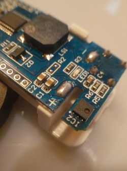

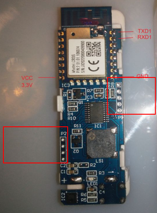

    But wait, what is IC1? Isn't it a TuyaMCU?
    IC2 is a sensor, I think:
    BK7231N/CB3S Tuya generic battery powered temperature and humidity sensor with CHT8305 sensor
    Can you post a better quality photo of IC1 and IC2?
    Isn't Q1 used to enable/disable WiFi module by IC1 (TuyaMCU)? Then you don't need deep sleep....
    Do you have a multimeter to do some basic checks?
    Two programming headers also suggest TuyaMCU:
    I think this device is using TuyaMCU (UART) to communicate with IC1 and gets measurement by UART. There is no i2c needed. Futhermore, no deep sleep is needed because TuyaMCU (IC2) controls power of WiFi module by Q1. So WiFi module is on only for a short time to report measurement and then powered off by Q1 transistor.

    What is the marking on IC1 and Q2? I can't see very well.
    Does RXD1 and TXD1 of BK7321 module connects to pins of IC1, and if yes, to which pins?
  • UM8005 identified as the main MCU on the board
    #5 20374794
    minusync
    Posts: 57
    It is extremely hard to make readable photos bcs the light from markings only reflects at distinct angles.
    about IC1 it should be UM8005
    https://www.unicmicro.com/index.php/en/show-75-127.html
    "UM8005 adopts an optimized 8051 system architecture with a maximum operating frequency of 24MHz, an ultra-low power management system, a sleep current of 0.59μA, and an operating current of 95μA/MHz. It supports timing wake-up and is suitable for various low-power application scenarios; Single-cycle EFLASH, SRAM read, most"
    http://www.gztrchip.com/product/list-18-1.html
    I could not find proper datasheet for 8005 so I cant be 100% sure I count pins correctly but meter gives pins readout
    TXD1 pin 16 and 9
    RXD1 pin 17 and 9

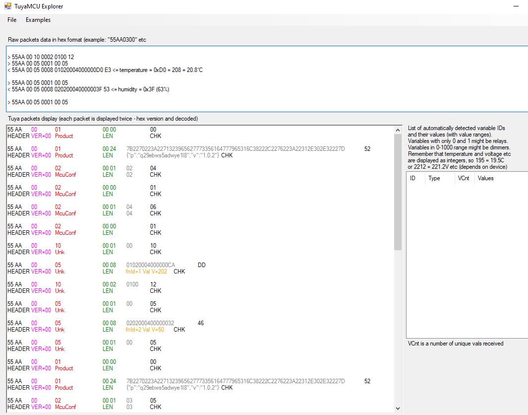

    I didn't check each packet precisely yet, but in general it looks similar to supported TuyaMCU door sensor. It's worth giving a try
    Here are results from my TuyaMCU analyzer:

    It reminds me of that topic:
    https://www.elektroda.com/rtvforum/topic3914412.html
    The autoexec for that door sensor was:
    startDriver tuyaMCU
    startDriver tmSensor
    setChannelType 1 ReadOnly
    linkTuyaMCUOutputToChannel 3 val 3
    setChannelType 3 ReadOnly;
    in this case we have different dpIDs:
    - temperature: fnId=1 Val V=208
    - humidity: fnId=2 Val V=63
    - idk some config var? fnId=15 Enum V=1 (that packet: < 55AA 00 05 0005 0F04000101 1E)
    so the config for this device would be:
    startDriver tuyaMCU
    setChannelType 1 Temperature_Div10
    setChannelType 2 Humidity
    You also need flags:
    - Flag 10 - [MQTT] Broadcast self state on MQTT connect
    - Flag 19 - [MQTT] Always publish channels used by TuyaMCU
    Please do 2MB firmware backup and try OBK with this config

  • Need UART capture setup for Tuya pairing mode
    #24 20379416

  • 3.3 V on battery contacts for packet capture
    #26 20381491
    Posts: 14805
    Rate: 12972
    ionoleinic wrote:
    I saw Tx2 and Rx2 on the front of the pcb, can i use 3.3 and GND from batteries?
    Tx1 and Rx1 are on the back of pcb.
    Thanks.
    If you want to make a packets capture from TuyaMCU device, then use can apply 3.3V power directly to batteries contact. This will just work like the device had batteries.
    On the other hand, applying 3.3V directly to VDD on WiFi module will not work, because the TuyaMCU lower power devices have TuyaMCU control the power of wifi module and TuyaMCU only enables module when it's needed to report the data.
    TuyaMCU here won't respond on request, it is at deep sleep most of the time.
  • #27 20381552
    ionoleinic
    Posts: 48
    Is somewhere a guide how capture these packets?
    I connected tx2 and rx2 to usb uart.Power and gnd was from batteries.
    I tried with realTerm and my capture.txt file was always empty.
    Thanks.
  • #28 20381572
    Posts: 14805
    Rate: 12972
    TX2 and RX2 are a debug log output. There you can find Tuya firmware log. TuyaMCU communication is on RX1 and TX1, it's on the same port that is used for flashing the device via UART bootloader.
    First make sure that you're getting anything in Realterm without capture. Then try capturing.
    I will write a guide on that topic soon, I have been asked the same just about yesterday.
  • #29 20381992
    ionoleinic
    Posts: 48
    I am trying to capture packets of TuyaMCU communication of tem and hum sensor.I tried with RealTerm, now with TeraTerm, but still nothing.
    I am doing this for first time and i am not understanding what i am doing wrong.
    Can somebody help me?
    Thanks.
  • #30 20382066
    Posts: 14805
    Rate: 12972
    You have wrong connection. You are supposed to have a common ground connection, just like during flashing. GND of WiFi device and GND of USB to UART converter should be connected together. Then, you can connect USB to UART converter RX pin to TXD1 or RXD1 to capture data.
    Gnd must be common, because all signal levels are measured as relative to ground.

I get “Bus error” or CRC mismatch during flashing – fixes?
Long jump-wires create capacitance that corrupts UART signals. Shorten wires, power only the Wi-Fi module, and retry. If CRC still fails, erase flash fully, then re-write; Windows Flasher skips the check [Elektroda, haps123, #20639761; Xinayder, #20677075].
What goes in autoexec.bat to read temperature and humidity?
startDriver tuyaMCU
linkTuyaMCUOutputToChannel 1 val 1
linkTuyaMCUOutputToChannel 2 val 2
This links DPID 1 and 2 to channels 1 and 2 and scales temperature by 0.1 °C [Elektroda, p.kaczmarek2, post #20375288]
