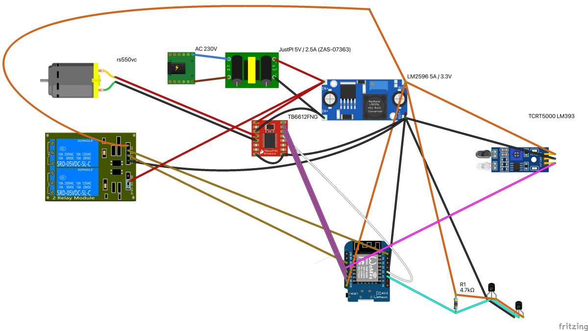

    As a weekend hobby and to learn electronics, I decided to make a magnetic stirrer for yeast propagation.
    The stirrer is to have motor speed control, speed measurement (as a fun addition), temperature measurement (ambient and liquid), cooling and heating control (relays) and in the future a touch screen (2,8" ILI9341).
    Components
    - The heart of the circuit is a Wemos D1 Mini (lion clone).
    - For the power supply, I used a JustPi 5v/2.5A power supply. Connected to it was a 5A version of the LM2596 twisted to 3.3V.
    - The motor is an rs550vs and is powered by 12v as standard. As it doesn't need that much RPM and torque I am powering it with 5v.
    - The motor controller is: TB6612FNG. It uses one channel.
    - I use a TCRT5000 LM393 reflection module to measure the speed.
    - The relay module is a standard board with 2 relays from an arduino. As wemos operates on 3.3v and the relays on 5v, the board itself is additionally connected under 5v (instead of a jumper)
    - The thermometers are standard ds18b20 with a 4.7k pull-up resistor
    - I based the software on esphome. Easy configuration and integration with other software.
    In theory, the circuit works fine. However, I have a few problems with it:
    - after connecting the power supply, the motor always turns (about 1/2-1 turn) and only stops
    - wemos does not always detect connected thermometers
    - after connecting the thermometers the system resets. motor turns over, wemos starts from the beginning.
    The starting action is so "painful" that I finally damaged the wemos in the tests.
    What could be wrong? Which components in particular should I pay attention to for diagnostics?
    Electronic schematic of a magnetic stirrer using Wemos D1 Mini and other components .
    Many thanks in advance for your help! and apologies for the large number of connections in the picture :(

    after power is applied, the motor will always turn (about 1/2-1 turn) and only stall
    This could be a transient (or fixed on) of some motor control line. Before the mcu starts the driver gets a signal.
    What control lines do you have connected to the motor driver?

    >>21367537 the controller is wired to wemos according to the schematic:
    AIN1 - D7
    AIN2 - D8
    PWM A - D6 and frequency 20000Hz
    STSY - D3. It defaults to ALLWAYS_OFF (low state). It probably only turns on when Wemos is started. Maybe this pin needs to be pulled up in some way?
    I also have a suspicion that the 5v/2.5A power supply is not too weak and thus the circuit does not read the thermometers and goes crazy when plugged in. Do you think this is possible?

    In the diagram you don't have the vcc connected to the driver, is that really the case?
    Isn't this motor on 12v (you are feeding 5v to the VM).
    Also do a test - unplug the STBY from the driver and see if the motor then starts too when you power it up.

    >>21367598 VCC is not connected to the driver. I missed while soldering. I will correct it. Mega thanks.
    The motor has a nominal 12V. Its power at 12v is way too strong. Already at 5V it runs at 30-35%. I therefore decided to power it with a lower voltage. I had it at a very good price, so I applied it.
    I will add VCC and test the STBY disconnection.
    Still additional questions:
    - should I connect the grounds from the 5V and 3.3V circuit and treat them separately or together?
    - can I solder the pull-up resistor on the DS18B20 to the feet of the first thermometer, or should that be closer to the Wemos?
    - for testing the power supply performance, can I supply the chip with LM2596 3.3V and the Wemos USB supply at the same time, or is it better not to do this?

    You should not supply the motor with more than twice the rated voltage, but use PWM instead.
    zendev wrote:
    should I connect the grounds from the 5v and 3.3v circuit and treat them separately or together?
    They are connected anyway, this inverter module has no separation between input and output, - the ground is common.

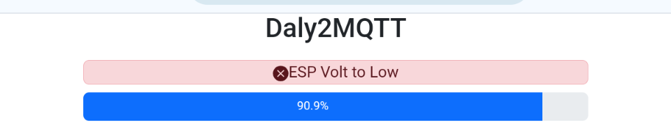

    I would use 5V to power the wemos D1 while I would use 3.3V from the wemos to power the ds18b20. So the LM2596 is unnecessary.
    I have Dalybms supported by ESP8266 powered by 3.3V there is information about low supply voltage .
    Low ESP voltage notification on Daly2MQTT interface .

    i have made the following changes to the circuit:
    - I removed the LM2596. i supply the wemos directly from 5v. I supply the rest of the hardware with 3.3v from the wemos
    - I installed the missing 3.3v to the motor driver.
    After the change the reading from the d218b20 improved. Now they no longer drop out and are available all the time.
    Unfortunately the errors are still there: engine rotation after system start, system restart after attaching/detaching ds18b20 sensor.
    As a test, I installed 10k and then 4.7k resistors between the standby and gnd legs of the motor controller. Unfortunately, such pull-ups also did nothing.
