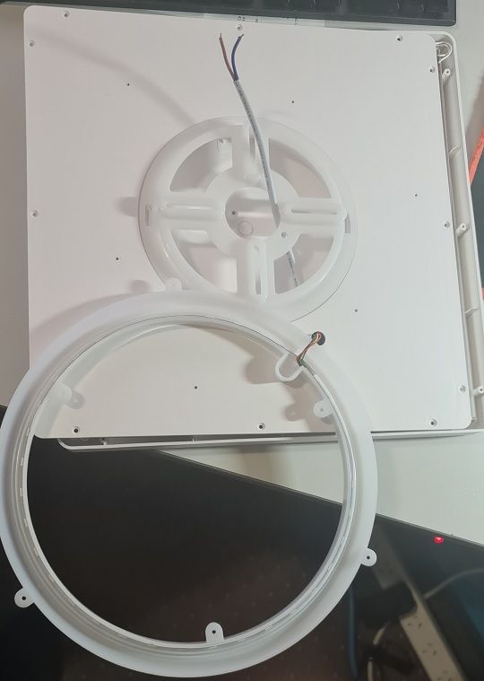

    Hi,
    Below is my journey to free up the Zemismart TUYA WiFi Ceiling Lamp 34W with CCT RGB Colorful Back Light from the Tuya cloud.
    Part 1 - Preparation
    AliExpress device link: Link

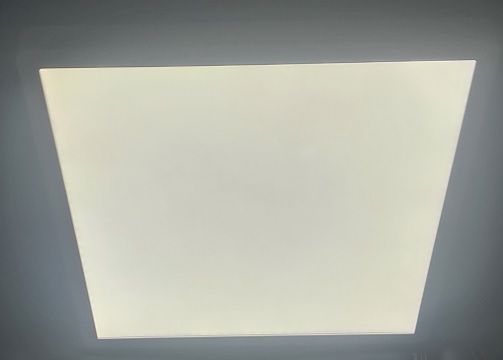

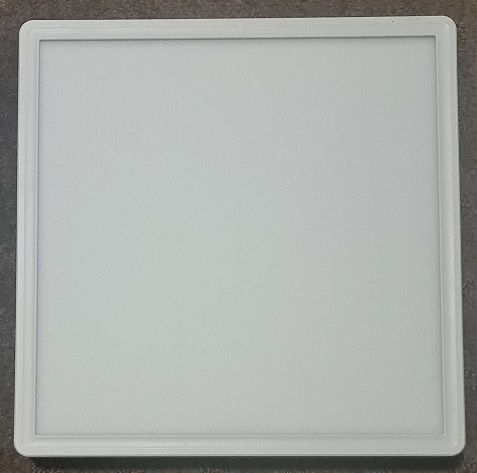

    Some pictures of the device:
    Zemismart TUYA WiFi Ceiling Lamp 34W with RGB Three lighting options of a ceiling LED lamp: warm, white, and cold light. Interior of a room with an RGB ceiling light featuring color-changing options, controlled via a smartphone app. Smartphone app showing brightness adjustment for a smart home ceiling light.
    Below are some pictures of the actual device. Both the white LEDs and the RGB ones are very bright (a bit hard to tell from the pictures but they are).
    Square LED ceiling lamp in white color. Square LED ceiling lamp with central light. Square ceiling lamp emitting bright white light. Ceiling lamp with brightly glowing LED ring and red background.

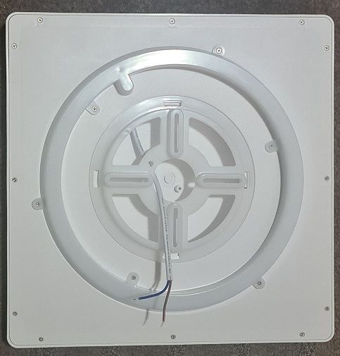

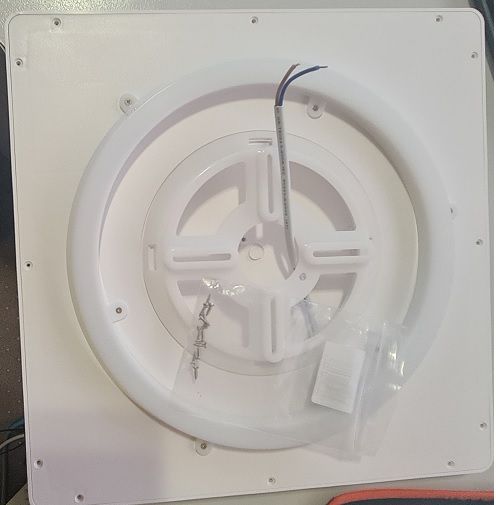

    Opening the device is very easy - a few screws and then the lid can come off.
    Image of the underside of a round ceiling lamp with the cover removed, showing wires, screws, and plastic components.
    Image of Zemismart TUYA ceiling lamp with open casing and visible wires.
    After taking the cover off (be careful not break the wires when taking off the cover) this is what we find inside:

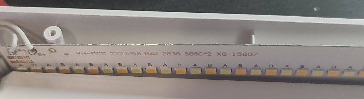

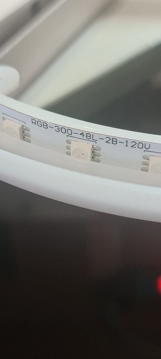

    - White LEDs:
    Close-up of an LED strip mounted on a circuit board with visible technical markings.

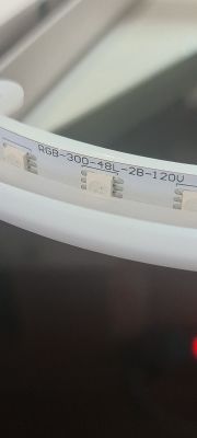

    - RGB LEDs:
    Close-up of an RGB-300-48L-2B-120V LED strip showing several diodes on a white base.

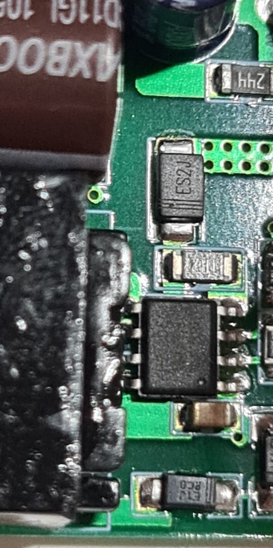

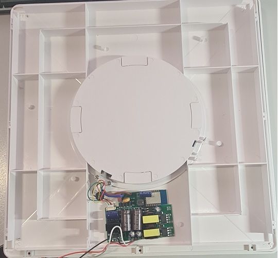

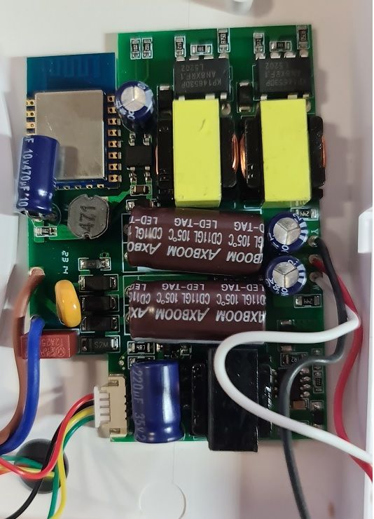

    Below is a picture with an overview of the circuit board:
    Interior of Zemismart TUYA WiFi Ceiling Lamp 34W with the cover removed, showing the circuit board and wiring.

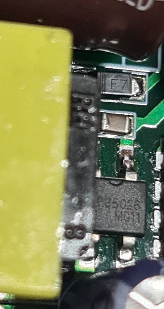

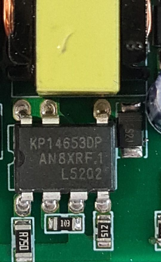

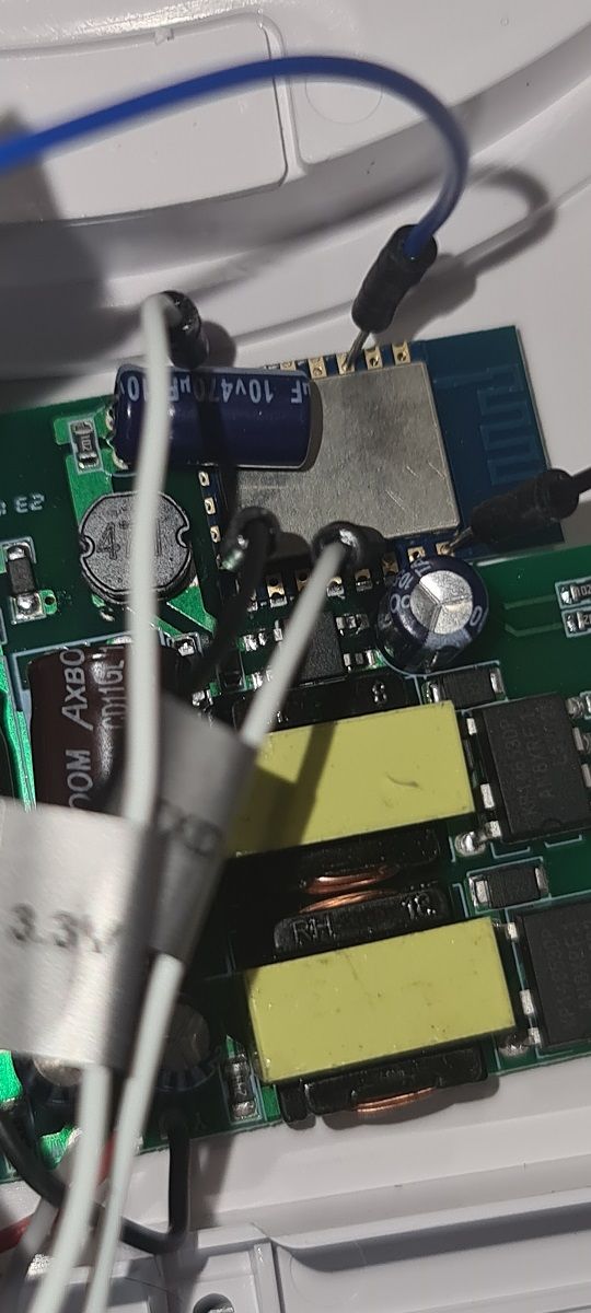

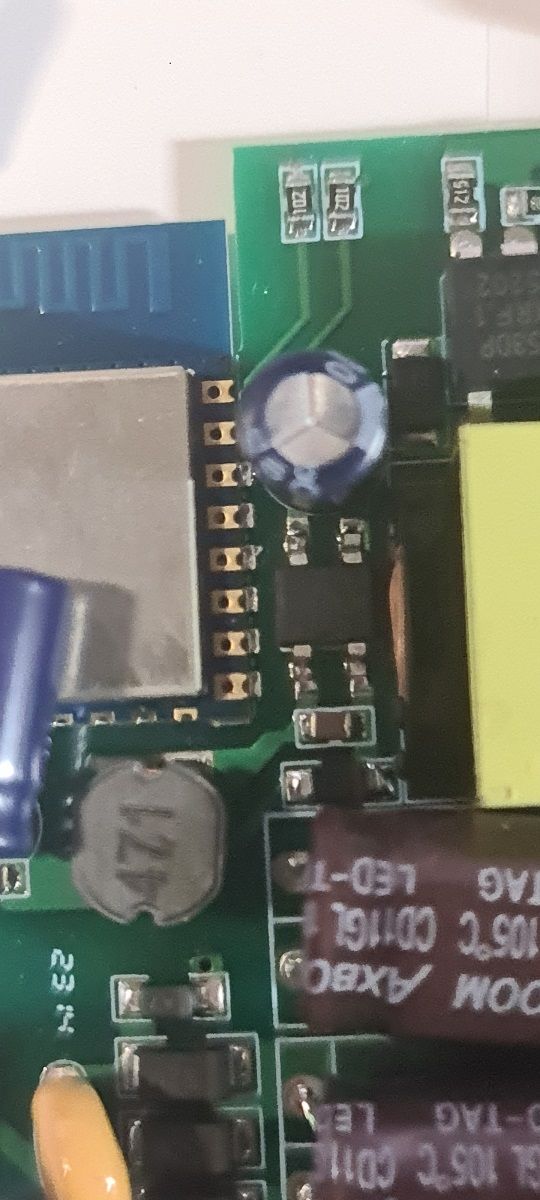

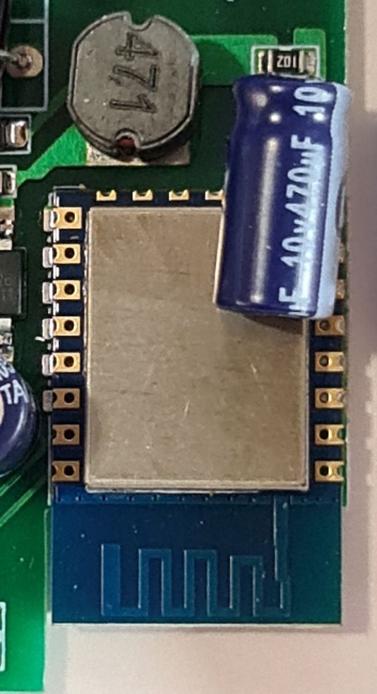

    Also some closeup pictures of the components on the circuit board:
    Close-up of a circuit board with various components. Close-up of electronic components on a printed circuit board. Close-up of components on the Zemismart ceiling lamp circuit board. Close-up of PCB components with markings on the integrated circuits Close-up of PCB components: visible markings on a microchip and other elements.

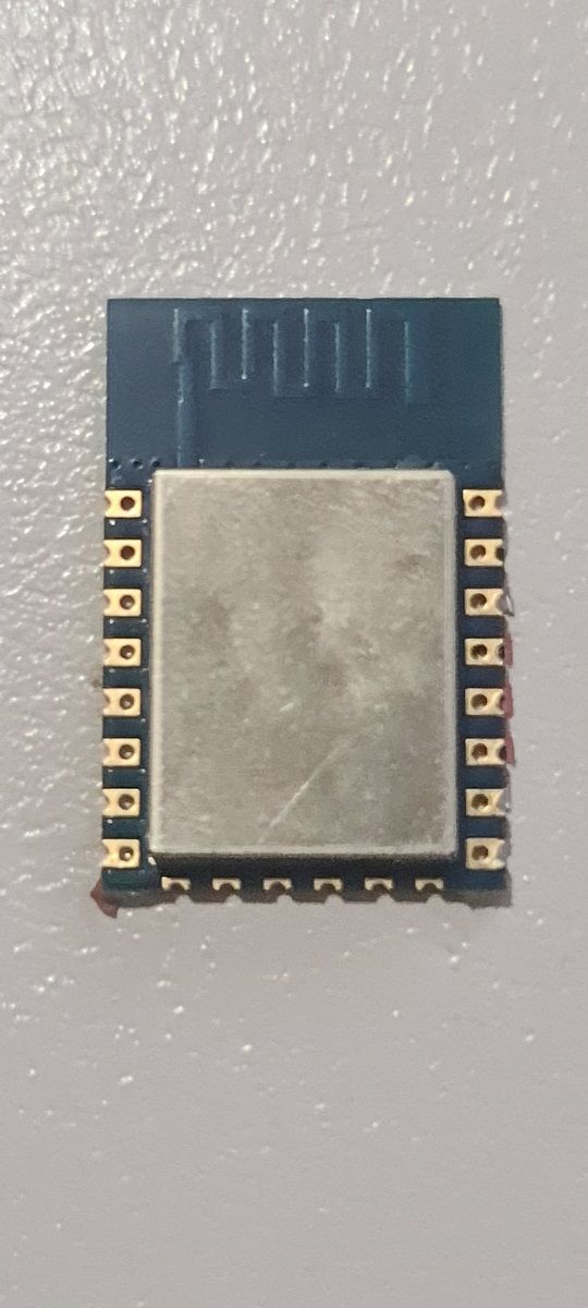

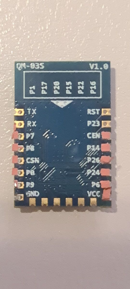

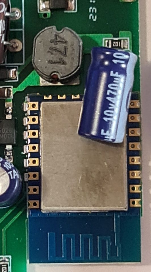

    The Tuya CB3S module - there are no markings on the CB3S Module at all. In the second picture you can notice that I have gently pushed the capacitor (assume it is a capacitor :) ) a little bit out of the way to expose the CB3S module connections.
    Close-up of a Tuya CB3S module on a circuit board. Tuya CB3S module on a circuit board with a capacitor
    Since the Tuya module has been identified as a Tuya CB3S module the device will need to be flashed with BK7231N
    Below are some pictures from a test module that I had which further strengthen the case that it is a Tuya CB3S module:
    Tuya CB3S Module QN-03S V1.0 module with pin markings.

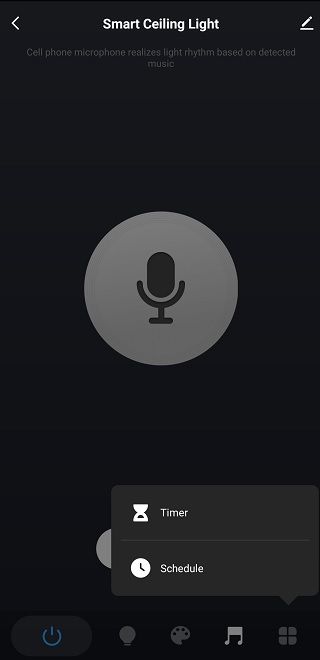

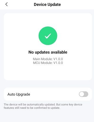

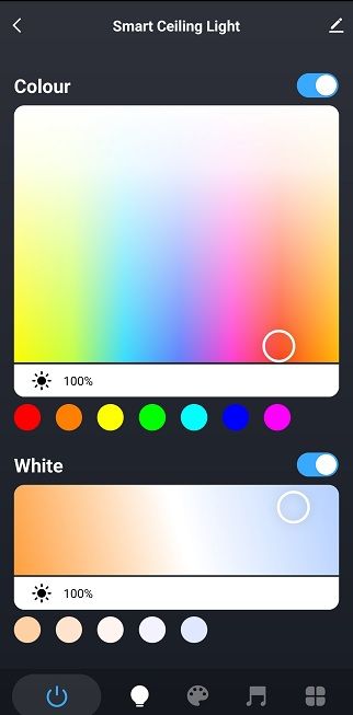

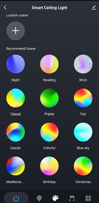

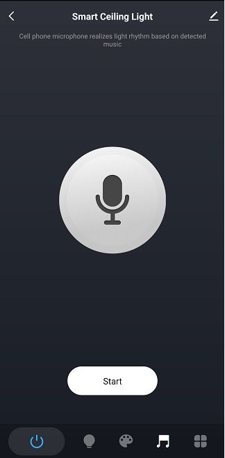

    I have added the light to Tuya Smart Life. Below are some screenshots of what options the device has in the Tuya app:
    Tuya Smart Life app interface for ceiling light color adjustment. Screenshot of Smart Ceiling Light app with various lighting scenes. Screenshot of a mobile app for controlling smart ceiling light. Screenshot of the Smart Ceiling Light app with a microphone icon and Timer and Schedule options. Device update screen indicating no updates available.

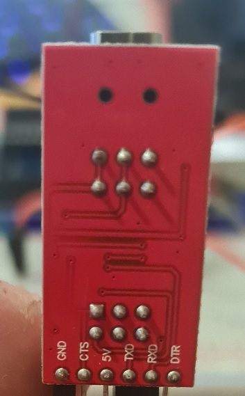

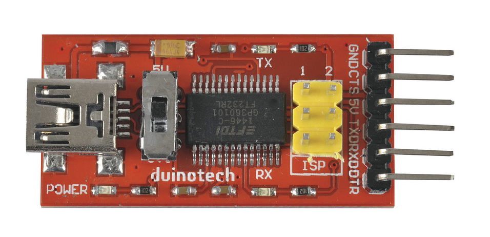

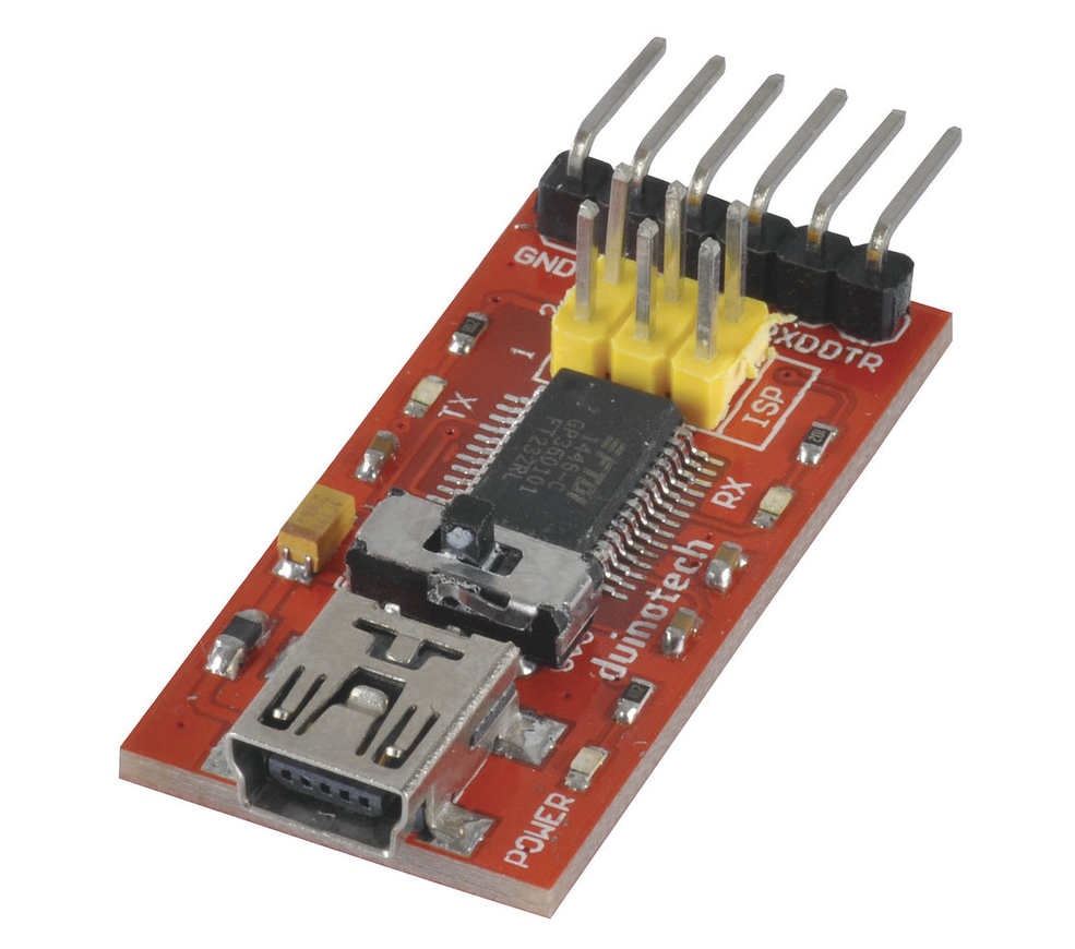

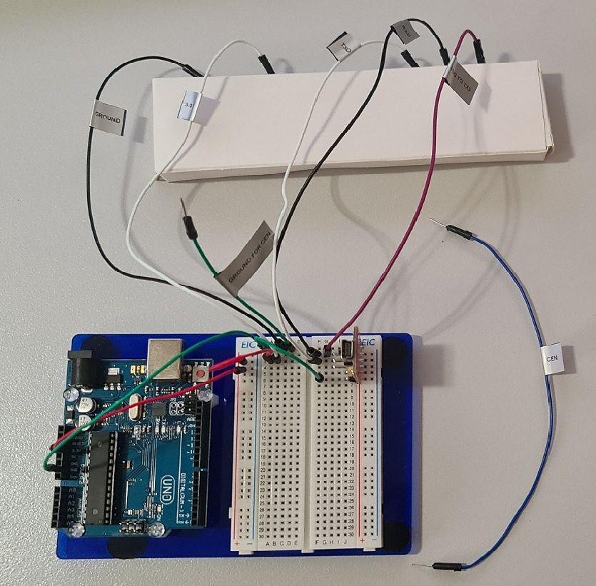

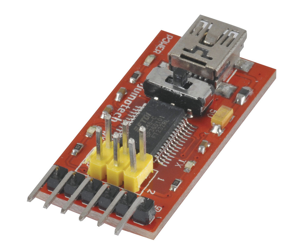

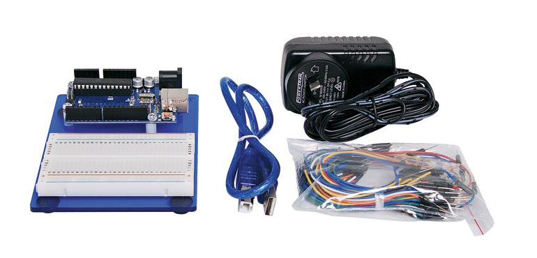

    These are the "tools" that I will use to flash OBK to this device:
    1. UART 3.3V and 5V (selectable)
    Duinotech USB to Serial Adapter Module in packaging. Communication module with micro USB port and pin header. Red USB to UART adapter with pin headers and a microchip. Duinotech USB-TTL adapter with GND, CTS, 5V, TXD, RXD, DTR connections.

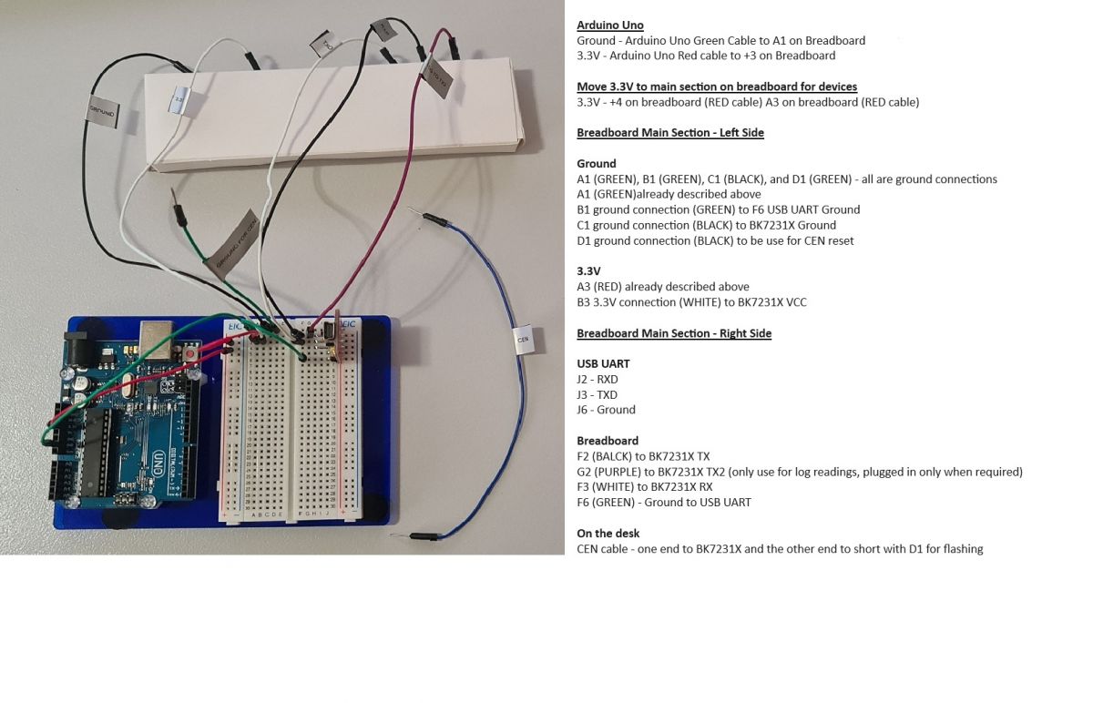

    2. Arduino Uno R3 - I have used a starter kit with mains power supply
    Arduino Uno R3 platform starter kit with breadboard. Arduino Uno starter kit with breadboard and wires Arduino Uno kit with breadboard, USB cable, and wires

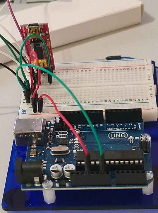

    Below are some pics on how I put the UART and Arduino Uno together:
    Close-up of an electronic module with visible pins and traces on a red background. Image of an Arduino Uno R3 module connected to a breadboard with wires, used for flashing a device. Arduino Uno set with connected wires and a breadboard.
    Image of Arduino Uno wiring with a breadboard and descriptions of connections to the Tuya module.
    Some notes for beginners like me :) on the above setup:
    - had to use additional power source as UART will not provide sufficient power
    - I tried intially to get power from the 5V pin on UART and use a 3.3V LDO but that did not work for me. So I got the Arduino Uno R3 kit that is powered with a mains external power supply
    - Ground had to be connected from the Arduino Uno to the chip and the UART

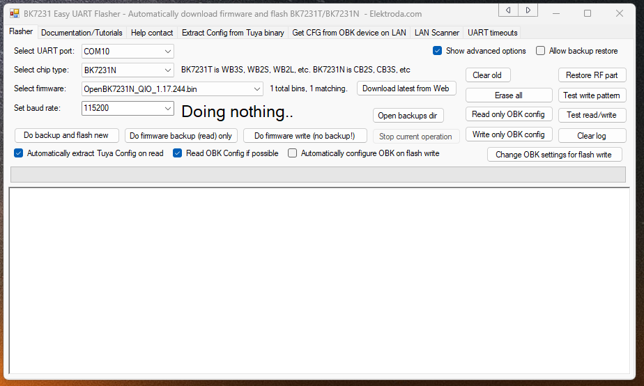

    3. BL7231 Easy UART Flasher
    I will be using used version 1.1.1 on a Windows PC
    BK7231 Easy UART Flasher interface on computer screen
    Stay tuned for Part 2 - the OBK flashing process.

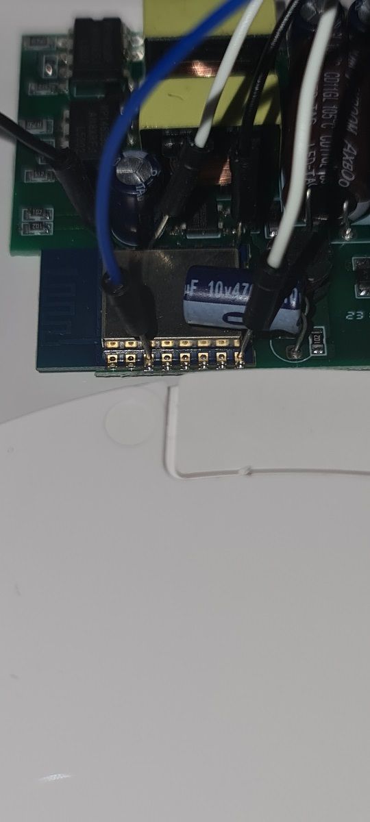

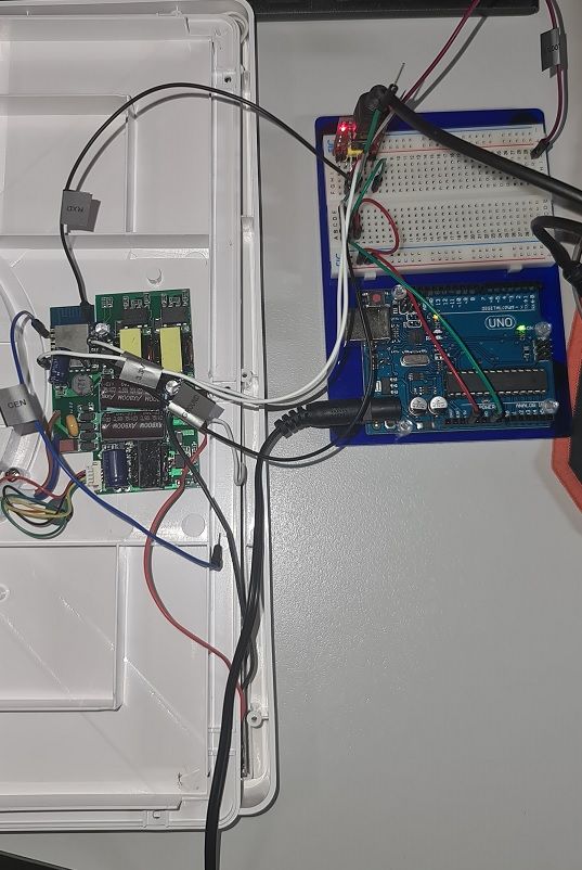

    As you can see in the picture below the Tuya CB3S module actually has some holes on the side.
    Close-up image of the Tuya CB3S module on a printed circuit board.
    So instead of taking the whole PCB out and solder wires I have decided to leave it in place and use the Arduino wires to push them slightly in, just enough that they stay put in the holes and don't actually come out.
    Close-up of Tuya CB3S module connected with wires. Close-up of an electronic circuit with wires and capacitors on a PCB.
    In the picture below everything is connected and powered up.
    Electronic module connected to an Arduino board.

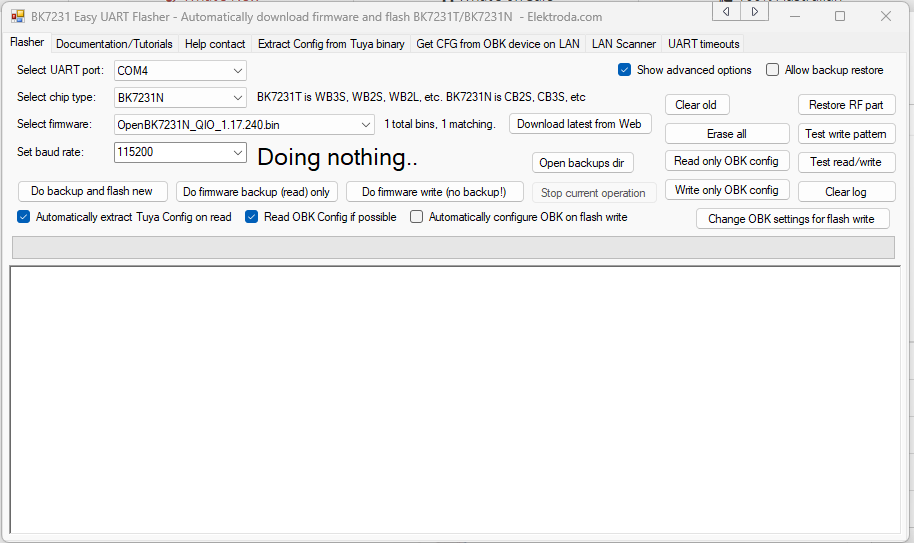

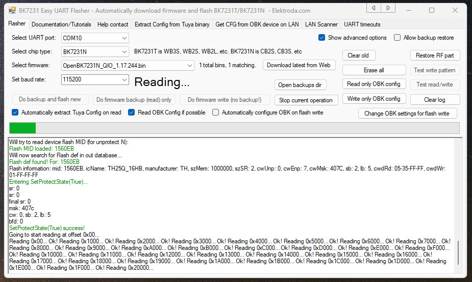

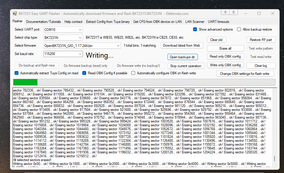

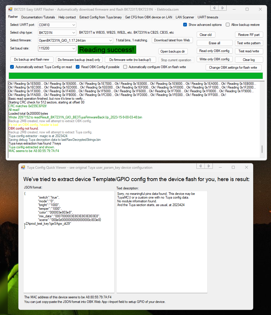

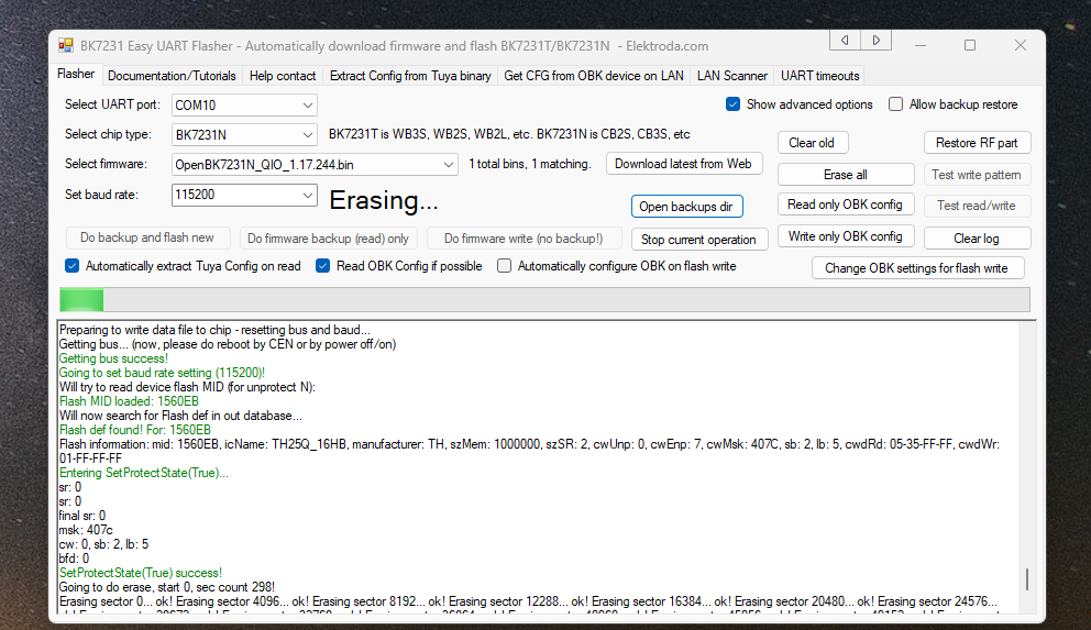

    Next I start BK7231 Easy UART Flasher on my Windows PC
    Screenshot of the BK7231 Easy UART Flasher program with settings

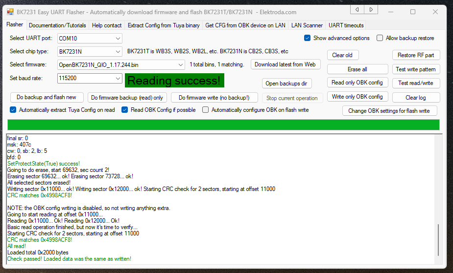

    Started to do a read/write test (and in the process I had to quickly short the CEN wire to the Ground wire). The test completed successfuly.
    BK7231 Easy UART Flasher screen with a reading success message.
    Next step was to select the Do firmware backup (read) only in BK7231 Easy UART Flasher. Original Tuya backup completed successfully. Backup file is attached below.
    BK7231 Easy UART Flasher panel on Windows PC displaying options and read flash progress.
    BK7231 Easy UART Flasher interface successfully reading data.

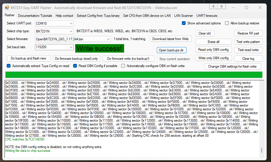

    Next I have selected Do firmware write (no backup) to flash the device with OpenBK7231N_QIO_1.17.244.bin file. The flash was successful.
    BK7231 Easy UART Flasher software executing an erase operation. BK7231 Easy UART Flasher interface on a computer with a flashing process log. Screenshot of BK7231 Easy UART Flasher program showing write success.

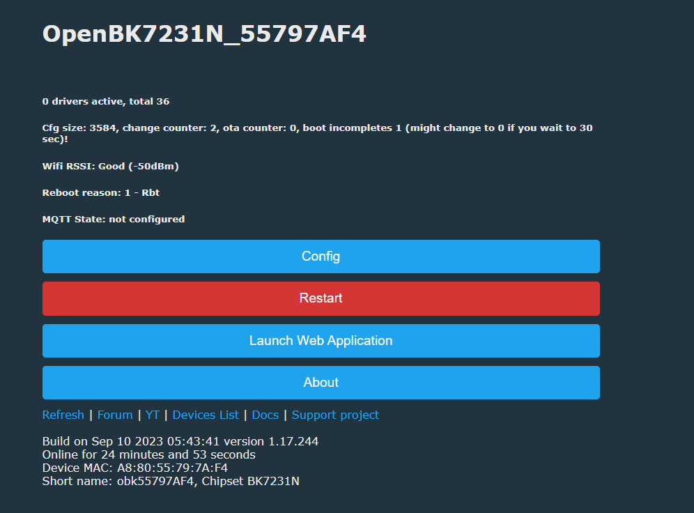

    I have then removed all the wires from the device and put its cover back and tightened the screws. Next I have connected power to the device.
    I saw its AP, connected to it and added the WIFI configuration. After the reboot the device was on my network and I could connect to it web interface
    Screenshot of the OpenBK7231N interface after flashing.

    As you can see from the Tuya app screenshot this device has 2 individual configurations, 1 for the white LEDs and another for the RGB LEDs.
    Screenshot of the Tuya app showing smart ceiling light configurations.

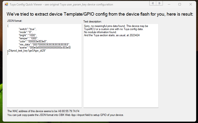

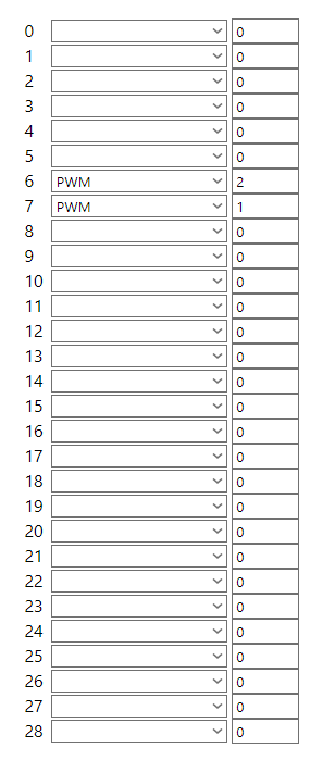

    Also the GPIO config doesn't look like it had any meaningful information in it:
    Screenshot from Tuya Config Quick Viewer showing device GPIO configuration.

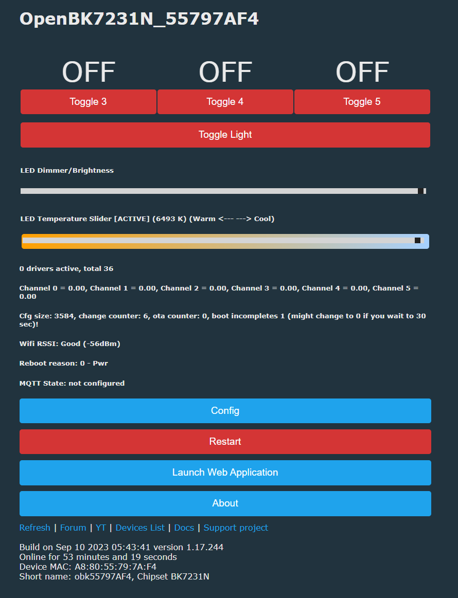

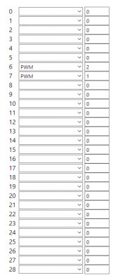

    So through some trial and error I have managed to find the configuration for the white LEDs. With it I can toggle ON/OFF, control the brightness and temperature of the white LEDs.
    Screenshot of a configuration table with GPIO settings for a device.
    Screenshot of OpenBK7231N application showing LED configuration options.

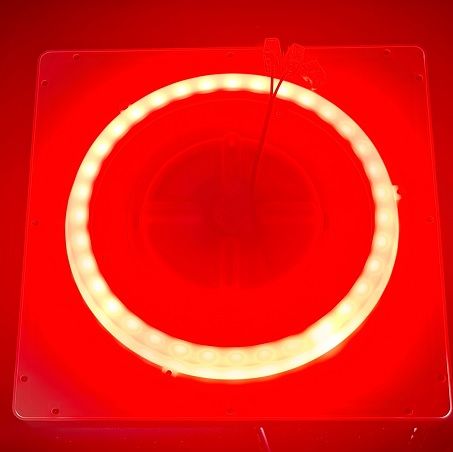

    With the RGB LEDs things are getting more complex, at least for me.
    I have figured that if I set P8, 24 and 26 to LEDs at least I can confirm that I got the right pins. The result is:
    P8 = 3 = RED Color
    P24 = 4 = GREEN Color
    P26 = 5 = BLUE Color
    So at least I got the pins and color correct. However this is not how the configuration should be because I get 3 extra individual toggle buttons on the web interface. There is no brightness or color picker at all:
    Screenshot of the OpenBK7231N application with LED configuration options.
    What I think we should have there is a another toggle button for the RGB LEDs with its own brightness and RGB color picker.

    That is how the device works with the Tuya firmware. So it will be good to have it work the same with OBK.
    If I set all the pins to PWM, there are a few things wrong with it:
    - One cannot independently control the on/off toggle of the white light and RGB ones as per Tuya firmware.
    - After you toggle the light on, if the dimmer/brightness is used, it switches off the white LEDs.
    - Similarly, for the temperature slider, if it turns off the white light.
    - The RGB color picker actually changes the white light temperature - the LEDs' color does not change at all.
    - The RGB LEDs are always red - I could not change them to another color.
    Maybe there are more issues, but this is what I have picked up through my testing.

    Alternatively you can enable "show raw PWMs" mode, but that is usually useful only for debugging.
  • #6 20734396
    MnM1
    Posts: 175
    Rate: 13
    I just quickly tried that (enable Flag 3).
    It has 5 sliders that will control the lights.
    The top 2 sliders will control the white light, achieving in a way what the previous configuration did.
    The last 3 sliders sort of equal an RGB picker but in a weird way :)
    There are no on/off toggle buttons.
    Any chance you can have OBK support the functions as they were in the Tuya firmware?

TL;DR: For the 34W Zemismart TUYA lamp with CB3S/BK7231N, UART flashing works — "The flash was successful." Back up first, then write OpenBK and map PWM for white and RGB. [Elektroda, MnM1, post #20732603]
Why it matters: This FAQ helps makers free the lamp from Tuya cloud, flash safely, and fix RGB/CCT control quirks so it behaves as intended.
What’s inside this Zemismart TUYA 34W ceiling lamp and which Wi‑Fi module does it use?
It uses a Tuya CB3S module based on the BK7231N SoC. The lamp has bright white LEDs plus RGB backlight, and the CB3S exposes side holes useful for UART. Opening the housing requires only a few screws. This setup enables direct flashing and local control without Tuya cloud. [Elektroda, MnM1, post #20732603]
How do I flash OpenBK7231N to the CB3S without desoldering?
Use the solderless side holes. Quote: "The flash was successful." How‑To: 1. Connect 3.3 V, GND, RX, TX; add external power and common ground. 2. Run BK7231 Easy UART Flasher v1.1.1; briefly short CEN to GND when prompted; perform a full backup. 3. Write OpenBK7231N_QIO_1.17.244.bin, reboot, join the AP, and set Wi‑Fi. [Elektroda, MnM1, post #20732603]
Which GPIOs control RGB and CCT on this lamp?
Use five PWMs: GPIO8 = Red, GPIO24 = Green, GPIO26 = Blue, GPIO7 = Cold white, GPIO6 = Warm white. This mapping was confirmed in a working ESPHome YAML and delivers independent white and RGB control. Set suitable PWM frequencies per channel. [Elektroda, MnM1, post #20843903]
Why can’t OBK control RGB and white independently on this hardware?
OBK currently treats five PWM pins as a classic RGB + CCT controller. You must switch modes rather than drive RGB and white separately. As the maintainer said, "OBK tries to enable the classic RGB + CCT controller." Independent dual‑toggle behavior is not officially supported yet. [Elektroda, p.kaczmarek2, post #20733928]
Is there an OBK workaround to test all channels during setup?
Yes. Enable the "show raw PWMs" mode (Flag 3). You will see five sliders that directly drive the two white channels and the three RGB channels. There are no on/off toggles in this mode. It is useful for debugging wiring and PWM ranges. Note this is not a final UX. [Elektroda, MnM1, post #20734396]
What issues appear if I assign all five PWMs in OBK today?
Users report several problems: only one combined toggle, dimmer actions turning off white LEDs, temperature slider switching off white, RGB color picker changing white temperature, and RGB remaining red. These reflect the current mode limitations in OBK’s five‑PWM handling. [Elektroda, MnM1, post #20733951]

What Tuya DP IDs does this lamp expose for reverse engineering?
Observed DP IDs include 20 switch_led, 21 work_mode, 22 bright_value, 23 temp_value, 24 colour_data, 25 scene_data, 26 countdown, 27 music_data, 28 control_data, and 51 mix_rgbcw. These help analyze cloud behavior or map features in other stacks. [Elektroda, MnM1, post #20732603]
What UART and power setup is recommended for reliable flashing?
Use a 3.3 V USB‑UART plus a separate, stable power source, such as an externally powered Arduino Uno. Tie grounds between the module, UART, and power supply. The UART alone could not power the board. Short CEN to GND briefly when the tool requests bootloader entry. [Elektroda, MnM1, post #20732603]
Is a solderless connection possible on the CB3S?
Yes. The CB3S module has accessible side holes. You can gently insert Dupont wires to make contact without removing the PCB. Secure the wires to avoid intermittent contact. Always back up the original firmware before writing. [Elektroda, MnM1, post #20732603]
How do I recover if the device won’t boot after flashing?
Re‑enter the bootloader by briefly shorting CEN to GND and reconnecting via the UART tool. Restore your Tuya backup with BK7231 Easy UART Flasher v1.1.1 or re‑flash OpenBK. Ensure a stable 3.3 V supply; UART power alone may fail to start the board. [Elektroda, MnM1, post #20732603]

What does Tuya’s DP 51 “mix_rgbcw” indicate on this lamp?
It represents a combined RGB+CW control datapoint used by the stock Tuya firmware. The device reports this DP among others. Custom local stacks often implement separate PWM control without relying on Tuya datapoints. [Elektroda, MnM1, post #20732603]
