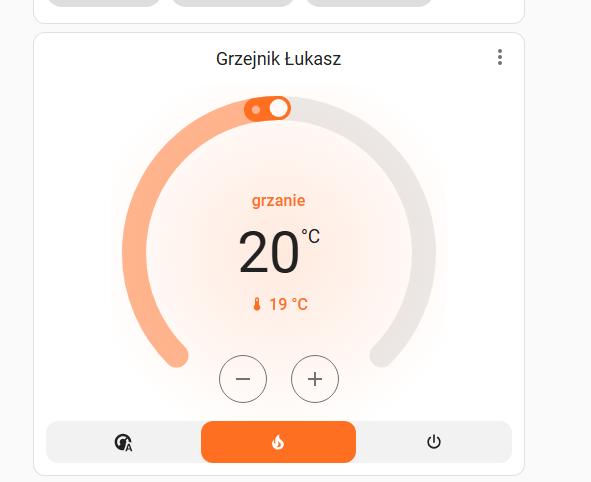

    and I can change its values in the HA panel without any problems
    Temperature control panel set to 20 degrees Celsius .

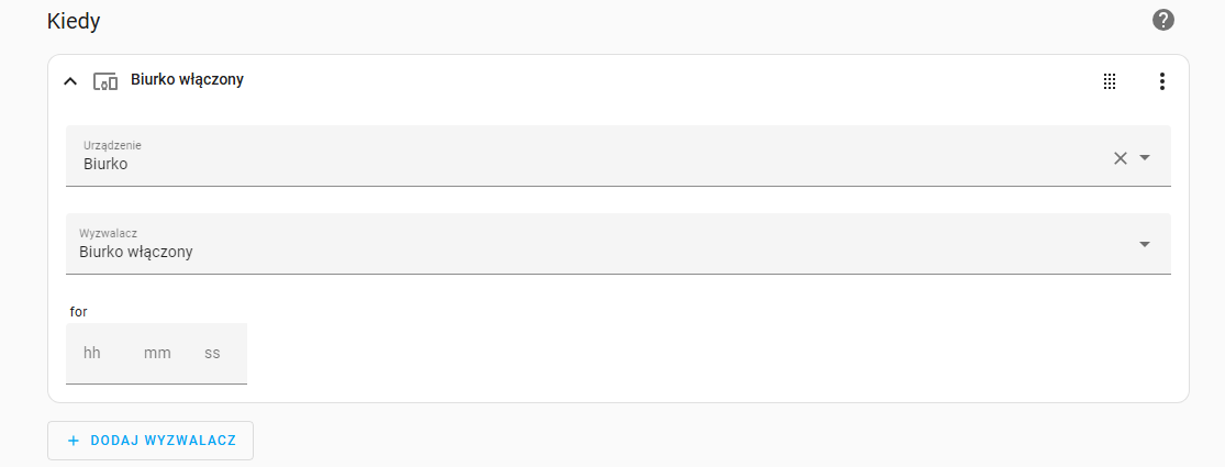

    and I've done the automation that when the desk lamp is on, it is to set the set temperature on the head.
    Screenshot of Home Assistant automation configuration showing a trigger for a desk lamp. .

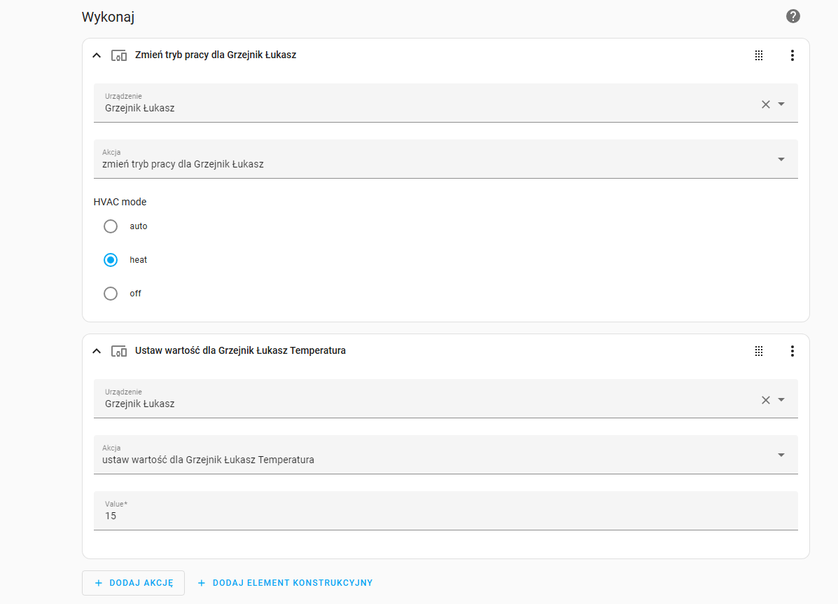

    Home Assistant automation panel with radiator settings. .
    alias: Grzejnik
    description: ustaw
    triggers:
      - type: turned_on
        device_id: 7c8e3f307c8f4a5b4c19ce113785a
        entity_id: 58a387a7d17672f17a4c07a07a4490
        domain: light
        trigger: device
    conditions: []
    actions:
      - device_id: 175e62c511982568cfd10075906d
        domain: climate
        entity_id: 52d471b5df8d9e892c0a2fae0689e
        type: set_hvac_mode
        hvac_mode: heat
        enabled: true
      - device_id: 175e62c511d98565d100d175906d
        domain: number
        entity_id: 05f1decf32ed97967091dc2281ace5
        type: set_value
        value: 15
    mode: single
    Unfortunately nothing happens, I'm wondering what I'm doing wrong or what I don't know.

    It is possible that the device as a trigger will not work (the trigger will never start) try by changing the trigger to trigger by changing the state of some entity (related to the enabled desk) from the state of any to enabled.
    (When: an entity [e.g. desk power] changes state from: any, to: on ; perform an action .... of this type)
