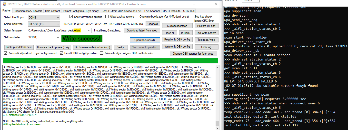

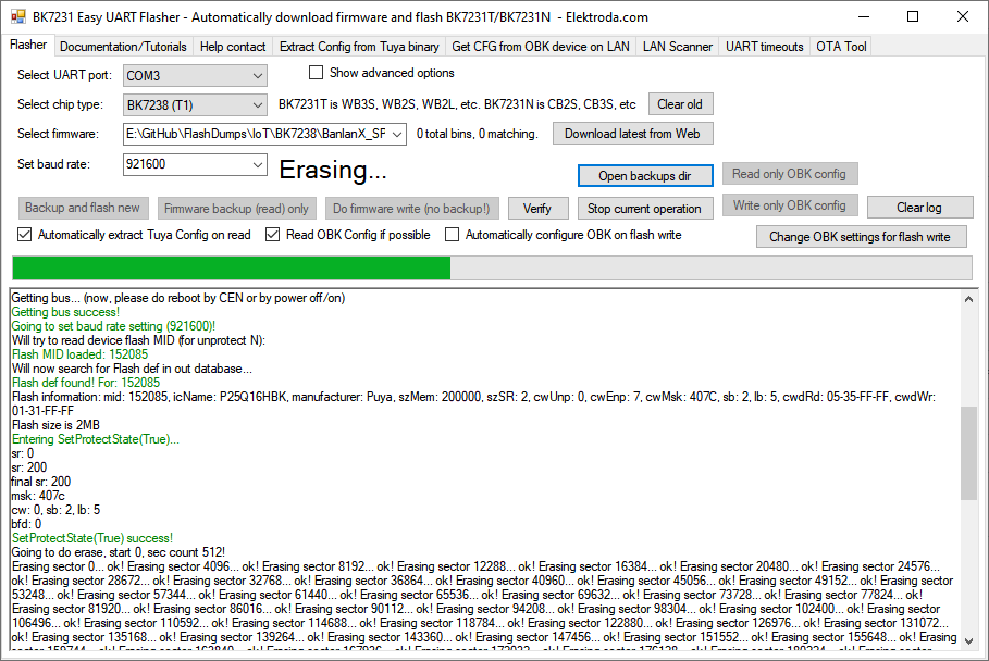

  • #6 21723570
    Posts: 5216
    Help: 448
    Rate: 917
    it flashes and boots OK. rename to .bin

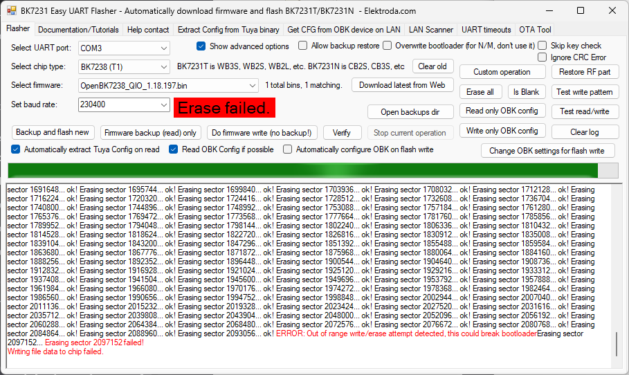

    I renamed to .bin, and chose "Custom Operation" and custom write, but get this
    Erase failed error in BK7231 Easy UART Flasher during flash memory erase operation

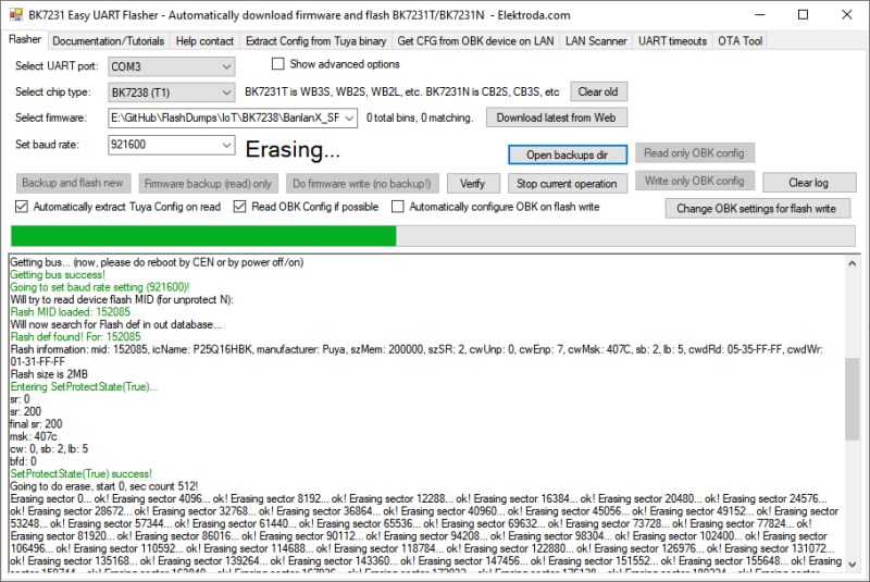

  • #8 21723573
    Posts: 5216
    Help: 448
    Rate: 917
    oh. drag your backup onto the 'select firmware' area so file is seen in drop-down box. then "do firmware write" button

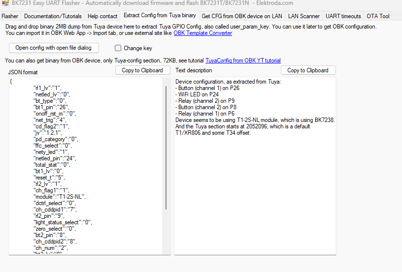

    Added after 4 [minutes]:
    Aha! This is very useful :)
    Screenshot of BK7231 Easy UART Flasher tool showing Tuya JSON and text configuration

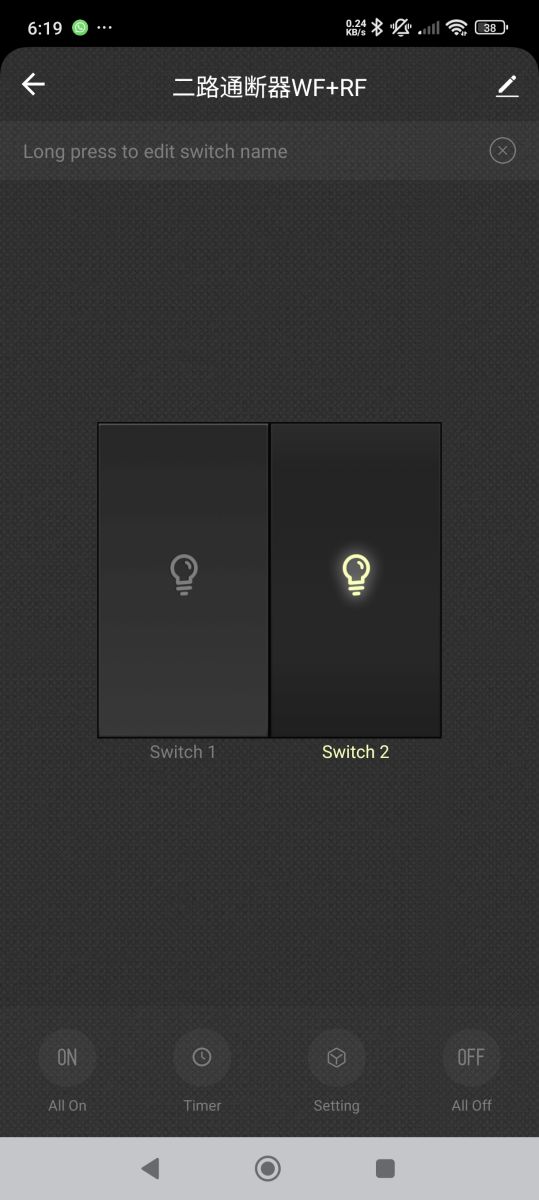

    not sure. How is the RF controller chip connected to the B7238, if at all? I seem to recall some RF-capable devices aren't intelligently connected to the MCU anyway, pair remote separately and maybe just control relay. Perhaps that is the case here too. I have paired your firmware with Tuya app and apart from the device name there's no mention of RF, no RF pairing info, nothing.
    App screen with two smart light switches; only Switch 2 is turned on

    I restored Tuya formats with your help, then the autoconfigure worked and detected all the necessary GPIO!
