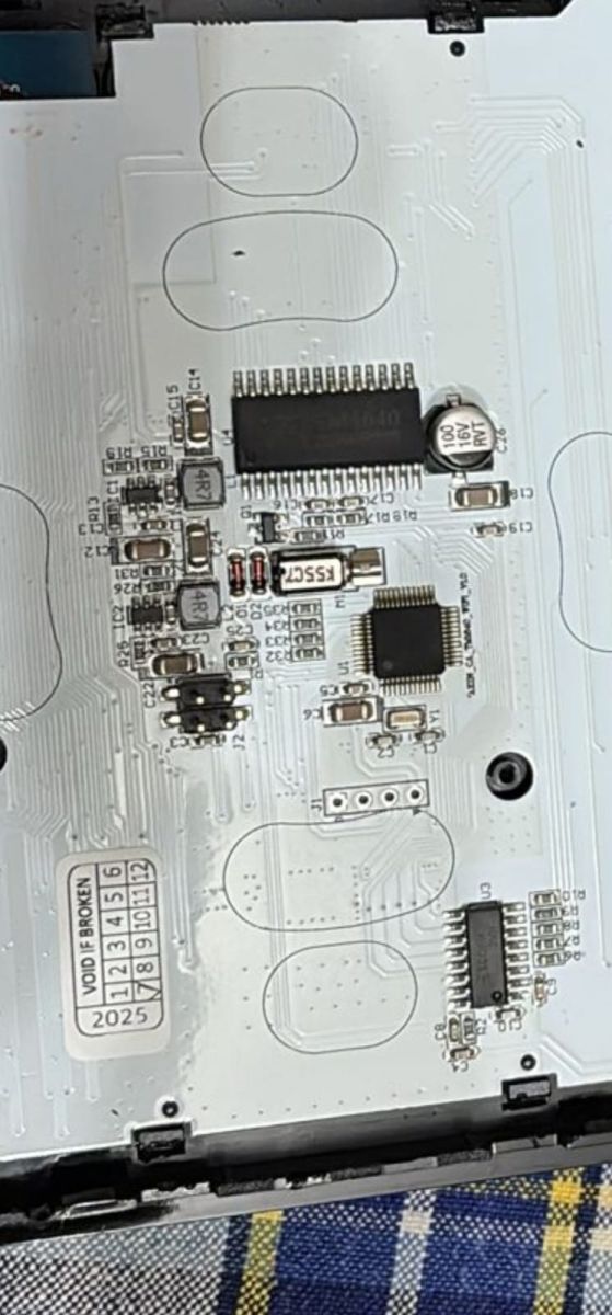

    I'm guessing there's a TM1640 present to drive the LEDs?
  • Fahrenheit datapoints 18 and 20 revealed by unit setting
    #5 21758772
    lamero345
    Posts: 33
    Wow. How to extract this info?
    Datapoints 18 and 20 are temperatures in Fahrenheit, so (I think) they are visible if I change from Celsius (default) to Fahrenheit.
    TM1640? Maybe I closed the thermostat, but I have a photo
    Internal view of electronic device with PCB and various mounted components.
