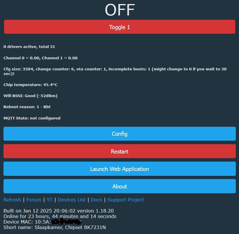

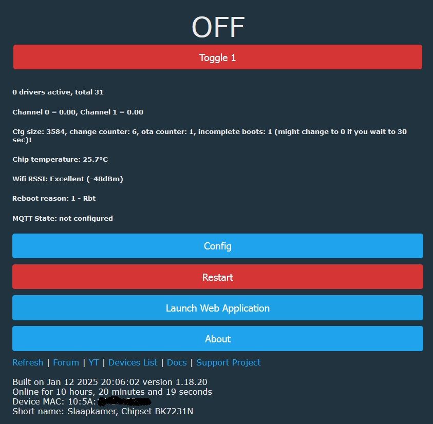

    I rebooted the socket and everything seems to work fine until I saw that my CPU temperature was much! higher then
    normal. (almost twice as high)
    So I removed all the NTP settings from autoexec.bat and just left PowerSave 1 in it, and rebooted.
    Again still high CPU temperature...
    I cleared the whole autoexec.bat, rebooted and in the WEBgui in 'Execute Custom command' I gave the command PowerSave 1
    and left it overnight and to my surprise the temperature was back to normal...
    Control panel of a smart WiFi socket with BK7231N chipset, displaying status information and configuration options.
    To be sure I placed PowerSave 1 back in autoexec.bat and left it for a few hours, and guess what... again high CPU temperature.
    WiFi smart socket web interface displaying diagnostic data

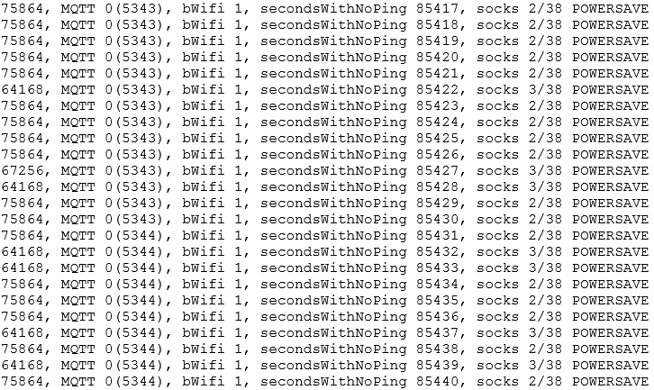

    To be clear in all cases the WEBgui was closed and no other traffic to the socket, strange thing is that in both cases in the logfile it says
    it is in powersafe mode, but there is a clear difference when PowerSave 1 is in autoexec.bat or given manually.
    Screenshot of a log showing messages related to MQTT and POWER SAVE mode.
    For me it looks that PowerSafe 1 is not executed in autoexec.bat, or maybe I'm missing out on something, then my apology for the trouble.

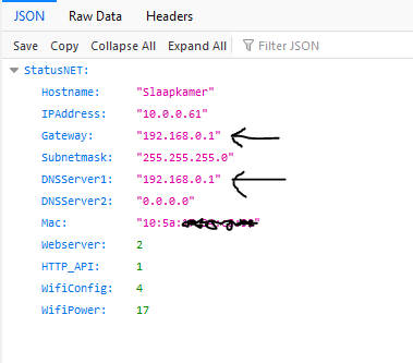

    Other small thing is that I do not use MQTT for control to the socket but via WEB requests and when I gave the status command for network
    settings this showed up;
    Screenshot of JSON data showing device network settings.
    The gateway and DNS do not have the right IPaddress, I think this is more a display thing, I can connect to devices outside my local network, so I guess
    gateway and DNS are OK, but they just display wrong in the status overview.

    At least for the JSON numbers I can tell that this is not showing the actual values but they are "hard coded" at the moment.
    https://github.com/openshwprojects/OpenBK7231...46a45280/src/httpserver/json_interface.c#L572

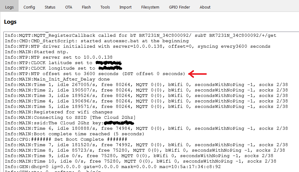

    Adding a sync interval to NTP seems a good idea. Should be easily added, will give this a try later.
    Added after 2 [hours] 44 [minutes]:
    Maybe you can try this image?
    It will allow an additional parameter to the startDriver ntp:
    startDriver ntp [<sync interval in seconds>]
    (defaults to 60 so without a argument it's (almost) like the actual driver).
    This is how it looks with 10 seconds, I didn't want to wait an hour for testing. This is up to you ;-)
    Screenshot of system logs with NTP synchronization every 10 seconds.

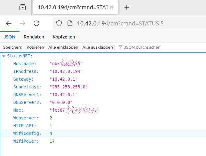

    Also I allowed the JSON code to display gateway ... for Beken devices.
    Screenshot of JSON interface displaying network information of a device.

    The JSON feedback on the WEB request http://10.0.0.61/cm?cmnd=Status%205
    Is still the same no change...
    But I think when you put a statement like <IF 0 > in the code it will always be true :-)
    To me it looks that the vars. HAL_GetMyGatewayString(), HAL_GetMyMaskString() and HAL_GetMyDNSString() do not have the right values,
    or default values declared earlier...

    Ooops, my fault, I simply uploaded the wrong version, without the fix...
    Please try this one.
    • dev_20250116_173250.zip (9.73 MB) You must be logged in to download this attachment.

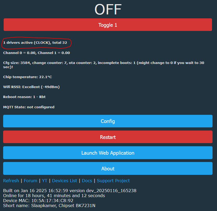

  • DEV firmware adds clock driver and keeps temperature stable
    #5 21398382
    Markie_V
    Hi
    Again thank you for the DEV firmware, will do some tests and tell later.
    Funny thing with the DEV firmware I suddenly have a clock driver (not in the normal firmware)
    and temperature (without NTP) is still good. :-)
    Screenshot of a device interface showing status and function information.
    Again I will do some tests and reply, but nobody else replied to this message, so maybe I'm chasing something that does not exist...
    Greetings Mark
    That's easy to explain, I added the changes to my actual testing branch.
