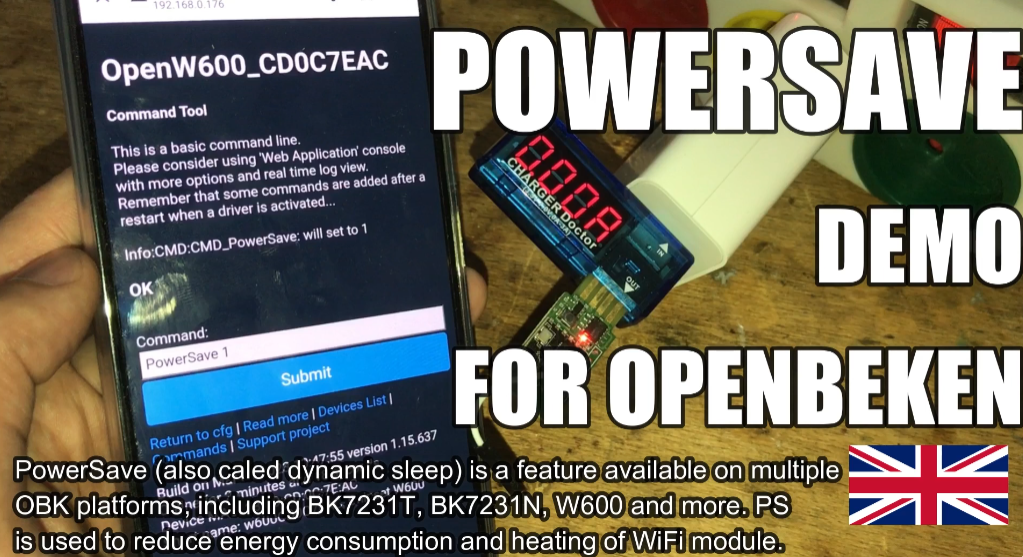

  • Mobile phone showing PowerSave feature enabled in the OpenBeken app, next to an energy meter.
    Dynamic power saving can be used to reduce energy consumption of the WiFi module. It can also reduce the heating of board and increase stability of the device. Sometimes power saving may be required for some cheapest Tuya devices, because their power supplies are not able to provide larger currents for longer times and will degrade their capacitors quickly when under higher load. Dynamic power saving is not a deep sleep, the WiFi module is still online when powersave is enabled. It can still respond quickly to MQTT and HTTP packets.
    Here's a quick powersave demonstration in OpenBeken:
    Keep in mind that power save may be reduced if you, for example, keep your constantly-refreshing Web App log open.
