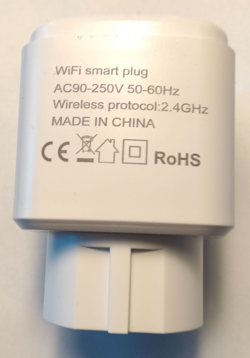

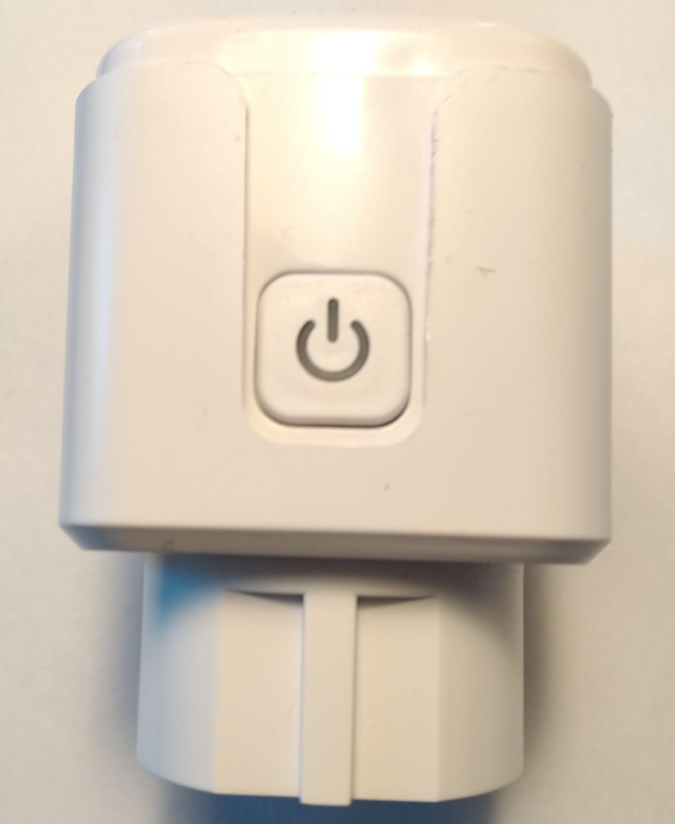

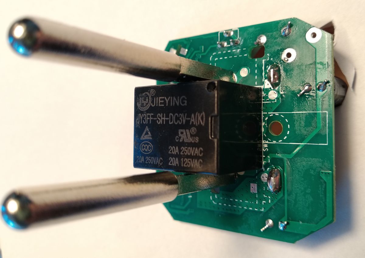

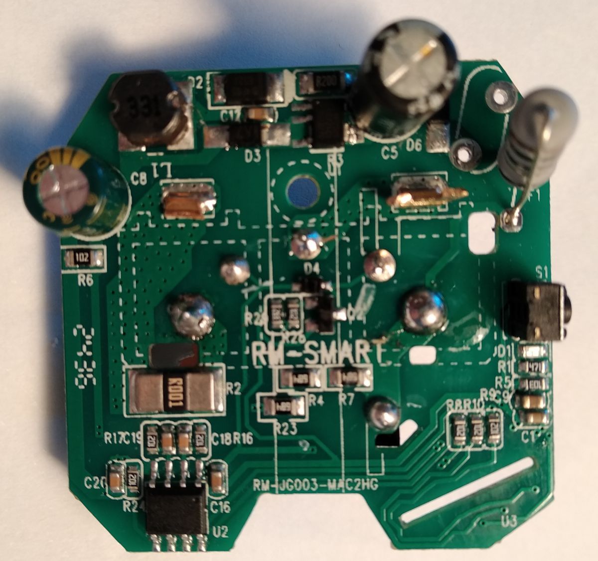

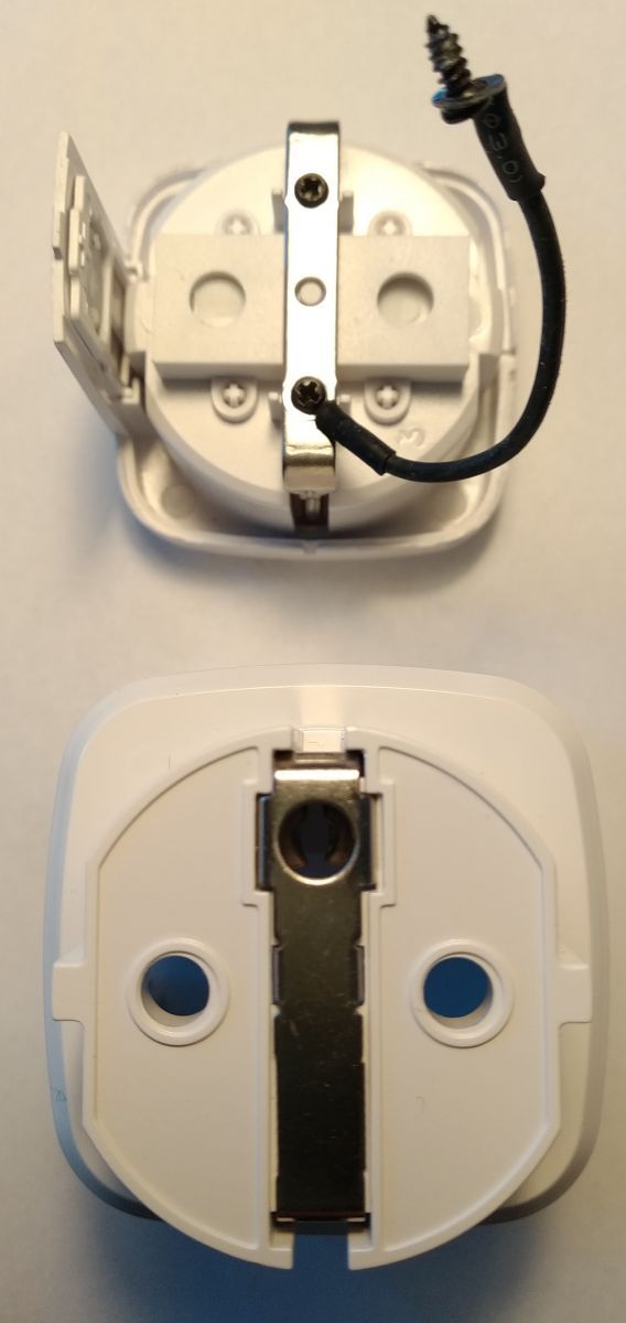

    Here's a generic EU wifi smart plug that @stefanmandl1 sent me a firmware dump and some pictures for. It is LSPA9-like but not labelled as such. The pin assignments do not match any other LN882H in the device list.
    White smart plug with a power button on the front. White Wi-Fi smart plug with technical specifications. Internal view of EU smart Wi-Fi plug Image of a PCB with a JIEYING relay on a smart Wi-Fi plug. Electronic circuit board of the RM-SMART Wi-Fi smart plug.

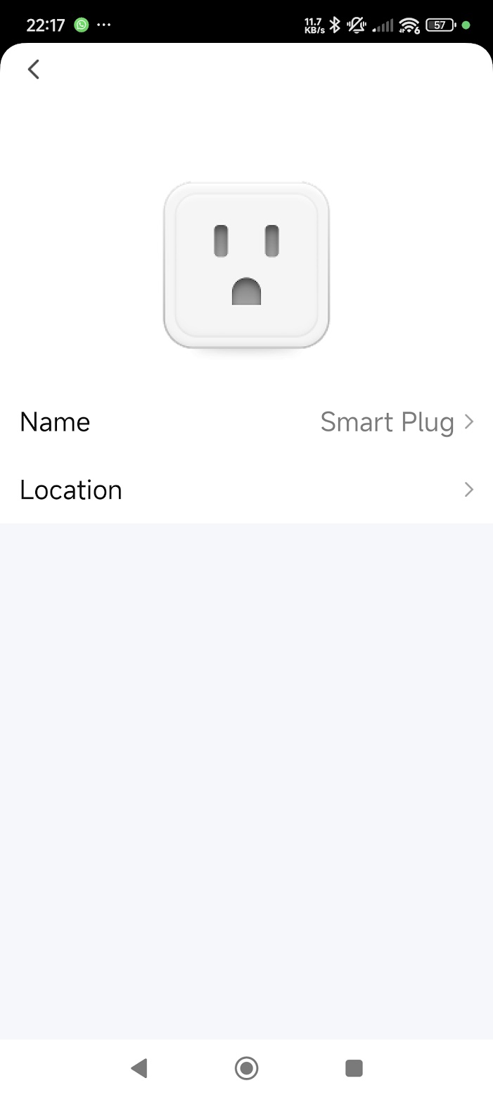

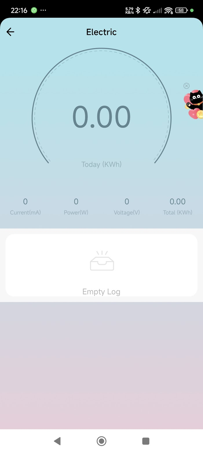

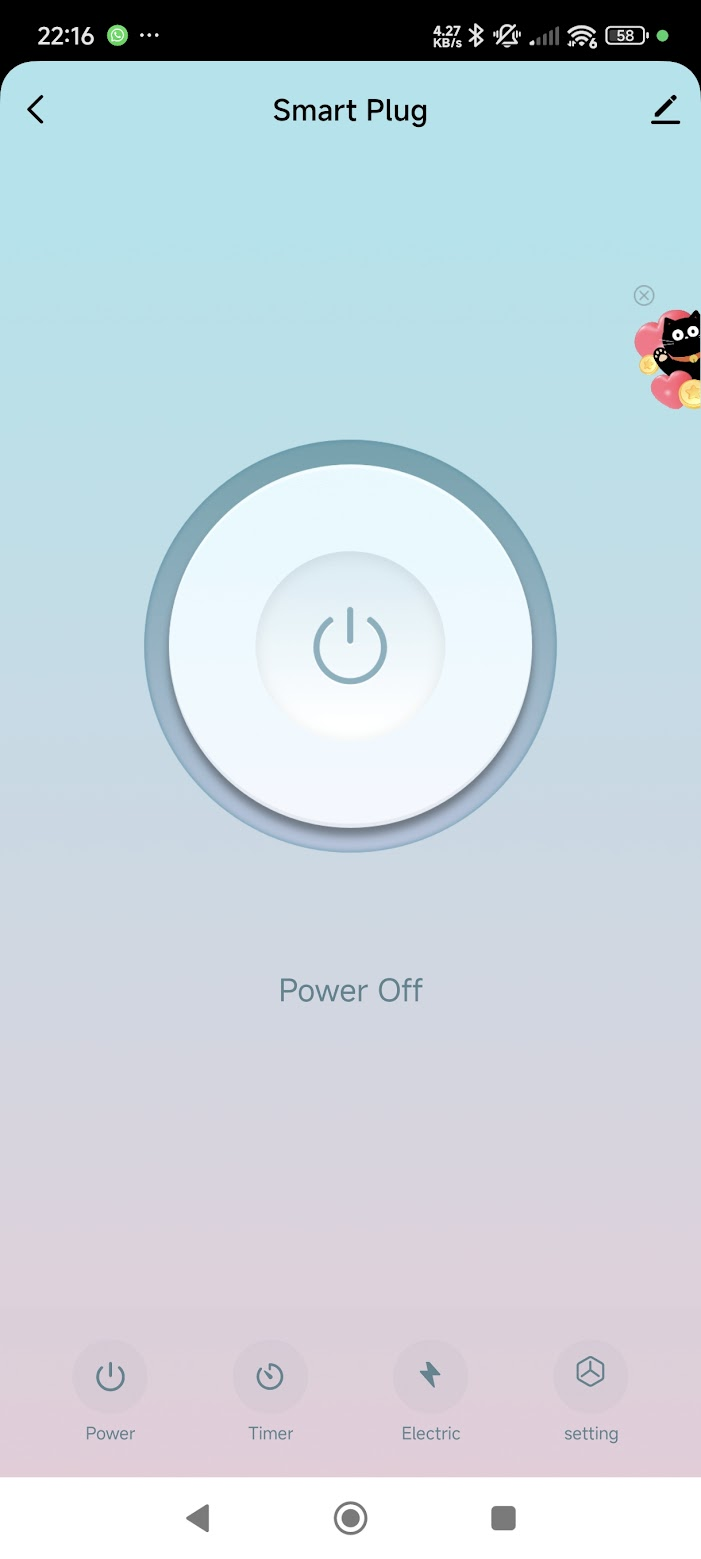

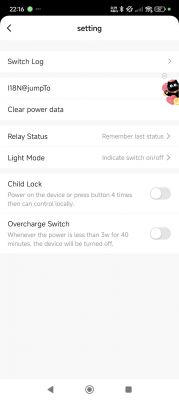

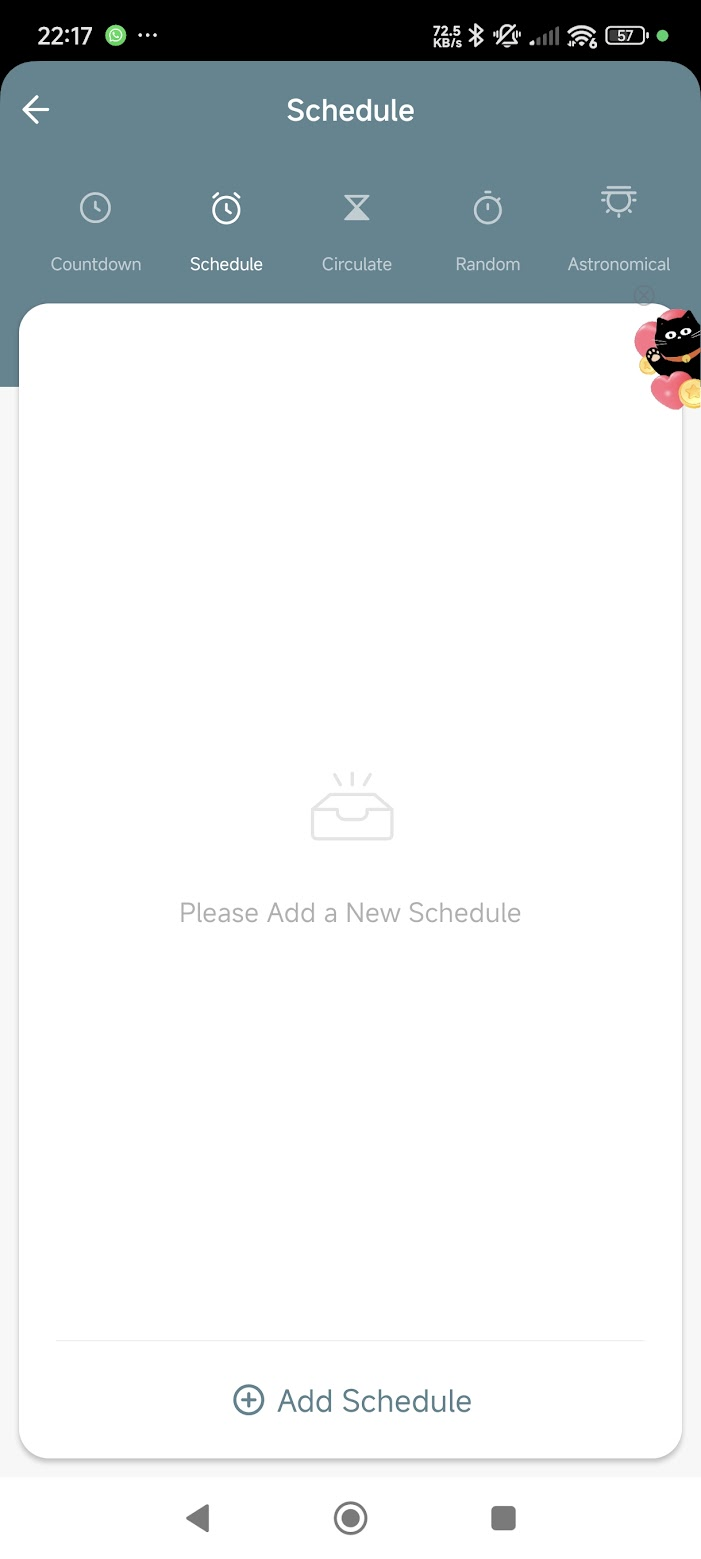

    Tuya app appearance
    Tuya app screen showing smart plug status with power on/off button. Screenshot of the Tuya mobile app showing electrical energy measurements. Screenshot of the Tuya app showing settings for a smart plug with options like switch log, language, clear power data, relay status, light mode, child lock, and overcharge switch. Tuya app screen with Schedule section awaiting the addition of a new schedule. Smartphone application interface with an image of a smart plug and options for setting name and location.

    LSPA9 but with LN882H? Nice. I hope it wasn't hard to open. I had multiple LSPA9s so far and some of them were glued very strongly, while other came off easily.

    I just realized that this plug is unique, as it has no 3.3V LDO and the power supply is providing 3.3V directly. The relay is also for 3V, it seems.
