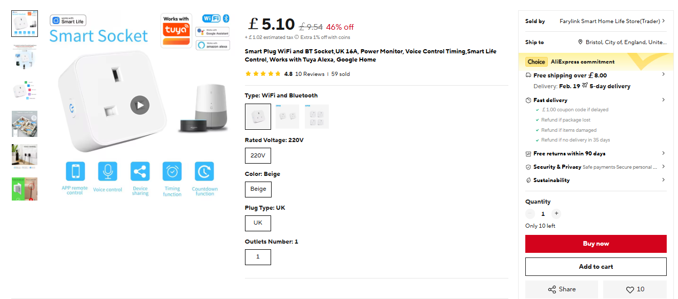

    This plug can be bought from Ali Express
    Tuya smart plug with energy monitoring available on AliExpress.

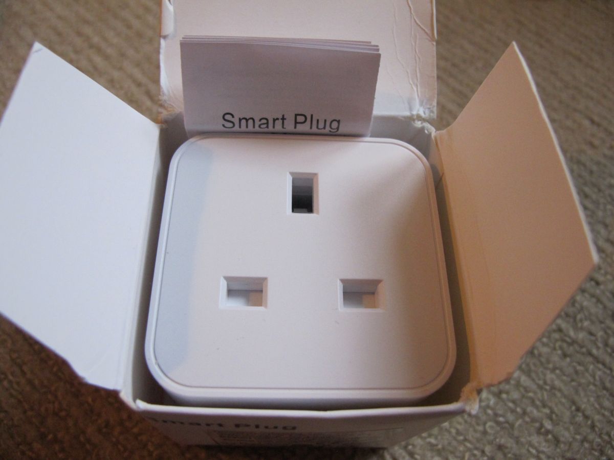

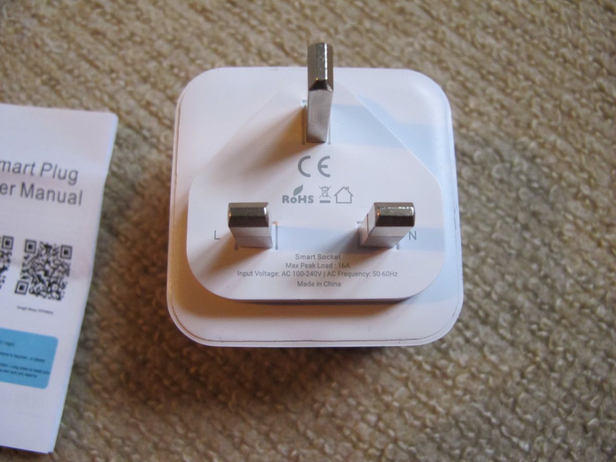

    Packaging and product externals:
    Close-up of a UK smart plug with electrical pins and specification label. Smart plug with three prongs and an instruction manual. Open box containing a Tuya smart plug, with the plug inside. Smart plug packaging with manufacturer details. Photo of Tuya smart plug packaging with a barcode.Smart device user manual. A smart plug user manual lies on the carpet, instructions are written in English.

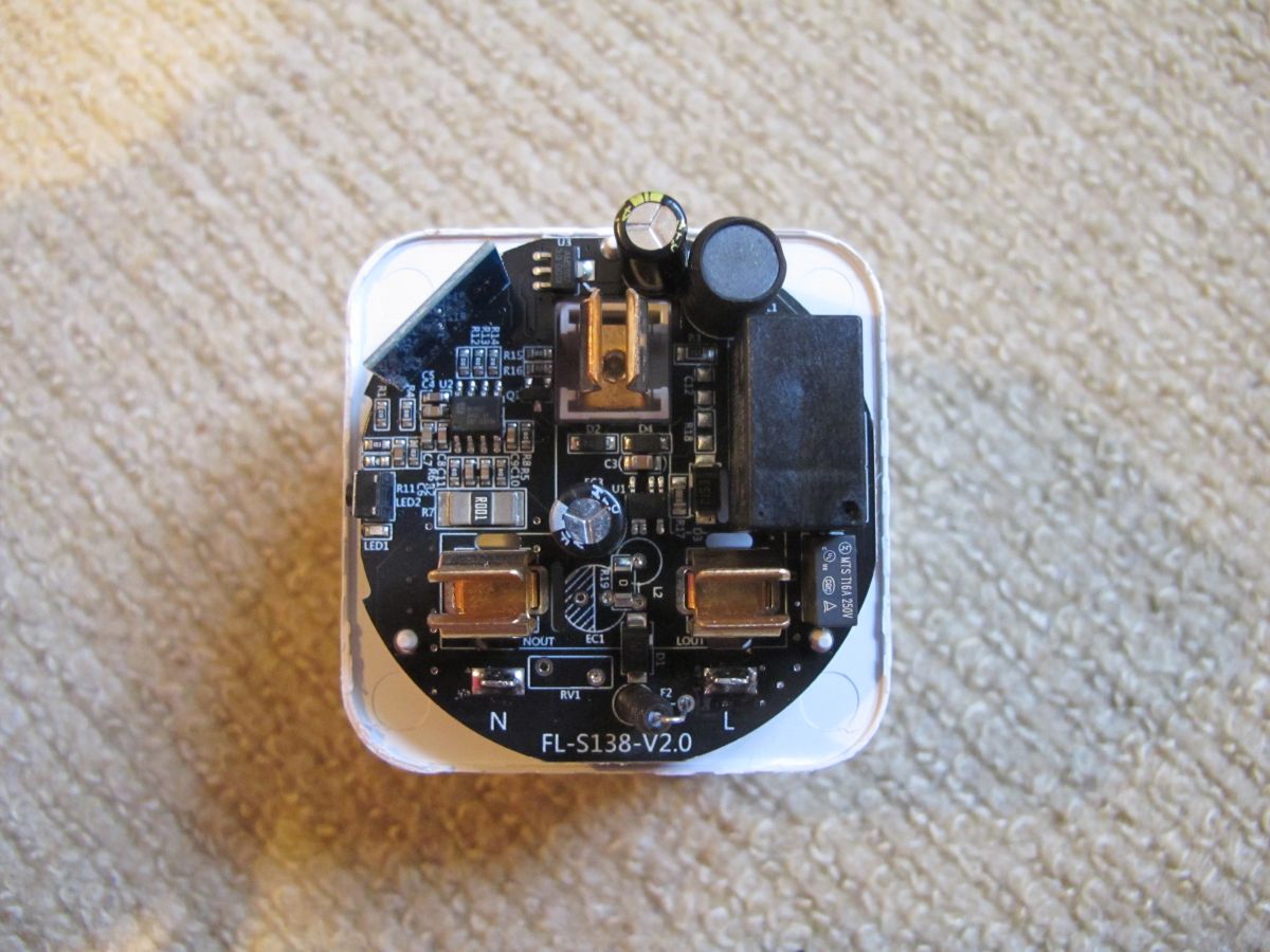

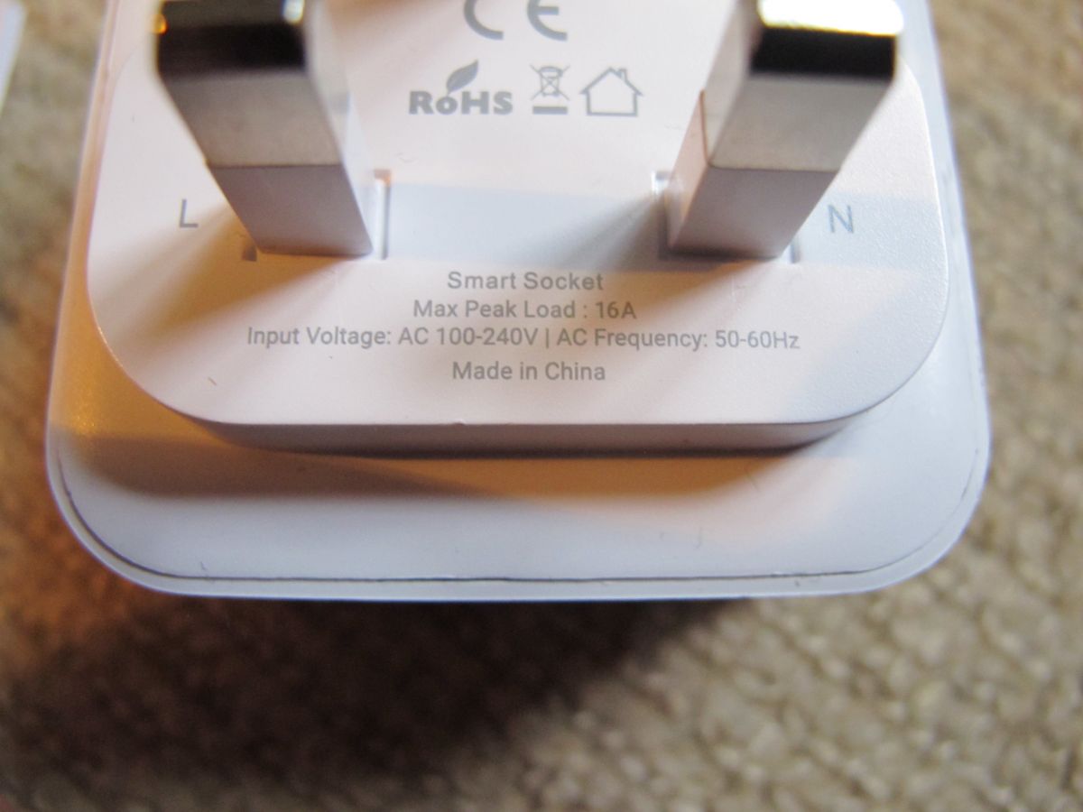

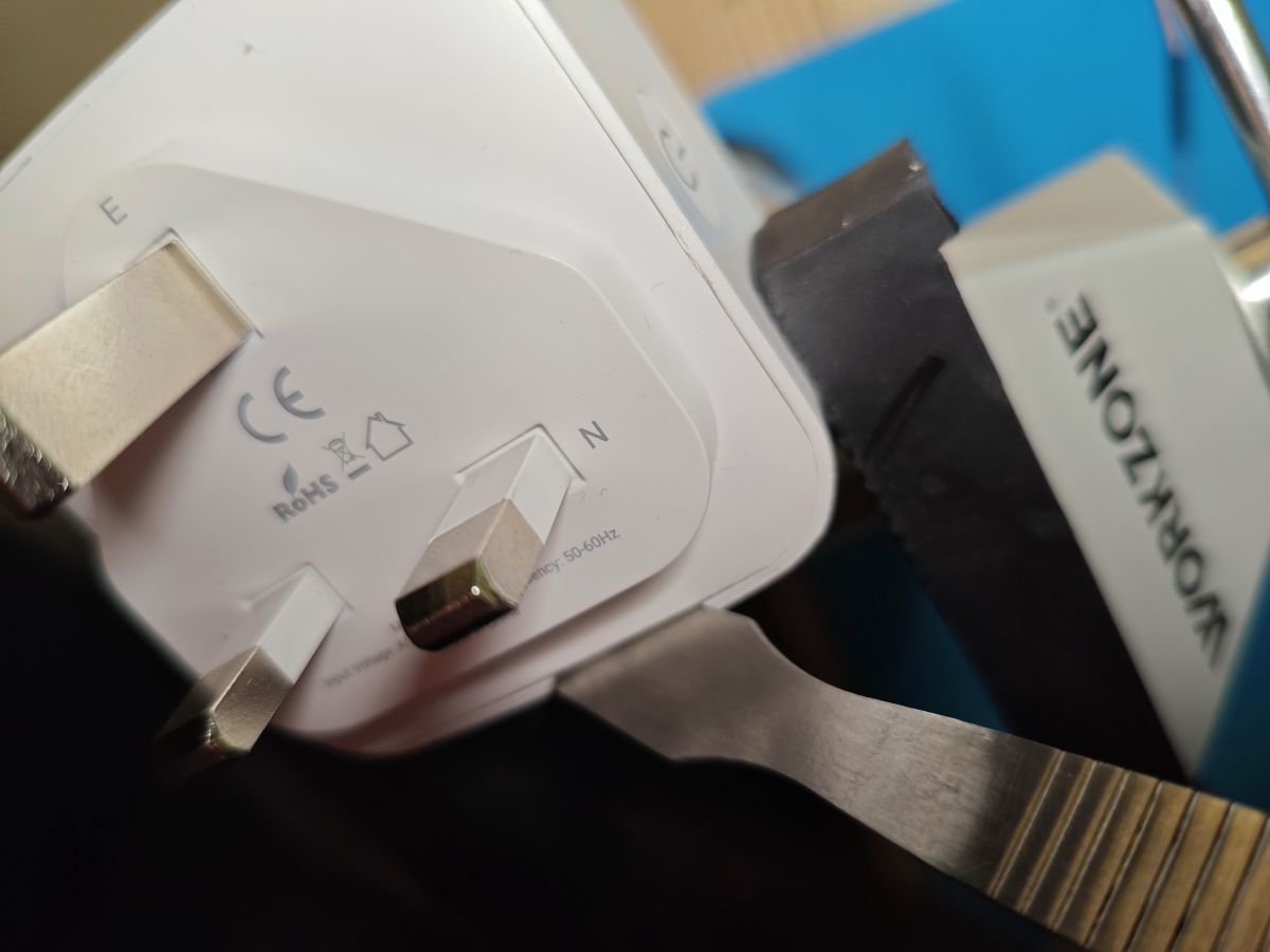

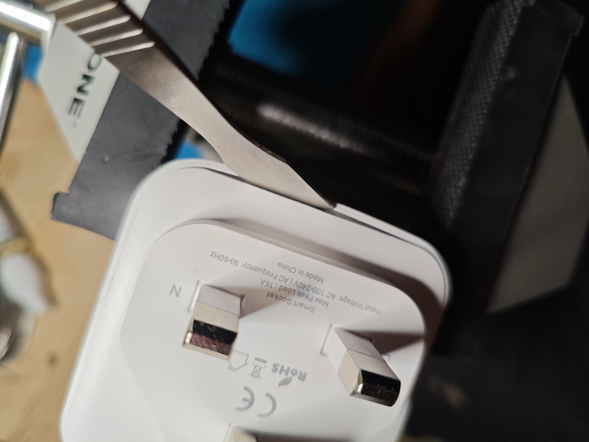

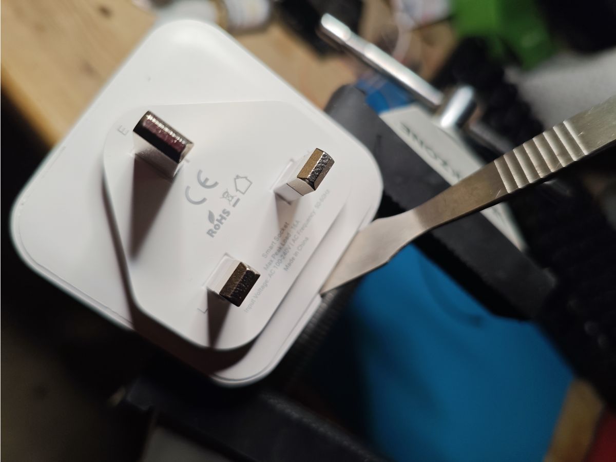

    To open, I trapped the plug in a vice below the joining lip/edge knowing that that's where the two main case pieces would be glued. With some decent, but not extreme, clamping the glue can be heard to give way and crack apart. A thin spudger helps it along. Rotate unit so different points are put under pressure until the glue is cracked in more places than not and the unit can be pulled apart by hand. My device was not glued well so this sample was relatively easy compared to some.
    Close-up of a white UK smart plug with a three-pin connector and visible CE and RoHS certifications. Tuya smart plug in a vise with a tool for opening the casing. Image of a three-pin electrical plug placed in a vise, partially opened with a tool.

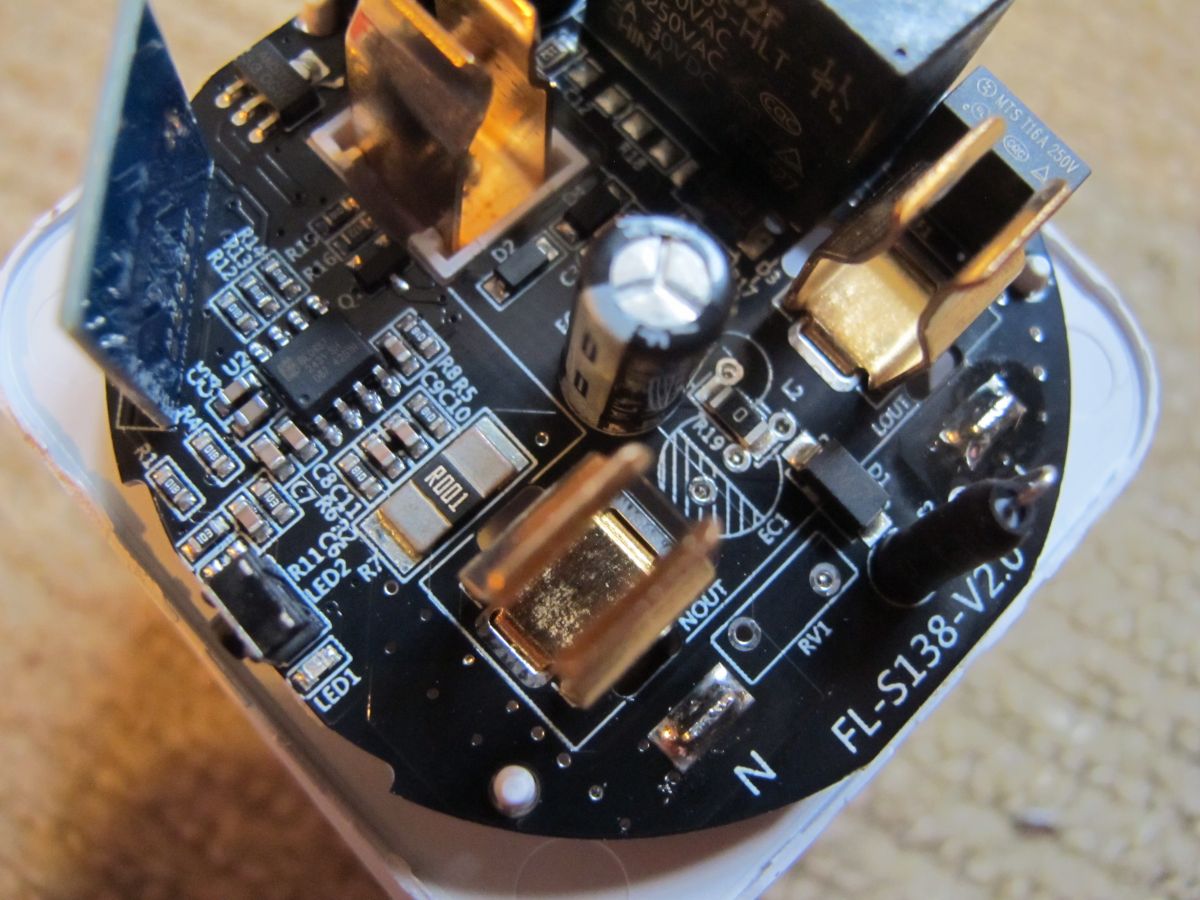

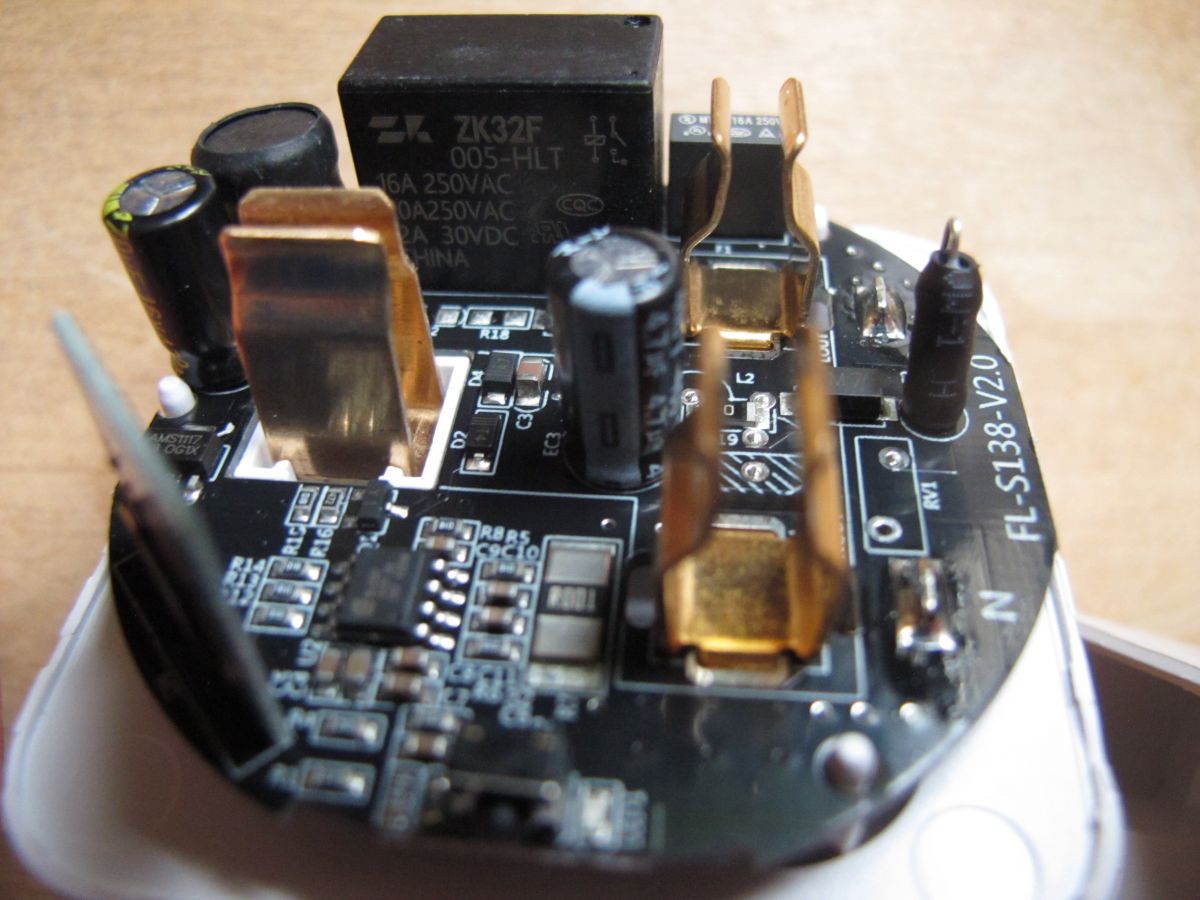

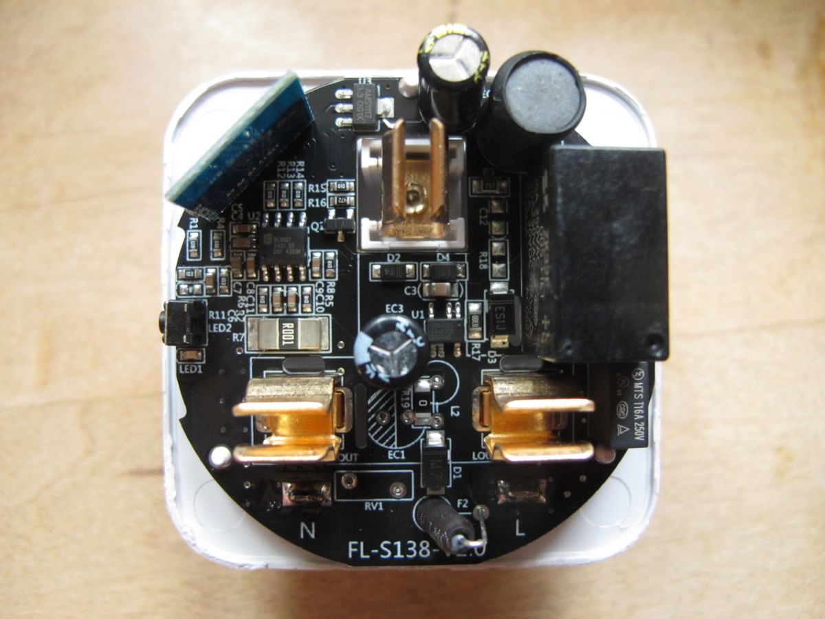

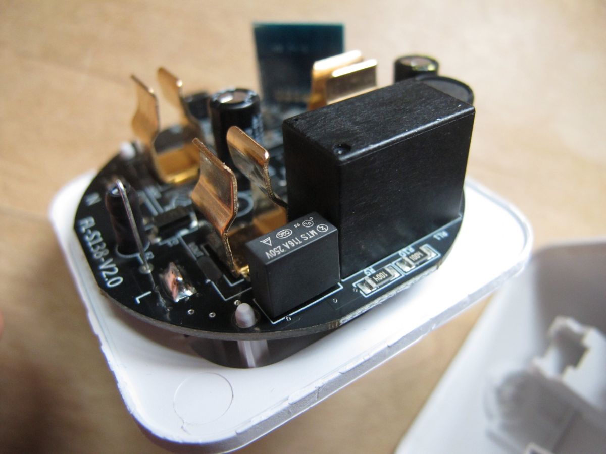

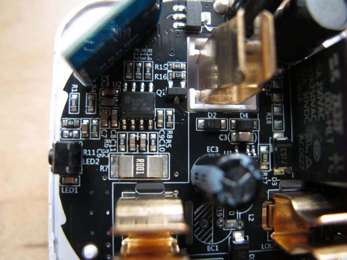

    Now that we're inside:
    Interior of a smart plug with electronic components on a circuit board. Interior of a smart plug showing the circuit board and components. Close-up of the interior of an electronic module labeled CB2S with Lightning LN882HKI chip. Interior of a smart plug with visible electronic components Close-up of the interior of a Tuya smart plug showing the module and components. View of the interior of a smart plug with electrical components on the PCB. Interior of a smart plug with electronic components on a circuit board. Close-up of a circuit board inside a smart plug with energy metering. Close-up of the interior of a smart plug with the FL-S138-V2.0 board.
    Some identified main components of interest:
    Belling BL0937 energy metering chip
    FL-M118-V1.1 Lightning Semi Conductor LN882HKI module
    ZK32F 005-HLT 16A@250VAC Shenzhen Zhongke Zhilian Electronics Co.,Ltd. relay
    Main PCB marked as FL-S138-V2.0
    AMS1117-3.3v linear voltage regulator

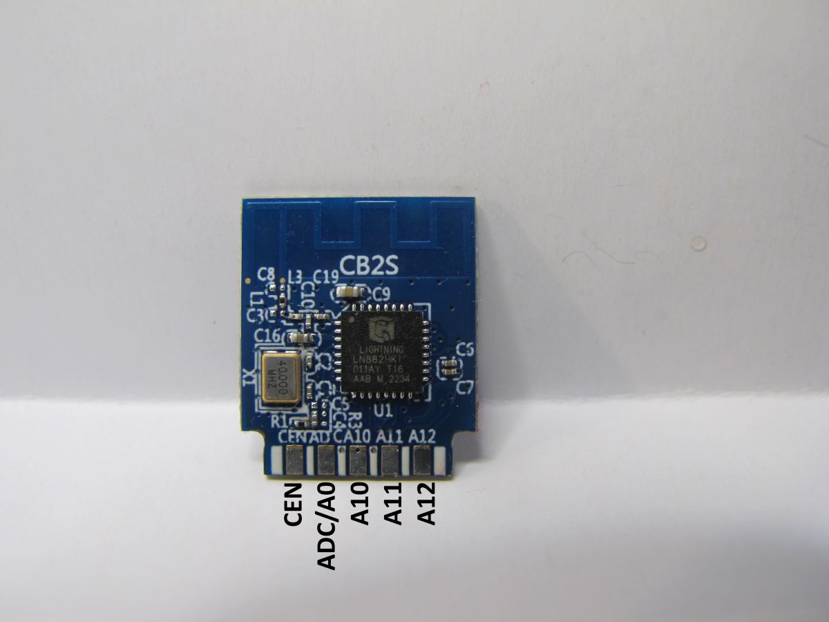

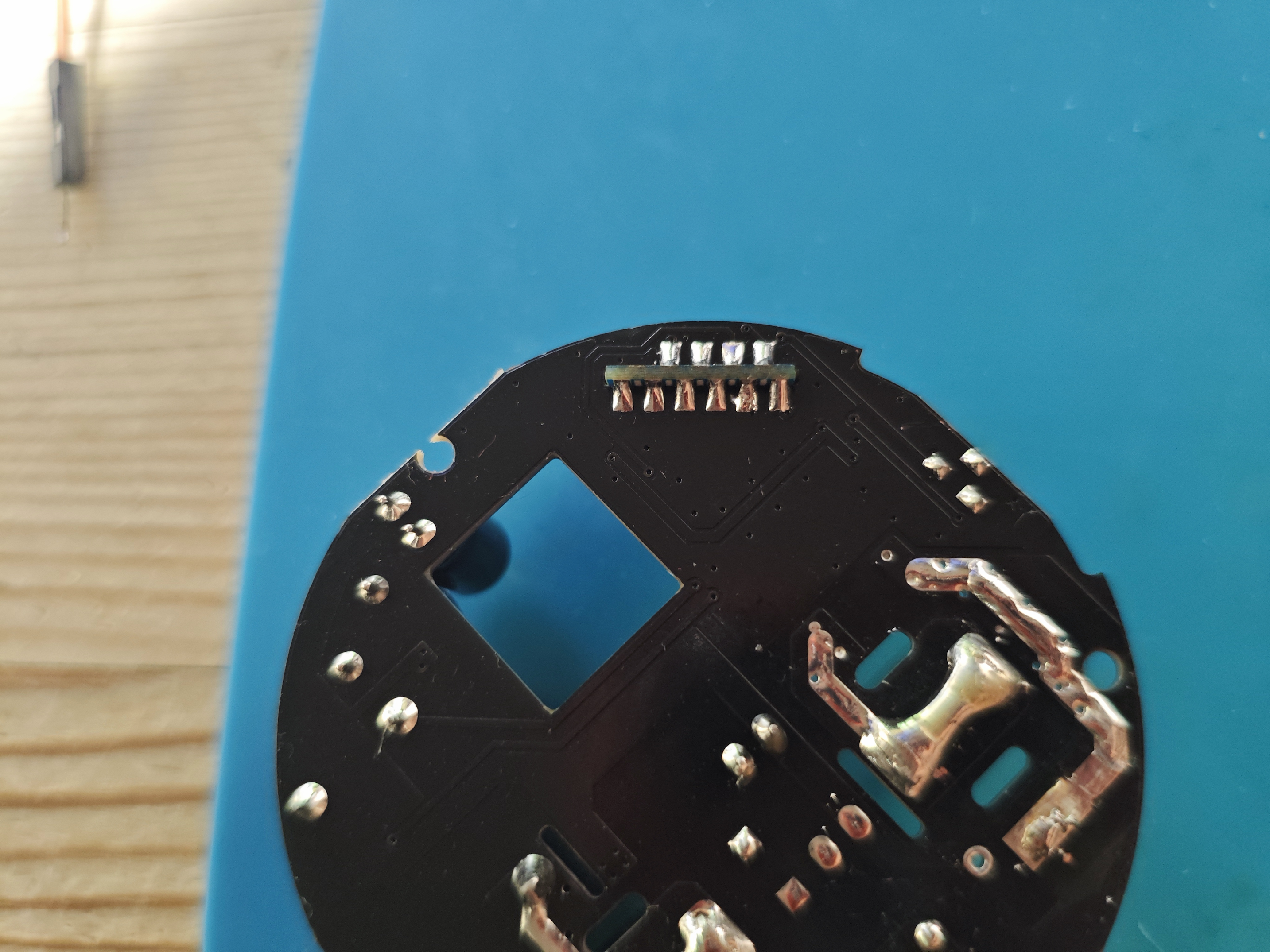

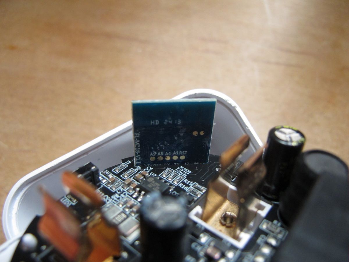

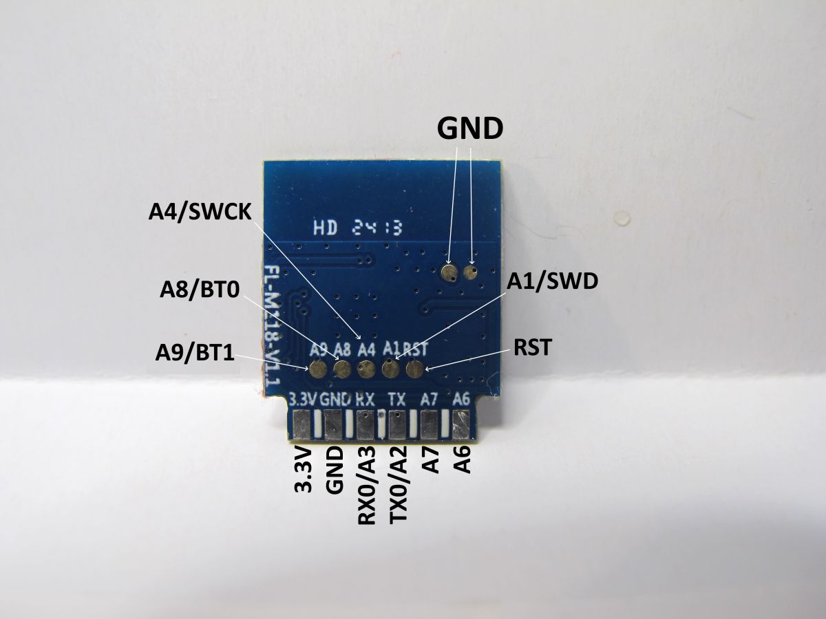

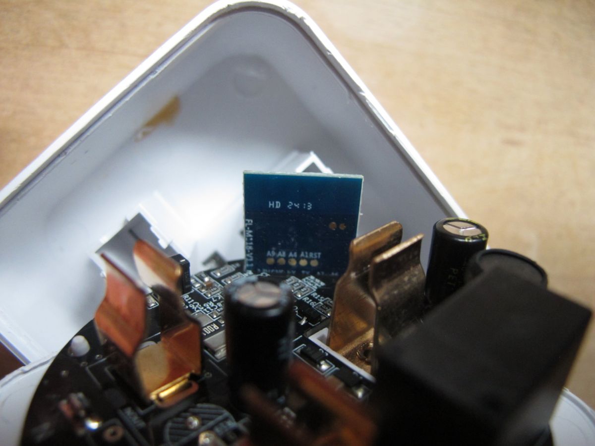

    The FL-M118-V1.1 module is what we need access to. We need to get to certain contacts on the module to be able to take a backup of the Tuya factory firmware and flash OpenBeken (OpenLN882H).

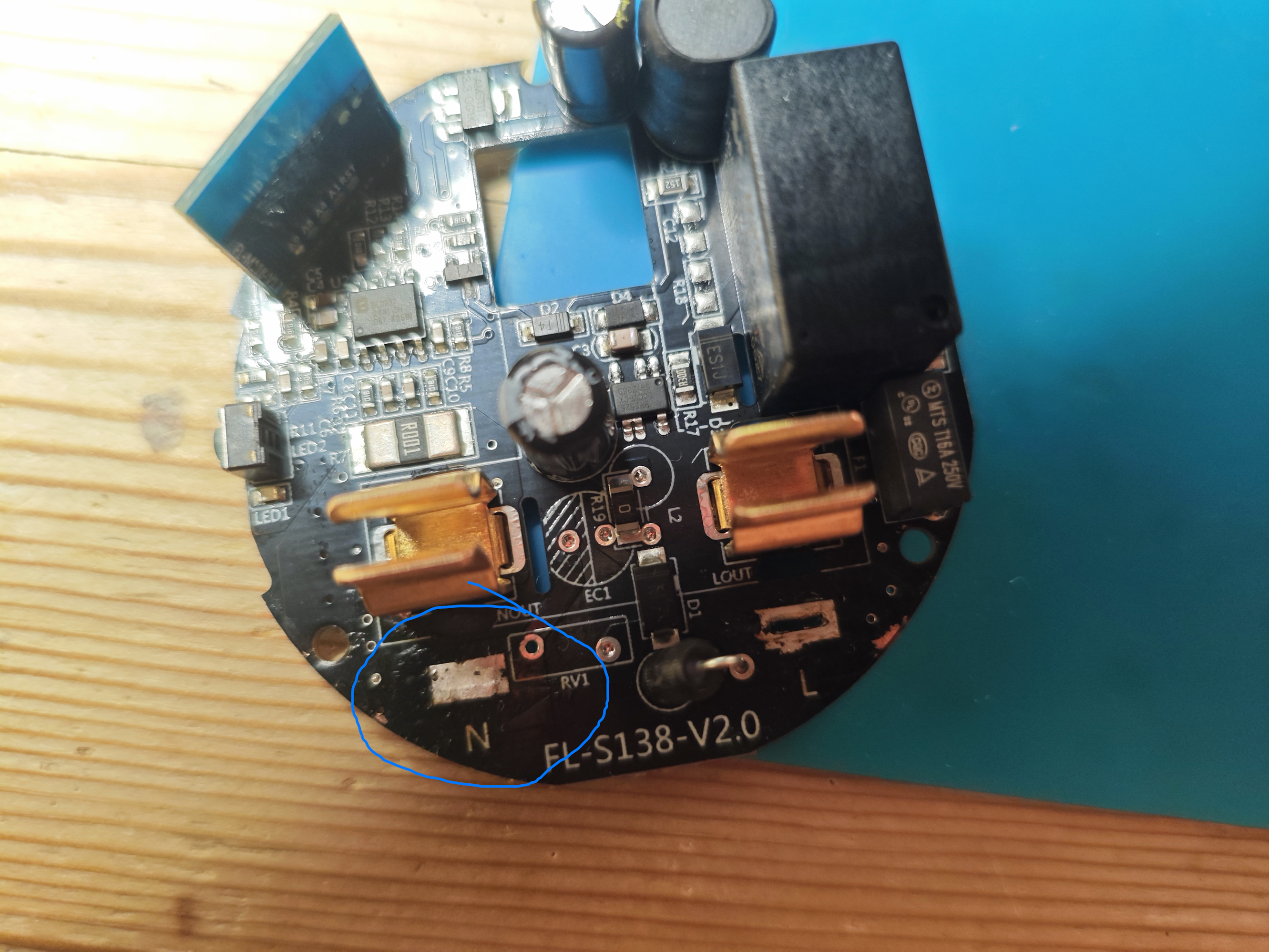

    Unfortunately RX, TX, 3.3v and GND module contacts are at the rear underside facing the centre of the plug - inaccessible without de-soldering the main PCB from the power prongs.
    Close-up view of the CB2S module mounted on a PCB inside a smart plug.

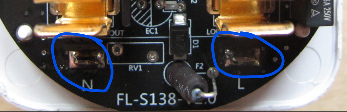

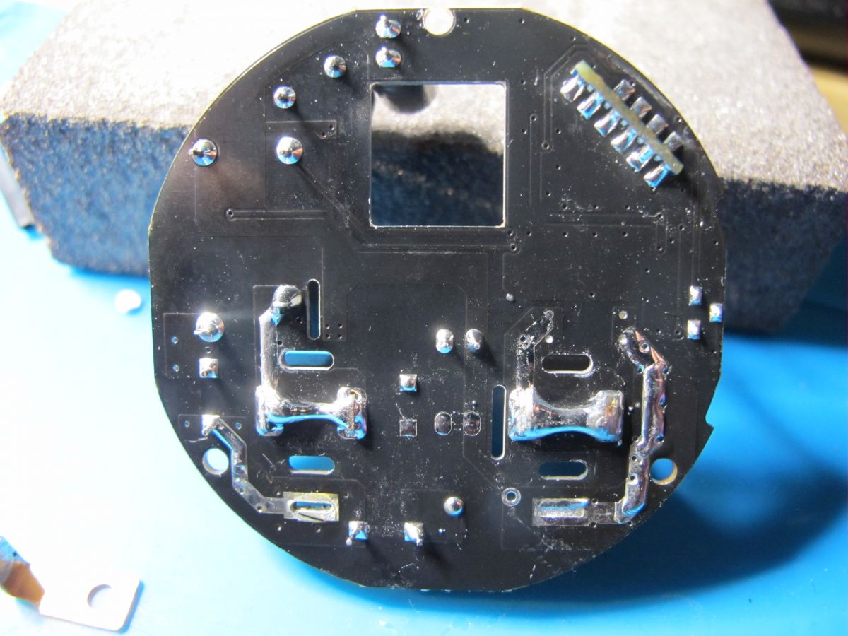

    To de-solder I added some flux to the solder points and then melted some 63/37 pb solder into the mix to reduce the melting point of the solder used by the factory
    Close-up of the main circuit board of a smart plug with highlighted solder points.
    This process was laborious because the whole power prong draws heat away from the solder point quickly, meaning it has to heat up a lot to get to melting point. Solder wick was used to soak up most of the solder but some stubborn bits remained - keeping the unit fixed in place. Switching sides slowly inching each upwards when melted was the solution.
    With the main PCB free the FL-M118-V1.1 can be de-soldered also using wick/pb/flux.
    Bottom of the smart plug's printed circuit board.

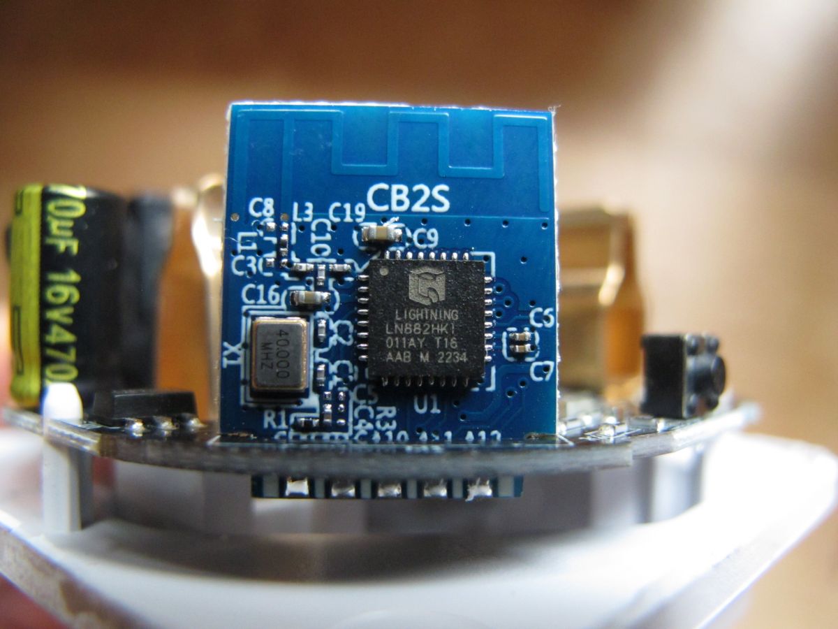

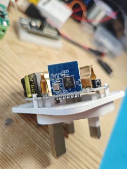

    The "CB2S" label is...interesting. "CB2S" is of course usually reserved for Beken BK7231N modules . This LN882H is a drop-in pad-compatible replacement for CB2S, so maybe that's the link trying to be made. I've labelled all pads for clarity:
    CB2S module board with LN882HKI chip View of the FL-M118-V1.1 module with labeled pins.

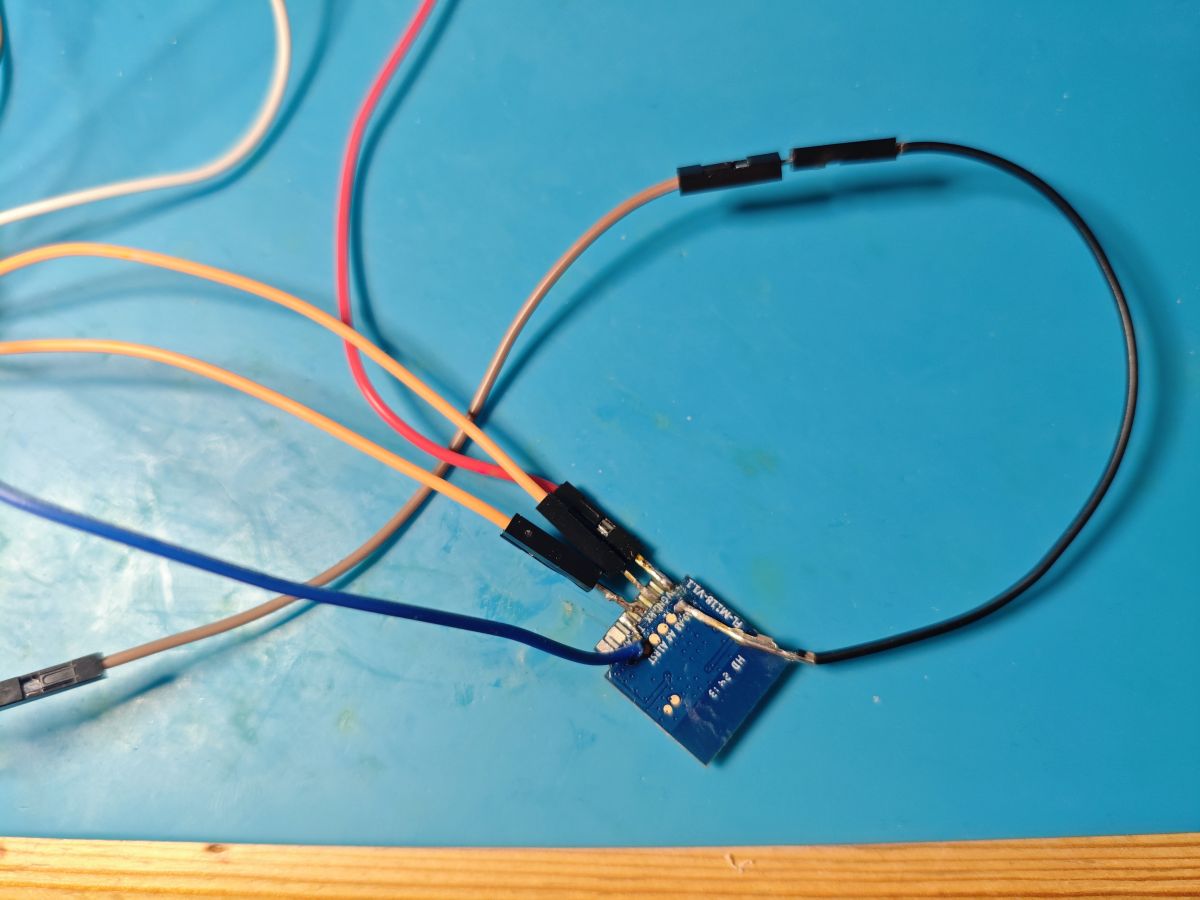

    RX/TX/VCC/GND and A9 (needs to be grounded for the flashing boot mode) all soldered ready:
    Electronic module with connected wires on a blue surface.
    Connect to USB-TTL UART adaptor as:
    USB-TTL RX -> Module TX
    USB-TTL TX -> Module RX
    External 3.3V PSU (XL4015 in my case) -> Module 3.3V
    USB-TTL GND + Module GND + A9 + PSU GND (all common ground)
    Insert USB adaptor then power on PSU. Using the attached flashdumper.py script in the attached zip the following was run to start the backup

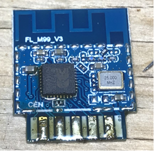

    Notes since initial draft

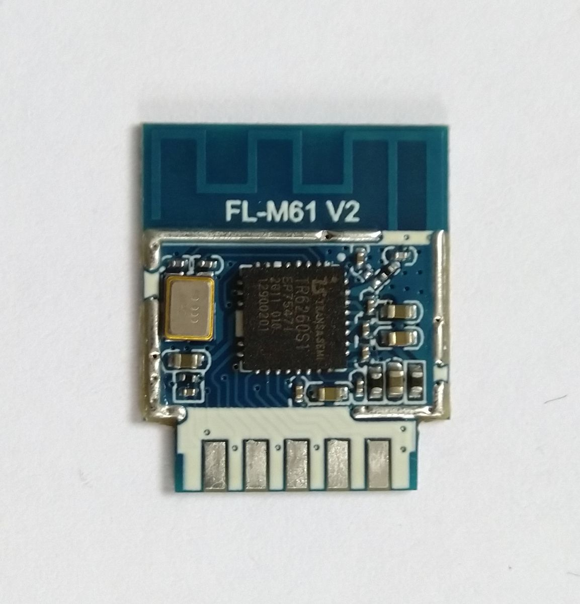

    I note that the main PCB Marking starts FL- (FL-S138-V2.0) as does the marking on the module (FL-M118-V1.1). The name on one of the stickers on the box is for a Shenzhen Farylink Technology Co.,Ltd. It would be reasonable to assume FL = Farylink, also the store on Ali Express it was bought from. I don't think it would be a stretch to assume similarly-named modules like the FL-M61 V2, FL_M99_V1/2/3 are all Farylink.
    Electronic module with an integrated circuit and soldered components FL-M61 V2 module with visible IR620S1 chipset.
    How to flash FL_M99_V1/FL_M99_V2/FL_M99_V3/CB2S WiFi module - BK7231N Tuya Home Assistant guide
    https://fcc.report/company/Shenzhen-Farylink-Technology-Co-L-T-D
    UART boot log B9 is not routed out to a pad on the module so I had to use my sewing needle probe to capture the log, which is:

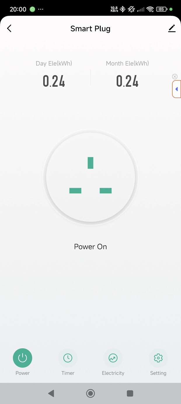

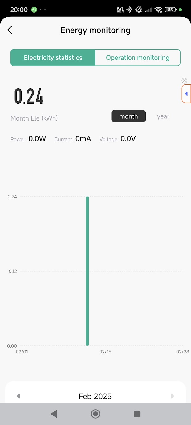

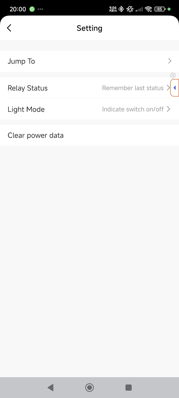

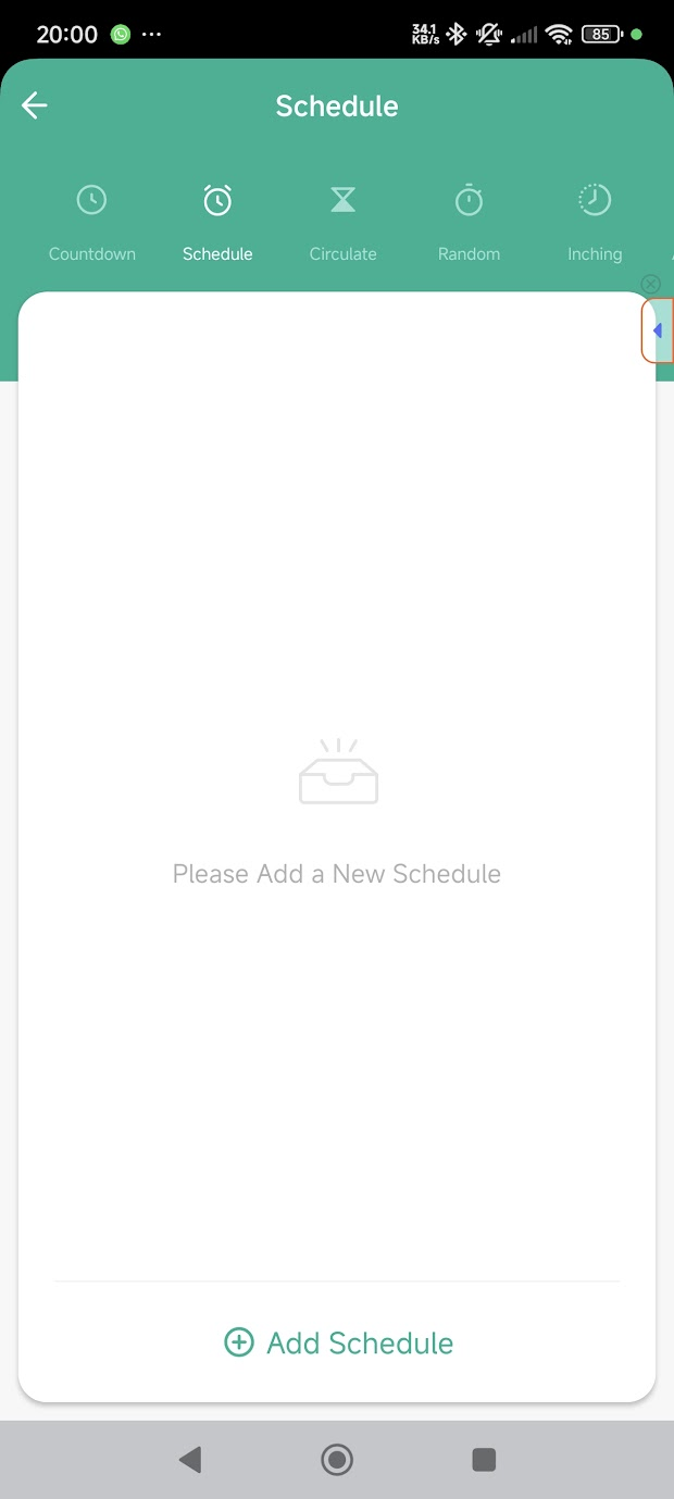

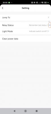

    Tuya app paired device pics
    Tuya app screen displaying smart plug energy usage information. Schedule screen in Tuya app with the option to add a new schedule. Screenshot of the Tuya app showing energy monitoring. Screenshot of Tuya app settings for a smart plug.

    This is the first time I see CB2S module with non-Beken chip. So far I've only seen like 3 types of CB2S:
    - original CB2S (the most common one)
    - CB2S with BK7231M (different Beken keys, now supported by OBK)
    - CB2S with incorrect silk screen (wrong VDD, GND, UART placements)
    And your CB2S is now the fourth kind, interesting. This may certainly confuse beginners.

    maybe it's their way of marking it as a CB2S replacement for interchangeable use internally within their product dev team? Dunno.
    What's also confusing, and I forgot to mention in the notes, is that the boot log looks like it contains all the pin assignments. eg:
    but they don't line up with the correct GPIO# or IC pin# so 🤷🏼‍♂

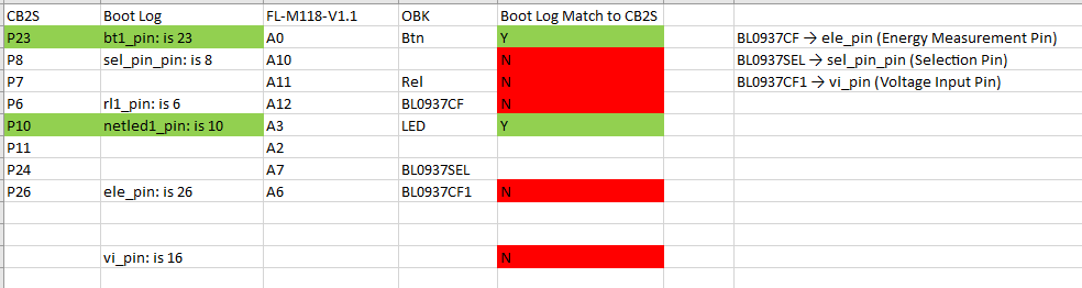

    Do they match with the pin indexes as if it were a true BK7231N module? I mean, is the P23 on BK7231N CB2S location the same as bt1_pin here?
  • #5 21437530
    Posts: 5212
    Help: 446
    Rate: 914
    good question! that would make sense.
    it started to look like that was the answer, until..
    Comparison table with columns related to Boot Log, FL-M118-V1.1, OBK, and Boot Log Match to CB2S.

    but wait, LN882H has pins in port + index format:
    https://github.com/openshwprojects/OpenBK7231T_App/blob/main/src/hal/ln882h/hal_pins_ln882h.c
    Code: C / C++
    and OBK mapping (indexes) is our own idea, maybe Tuya has there a different table order
