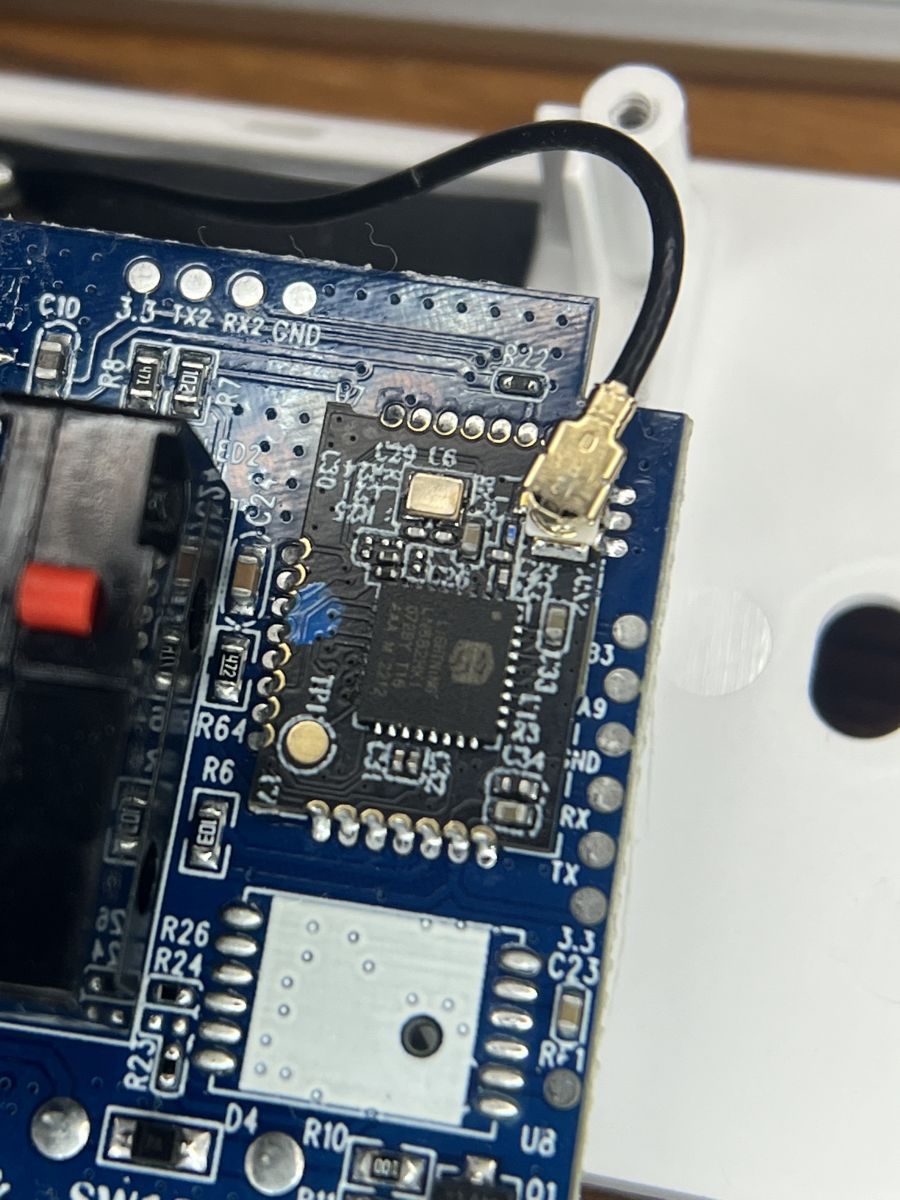

    LN882H SMD board...reaching the boot pin for flashing
    I have an LN882H attached to a board that apparently connects the wifi antenna of the smart switch among other things. That host board is attached via SMD pads to the PCB, so not so easy to find the boot pad on the back of the LN882H board. My question was one of access to that pad....but I may have answered my own question, given access (apparent in the image) to a pad for GPIOA9. I think that maps to boot.... open to thoughts or comments. I hope so, because that would make things a lot easier.

    AI: Do you have access to the schematic or datasheet for the LN882H board to confirm if GPIOA9 is indeed the boot pin?
    No
    AI: Could you share your level of experience with electronics and flashing procedures to better tailor the advice?
    intermediate

    Determined that GPIO pad A9 maps to Boot
