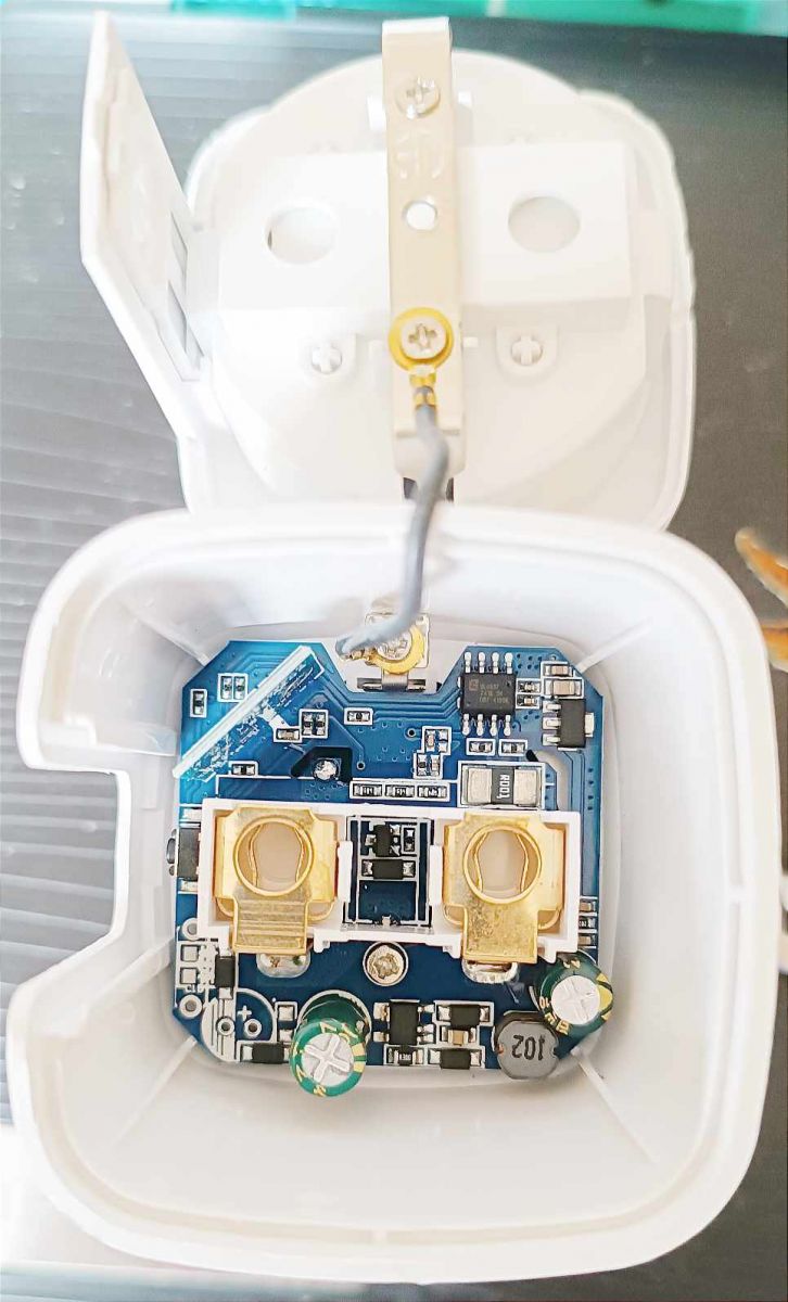

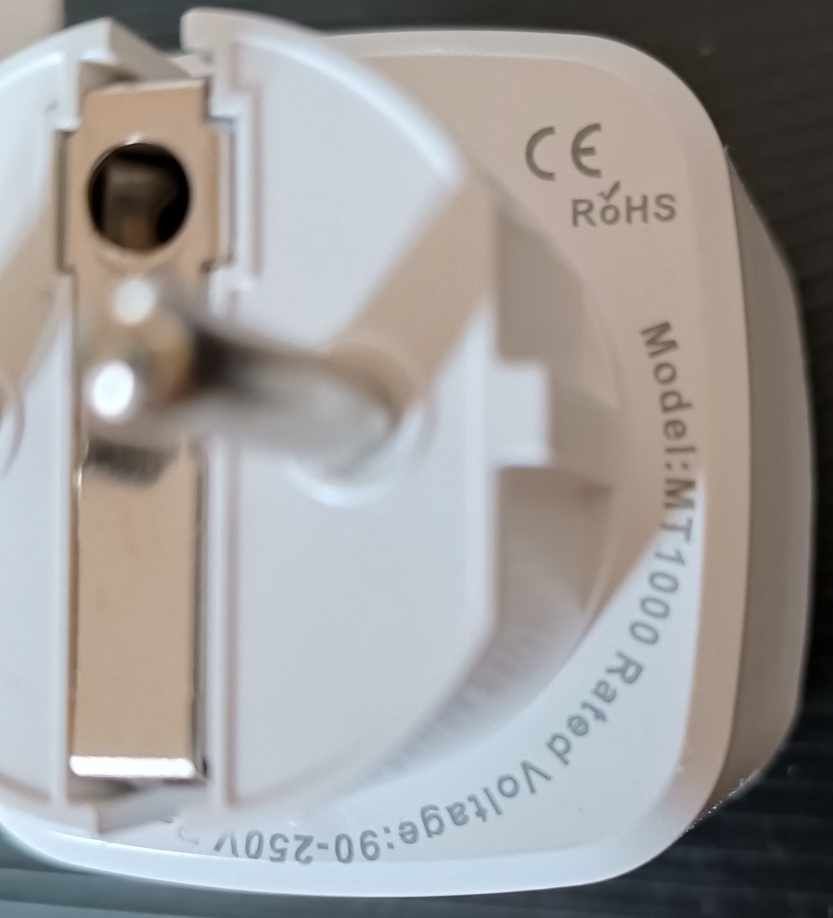

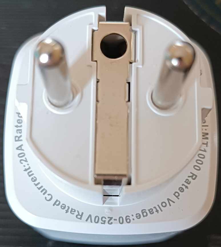

    Here I show you the teardown of just another LSPA9 housing.
    I opened it with my door of course 😂
    https://www.elektroda.com/rtvforum/topic4052105.html

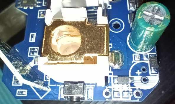

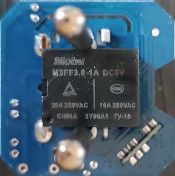

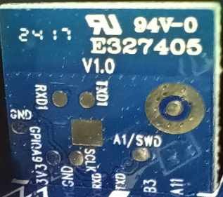

    After I de-soldered the sub PCB I can connect some thin wires to the connection points I need to flash the device.

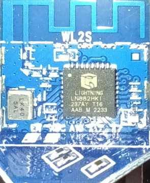

    The sub PCB is the new one WL2S with the Wi-Fi chip LN882H.
    This chip needs to flash a permanent ground connection at the pin A9, you can also find this point for soldering on the sub PCB.
    The following description to flash this chip works very well.
    https://www.elektroda.com/rtvforum/topic4028087.html
    Used the described tool to flash the device with my Windows machine.
    https://www.elektroda.com/rtvforum/download.php?id=1205991
    But I need to screw down the serial speed to get a working connection.
    LN882H_CMD_Tool.exe COMx download flash 921000 0x0 flashimage.bin
