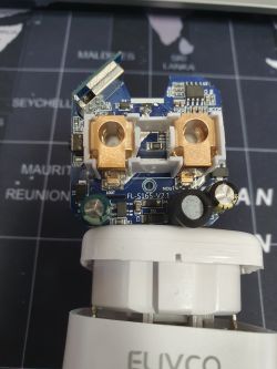

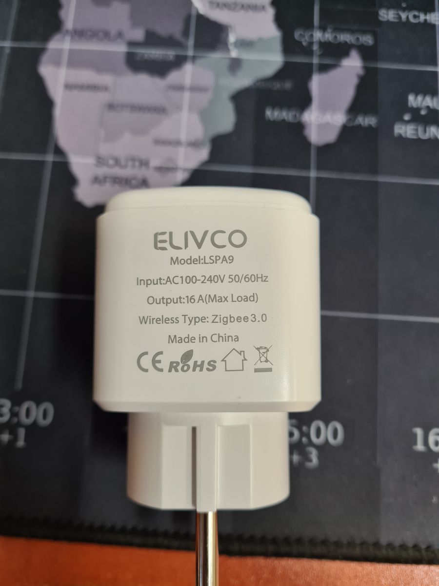

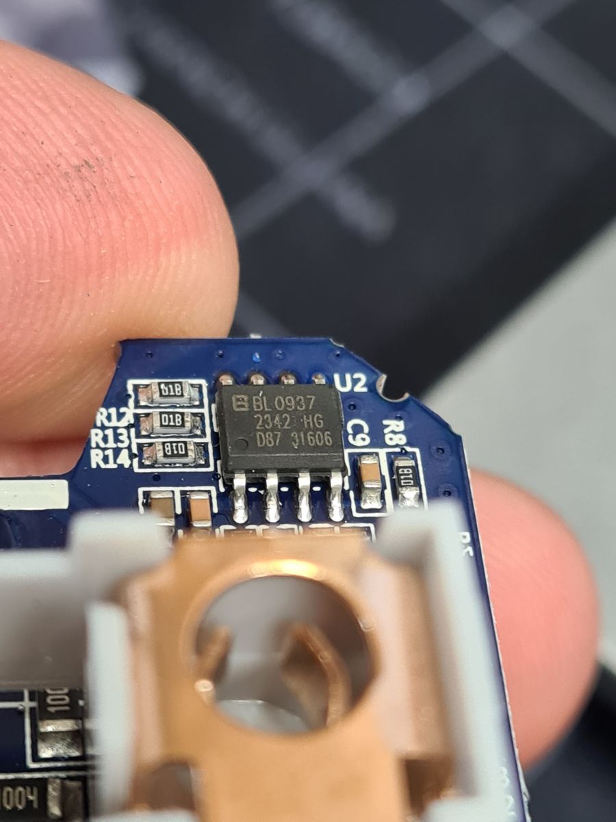

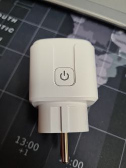

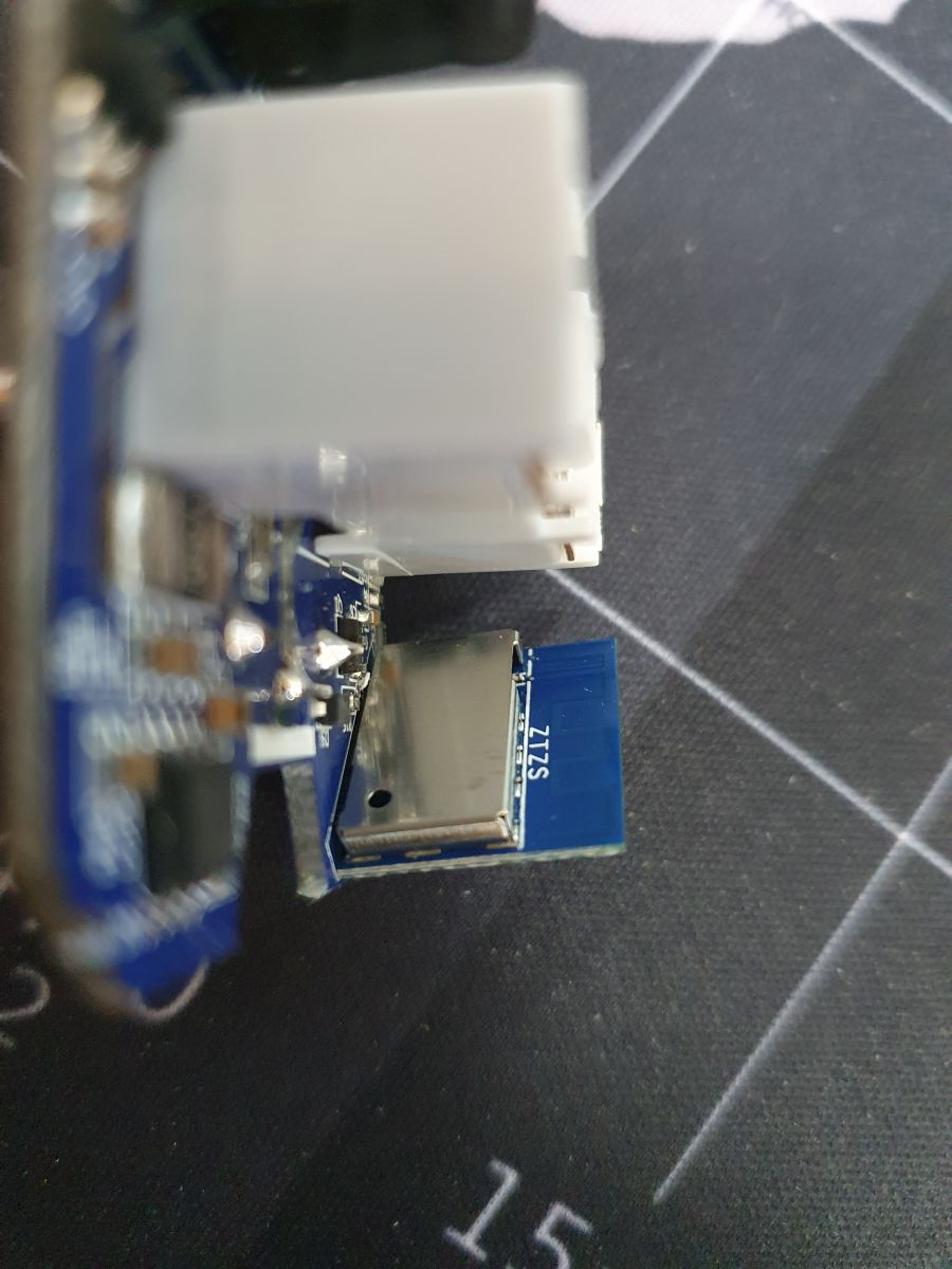

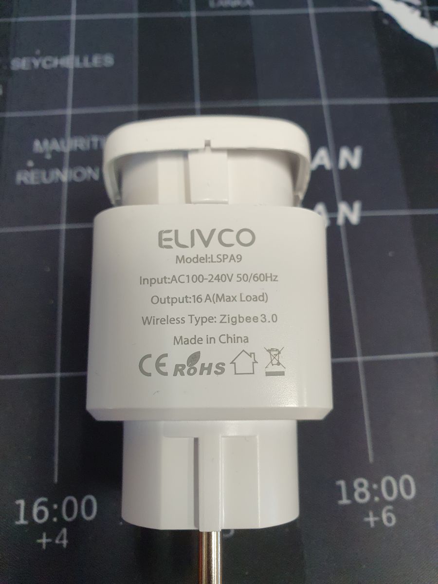

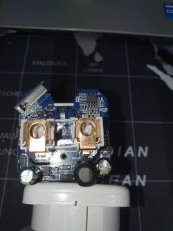

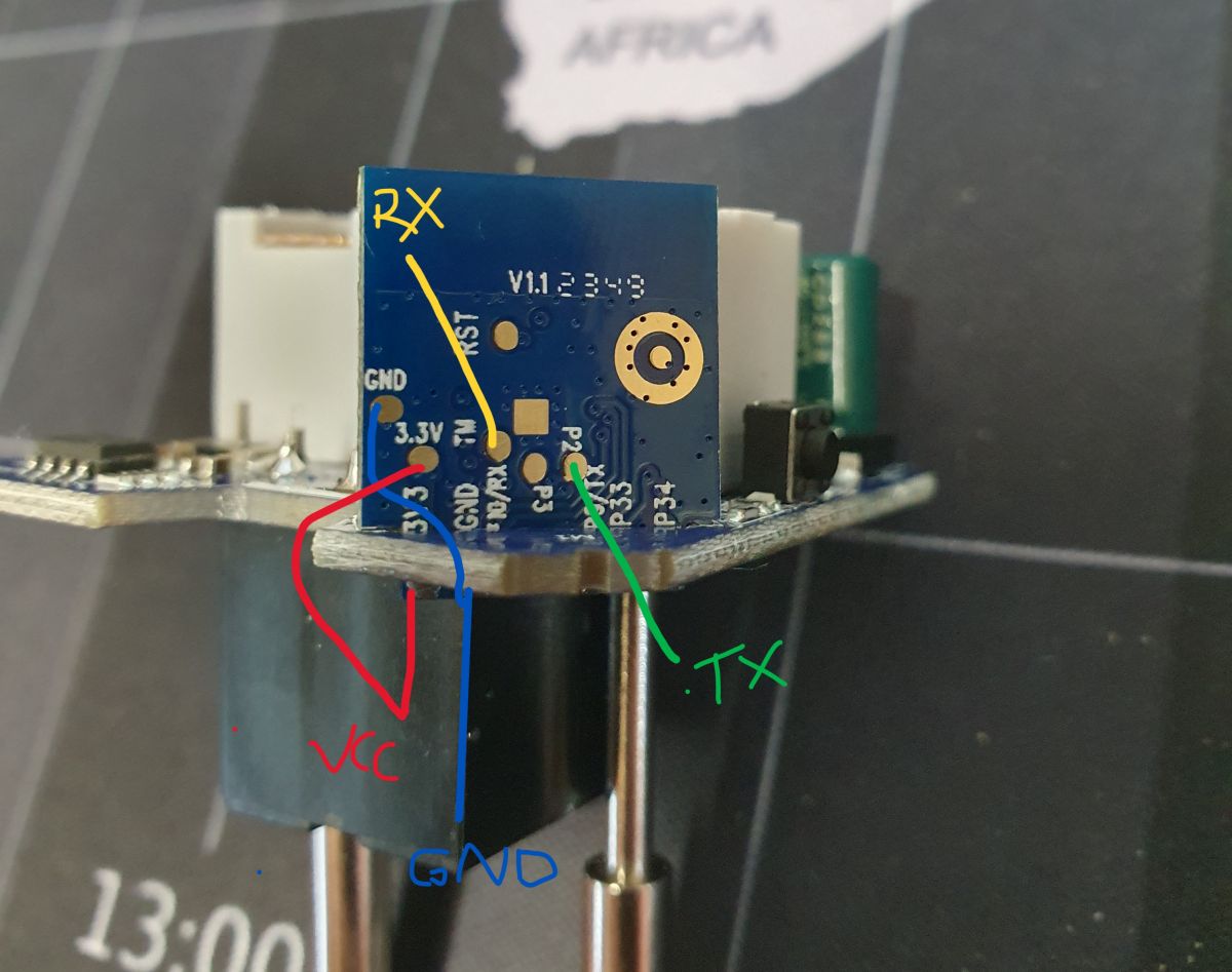

    Hello, I have a new socket marked LSPA9, with BL0937 for voltage measurement, but without any markings on the wifi module, except ZTZS (photos). I am looking for the Boot pin to connect the programmer (I marked the others, judge if they are correct).

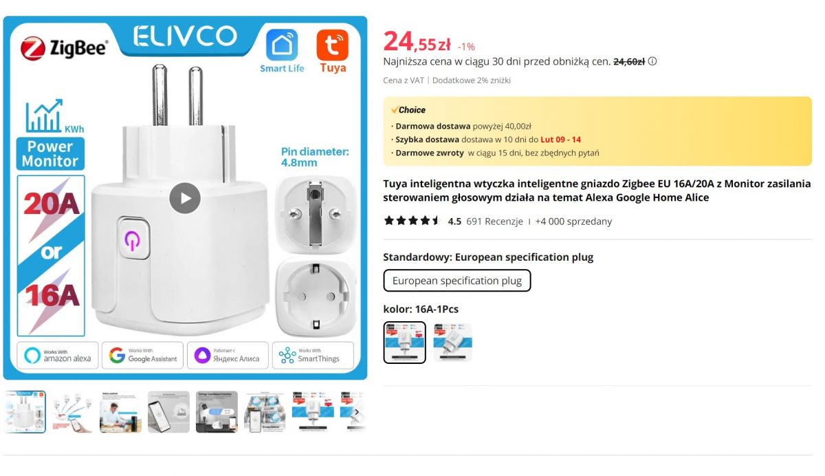

    Your socket is Zigbee based, this is evidenced by the writing on the casing (Wireless Type - Zigbee) and the ZTZS module.
    It is not likely that you can change its firmware, it connects to a Zigbee hub or Home Assistant via a Zigbee dongle.
    If you absolutely want it on WiFi, the entire WiFi module would have to be changed.

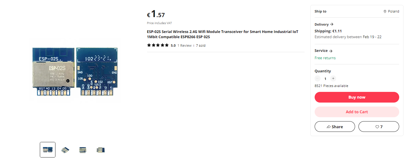

    How about ESP? Only you'll be waiting a long time for shipping.
    ESP-02S 2.4G WiFi module for smart home with price and shipping options .

    If I use ESP02S then I don't need to upload OpenBL anymore just Tasmota normally, yes?

    Send a link to the listing where you bought and post a screenshot from it too (because links expire and then the discussion loses its point), maybe it really is a seller error. If so, you can report the problem and get some of the money back. I don't know where you bought, but I've never been left without a partial refund by the Chinese.
    On the ESP upload Tasmota.

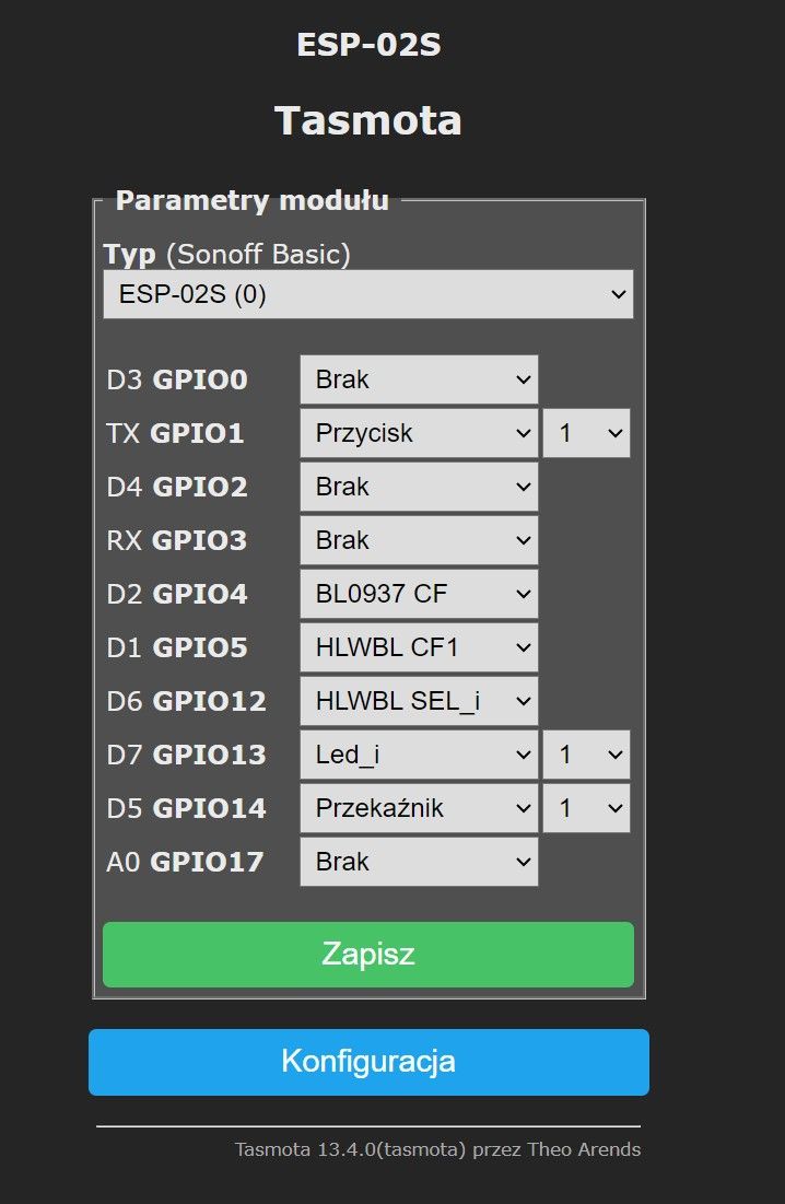

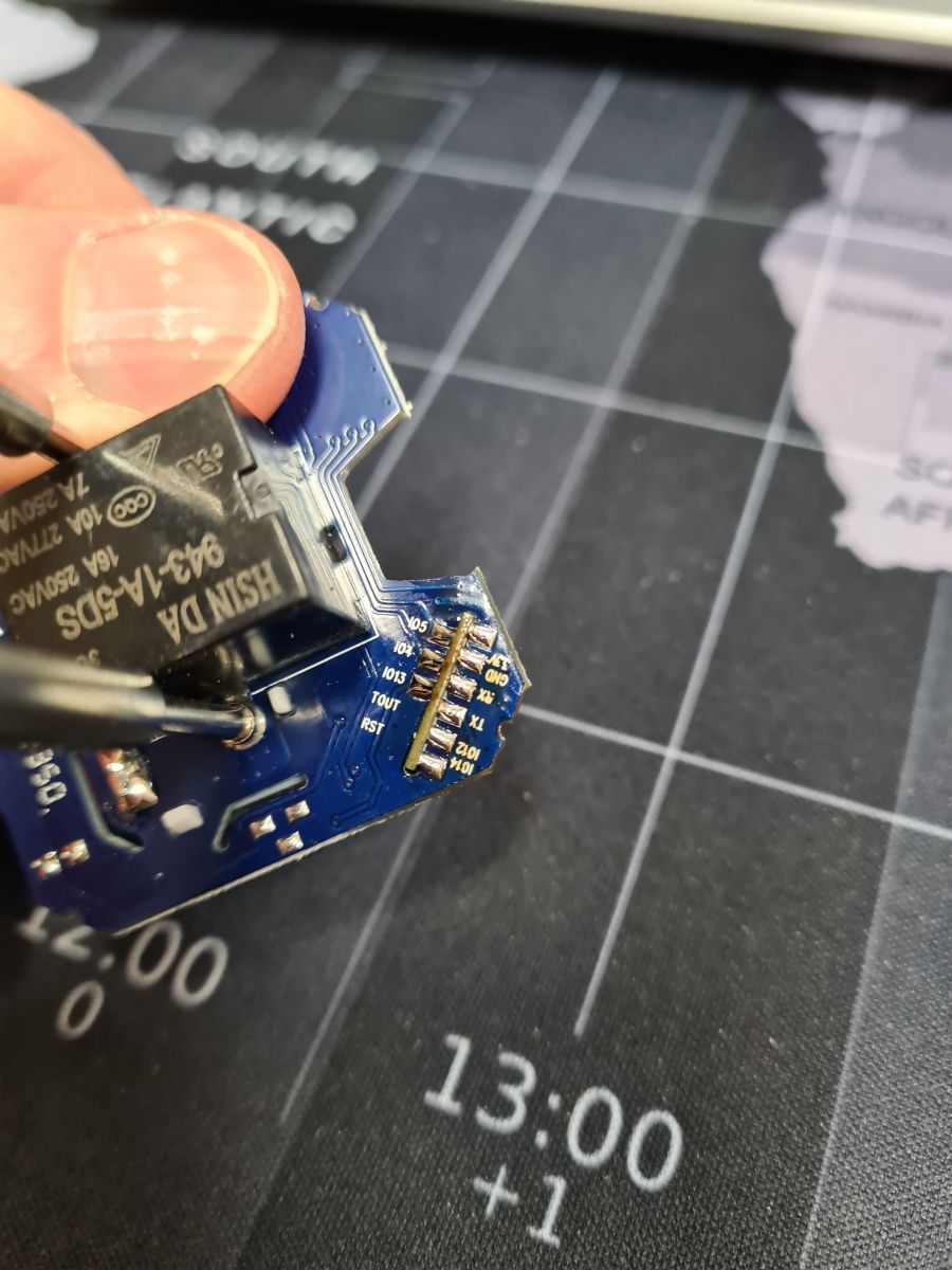

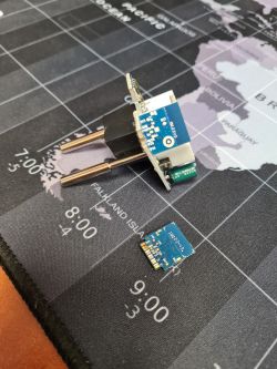

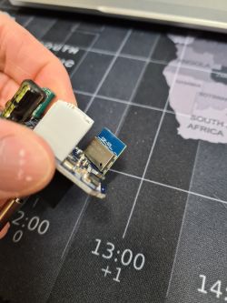

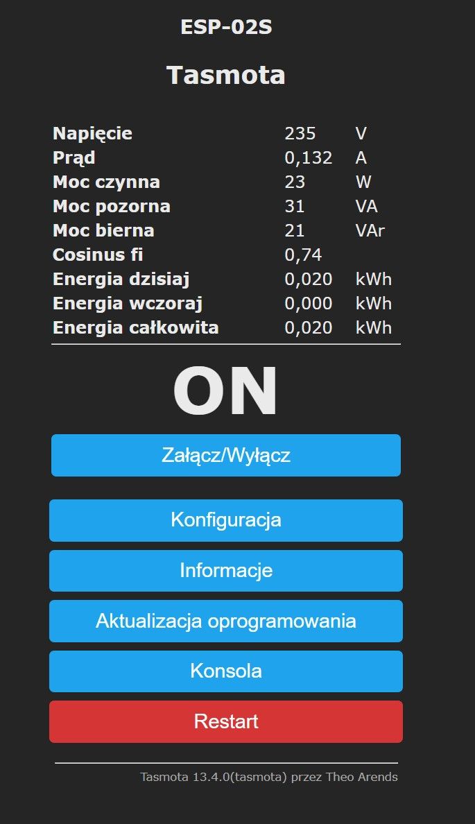

    The ESP-02S module soldered in place of the one from Zigbee was successfully installed. After some thinking, measurements with a multimeter, etc., it turned out that even the voltage measurement works :) Here`s what it looks like:

    Good job. Don't forget to calibrate with VoltageSet/PowerSet/CurrentSet commands (like in OBK). I will close this topic for now.
