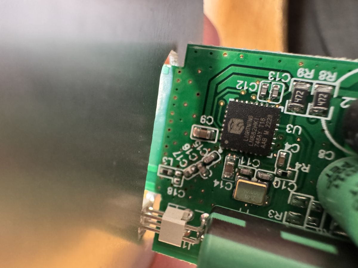

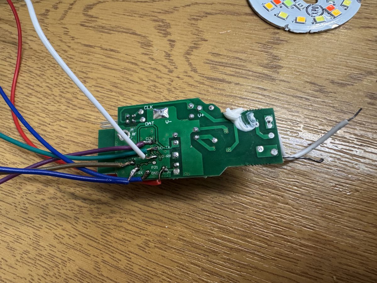

    Not done these particular ones before, and I can’t get any comms from it. Got everything wired up as per the guides; it’s very similar to others, only requiring a boot pin to ground out.
    I’m using U0 RX and U0 TX as that’s what you flash via, right?
    Even so, no serial comms on U1 RX/TX too.
    Any ideas what I could be doing wrong? These should be relatively simple as they are in Easy Flasher

  • Cap placement may interfere with LN882H flashing

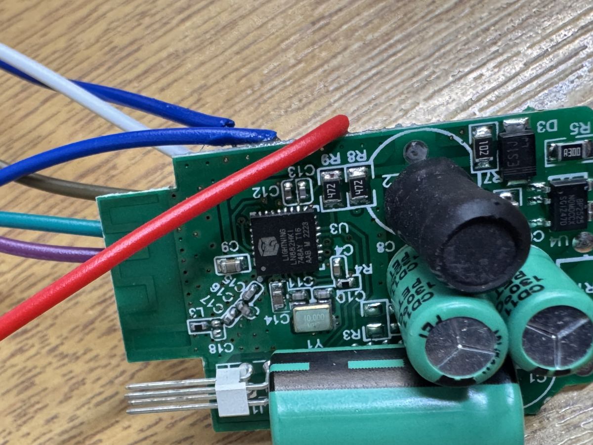

    Close-up of a green printed circuit board with IC chip and capacitors visiblePCB with multicolored wires soldered, placed on wooden surface with LED module nearbyClose-up of a PCB with capacitors, wires, and an integrated circuit
    Excuse colours — I don’t have any colour‑coded DuPont cables on me
    Red is going to 3.3 V, purple to cen (and grounded?)
    Green is TX, so going to RX on TTL
    White is RX, going to TX on TTL
    Have tried switching them around. No change
    Blue is ground.
    Can cap placements interfere with flashing? Sure — I heard that in the Ln882h guide video

    >>21730338
    CEN is used to reset chip, not to put it in boot mode.
    I guess P21 is a boot1 pin, so it should be grounded instead.
  • No LEDs firing despite Wi‑Fi and web UI working
    #5 21730360
    gandi69
    Posts: 99
    Thank you — it's being held in reset then. I'm attempting to get a few of these done today. I'll report back shortly when I've soldered it up.

    Added after 17 [minutes]:
    That was the issue — thanks!
