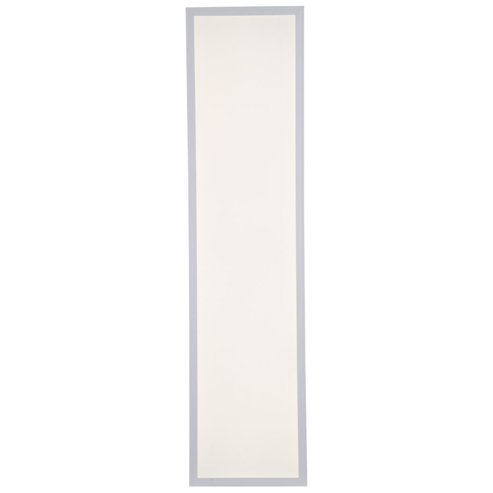

    DETA DET812HA 36W 1200 x 300mm CCT panel light configuration.
    Rectangular lighting panel with gray edges and white center.
