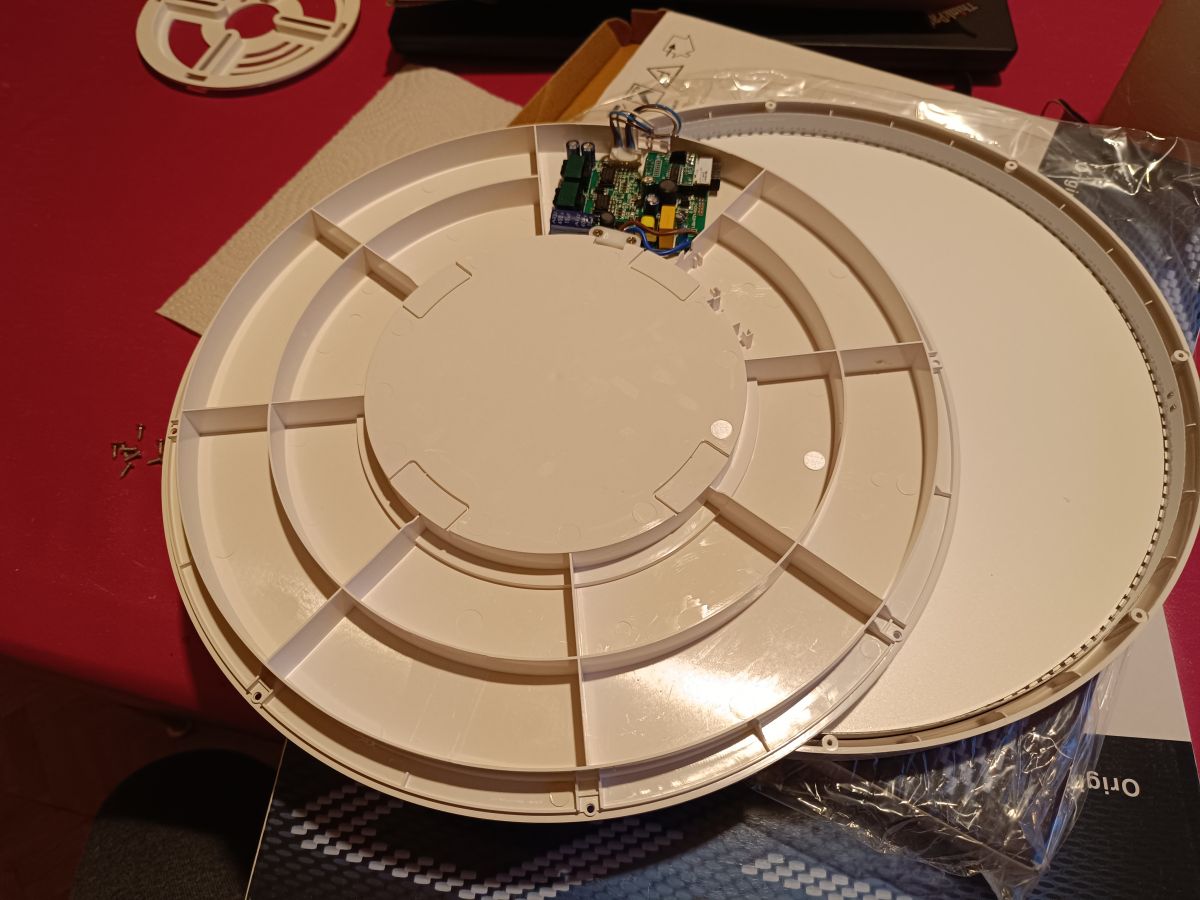

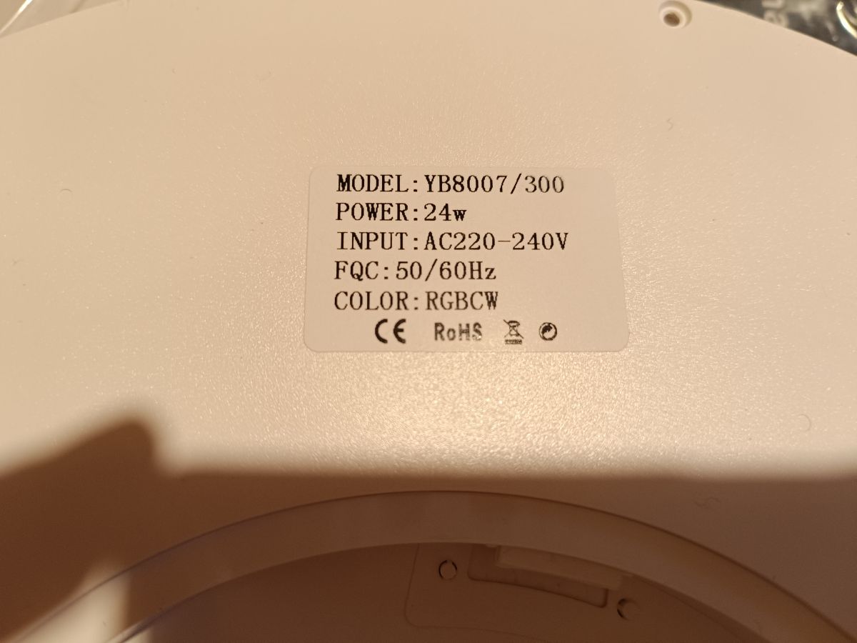

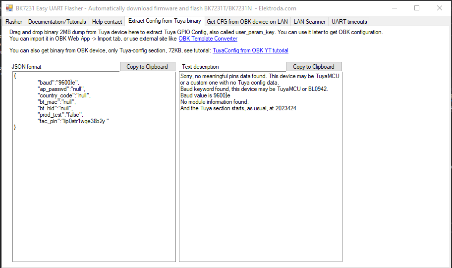

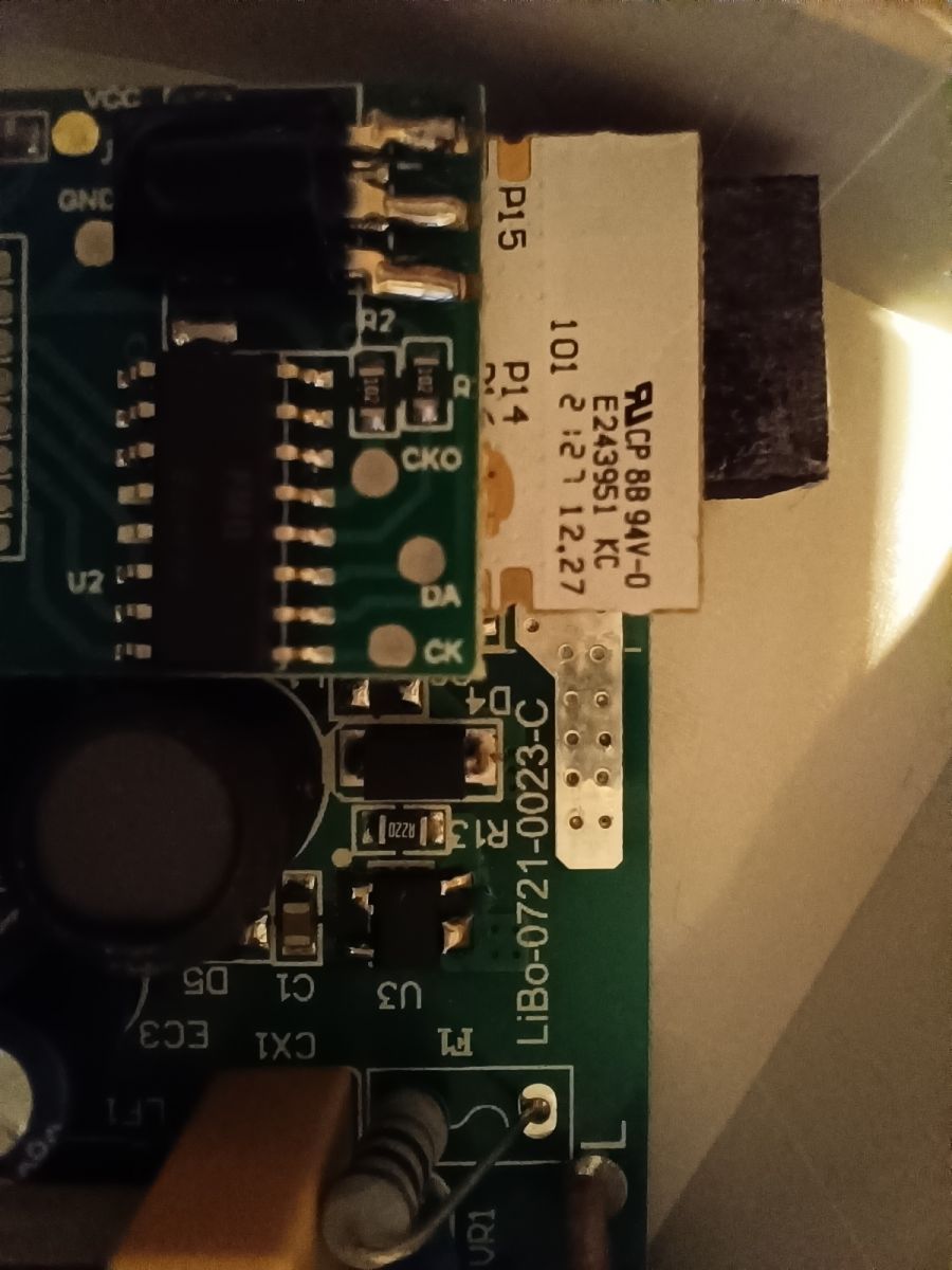

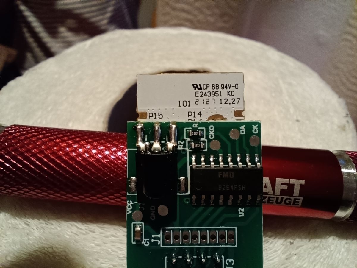

    first thanks for your great work.

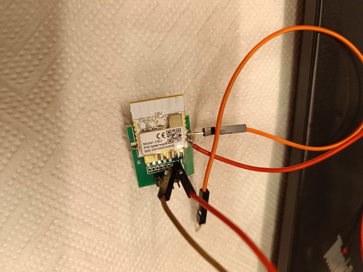

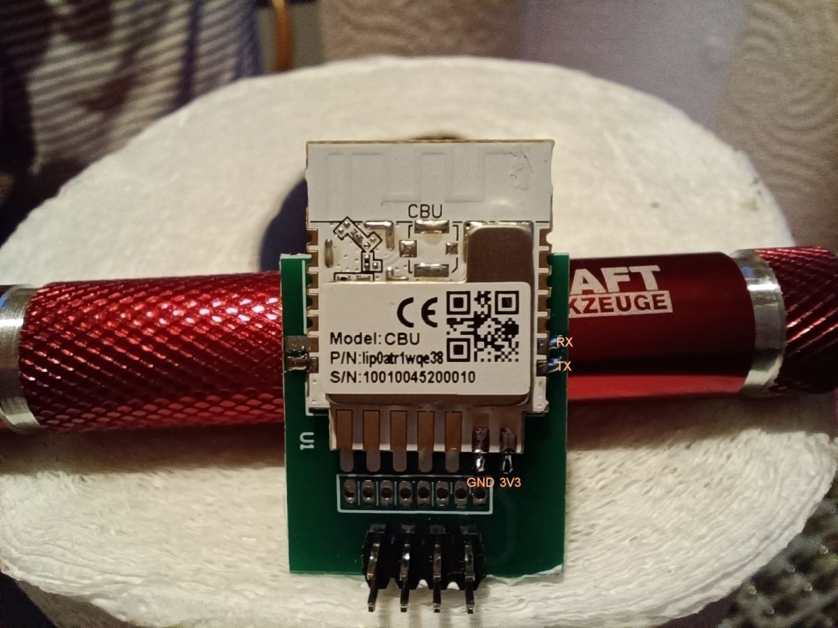

    I tried to flash 3 different types of LED lamps so far
    with openbeken. 1 works great, 2 not.
    In this thread i ask for help for my first problem LED:
    The LED panel is bought from amazon
    https://www.amazon.de/dp/B09XBNNHHV
    [BK7231N/CBU] LED Panel YB8007/300, BK7231Flasher Extraction of config, TuyaMCU LED?
    [BK7231N/CBU] LED Panel YB8007/300, BK7231Flasher Extraction of config, TuyaMCU LED? [BK7231N/CBU] LED Panel YB8007/300, BK7231Flasher Extraction of config, TuyaMCU LED? [BK7231N/CBU] LED Panel YB8007/300, BK7231Flasher Extraction of config, TuyaMCU LED?
    i identified the CBU chip, connected the serial adapter
    and saved the firmware.
    The BK7231Flasher was not able to extract the GPIO
    informations from the firmware.
    [BK7231N/CBU] LED Panel YB8007/300, BK7231Flasher Extraction of config, TuyaMCU LED? [BK7231N/CBU] LED Panel YB8007/300, BK7231Flasher Extraction of config, TuyaMCU LED? [BK7231N/CBU] LED Panel YB8007/300, BK7231Flasher Extraction of config, TuyaMCU LED? [BK7231N/CBU] LED Panel YB8007/300, BK7231Flasher Extraction of config, TuyaMCU LED? [BK7231N/CBU] LED Panel YB8007/300, BK7231Flasher Extraction of config, TuyaMCU LED?

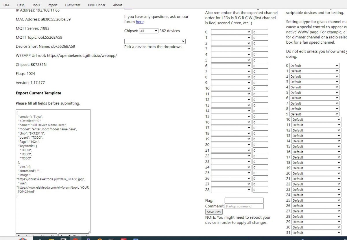

    Then i flashed the firmware suggested by the flasher.
    Success, but now i have to configure the GPIO pins,
    where i don't have experiences.
    I already tried the GPIO doctor, but i didn't get
    any reaction from the lamp while wildclicking.
    From here i ask you how to go further.
    If i remember correctly, i could open a tuya developer
    account, flash back the original firmware, register the
    device with the tuya developer account and try there
    to get more infomartions about the device.
    Would i get there the necessary informations, is this the way
    to go ?
    I am really not sure.
    I am attaching some pics and the saved firmware.
    Greetings Torsten

    Trial and error by selecting all the pins as relays and toggle each one and see which color you’re getting.
    Then assign the pin as below
    Red - pwm 1
    Green - pwm 2
    Blue - pwm 3
    Cold white - pwm 4
    Warm white - pwm 5
  • Config shows TuyaMCU with 9600 baud UART
    #3 20610467
    Posts: 14791
    Rate: 12937
    The flasher does not fail, it extracts meaningful information.
    Following config section:
    indicates it's a TuyaMCU devices. Baud (9600 here) is a speed of UART communication, which is used by TuyaMCU.
    You could have done a TuyaMCU capture with original firmware:
    https://www.elektroda.com/rtvforum/topic3970199.html#20528459
    but you can also try just doing a simple autoexec for TuyaMCU:
    startDriver TuyaMCU
    and try to guess/play around with dpIDs, but I must admit, I haven't seen many LED TuyaMCU devices. So maybe original packets capture can help.
    In general, it's a bit strange device. As I just said, most of LEDs devices are not TuyaMCU, they are either raw PWM or "I2C" LED drivers like SM2135, SM2235, BP5758D, etc.
    You can see how a "classic" PWM based lamp looks like here:
    https://www.youtube.com/watch?v=YQdR7r6lXRY
    In case of your lamp, if you don't want to use TuyaMCU, you could maybe inspect the PCB and with some electronics knowledge you could figure out which LED drivers are used and interface them with PWM IOs of the BK7231N. Maybe that could work. Just remove TuyaMCU and convert device to raw PWMs.

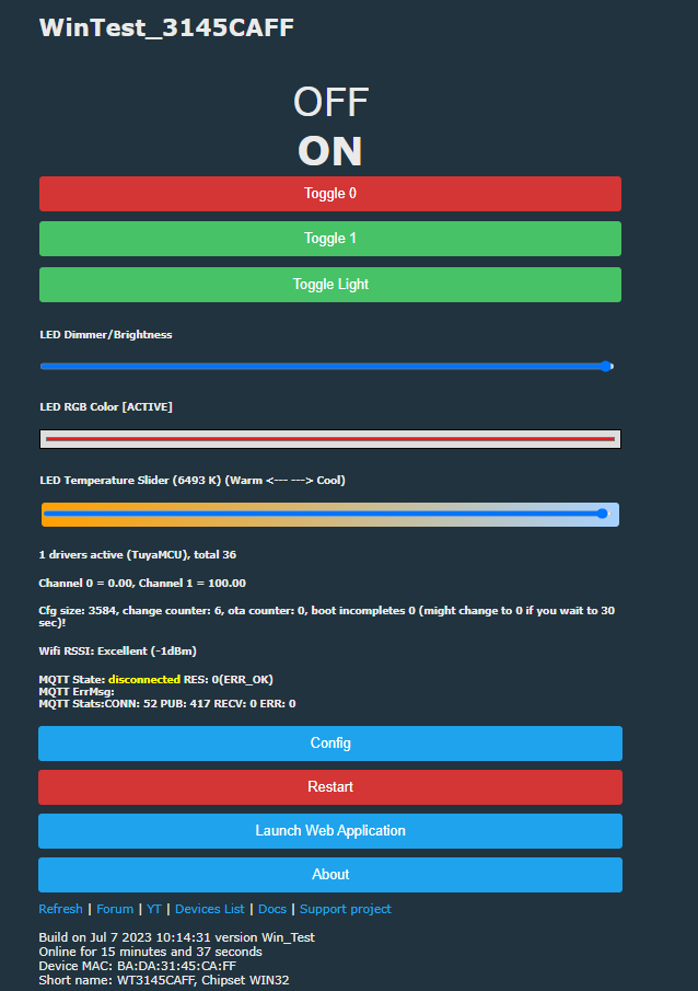

    So i have the dpIds 20, 21, 22, 23, 24, 25

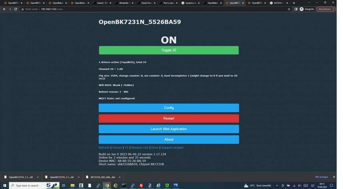

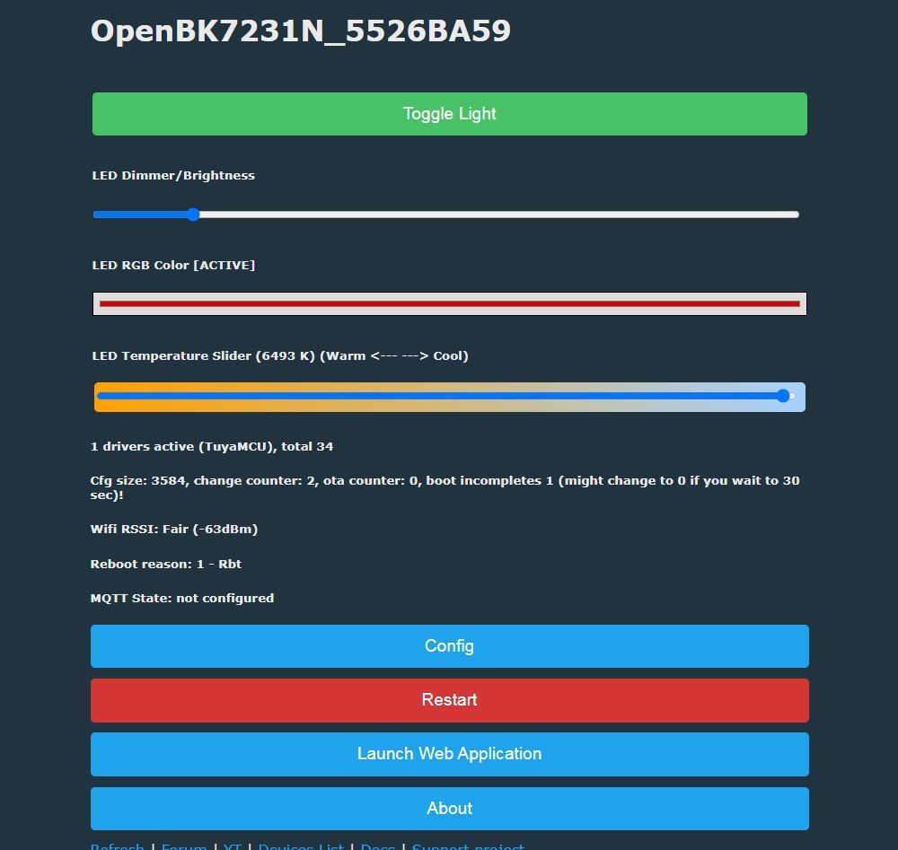

    20 seems easy, the on/off switch, so i created an autoxec.bat with
    setChannelType 20 switch
    linkTuyaMCUOutputToChannel 20 1 20
    ( startDriver TuyaMCU was already placed somewhere else, as the driver was already loaded )
    In fact this works, although the respnsiveness is sometimes not the best.
    Now i think the harder parts.
    dpId 21, dataType 4-DP_TYPE_ENUM and 1 data bytes
    raw data 1 byte:
    dpId 22, dataType 2-DP_TYPE_VALUE and 4 data bytes
    raw data 4 int: 367
    dpId 23, dataType 2-DP_TYPE_VALUE and 4 data bytes
    raw data 4 int: 182
    dpId 24, dataType 3-DP_TYPE_STRING and 12 data bytes
    dpId 25, dataType 3-DP_TYPE_STRING and 2 data bytes

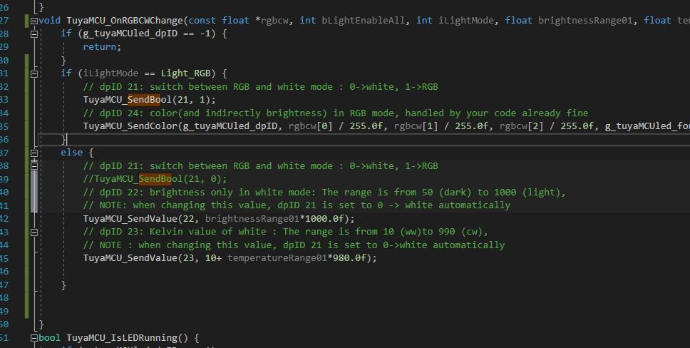

    21: probably switch between RGB and white ?
    22: brightness ?
    23: Kelvin value of white ?
    24: RGB value in a string variable ?
    25: ?
    ... yes, sniffing the MCU traffic would be helpful now :-)

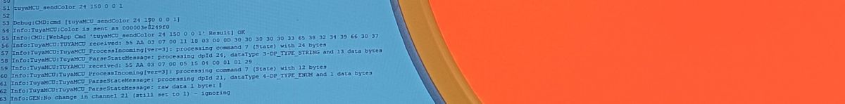

    Edit:
    yes, 21 switches the color modes, i use additionally in the autoexec.bat
    setChannelType 21 toggle
    linkTuyaMCUOutputToChannel 21 1 21
    According to https://tasmota.github.io/docs/TuyaMCU/#lighting this could be scenes too, but i have no interest (in the moment)
    Which ChannelType would you recommend for 22, 23, 24, 25 ?
    How would an entry in the autoexec.bat look like ?
  • TuyaMCU string dpID testing and range questions

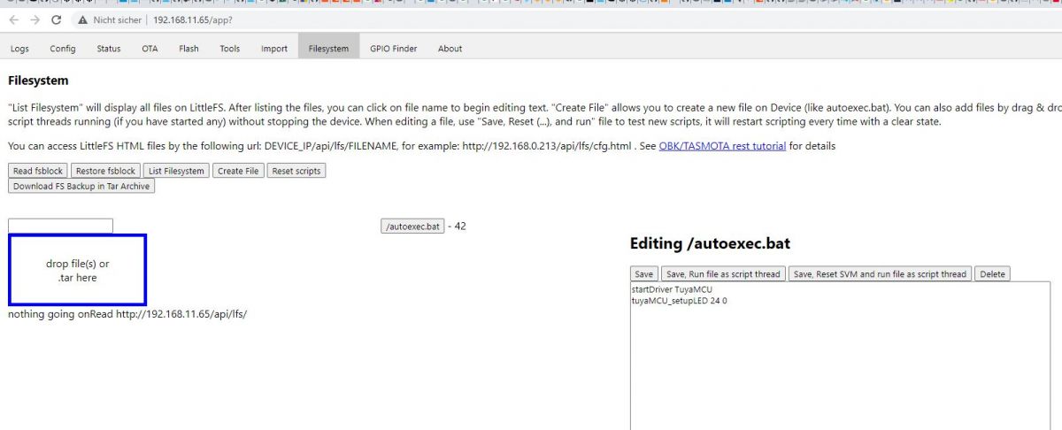

    #5 20611479
    Posts: 14791
    Rate: 12937
    Hmm, for the very start, you can just use ReadOnly or a TextField channel types, or just use console command:
    setChannel 15 200
    If you link channel 15 to some dpID, and use this command, then value 200 will be send to dpID linked to channel 15.

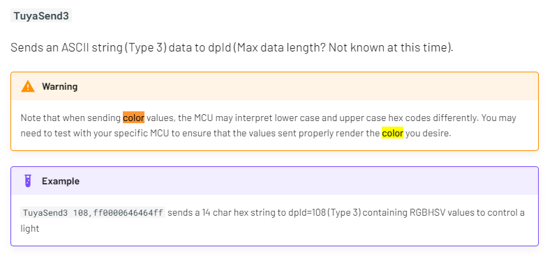

    And regarding this:

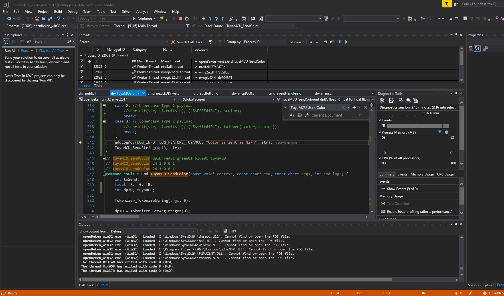

    I think I will add a new channel type for you here. Don't worry, I am online every day, I will do my best to get your device running. It's just that.... it's a first TuyaMCU LED I ever saw. Your device is very unique, that's why we need to do some little work before it will be working.
    I will now update tuyaMcu_sendState command to also support strings. Do you happen to know (or is it in Tasmota docs?) how the values of dpID24 looks like here? If it's a 12 bytes of data, then it's not just an RGB string like "FF0000" for red, because it is just 6 bytes. Is it RGBHSV?

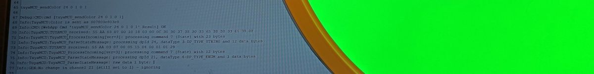

    With latest update (update your obk first), you can try:
    tuyaMcu_sendState 25 3 ff0000646464ff
    this should send that string to dpID 25 (3 is a data type string). This will work without mapping. This is for testing only, I think. Let me know if that command works for you.

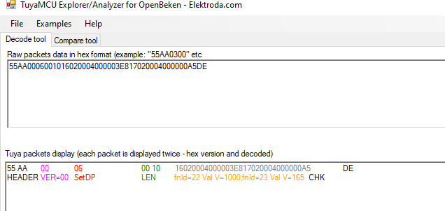

  • dpId 22 and 23 control white brightness and color temperature

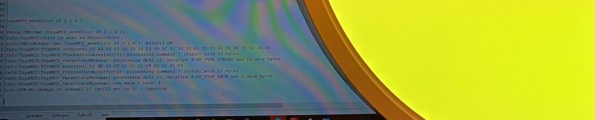

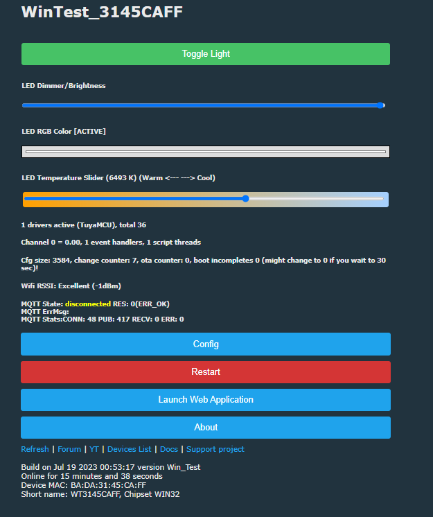

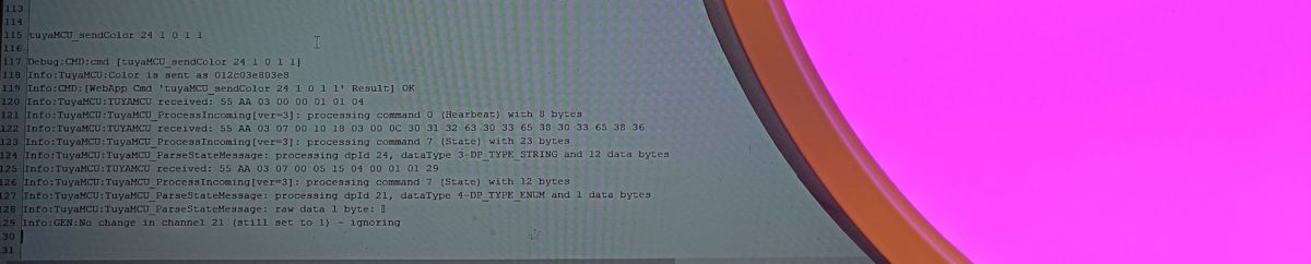

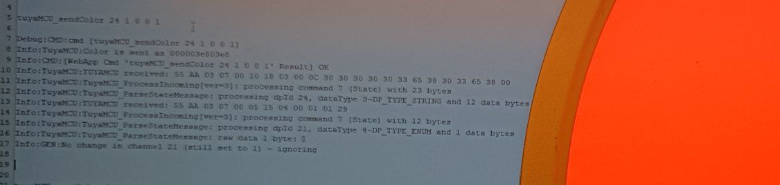

    #6 20612603
    nethawk
    Posts: 23

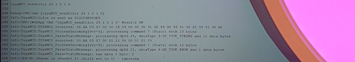

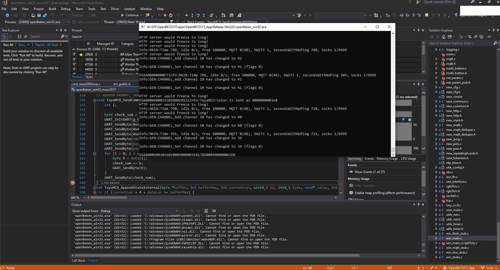

    i played a little bit with dpId 22 and 23
    I did setup them with
    setChannelType 22 TextField
    linkTuyaMCUOutputToChannel 22 2 22
    setChannelType 23 TextField
    linkTuyaMCUOutputToChannel 23 2 23
    Setting 23 to a value sets the colormode (dpId 21) to 0 (white) and
    changes the colortemperature of white.
    The range is from 10 (ww) to 990 (cw).
    How did i find the range ? I did set the value to 2000, which
    is out of range. Then i changed the colormode in the webinterface
    to RGB and then back to white and switched off and on (by using dpId 20).
    It seems the TuyaMCU checks in this case
    the entered min-max values and sets the allowed max and min value, if it's out of range.
    So in my case, the value changed from 2000 to 990.
    Setting 22 to a value sets the colormode (dpId 21) to 0 (white) and
    changes the brightness of white.
    The range is from 50 (dark) to 1000 (light).

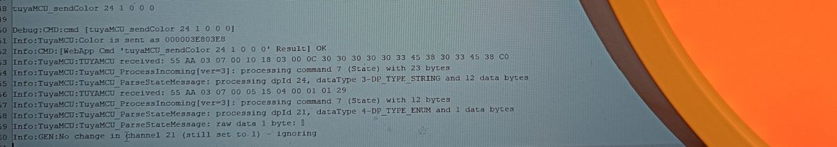

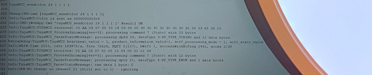

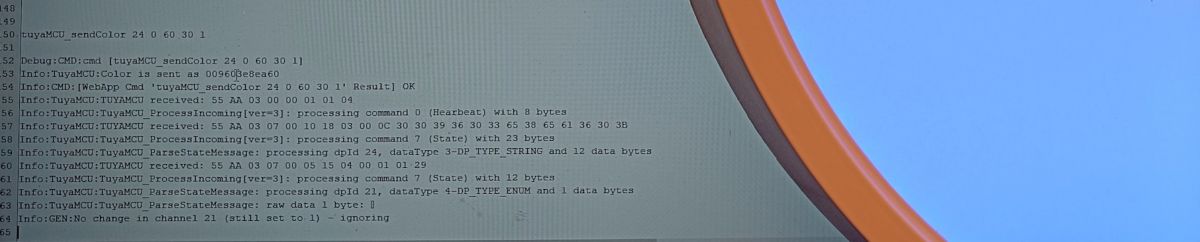

    forces a reaction of the lamp, it changes to warmwhite (or bright yellow ?).
    How did you generate "ff0000646464ff", so i can test other values ?

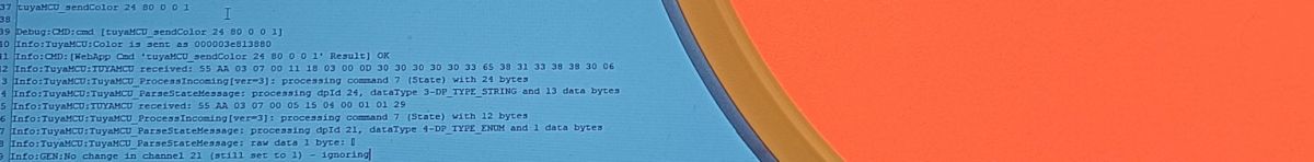

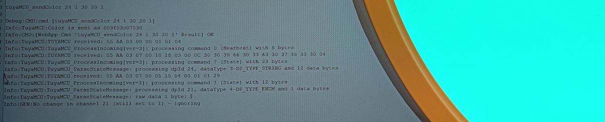

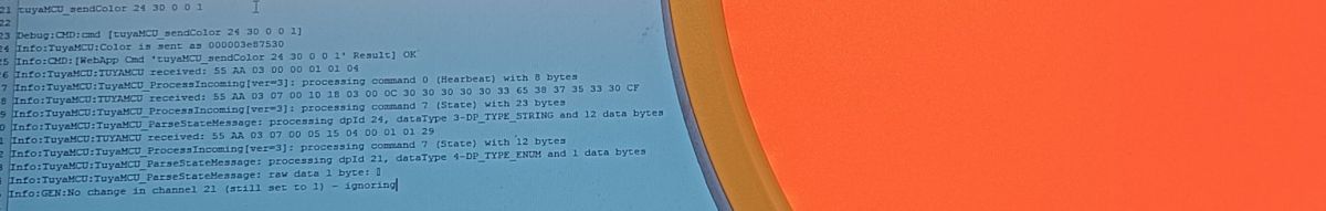

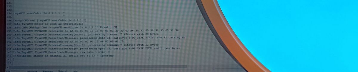

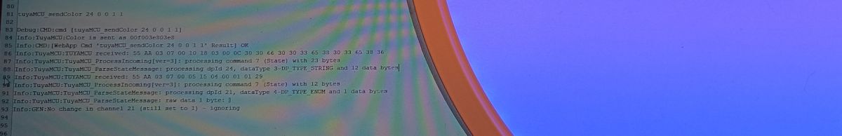

    Then i played around and forced an error. This brings up a new dpID 49, but how
    do i show the value of this dpId ?
    Info:CMD:[WebApp Cmd 'tuyaMcu_sendState 24 3 110000' Result] OK
    Info:TuyaMCU:TUYAMCU received: 55 AA 03 07 00 0A 18 03 00 00 31 31 30 30 30 30 50
    Info:TuyaMCU:TuyaMCU_ProcessIncoming[ver=3]: processing command 7 (State) with 17 bytes
    Info:TuyaMCU:TuyaMCU_ParseStateMessage: processing dpId 24, dataType 3-DP_TYPE_STRING and 0 data bytes
    Info:TuyaMCU:TuyaMCU_ParseStateMessage: processing dpId 49, dataType 49-DP_ERROR and 12336 data bytes

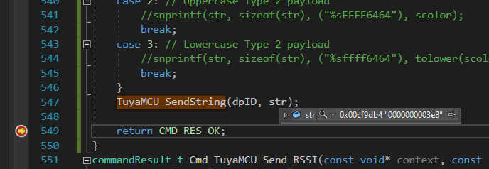

    I don't know, what dpIDs 24 and 25 contain.
    I saw a refernce at tasmota
    https://tasmota.github.io/docs/TuyaMCU/#lights
    which points to a
    TuyaMCU uses different types of RGB Hex format where the most recent is 0HUE0SAT0BRI0 (type 1) and the older being RRGGBBFFFF6464 (type 2). Depending on the MCU, code can be case sensitive.
    After enabling the RGB function check the TuyaReceived information and use TuyaRGB to configure and store the correct (or the closest) format:
    TuyaRGB 0 - Type 1, 12 characters uppercase. Example: 00DF00DC0244 (default)
    TuyaRGB 1 - Type 1, 12 characters lowercase. Example: 008003e8037a
    Probably this can be helpful ?

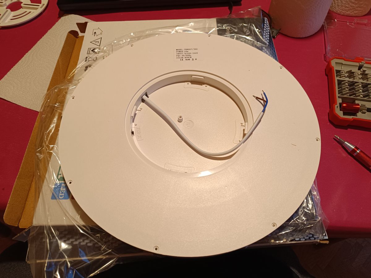

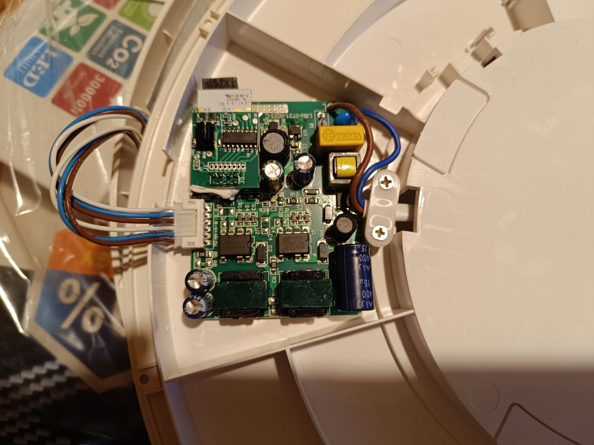

    #7 20615058
    nethawk
    Posts: 23
    Hello again,
    i ordered at amazon 2 of these lamps, so i flashed one lamp back
    with the saved tuya firmware before flashing with openbeken.
    I paired the lamp with the tuya app.
    Then i paired the app (and the included devices) in the tuya developer account (i did this

    So I added a little function:
    https://github.com/openshwprojects/OpenBK7231...mmit/5a4eac37beae67f9cdc77e719a8a2f46732a0f28
    Usage:
     tuyaMCU_sendColor dpID red01 green01 blue01 tuyaRGB1
    tuyaMCU_sendColor 24 1 0 0 1
    will send red color:
    encoded as:
    0000 03e8 03e8
    now, can anyone play around with it and check if it works correctly?

    I will play with it, results in the next post.
    Added after 22 [minutes]:
    Here come my results of testing some values.
    First i didn't realize, that
    tuyaRGB1 can only be 0 or 1 and mean upper or lowercase
    Debug:CMD:cmd [tuyaMCU_sendColor 24 1 0 0 1]
    Info:TuyaMCU:Color is sent as 000003e803e8
    Info:CMD:[WebApp Cmd 'tuyaMCU_sendColor 24 1 0 0 1' Result] OK
    Info:TuyaMCU:TUYAMCU received: 55 AA 03 07 00 10 18 03 00 0C 30 30 30 30 30 33 65 38 30 33 65 38 00
    Info:TuyaMCU:TuyaMCU_ProcessIncoming[ver=3]: processing command 7 (State) with 23 bytes
    Info:TuyaMCU:TuyaMCU_ParseStateMessage: processing dpId 24, dataType 3-DP_TYPE_STRING and 12 data bytes
    Info:TuyaMCU:TUYAMCU received: 55 AA 03 07 00 05 15 04 00 01 01 29
    Info:TuyaMCU:TuyaMCU_ProcessIncoming[ver=3]: processing command 7 (State) with 12 bytes
    Info:TuyaMCU:TuyaMCU_ParseStateMessage: processing dpId 21, dataType 4-DP_TYPE_ENUM and 1 data bytes
    Info:TuyaMCU:TuyaMCU_ParseStateMessage: raw data 1 byte:
    Info:GEN:No change in channel 21 (still set to 1) - ignoring
    tuyaMCU_sendColor 24 30 0 0 1
    Debug:CMD:cmd [tuyaMCU_sendColor 24 30 0 0 1]
    Info:TuyaMCU:Color is sent as 000003e87530
    Info:CMD:[WebApp Cmd 'tuyaMCU_sendColor 24 30 0 0 1' Result] OK
    Info:TuyaMCU:TUYAMCU received: 55 AA 03 00 00 01 01 04
    Info:TuyaMCU:TuyaMCU_ProcessIncoming[ver=3]: processing command 0 (Hearbeat) with 8 bytes
    Info:TuyaMCU:TUYAMCU received: 55 AA 03 07 00 10 18 03 00 0C 30 30 30 30 30 33 65 38 37 35 33 30 CF
    tuyaMCU_sendColor 24 80 0 0 1
    Debug:CMD:cmd [tuyaMCU_sendColor 24 80 0 0 1]
    Info:TuyaMCU:Color is sent as 000003e813880
    Info:CMD:[WebApp Cmd 'tuyaMCU_sendColor 24 80 0 0 1' Result] OK
    Info:TuyaMCU:TUYAMCU received: 55 AA 03 07 00 11 18 03 00 0D 30 30 30 30 30 33 65 38 31 33 38 38 30 06
    Info:TuyaMCU:TuyaMCU_ProcessIncoming[ver=3]: processing command 7 (State) with 24 bytes
    Info:TuyaMCU:TuyaMCU_ParseStateMessage: processing dpId 24, dataType 3-DP_TYPE_STRING and 13 data bytes
    tuyaMCU_sendColor 24 150 0 0 1
    Debug:CMD:cmd [tuyaMCU_sendColor 24 150 0 0 1]
    Info:TuyaMCU:Color is sent as 000003e8249f0
    Info:CMD:[WebApp Cmd 'tuyaMCU_sendColor 24 150 0 0 1' Result] OK
    Info:TuyaMCU:TUYAMCU received: 55 AA 03 07 00 11 18 03 00 0D 30 30 30 30 30 33 65 38 32 34 39 66 30 37
    tuyaMCU_sendColor 24 0 1 0 1
    Debug:CMD:cmd [tuyaMCU_sendColor 24 0 1 0 1]
    Info:TuyaMCU:Color is sent as 007803e803e8
    Info:CMD:[WebApp Cmd 'tuyaMCU_sendColor 24 0 1 0 1' Result] OK
    Info:TuyaMCU:TUYAMCU received: 55 AA 03 07 00 10 18 03 00 0C 30 30 37 38 30 33 65 38 30 33 65 38 0F
    tuyaMCU_sendColor 24 0 0 1 1
    Debug:CMD:cmd [tuyaMCU_sendColor 24 0 0 1 1]
    Info:TuyaMCU:Color is sent as 00f003e803e8
    Info:CMD:[WebApp Cmd 'tuyaMCU_sendColor 24 0 0 1 1' Result] OK
    Info:TuyaMCU:TUYAMCU received: 55 AA 03 07 00 10 18 03 00 0C 30 30 66 30 30 33 65 38 30 33 65 38 36
    tuyaMCU_sendColor 24 1 1 0 1
    Debug:CMD:cmd [tuyaMCU_sendColor 24 1 1 0 1]
    Info:TuyaMCU:Color is sent as 003c03e803e8
    Info:CMD:[WebApp Cmd 'tuyaMCU_sendColor 24 1 1 0 1' Result] OK
    Info:TuyaMCU:TUYAMCU received: 55 AA 03 07 00 10 18 03 00 0C 30 30 33 63 30 33 65 38 30 33 65 38 36
    tuyaMCU_sendColor 24 1 0 1 1
    Debug:CMD:cmd [tuyaMCU_sendColor 24 1 0 1 1]
    Info:TuyaMCU:Color is sent as 012c03e803e8
    Info:CMD:[WebApp Cmd 'tuyaMCU_sendColor 24 1 0 1 1' Result] OK
    Info:TuyaMCU:TUYAMCU received: 55 AA 03 07 00 10 18 03 00 0C 30 31 32 63 30 33 65 38 30 33 65 38 36
    tuyaMCU_sendColor 24 0 1 1 1
    Debug:CMD:cmd [tuyaMCU_sendColor 24 0 1 1 1]
    Info:TuyaMCU:Color is sent as 00b403e803e8
    Info:CMD:[WebApp Cmd 'tuyaMCU_sendColor 24 0 1 1 1' Result] OK
    Info:TuyaMCU:TUYAMCU received: 55 AA 03 07 00 10 18 03 00 0C 30 30 62 34 30 33 65 38 30 33 65 38 36
    tuyaMCU_sendColor 24 0 60 30 1
    Debug:CMD:cmd [tuyaMCU_sendColor 24 0 60 30 1]
    Info:TuyaMCU:Color is sent as 009603e8ea60
    Info:CMD:[WebApp Cmd 'tuyaMCU_sendColor 24 0 60 30 1' Result] OK
    Info:TuyaMCU:TUYAMCU received: 55 AA 03 07 00 10 18 03 00 0C 30 30 39 36 30 33 65 38 65 61 36 30 3B
    tuyaMCU_sendColor 24 1 30 20 1
    Debug:CMD:cmd [tuyaMCU_sendColor 24 1 30 20 1]
    Info:TuyaMCU:Color is sent as 009f03c07530
    Info:CMD:[WebApp Cmd 'tuyaMCU_sendColor 24 1 30 20 1' Result] OK
    Info:TuyaMCU:TUYAMCU received: 55 AA 03 07 00 10 18 03 00 0C 30 30 39 66 30 33 63 30 37 35 33 30 04
    tuyaMCU_sendColor 24 1 1 1 1
    Debug:CMD:cmd [tuyaMCU_sendColor 24 1 1 1 1]
    Info:TuyaMCU:Color is sent as 0000000003e8
    Info:CMD:[WebApp Cmd 'tuyaMCU_sendColor 24 1 1 1 1' Result] OK
    Info:TuyaMCU:TUYAMCU received: 55 AA 03 07 00 10 18 03 00 0C 30 30 30 30 30 30 30 30 30 33 65 38 C0
    ExtraDebug:TuyaMCU:TuyaMCU heartbeat_valid = 1, product_information_valid=1, self_processing_mode = 1, wifi_state_valid = 1, wifi_state_timer=54
    Info:MAIN:Time 2515, idle 183875/s, free 72624, MQTT 0(157), bWifi 1, secondsWithNoPing 2445, socks 2/38
    tuyaMCU_sendColor 24 1 0 1 0
    Debug:CMD:cmd [tuyaMCU_sendColor 24 1 0 1 0]
    Info:TuyaMCU:Color is sent as 012C03E803E8
    Info:CMD:[WebApp Cmd 'tuyaMCU_sendColor 24 1 0 1 0' Result] OK
    Info:TuyaMCU:TUYAMCU received: 55 AA 03 07 00 10 18 03 00 0C 30 31 32 43 30 33 45 38 30 33 45 38 D6
    tuyaMCU_sendColor 24 1 0 0 0
    Debug:CMD:cmd [tuyaMCU_sendColor 24 1 0 0 0]
    Info:TuyaMCU:Color is sent as 000003E803E8
    Info:CMD:[WebApp Cmd 'tuyaMCU_sendColor 24 1 0 0 0' Result] OK
    Info:TuyaMCU:TUYAMCU received: 55 AA 03 07 00 10 18 03 00 0C 30 30 30 30 30 33 45 38 30 33 45 38 C0
    Added after 5 [minutes]:
    Should i test more commands ?
    Which Rval Gval Bval and 0|1 pairs would help if i test them ?
    tuyaMCU_sendColor 24 Rval Gval Bval 1|0

  • Add tuyaMCU_setupLED command for RGBCW picker
    #15 20646461
    Posts: 14791
    Rate: 12937
    Sorry, I forgot about this topic. You should feel free to remind me, when I don't reply for some time. I remember that I looked at your images and got confused by their order, but I can see that colors seem to be okay.
    Okay, so now...
    I am adding command:
    tuyaMCU_setupLED dpID RGBFormat
    Select proper ID here and proper RGB format. You should get RGBCW picker on main menu. Check if it works.
    I haven't tested on physical device, only in Windows simulator:
    Please test and let me know if there are any problems.
  • RGB control works; temperature slider only affects white mode
    #16 20648624
    nethawk
    Posts: 23
    Sorry, I forgot about this topic. You should feel free to remind me when I don't reply for some time.
    No problem, I respect that you invest your time in this project.
    OK.
    I tested it and made a "factory reset" and started then with:
    "Toggle Light" works.
    "LED RGB Color" - the color picker works, the chosen color will be presented by the LED.
    "LED Dimmer / Brightness" works, but values below 13 make the LED go off.
    "LED Temperature Slider" doesn't work. Changing something there does turn off the LED, but I think this is not a problem, as this Slider should only work in the white mode of the LED, right?
  • Need to hide white temperature slider for RGB-only lights
    #17 20648693
    Posts: 14791
    Rate: 12937
    Thank you for your kind words. If you like our project, please post a teardown in our IoT section if you encounter an undocumented IoT device. You can also subscribe to our Elektroda com YT channel: https://www.youtube.com/@elektrodacom
    Regarding the testing, it seems your device is RGB only, right? So there is no way to display cool and warm white...
    It seems we just have to hide the white temperature slider. The only question is, are there also TuyaMCU RGBCW lights? I do not currently have enough knowledge to judge.
  • RGBCW lamp uses DP 21–23 for mode and white control
    #18 20648716
    nethawk
    Posts: 23
    It is an RGBCW lamp.
    DP 21: switch between RGB and white mode: 1 -> RGB, 0 -> white
    DP 22: brightness: The range is from 50 (dark) to 1000 (light)
    DP 23: Kelvin value of white: The range is from 10 (ww) to 990 (cw)
    (see posts above https://www.elektroda.com/rtvforum/topic3982779.html#20612603)
  • #19 20648757
    Posts: 14791
    Rate: 12937
    Hmm, okay, so it seems that we need to support those extra dpIDs. Can you tell me whether dpID 22 (brightness from 50 to 1000) affects the colors sent by OpenBeken?
    I am asking because currently OpenBeken does brightness internally and sends already scaled values as Tuya Color. We do not send anything to dpID 22 yet.
  • dpID 22 only controls white-mode brightness
    #20 20649138
    nethawk
    Posts: 23
    dpID 22 affects only the brightness in white mode.
    I want to summarize:
    dpID 20: switch the lamp on and off. If the lamp is switched on again, previous color mode and brightness is restored. 0 -> off, 1 -> on
    dpID 21: switch between RGB and white mode: 0 -> white, 1 -> RGB
    dpID 22: brightness only in white mode: The range is from 50 (dark) to 1000 (light), NOTE: when changing this value, dpID 21 is set to 0 -> white automatically
    dpID 23: Kelvin value of white: The range is from 10 (ww) to 990 (cw), NOTE: when changing this value, dpID 21 is set to 0 -> white automatically
    dpID 24: color (and indirectly brightness) in RGB mode, handled by your code already fine
    dpID 25: scene management, not yet investigated more, at least for me not needed, so UNUSED
    So, in white mode the "Toggle Light" switch does not work (I assume it sets the color to black?)

    @nethawk I didn't have time to add configuration, but, for a quick test, I hardcoded your dpIDs in the code:
    I didn't add the ON/OFF, only brightness and temperature.
    https://github.com/openshwprojects/OpenBK7231...mmit/d6466ed3a8201599dc354b8ccfdf482dce1d31ea
    Can you test and tell me whether now the device can control cool/warm color? The release will be up in 15 minutes or so...

    #23 20655752
    nethawk
    Posts: 23
    I uploaded OpenBK7231N_1.17.182.rbl and it gives unexpected results:
    If I use the LED temperature slider, the lamp changes to white mode, but the temperature is not adjustable and stays at the same level.
    Using the brightness slider works for the white mode.
    In RGB mode, the brightness slider doesn't work.
    The dimmer does not work for RGB colors.

  • RGB color picker and dimmer broken in 1.17.182
    #25 20656814
    nethawk
    Posts: 23
    This is with 1.17.182, autoexec.bat containing
    startDriver TuyaMCU
    tuyaMCU_setupLED 24 1
    tuyaMcu_sendState 23 2 10
    -> ww works
    tuyaMcu_sendState 23 2 980
    -> cw works
    tuyaMcu_sendState 23 2 444
    -> "midwhite" works
    tuyaMcu_sendState 22 2 50
    -> white brightness to dark works
    tuyaMcu_sendState 22 2 990
    -> white brightness to light works
    tuyaMcu_sendState 22 2 500
    -> white brightness to mid works
    -> RGB mode, color near yellow works
    -> RGB mode, color red works
    PS: What's going on with dimmer on RGB? I thought it was reported to be working and I didn't change RGB handling.
    with 1.17.182 the RGB part (on the web interface) is partly broken:
    the color picker: doesn't change the color at all
    the brightness dimmer: doesn't change the brightness at all

    Can you check with the latest release whether dimmer+temperature behaves differently? Btw, thank you for the support!
  • RGB mode switches to white on brightness change
    #28 20661824
    nethawk
    Posts: 23
    Can you check whether the dimmer and temperature behave differently in the latest release?
    I am sorry, this didn't succeed.
    To enter RGB mode, set the color to red:
    In RGB mode:
    The color picker doesn't work.
    Changing the brightness dimmer causes the lamp to go into white mode and dim white correctly.
    Now we are in white mode:
    The dimmer works,
    The temperature doesn't work.
    I know, this is frustrating. Maybe we should calm down the TuyaMCU LED and wait a few days before continuing?

    I have double checked my code in Simulator, and for this CCT color:
    It sends:
    55AA0006001016020004000003E817020004000000A5DE
    which is:
    55 AA 00 06 00 10 16020004000003E817020004000000A5 DE
    HEADER VER=00 SetDP LEN fnId=22 Val V=1000,fnId=23 Val V=165 CHK
    Maybe it also doesn't like compound packets and i will need to send two dpID values with some interval time... or maybe something else is wrong

    #30 20662274
    nethawk
    Posts: 23
    Does temperature at least work with those commands then?
    RGB mode:
    Starting with 1.17.182 the RGB part does not work like it did with previous versions.
    The color picker doesn't work and the dimmer doesn't work since 1.17.182
    Now testing 1.17.186
    RGB mode:
    Using the webpage nothing new: color picker doesn't work, dimmer doesn't work.
    Using the CMD works:
    white mode:
    webpage dimmer for brightness works
    webpage slider for temperature doesn't change something
    -> ww works
    Info:CMD:[WebApp Cmd 'tuyaMcu_sendState 23 2 10' Result] OK
    Info:TuyaMCU:TUYAMCU received: 55 AA 03 07 00 08 17 02 00 04 00 00 00 0A 38
    Info:TuyaMCU:TuyaMCU_ProcessIncoming[ver=3]: processing command 7 (State) with 15 bytes
    Info:TuyaMCU:TuyaMCU_ParseStateMessage: processing dpId 23, dataType 2-DP_TYPE_VALUE and 4 data bytes
    Info:TuyaMCU:TuyaMCU_ParseStateMessage: raw data 4 int: 10
    Info:TuyaMCU:TUYAMCU received: 55 AA 03 07 00 05 15 04 00 01 00 28
    -> cw works
    Info:TuyaMCU:TUYAMCU received: 55 AA 03 07 00 08 17 02 00 04 00 00 03 D4 05
    Info:TuyaMCU:TuyaMCU_ParseStateMessage: raw data 4 int: 980
    Using the webinterface:
    -> does not work
    setting the white temperature using the slider to 190 i see in the logs:
    Info:TuyaMCU:TUYAMCU received: 55 AA 03 07 00 10 16 02 00 04 00 00 03 E8 17 02 00 04 00 00 00 6F AC
    Info:TuyaMCU:TuyaMCU_ParseStateMessage: processing dpId 22, dataType 2-DP_TYPE_VALUE and 4 data bytes
    Info:TuyaMCU:TuyaMCU_ParseStateMessage: raw data 4 int: 1000
    Info:TuyaMCU:TuyaMCU_ParseStateMessage: raw data 4 int: 111
    So what is the difference between changing the brightness (white) and the tempearature (white)
    Using the webinterface i changed again the brightness
    -> works
    setting the brightness using the slider i see in the logs:
    I see no real difference between changing brigtness and temperature (white) in the logs.

How should I configure OpenBeken autoexec.bat for a TuyaMCU LED lamp with dpID 20 on/off, dpID 21 mode, dpID 22 brightness, dpID 23 color temperature, and dpID 24 RGB color?
Start TuyaMCU and set the RGB dpID with tuyaMCU_setupLED 24 1, then let current OpenBeken handle the hardcoded white dpIDs for this lamp. A minimal tested file was startDriver TuyaMCU plus tuyaMCU_setupLED 24 1. Earlier manual mappings linked dpID 20 as a switch and dpID 21 as a toggle, but later LED support handled the web UI and MQTT light controls. [#20656814]
What is the correct TuyaMCU HSV color string format for dpID 24 on Tuya RGB lights?
dpID 24 uses a 12-character lowercase HSV-style string formatted as three 4-hex-digit fields. Tasmota’s equivalent type 1 lowercase format uses %04x%04x%04x, meaning hue, saturation multiplied by 10, and brightness multiplied by 10. The captured value 00f903b6024d matched that pattern and was sent as ASCII string data. [#20633912]
How does the OpenBeken tuyaMCU_sendColor command work for controlling RGB colors on a TuyaMCU lamp?
tuyaMCU_sendColor converts RGB input into a Tuya HSV string and sends it to the selected color dpID. The command format is tuyaMCU_sendColor dpID red01 green01 blue01 tuyaRGB1. For this lamp, tuyaMCU_sendColor 24 1 0 0 1 sent red and encoded it as 000003e803e8. The final argument selected lowercase or uppercase Tuya RGB format. [#20633912]
Why does changing white brightness or color temperature on a TuyaMCU LED lamp require delays between dpID packets?
This lamp needs delays because rapid consecutive dpID packets can fail or overwrite each other. Manual commands to dpID 22 and 23 worked, but combined or immediate web-interface sends caused missing temperature updates. Adding a delay between packets fixed white temperature control in OpenBeken 1.17.187; a later reduction to 50 ms still worked. [#20662700]

How do I integrate an OpenBeken TuyaMCU RGBCW LED lamp with Home Assistant over MQTT?
Integrate it as an MQTT light using OpenBeken command and state topics for power, RGB, brightness, and color temperature. The posted Home Assistant YAML used led_basecolor_rgb, led_enableAll, led_dimmer, and led_temperature topics. It set brightness_scale: 100 and used an RGB command template formatted as #%02x%02x%02x0000. The user confirmed Home Assistant integration worked after TuyaMCU LED fixes. [#20720527]
How can I troubleshoot Home Assistant color changes that make an OpenBeken TuyaMCU light become slow or unresponsive?
Test rapid color changes from the OpenBeken console and watch TuyaMCU logs before blaming Home Assistant. Run backlog led_basecolor_rgb FF0000; led_basecolor_rgb 00FF00; led_basecolor_rgb 0000FF only when you can power-cycle the lamp. One test caused about 1.5 seconds of web UI unresponsiveness, then recovered. The likely backend fix is a TuyaMCU send queue. [#20726537]
TuyaMCU vs raw PWM vs I2C LED drivers like SM2135, SM2235, and BP5758D — which control method is better for OpenBeken LED lamps?
Use TuyaMCU when the original firmware exposes a TuyaMCU UART config, and use PWM or I2C only when hardware confirms those paths. The developer said classic LED lamps often use raw PWM or I2C LED drivers like SM2135, SM2235, and BP5758D. This device was different: it used TuyaMCU at 9600 baud, so dpID control was the practical OpenBeken route. [#20610467]
How do I read or debug a new TuyaMCU dpID 49 DP_ERROR message after sending an invalid dpID 24 string?
Treat dpID 49 as an error response caused by an invalid TuyaMCU color payload, then retest with valid dpID 24 string length. The user triggered DP_ERROR after sending tuyaMcu_sendState 24 3 110000, which produced a malformed string case. Valid RGB color testing later used 12-character HSV strings on dpID 24, such as 00f903b6024d. [#20612603]
