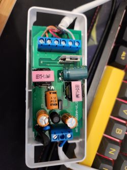

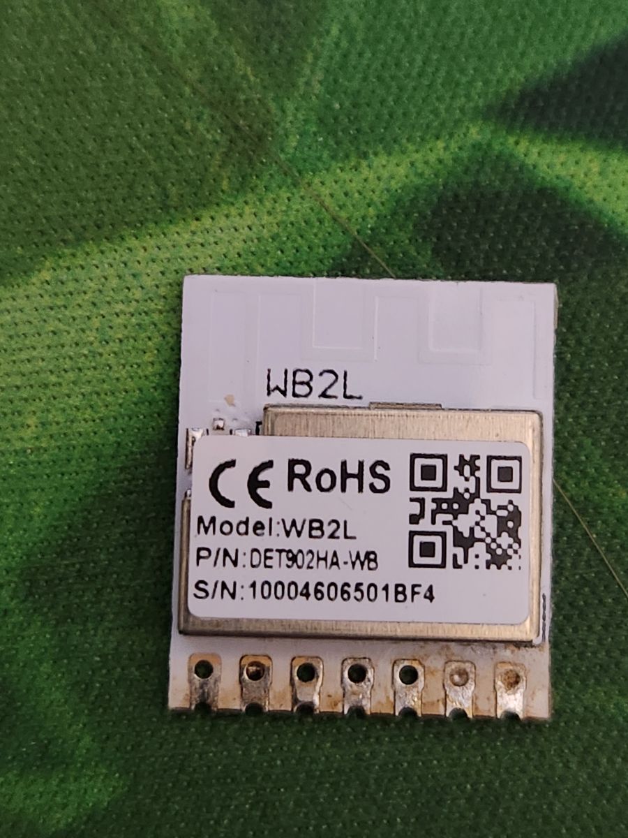

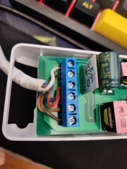

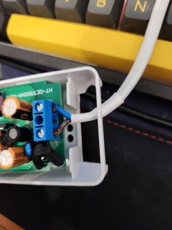

    Device Name: DETA 10W SMART LED DOWNLIGHT - DET902HA Series 2
    Device Type: LED Downlight RGBCWWW
    Device Chip: WB2L - BK7231T
    Device Purchased: Bunnings Warehouse - ~$52.27NZD
    Printed circuit board with electronic components in a casing. Close-up of the interior of a device with wiring and capacitors. Close-up of the interior of a device housing showing wires and electronic components. WB2L module with CE RoHS label on a green background. WB2L module with visible pins and markings on a green background.Box of DETA 10W SMART LED DOWNLIGHT with visible logo and RGB color designation.Box of DETA SMART LED DOWNLIGHT with GRID Connect logo and smart home icons.Box of DETA 10W Smart LED Downlight on a black surface.

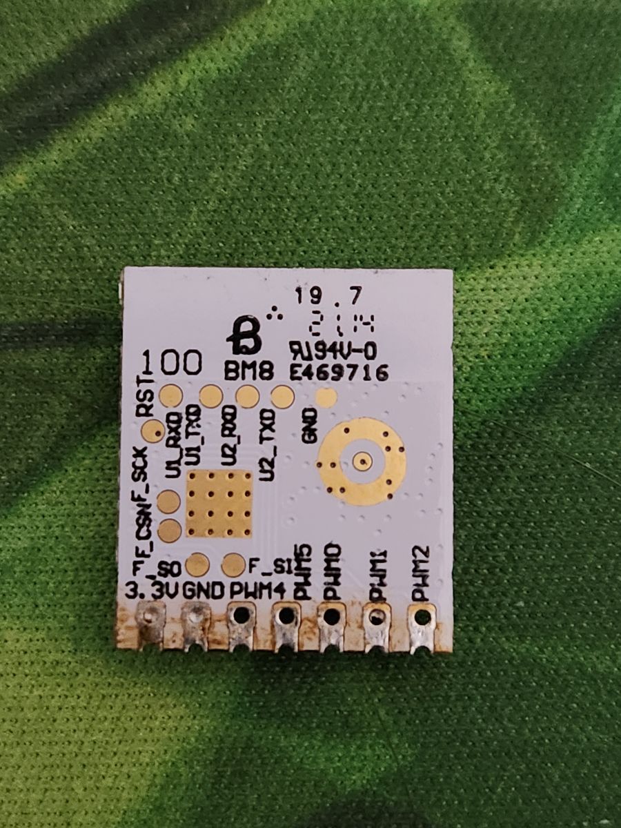

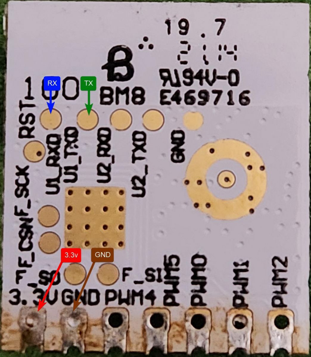

    Flashing of Main Chip
    Manually flashed the chip with BK7231 GUI Flash Tool.
    Some posts for WB2L suggest you need to increase the current available for 3.3v but was able to flash with a cheap USB to TTL - UART serial adapter without this, I did remove the WB2L module from the main PCB before doing so using some solder wick then reinstalled after flashing.
    Make sure you set adapter to 3.3v or use 3.3v pin (depending on adapter type)
    3.3v - VCC or 3.3V on USB to TTL
    GND - GND on USB to TTL
    TX - RX on USB to TTL
    RX - TX on USB to TTL
    Close-up of the WB2L module with described pins and color-coded labels.
    WB2L Module Datasheet
    Configuration of Module
    Pins
    P26 - PWM - Channel 1
    P24 - PWM - Channel 2
    P6 - PWM - Channel 3
    P8 - PWM - Channel 4
    P7 - PWM - Channel 5
