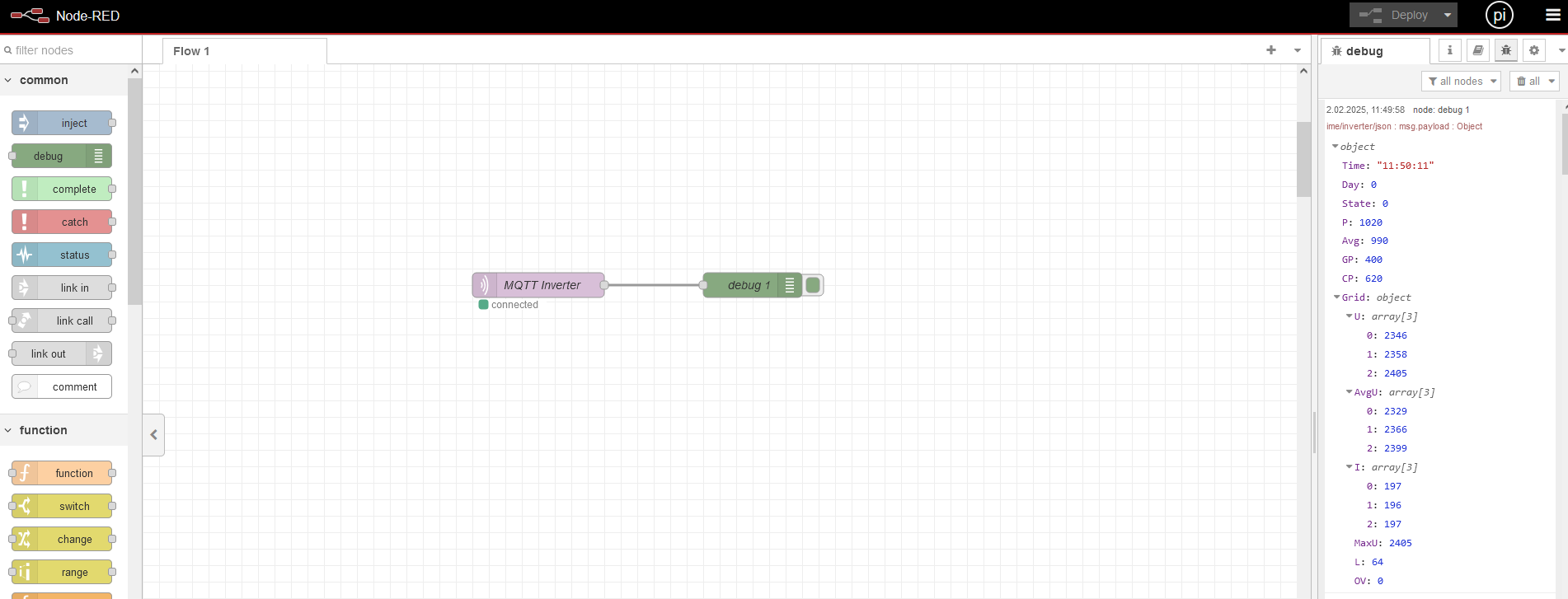

    I am asking for help from colleagues in setting up a NodeRed connection to Domoticz.
    Currently, thanks to my colleague @michal.zd, I have in NodeRed data from a Sofar 15KTL-X inverter which I would like to transfer to domoticz and use there.
    In this topic: https://www.elektroda.pl/rtvforum/topic4101631.html all the details on how to get the data from the Sofar inverter to NodeRed.
    Screenshot of Node-RED interface with MQTT Inverter connection to debug node. .
    Maybe there is someone willing to take the time and help with the topic of getting data from NodeRed into Domoticz.
    Domoticz on a shared raspberry with NodeRed.

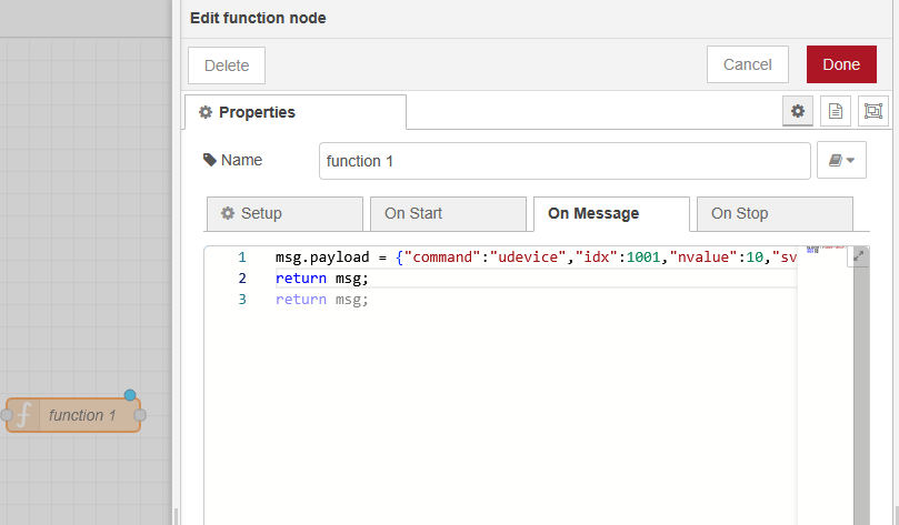

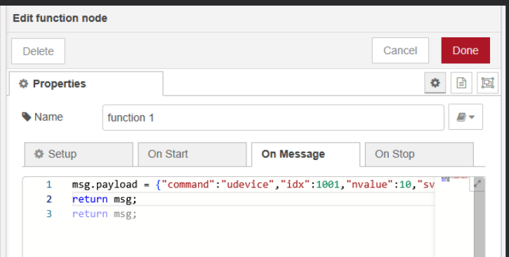

    To start with, I suggest you try to send some data typed in rigidly.
    This node with the f icon is its own function, in which you enter
    msg.payload = {"command":"udevice","idx":1001,"nvalue":10,"svalue":""};
    return msg;
    Check that you have access to the data in domoticz.
    I have no idea what the command is,
    idx is probably the device index
    nvaluea svalue I suspect numeric, string value.

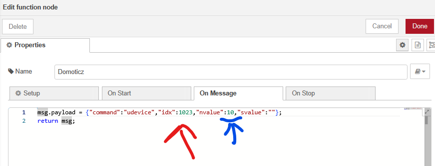

    @michal.zd I don't really understand what I have to set in this node:
    Node flow diagram in the application. .
    I understand that in the one with F:
    Edit view of a function node in Node-RED software with a snippet of JavaScript code. .
    Somewhere else you probably need to give the IP and port of Domoticz.

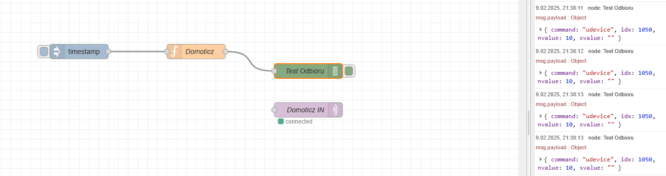

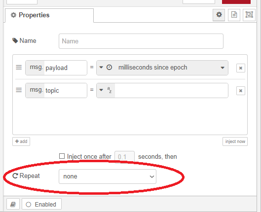

    Use a timestamp inject node for testing
    #5 21429925
    michal.zd
    Posts: 1684
    Help: 84
    Rate: 274

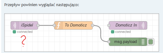

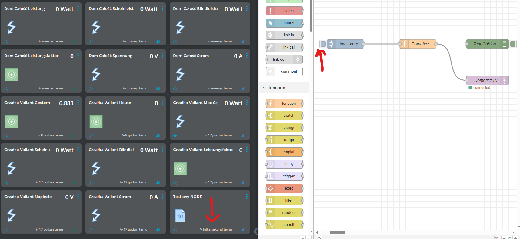

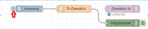

    For testing instead of this ispidel use Timestamp.
    Then by pressing in this area marked with an arrow you generate the pulse and flow action manually.
    Node-RED flow example with Timestamp, To Domoticz, and Domoticz In nodes. .
    Settings for this Timestamp:
    Node-Red properties window with node settings, repeat option set to none. .
    Settings Domoticz In you should have guessed.

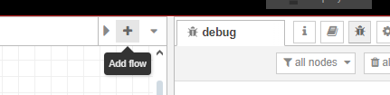

    Any test flow is good to do on new blank node-red cards. With this button you add:
    Add flow button in the node-red user interface. .
    Have you already taken a node-red course? It is worth getting to know this environment better, many things will become clearer.
    Here an accessible (but a bit short and not much) description of the basic nodes : https://www.pomysłowydom.pl/przykladowe-reguly-node-red/
    A nice course is given by Artur on his channel, here's a link to the first episode : https://www.youtube.com/watch?v=9fTMpgr3EU0
    and of course https://nodered.org/docs/
    Added after 1 [hour] 1 [minute]: .
    Well, and don't forget to connect the nodes to each other, now the net domoticz in is not connected to the predecessor.

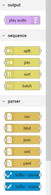

    #6 21431387
    Daro1003
    Posts: 2713
    Help: 295
    Rate: 606

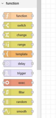

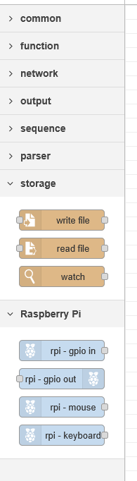

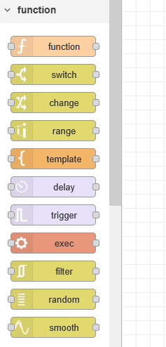

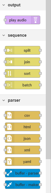

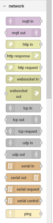

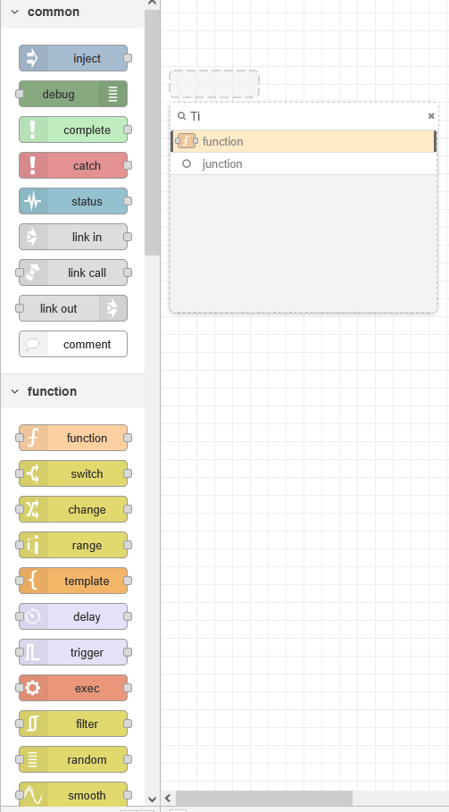

    Exactly @michal.zd there is no such node as Timestamp and watching some video on NodeRed they also used nodes which I don't have on mine I don't know I need to install them or something.
    Node-RED editor view with node search. Node-RED interface showing a list of available function nodes, such as function, switch, change, and others. List of available network nodes in Node-RED displayed in the application. Screenshot of Node-RED editor showing a list of available nodes under categories output, sequence, and parser. Node-RED panel showing node categories, including Raspberry Pi and storage. Screenshot of Node-RED editor showing a list of available nodes under categories output, sequence, and parser. Node-RED panel showing node categories, including Raspberry Pi and storage.
  • Install missing Node-RED nodes via manage palette
    #7 21431532
    michal.zd
    Posts: 1684
    Help: 84
    Rate: 274
    :D
    fact, for inconspicuousness in the list it is called so: Screenshot from Node-RED tool showing the inject node in the common section. .
    Added after 57 [seconds]:
    Daro1003 wrote:
    watching some movie about NodeRed there were also used nodes which are not there in my case I do not know I need to install them or something.
    Some nodes do need to be installed.
    regarding: Screenshot showing the iSpider node in a flow editor with the label connected below. .
    I suspect that someone simply called it that, as the name of the noda can be changed. You need to read the whole thing in this forum, as it may turn out to be the usual mqtt you used earlier in my example. After all, it looks the same. Basically the colour of the noda and its icon is unchangeable, you can tell by that.

    ps: here you have two return. one unnecessary
    Editing a function node with code and settings. .

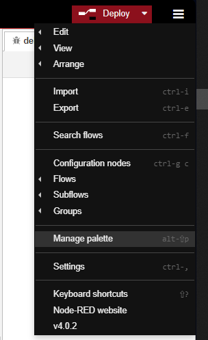

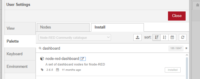

    Back to adding nodes...
    This is done here - manage palette:
    Screenshot of the Node-RED menu with the Manage palette option highlighted in version 4.0.2. .
    It is worth installing this one:
    Node-RED installation window highlighting the node-red-dashboard add-on. .

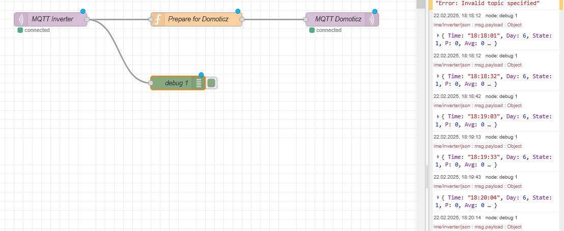

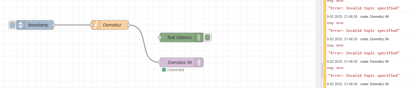

    This is where it flies ok for me:
    Screenshot of the Node-RED interface with a Domoticz error. .
    However, to Domoticz the error:
    Node-RED connection diagram with errors related to Domoticz. .

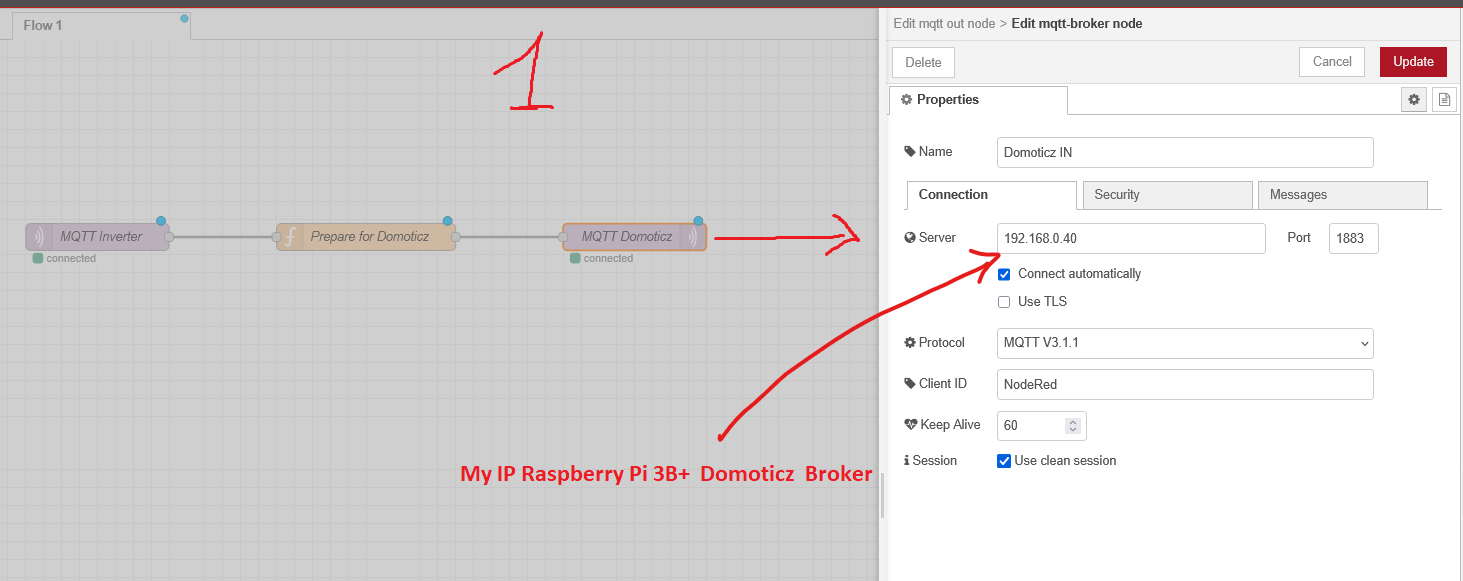

  • Use domoticz/in topic and mosquitto broker address
    #9 21432627
    michal.zd
    Posts: 1684
    Help: 84
    Rate: 274
    Maybe you haven't defined the noda?
    Look in the forum you took it from, I think it will be there.
    Anyway, it's not a problem to guess. Open the parameters of the noda.
    Added after 2 [minutes]: .
    Here you have the def domoticz shown
    https://wiki.domoticz.com/MQTT
    In the image is the topic for mqtt: domoticz/in for messages sent to domoticz.
    Set this in this node
    Added after 1 [minute]: .
    Ps. I guess that index in the idx field is important and must be compatible with domoticz.
    There is some more important information on this page
    if the publish topic of the MQTT hardware is set to Index then the publish topic will be domoticz/out/$idx were $idx is the idx number of the device.
    if the publish topic of the MQTT hardware is set to Index with retain then the publish topic will be domoticz/out/$idx were $idx is the idx number of the device and retained in MQTT broker.
    if the publish topic of the MQTT hardware is set to Name then the publish topic will be domoticz/out/$name were $name is the name of the device.
    Only for domoticz/in they didn't write this, maybe then there will be a topic without an index.
    Added after 11 [minutes]: .
    Daro1003 wrote:
    Somewhere you probably still need to give Domoticz IP and port.
    You don't need that, it's domoticz that needs to have a connection to mosquitto.
    In the noda you give the address to mosquitto. He is the intermediary.

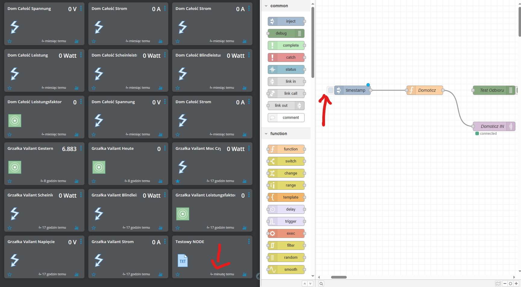

    Added after 17 [minutes]: .
    I think I have some kind of overflow because:
    Domoticz interface with data widgets and Node-RED environment.
    You can see on the block time 2 minutes inactive I click on nodeRed and it will change for a few seconds that is as if this block got some info.
    Screenshot showing Node-RED interface and Domoticz dashboard with widgets.

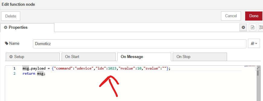

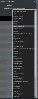

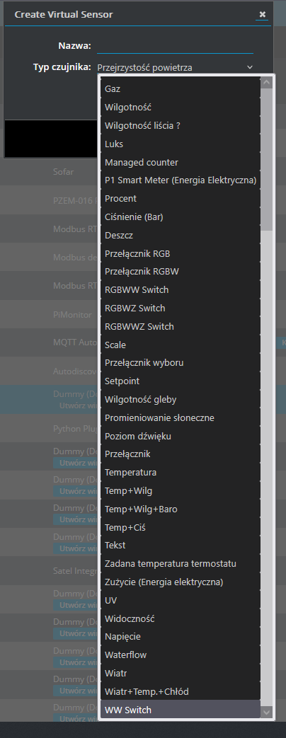

    1. I don't know what type to set the block in domoticz to receive this test:
    Screenshot showing sensor type selection options in Domoticz software. Screenshot of the Create Virtual Sensor in Domoticz with a dropdown menu of sensor types. .
    2. what exactly is to be sent to Domoticz from NodeRed - some text from this:
    Screenshot showing Node-RED function configuration for Domoticz integration. .
    P.S. What I'm trying to do is as if I've set about doing an electrical installation and I can't see what a cable is.
    So this value of 10 should appear in domoticz:
    Screenshot of a function node in Node-RED with command configuration for Domoticz. .
    Yes.
    Try some block in domoticz that shows something. Could be some sort of power meter.
    It will be immediately ready for data from the inverter.

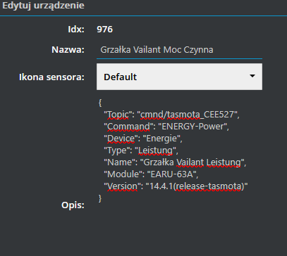

  • Active power topic from Tasmota energy meter
    #14 21433564
    Daro1003
    Posts: 2713
    Help: 295
    Rate: 606

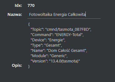

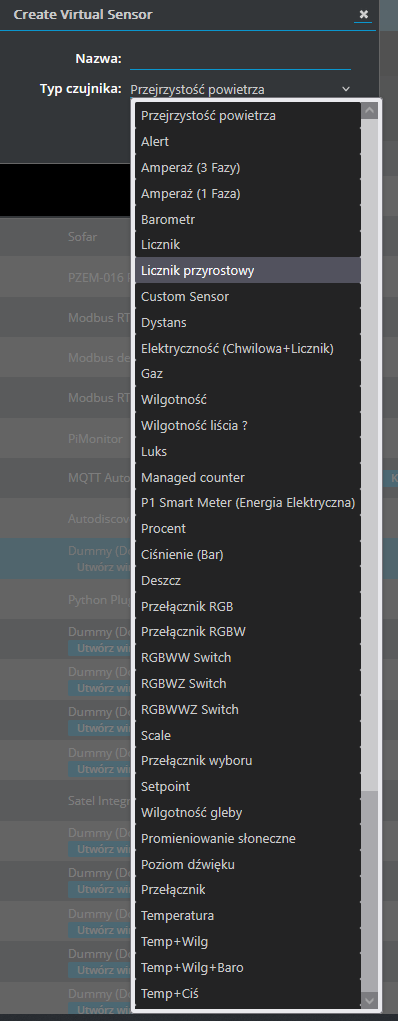

    It does not transmit this value only this time changes i.e. you can see how it would violate.
    I tried different temperature blocks, text, percentage, counter.
    If I give a block from the energy meter sent by Tasmota, here you can see the topic that is coming from Tasmota:
    Screenshot of Tasmota data related to energy monitoring. .
    Active power:
    Screenshot of active power sensor configuration interface with Tasmota.

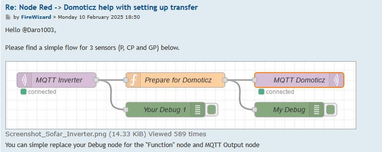

  • #17 21434690
    michal.zd
    Posts: 1684
    Help: 84
    Rate: 274
    He has given you the whole flow, copy everything from the code to a file and import it into node-red into a new empty flow.
    Changes need to be made to the node in and out and it should work
    Somewhere in the menu is the import

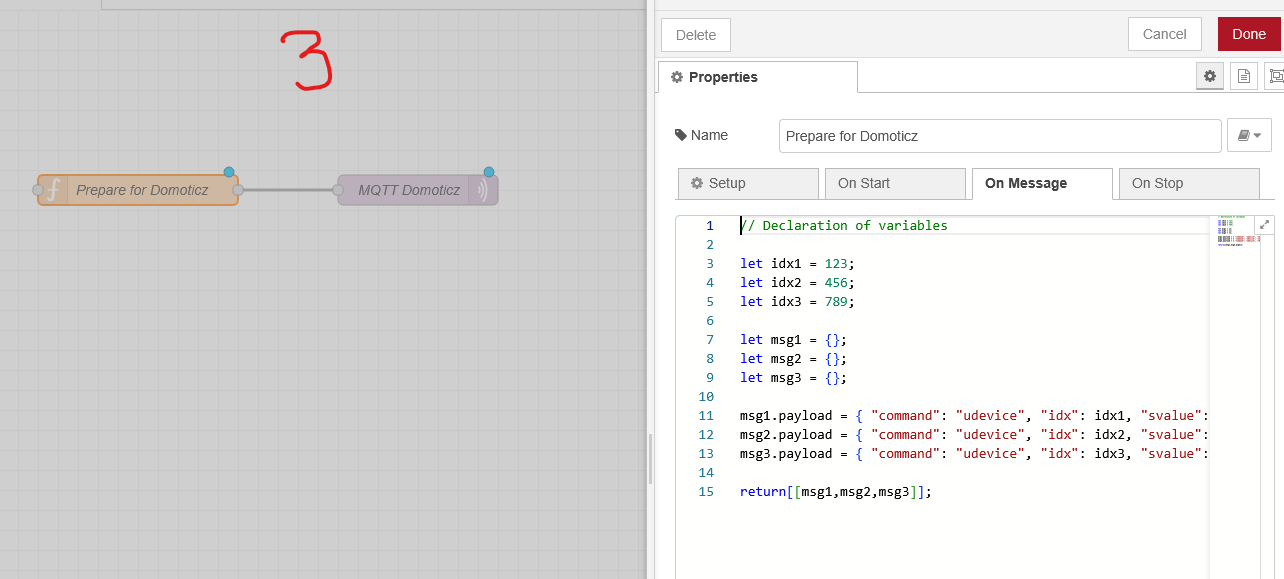

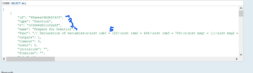

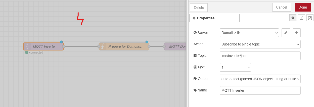

    Do I insert IDX from Domoticz in these underlined places ?
    It says: "Edit the "Function" node and replace in line 3, your Domoticz idx number for P."
    So in line 3 and this is not line 3 for me it is line 5.
    Screenshot of code with line annotations. .
  • #19 21438078
    michal.zd
    Posts: 1684
    Help: 84
    Rate: 274
    No
    These are the data to import into node-red, they describe the whole flow.

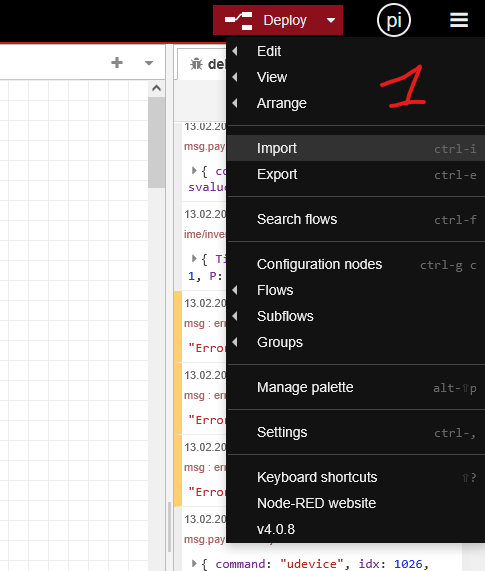

    Do as I wrote earlier, copy the whole thing to a file, then in node-red use the import option.
    Then there will be a new flow with nodes as in the colleague who forwarded it to you.
    Only after that complete the node definitions to mqtt, first and last.

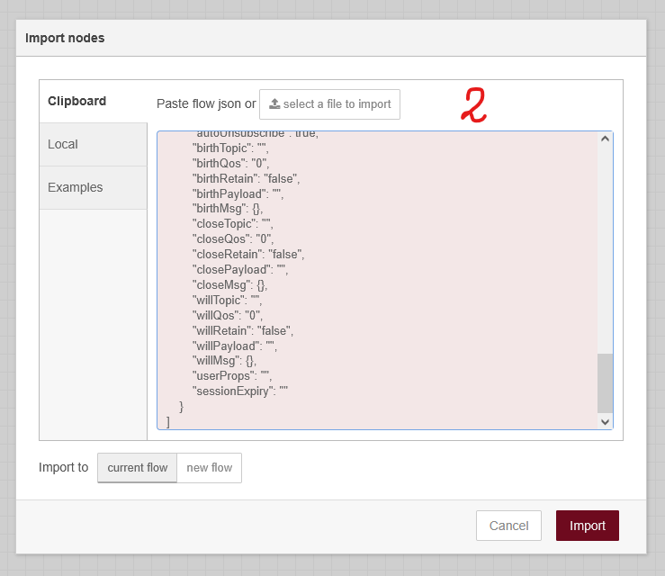

  • Importing the flow and asking about next setup steps
    #20 21439117
    Daro1003
    Posts: 2713
    Help: 295
    Rate: 606

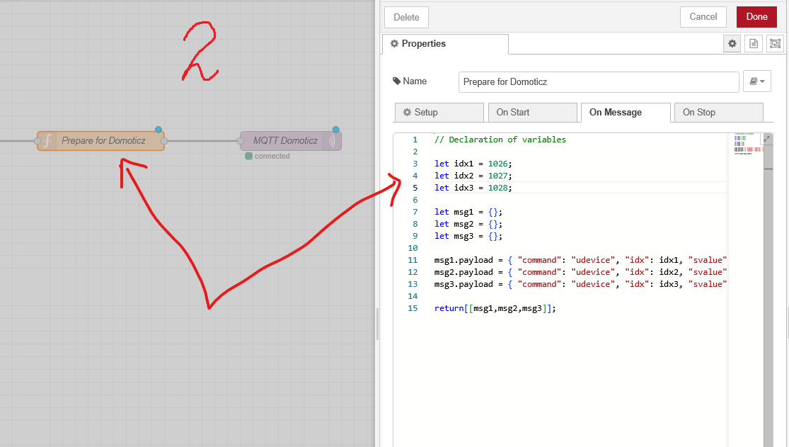

    A So I click on options and give import as in image 1.
    Dropdown menu in Node-RED with the Import option highlighted. .
    In the window as in image 2 I paste the given code and give import.
    Node import window with pasted JSON code. .
    Two nodes appear to me as in image 3 and I guess the whole flow should appear like this:
    Screenshot of a Node-RED flow configured to transfer data from MQTT to Domoticz using three nodes. .
    I click on nod F and I have as in image 3 and there I change the IDXs to my own ?
    Two connected nodes Prepare for Domoticz and MQTT Domoticz with visible script.
    And what next ? I create a nod as in image 4 which was previously for testing ??
    User interface with a node graph, including MQTT Inverter and Prepare for Domoticz.

    Daro1003 wrote:
    And what next ?
    What you have imported is the finished flow, you already have in it from the left str reading the information from mosquitto, set the appropriate parameters in it as from the old one. The last one on the right passes the information back to mosquitto and it passes it to domoticz. You must configure it accordingly.
    xury wrote:
    Through modbus or via LSW3?
    Via LWS3 modbusTCP. But through my program, writing this information to mosquitto.
    Node-red is supposed to receive it from mosquitto and pass it to domoticz.

    Daro1003 wrote:
    I get two nodes like in image 3 and I guess the whole flow should appear like this:
    Hmm, unless a colleague has only specified these two.
    If so, include your node that receives data from mosquitto.

    If anything happens to that topic I will paste the flow to be imported in NodeRed:
            "id": "9faeea04b2b50403",
            "type": "function",
            "z": "c03666d911c02a8f",
            "name": "Prepare for Domoticz",
            "func": "// Declaration of variables\n\nlet idx1 = 123;\nlet idx2 = 456;\nlet idx3 = 789;\n\nlet msg1 = {};\nlet msg2 = {};\nlet msg3 = {};\n\nmsg1.payload = { \"command\": \"udevice\", \"idx\": idx1, \"svalue\": msg.payload.P.toString() + \";0\"};\nmsg2.payload = { \"command\": \"udevice\", \"idx\": idx2, \"svalue\": msg.payload.GP.toString() + \";0\" };\nmsg3.payload = { \"command\": \"udevice\", \"idx\": idx3, \"svalue\": msg.payload.CP.toString() + \";0\" };\n\nreturn[[msg1,msg2,msg3]];",
            "outputs": 1,

    1 You need to edit the IP address of the broker:
    Screenshot of Node-RED editor showing an MQTT flow. 2.
    2. you need to edit the IDXs:
    Screenshot of Node-RED editor showing a flow with a function Prepare for Domoticz. 3.
    3. attach data from Sofar and it should work:
    Screenshot of a Node-RED flow for integrating Domoticz using MQTT. 3.
