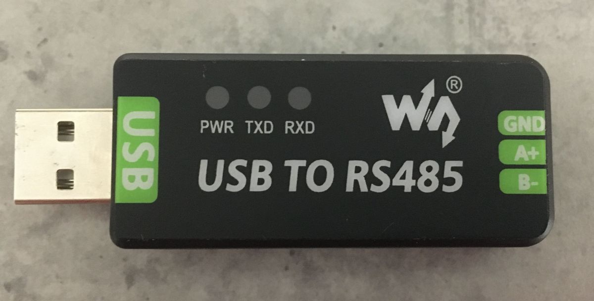

    I would like to communicate the domoticz with the recuperator. For this I bought:
    Domoticz and the Vents VUT R 600 VE EC A21 recuperator: communication via Modbus and Raspberry Pi

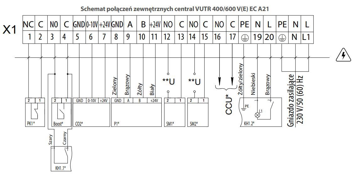

    I connected in parallel to the A+ B- and GND to the keypad.
    How do I now handle this programmatically so that domoticz can see the available options ? E.g. temperatures ?

    It seems to me that this A21 only embedded on the motherboard and other controllers plugged into the board work on this.

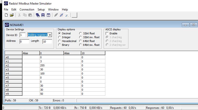

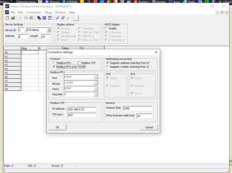

    Test Modbus TCP input registers from address 0
    #9 20561989
    starob
    Posts: 1088
    Help: 128
    Rate: 137
    Daro1003 wrote:
    what to ask at vents for what data exactly.
    Basically it's about nothing :) in the document linked earlier is everything.

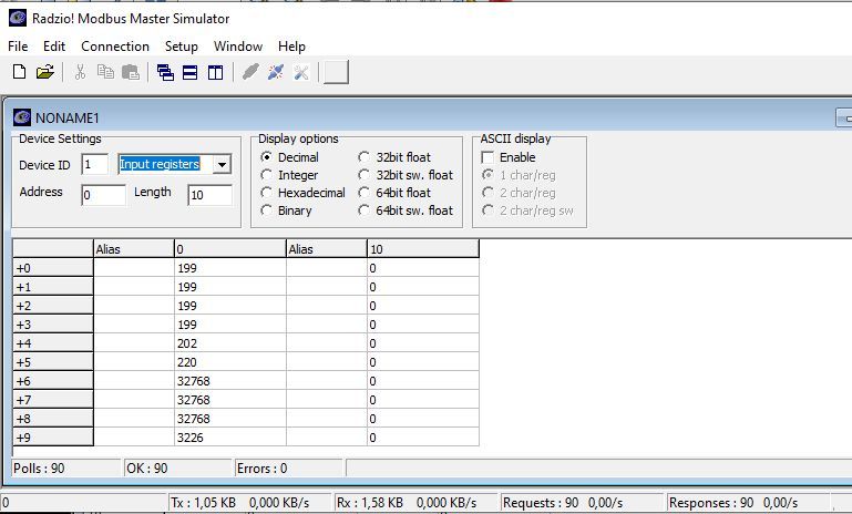

    1. If you already have any control device connected after RS485, you are only left with WiFi or Eth.
    2. To start - as @zuhjk wrote - fire it up on your PC, Download the subliked MasterSimulator.
    and configure in it the ModusTCP connection Ip:recuperator port:502
    3. Now you can try to read the InputRegister from address 0.
    If you manage to read something meaningful and compatible with this table - you can try to integrate it with Domoticz.

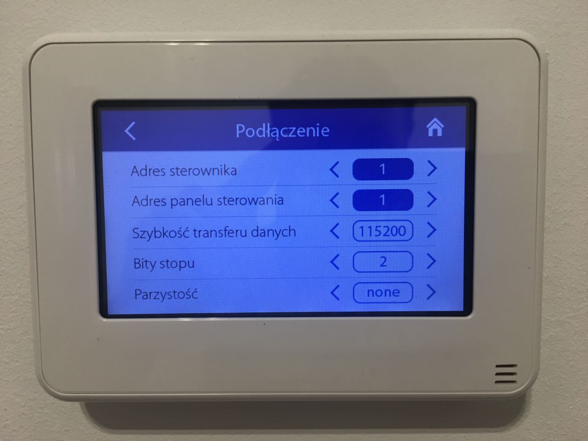

    1. If after RS485 you have already connected any control device,
    Yes I have connected such a keypad with data as shown on the screen:
    So if there is one keypad then nothing else will work ??

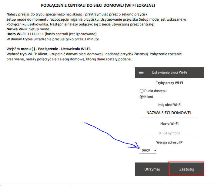

    Daro1003 wrote:
    Here is the problem because I don't know the IP address of the recuperator connected via Wi-Fi it gets some there from the pool
    Try to ;) It must be saved somewhere in the router! In addition there will be somewhere an option p.t. about "Mac filter", which allows by mac address to assign a fixed IP.
    If there is not then it is time to change the router ;)
    Beyond that probably here changes the address type Static<>DHCP
    Domoticz and the Vents VUT R 600 VE EC A21 recuperator: communication via Modbus and Raspberry Pi .

    starob wrote:
    Other than that, probably here changes the address type Static<>DHCP

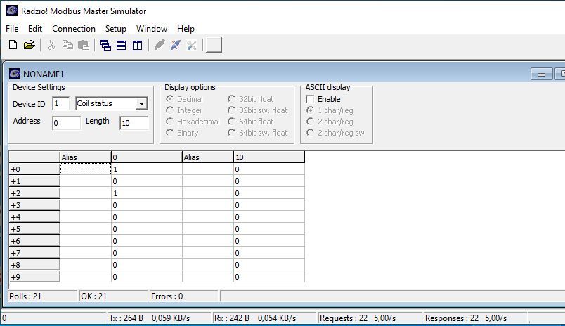

    It is at this point that a fixed IP is set, but a wired connection I tried this and after saving the settings returns itself to DHCP if I do not have a LAN connected but Wi-Fi but LAN is not a problem.
    Is this how a configured connection should look like:
    Domoticz and the Vents VUT R 600 VE EC A21 recuperator: communication via Modbus and Raspberry Pi Domoticz and the Vents VUT R 600 VE EC A21 recuperator: communication via Modbus and Raspberry Pi
    Something should show up in the table ? Any data ?
    It looks like something is flying:
    Domoticz and the Vents VUT R 600 VE EC A21 recuperator: communication via Modbus and Raspberry Pi Domoticz and the Vents VUT R 600 VE EC A21 recuperator: communication via Modbus and Raspberry Pi [img-0].

    What more does the colleague expect? ...From the test it appears that you can connect and read the registers correctly. Now do the same in domoticz via modbus (as its documentation says).

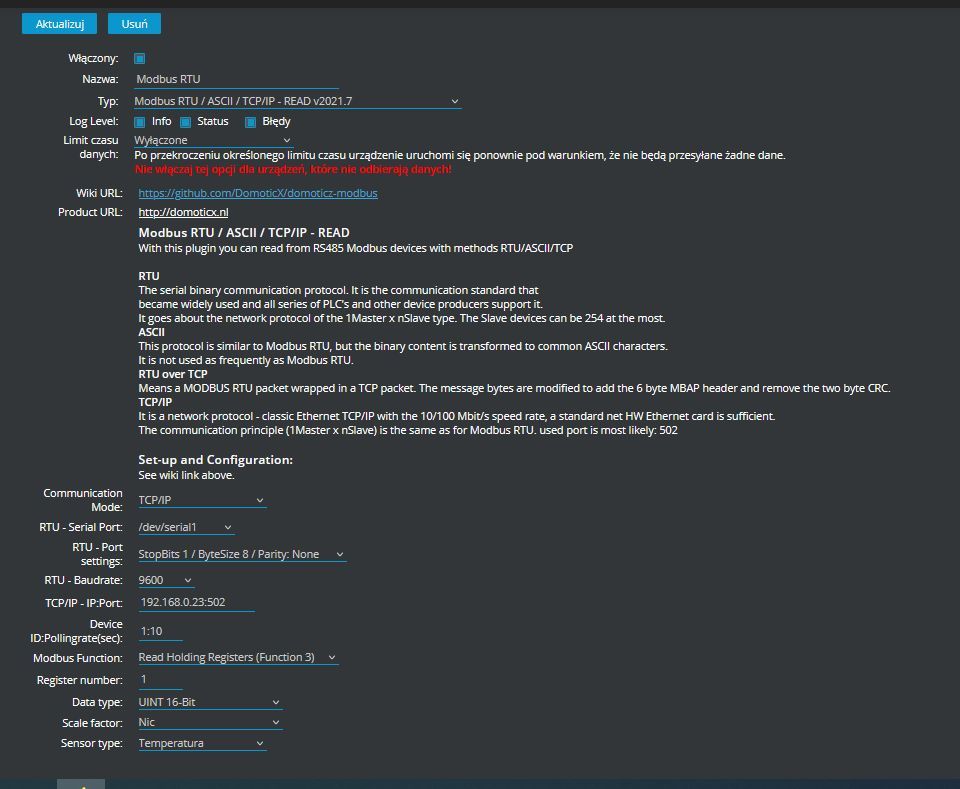

  • Domoticz plugin setup and READ/WRITE confusion
    #15 20582515
    Daro1003
    Posts: 2715
    Help: 295

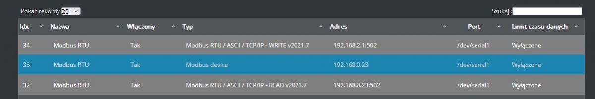

    I just don't know how to set this up in domoticz and whether I have the right plugins.
    When I try to add and change the settings, domoticz crashes for a few minutes and I also can not remove the added plugins:

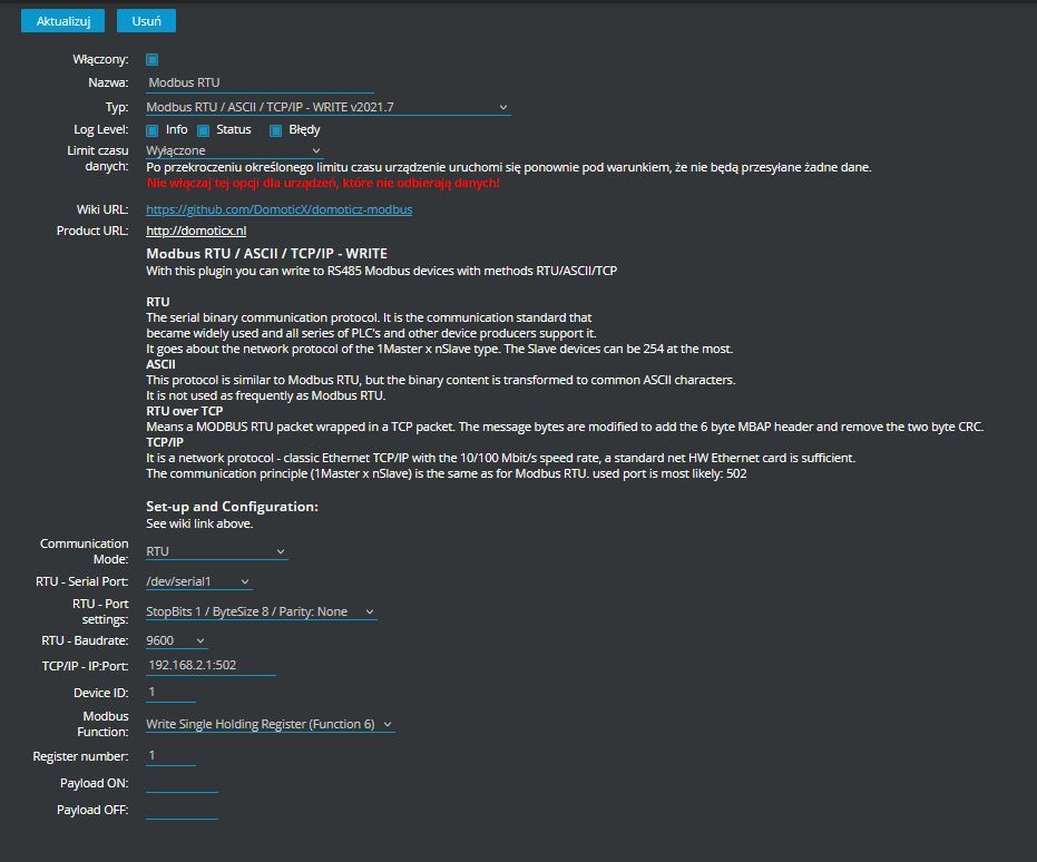

    I don't know if both READ and WRITE are to be added or just one of them and option settings:
  • Modbus mode depends on LAN or USB converter
    #16 20582549
    starob
    Posts: 1088
    Help: 128
    Rate: 137
    You have to decide what you are trasmitting over (what converter you are using).
    Till now it was mentioned about the LAN converter, so you set as in the program RTU over TCP. Then you don't define serial - because it is defined in the converter.
    If you use USB then you set only RTU and omit TCP settings.
    If you only read then READ, if read write then READ and WRITE.
    These are universal rules, I don't remember the details of domoticz itself.

  • Use RTU over TCP read input registers
    #18 20582734
    starob
    Posts: 1088
    Help: 128
    Rate: 137
    It can be done... because from your picture (from radio) you can see the input registers read some temperatures at the level of 19.9C.
    First of all focus on getting the readings in domoticz from one register.
    Comunication mode: RTU over TCP
    Modbus Function: Read Input register
    This must be the same parameters as in the radio program.... remember that other programs communicating via modbus should be switched off while domoticz is running
    .edit ..just what protocol did you get these readings in radio?!
    Because the documentation says it should be Modbus TCP and your pictures suggest Modbos RTU over TCP.

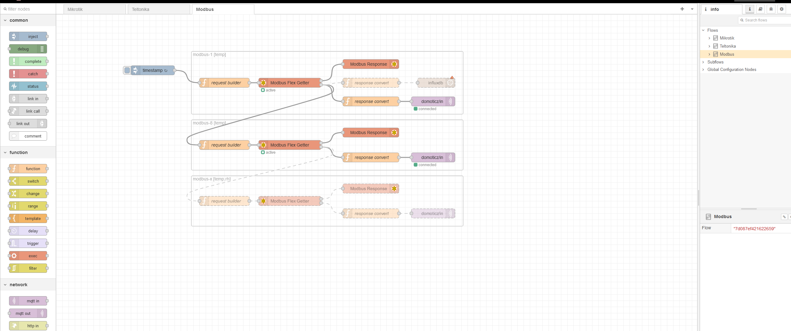

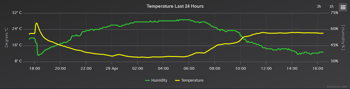

    Now the topic is being embraced. Screenshot of Node-RED with a Modbus flow.
    From blutocz to MQTT and to domoticz
    Graph showing changes in temperature and humidity over the last 24 hours, marked in degrees Celsius and humidity percentage. .

  • The working test path used Modbus TCP-style access to the recuperator IP on port 502 before Domoticz integration. [#20561989]
  • A successful Node-RED read used address 1 and later expanded to 90 registers, matching the Radzio program view. [#21454803]
  • Temperature values arrive scaled by 10, so 199 must be divided by 10 to display 19.9 °C. [#21454831]
