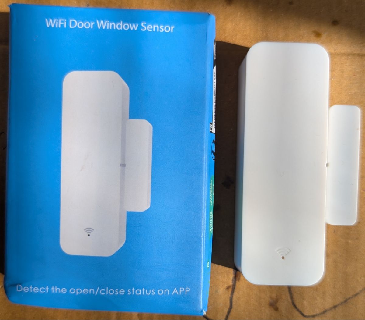

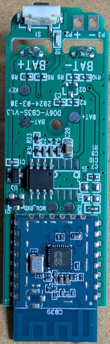

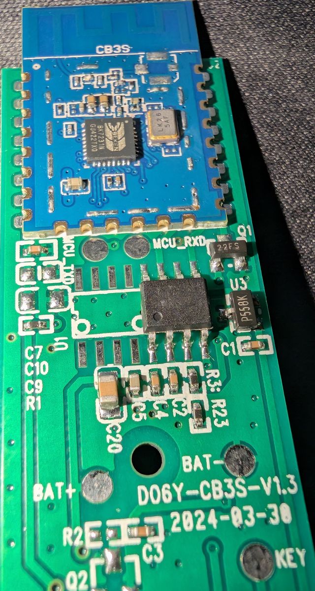

    I ordered a WiFi Door Sensor from AliExpress and received a new version of the D06 sensor. There are mentions of old versions, but I didn't find this new one on the website, so putting up this post. It has a CB3S (BK7231N) chip, which is fairly common among wifi door sensors.
    Images:
    Box and white WiFi door and window sensorNew version of WiFi door sensor with CB3S chip on the circuit board.Close-up of a circuit board with a CB3S WiFi module.
    I have attached the firmware dump. The config retrieved from bk7231flasher is following:

    Then I flashed openbk7231 using bk7231flasher, baud rate of 921600 didn't work for me, I had to flash at 115200. To flash, I used this guide.

    I don't there is anything meaningful in the config. Also there is no label on the 8-pin chip in the center.
