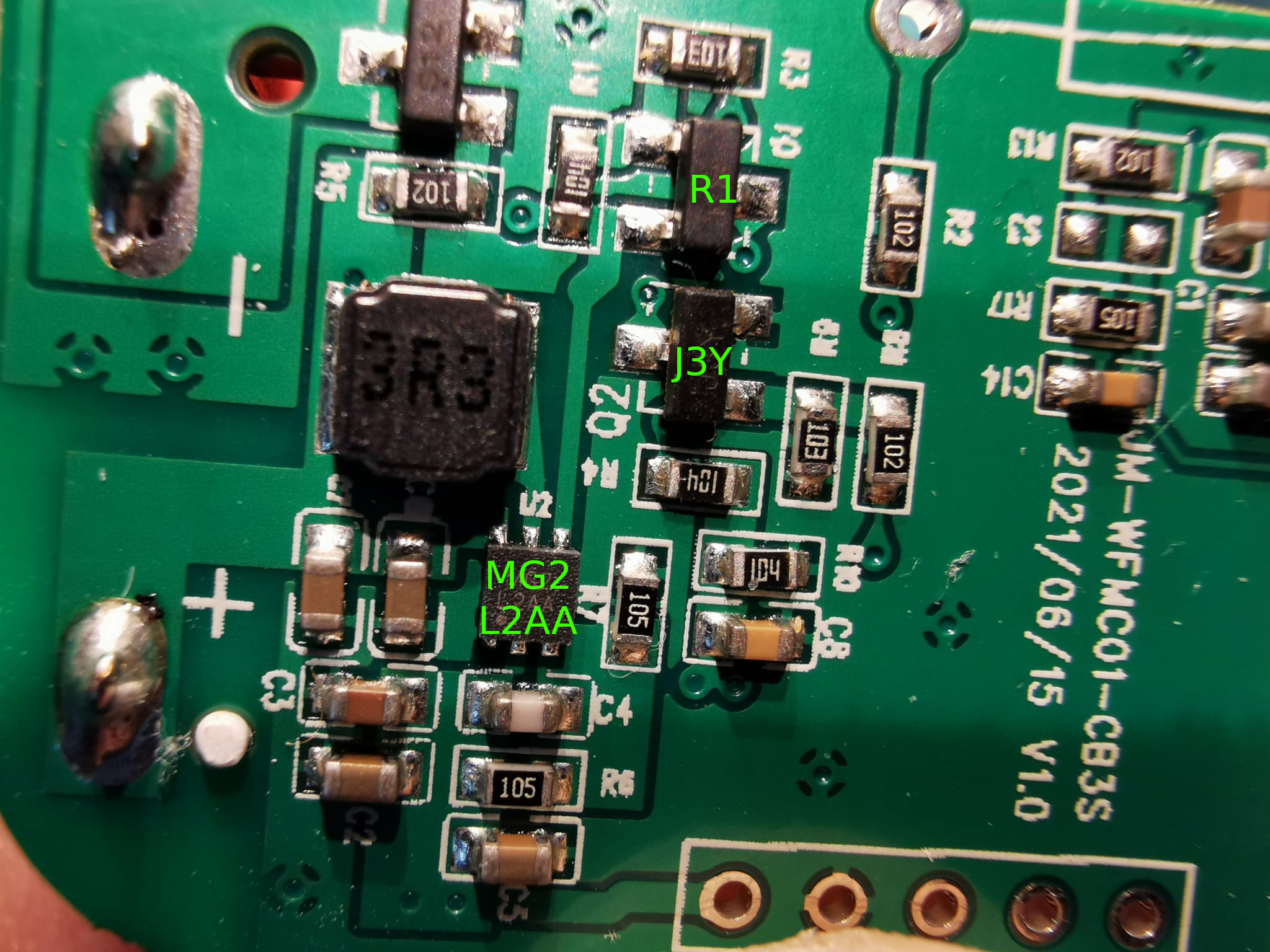

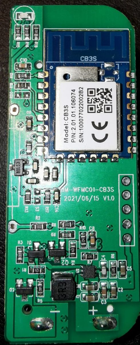

    Hello everyone!
    A reseller on Amazon delivered me a new set of devices when I tried to older some old ESP-based window/door sensors.
    They don't have a name or model printed anywhere, but I found a label on the board:
    JM-WFMC01-CB3S
    2021/06/15 V1.0
    [BK7231N / CB3S] Another Door/Window sensor without TuyaMCU (JM-WFMC01-CB3S V1.0)
    [BK7231N / CB3S] Another Door/Window sensor without TuyaMCU (JM-WFMC01-CB3S V1.0) [BK7231N / CB3S] Another Door/Window sensor without TuyaMCU (JM-WFMC01-CB3S V1.0)
    The board does not have a Tuya MCU chip on it. The only other IC that I could find does not tell me anything through google:
    Beside the sensor status the Tuya integration also provides battery charge information (0% - 100%) and the board has a button accessible on the back side. You have to detach the sensor from the mount to access it.

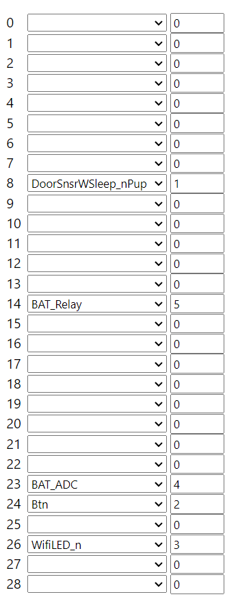

    So far I have managed to get it running using these pin configurations:
      "pins": {
        "8": "DoorSnsrWSleep_nPup;1",
        "24": "Btn;2",
        "26": "WifiLED_n;3"
    And with the following startup arguments:

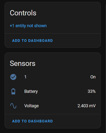

    So far it works as intended. The sensor updates the state in Homeassistant correctly.
    Deepsleep also works and wakes up on a change. The LED is showing Wifi status and the button works for extending deepsleep for debugging uses.

    I was unable to find a way to read the battery charge. Tuya is able to tell in percent how much charge is left in the batteries, but I cannot find any pin with usable data. ADC is always 0.00 and I don't see any specific IC that would provide the information via 1-wire or similar.
    Except for the one labeled MG2 L2AA, but I could not find any information about this online.
    With 18 seconds update time battery life will be sub-optimal.
    I have 5 of these sensors and would very much like getting rid of the original firmware as the Tuya Homeassistant integration is getting more and more unstable.
    Any help would be appreciated!

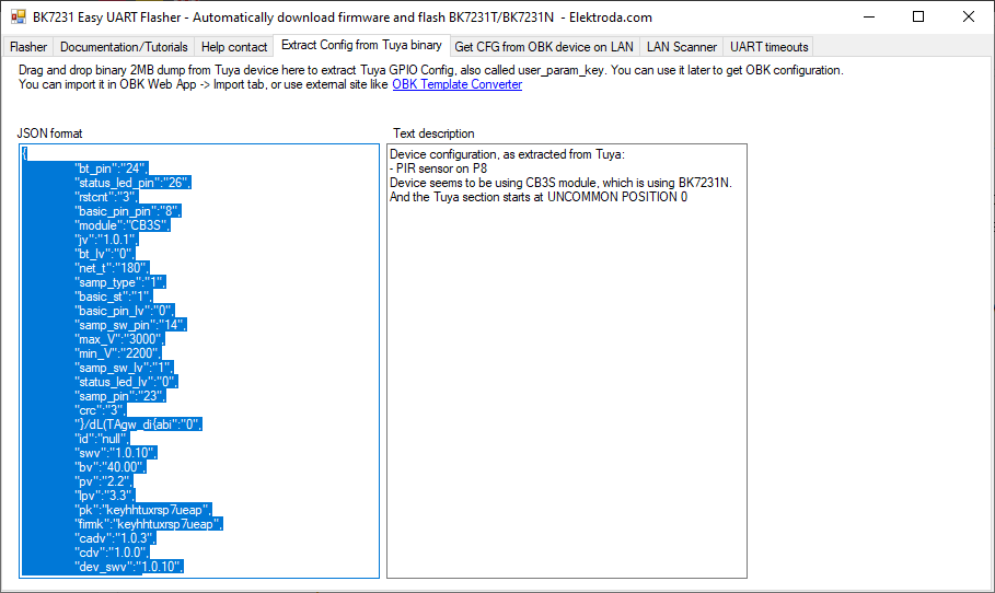

    Hello, do you have a 2MB dump for analysis? Maybe I could find something ADC there.
    Here's a ADC battery driver tutorial:
    https://www.elektroda.com/rtvforum/topic3959103.html
    Regarding battery thing - how fast does your device get to MQTT?
    Open Web App log, let device go to sleep, clear log, wake it up, and paste log here. It will have timestamps.
    (Maybe also remove your SSID/pass from that).
    Btw, does your MAC ends with 00 00 00? It may indicate corrupted RF partition and partially refresh so long, 18 seconds, time. It should be 9 seconds or so, I had OBK devices connecting to MQTT in 5 or so seconds.

    The Tuya Config dump is good.
    Here's content:
    It looks like this device supports ADC check of battery, for example here are voltage ranges:
    Did you made sure to enable correct transistor (gpio) before doing ADC voltage check? Please refer to the linked Battery driver topic, but basically, battery voltage divider is only enabled via transistor.
    Is it your only OBK device? Do other devices also have that problem with connection to WiFi? Please try with another one (or router), if you can. I don't know what's the source of the problem yet.
  • Battery reading working; first Wi-Fi connect still fails

    Alright, I had some more time to test this out.
    I got the battery reading working thanks to your advice!
    Compared to the readout of my multimeter I get fitting values to the state of different battery packs.
    (changed to a max of 2800 since I'm using rechargeables with lower voltage)
    Battery_Setup 2200 2800 2.02 2400 4096
    Battery_Cycle 4
