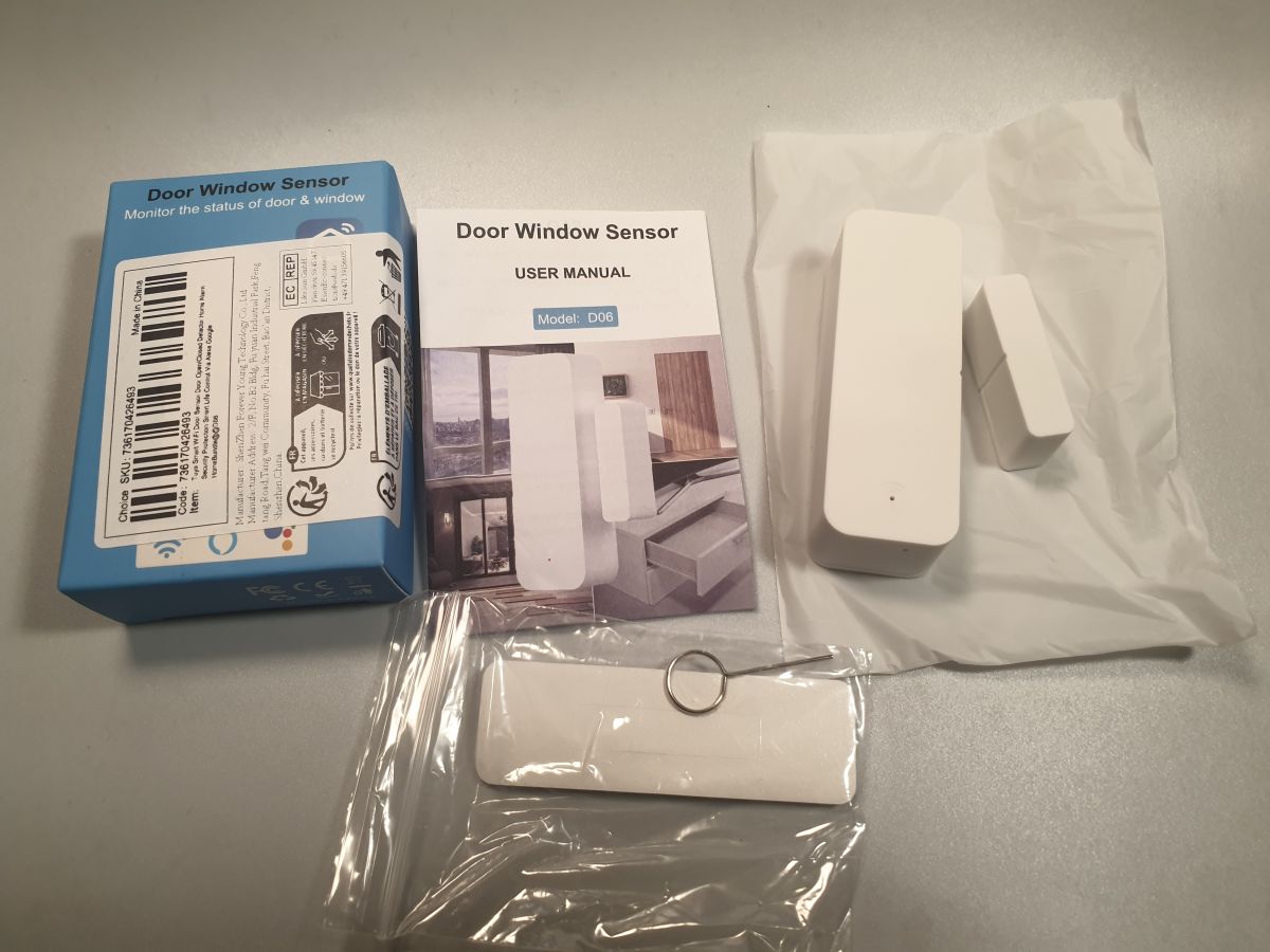

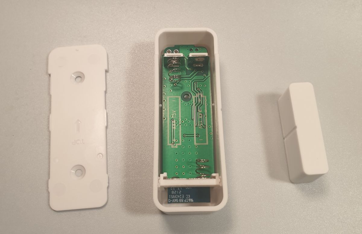

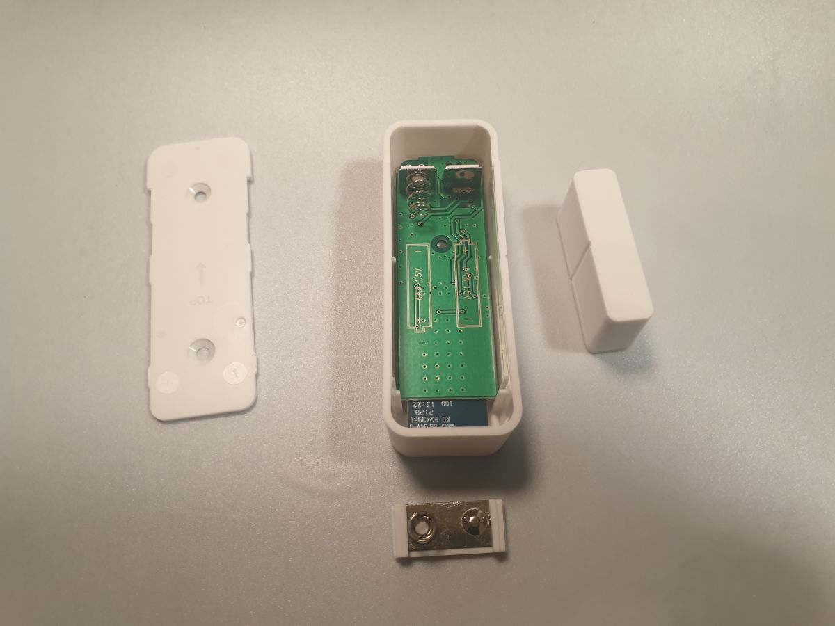

  • One more Door Sensor
    PCB with CB3S module and component markings View of door sensor board with slots for AAA batteries.
    Door and window sensor set with manual and packaging. Photo of an open door sensor casing showing the circuit board. Disassembled DS06 door sensor with visible interior. Disassembled door sensor showing circuit board and casing.

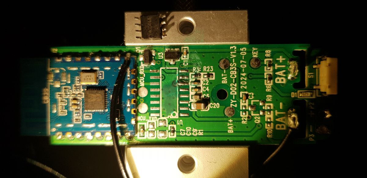

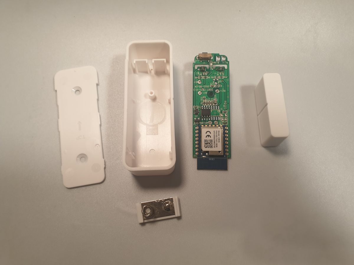

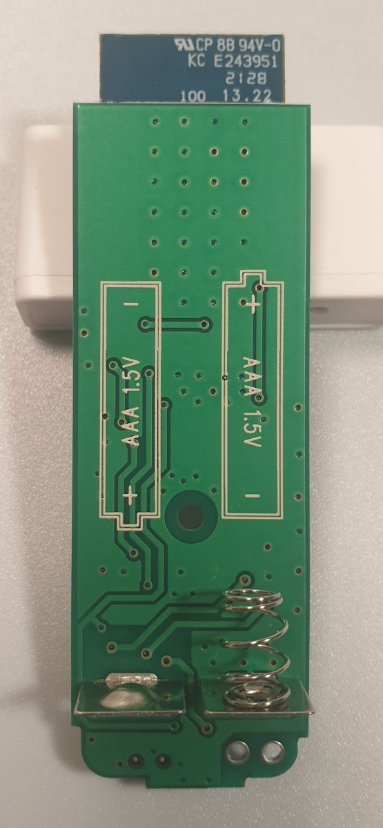

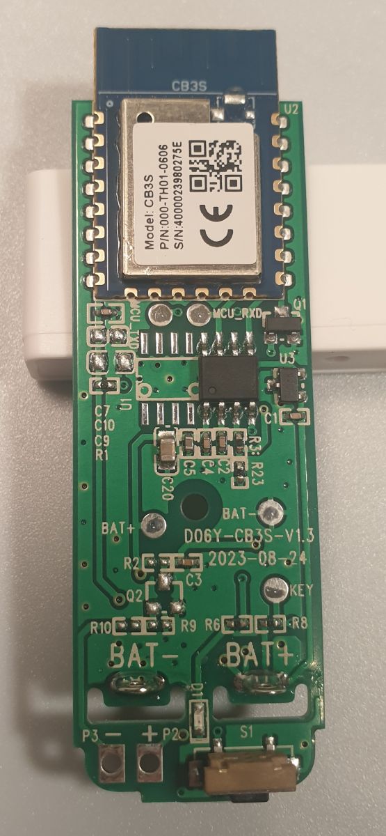

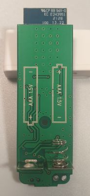

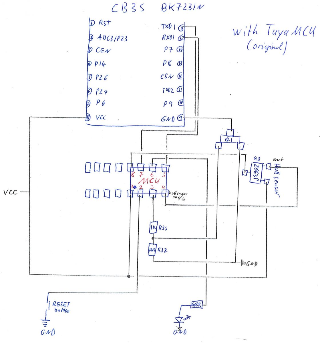

    First Look

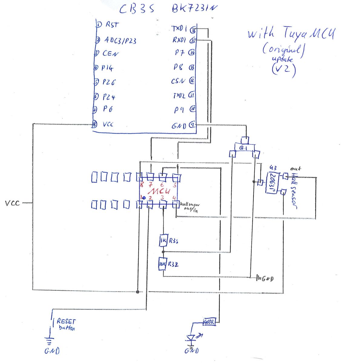

    WiFi Chipset BK7231N/CB3S connected only to TuyaMCU via serial interface. Even LED connected to TuyaMCU.
    TuyaMCU has power control for WiFi module.
    There are two pins on the bottom of the board P3 and P2. Seems like this is for external sensor like a water leak sensor. To use it need Q2, R10, R9. But it use the same TuyaMCU pin that used for Magnetic Field Sensor now. So U3 needs to be dismounted in this case. (??? maybe they have a HighZ output and can work at the same time)

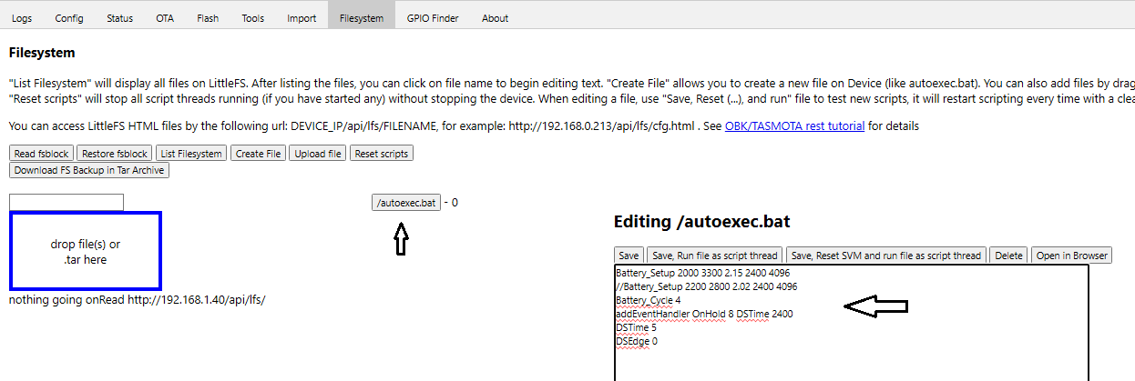

    OpenBK firmware was uploded via serial inteface and working good.
    Draft config
    Pins:
    RX1 and TX1 connected to TuyaMCU.
    TuyaMCU channels
    #1 - Door Sensor (0-Closed, 1-Open)
    #3 - Battery ( 2 -> 3V, 1-> ???, 0->??? )
    Everything exactly like here Energy-saving (?) Battery-operated door / window sensor for WiFi DS06

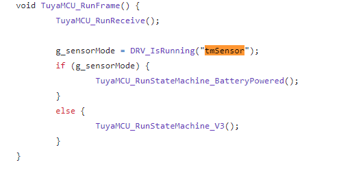

    I can't understand, what "startDriver tmSensor" for?
    Seems like it's in "src/driver/drv_tuyaMCUSensor.c"
    But it's doing nothing. All actions are commented now.
  • tmSensor now integrated into TuyaMCU driver
    #3 20918886
    Posts: 14754
    Rate: 12875
    @CMY I know this is unfortunate, but tmSensor code is now integrated with TuyaMCU driver, so it is still required to run, it's just the functions are in the other file. Everything should be okay once you run it:
    Code snippet showing a function that checks sensor mode status in integration with TuyaMCU.
    This is a legacy thing, that's because in the past tmSensor was totally separate but then it has turned out that we really have to merge them, so we ended up with the following aproach.

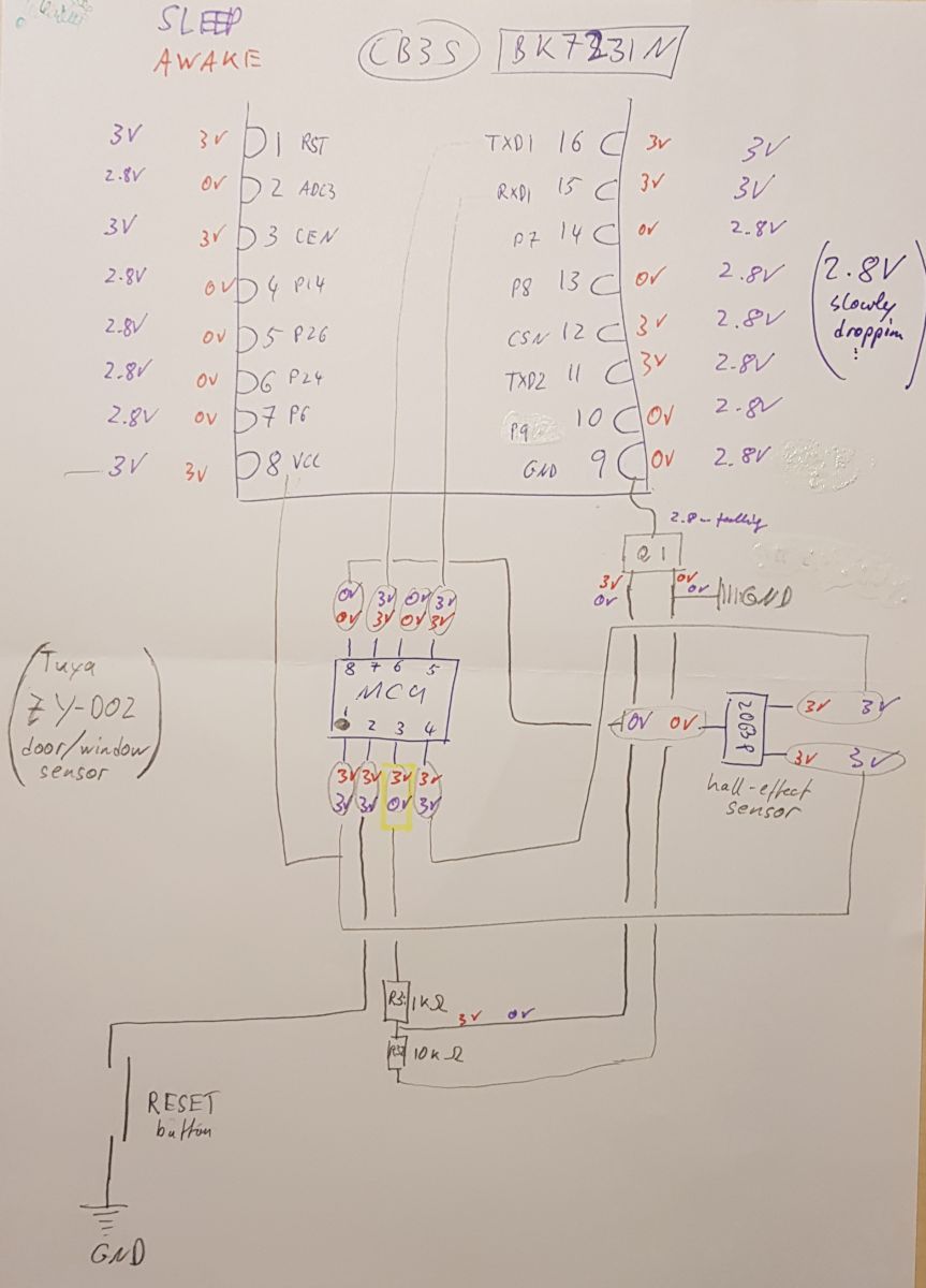

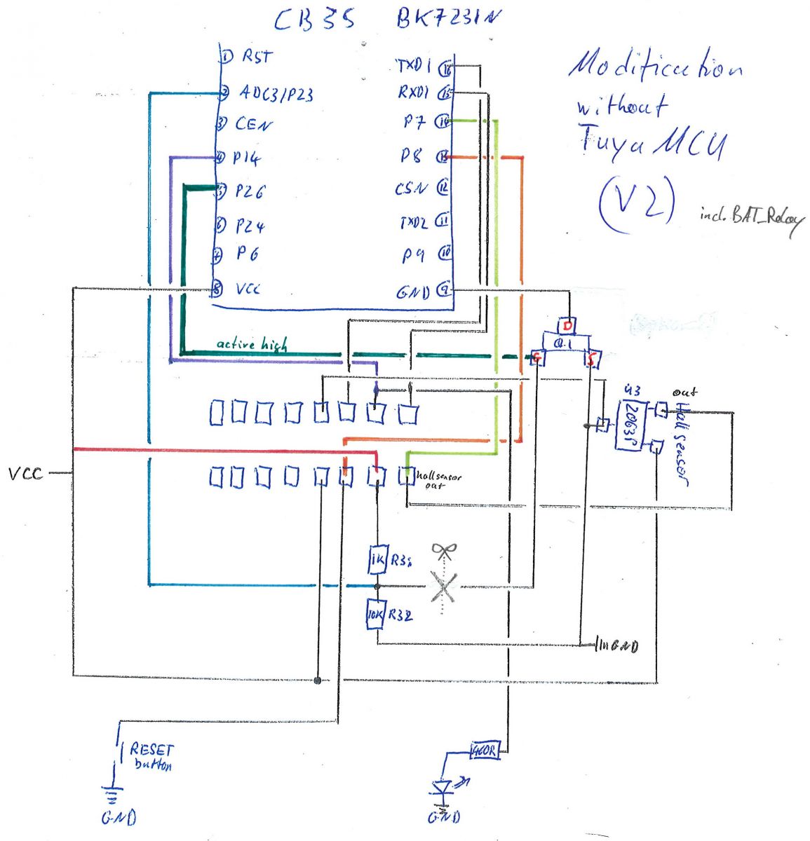

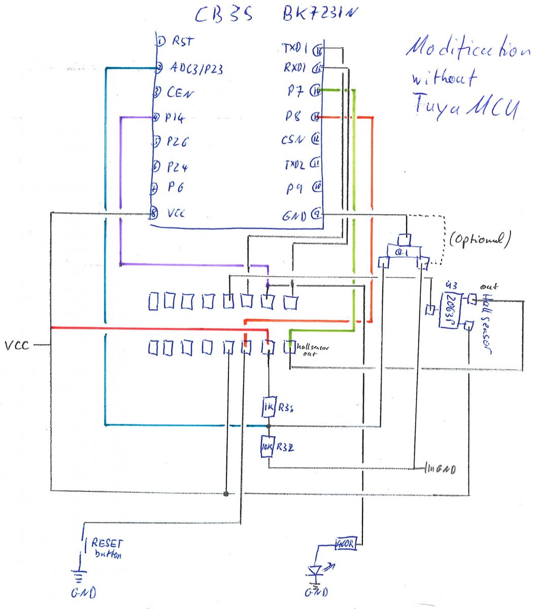

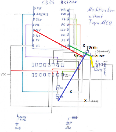

  • Alternative BK7231N door sensor wiring options
    #4 20922013
    CMY
    Posts: 6
    Well, if someone wants, it's always possible to desolder the MCU and rig BK to control everything.
    Sure.
    But in this case better get this one "Door Sensor 19JWT-B (BK7231N)" https://www.elektroda.com/rtvforum/topic4028193.html#20906219
    Or you can
    - remove power controll Triac,
    - connect WiFi chip pin ground to Bat-
    - connect PowerControl output from TuyaMCU to some free WiFi pin to get wakeup trigger
    - extra option: connect someWiFi pin to TuyaMCY button (key) pin to have a option for wakeup TyuaMCU from WiFi. In this case WiFi can check door and battery status wherever you want.
  • #5 20922299
    Posts: 14754
    Rate: 12875
    Your concept is very interesting, @CMY , but wouldn't that reduce battery life, with both MCU and BK draining current slowly?
  • Deep sleep test shows BK7231N adds only 7 µA
    #6 20923837
    CMY
    Posts: 6
    I alredy cheked it.
    CMY wrote:
    For a test, I put BK7231N in to DeepSleep mode and all unit has ~20uA. So, It not so good as I was expected, and cutting power from WiFi chip is saving only ecreasing curent from 20uA to 13uA.
    So. Yes, 13uA vs 20uA.
    About +50% in deep sleep mode.
    It is all depends. But if i wanna do this, i will wakeup WiFi module like a every 5 min. And this will be more effected on power consumption.

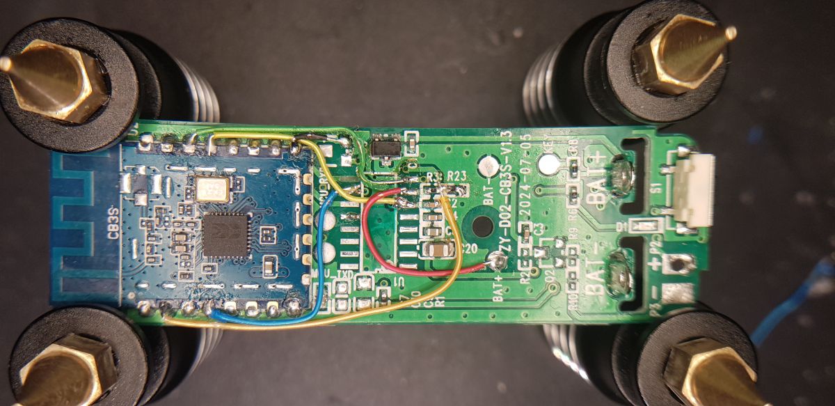

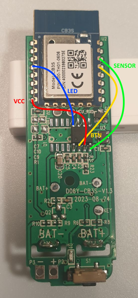

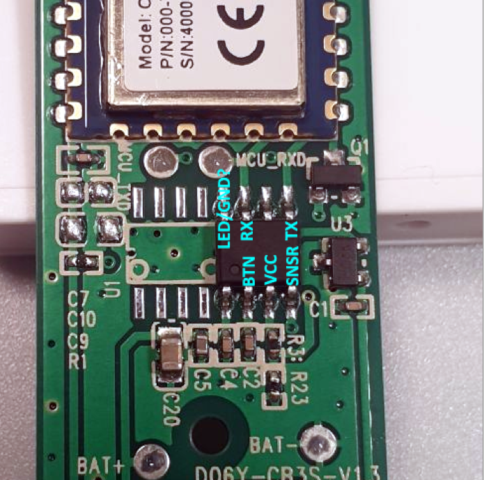

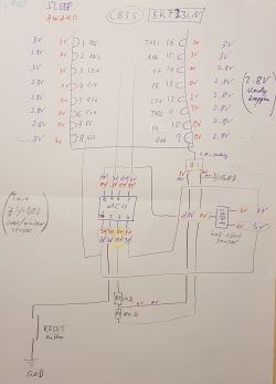

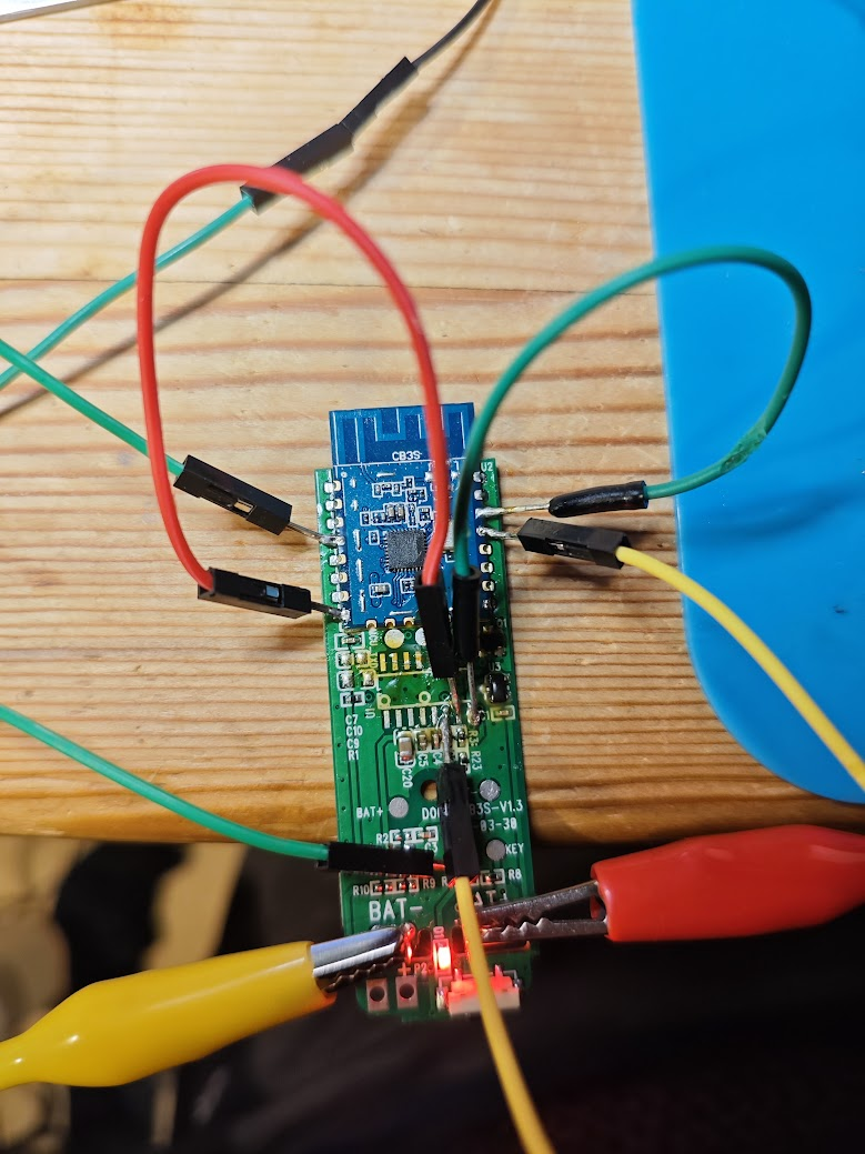

  • Hacky TuyaMCUless pin assignments tested
    #12 21299079
    Posts: 5206
    Help: 446
    Rate: 914
    my hacky TuyaMCUless prototype.
    not 100% sure of the LED/GND situation. And I don't know if there's a BAT_ADC/BAT_REL - could the MCU have done this measurement internally?
    Circuit board with marked pins for TuyaMCUless prototype.
    These assignments work in testing
    "7": "dInput;1",
    "8": "Btn;2",
    "14": "LED;2"
    Electronic circuit prototype with wires and LED on a PCB.
    (I damaged a couple of the MCU pads a while ago which is why the LED cable doesn't go from where labelled)
  • #13 21299315
    Posts: 14754
    Rate: 12875
    Nice, does deep sleep work as well?
    Also... your MCU was in SO8 case? That seems unusual for me. I saw many devices with SO16-etc MCUs.
  • #14 21299423
    Posts: 5206
    Help: 446
    Rate: 914
    yes. with:
    "7": "DoorSnsrWSleep;1",
    "8": "Btn;2",
    "14": "WifiLED;2"
    same wake with button. no additional DSEdge config. Closed/magnet = channel 1 value 0, open/no magnet = channel 1 value 1

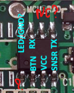

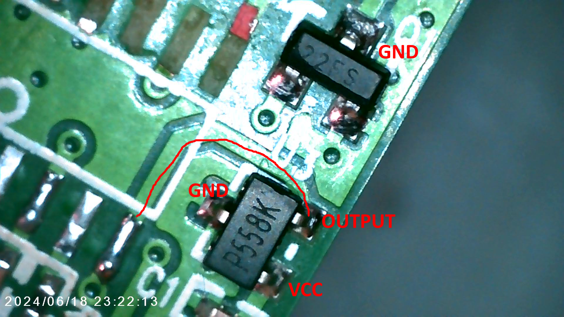

    So it's easier than I expected. Please consider making a separate guide for Smart Home Tutorials section.
    I see you also labeled pins on the MCU - so there is not BAT_ADC pin? I guess you may need to add your own resistors divider and utilize P23 (ADC) of Beken..
    We would need to either check all pins or get MCU datasheet to know if it's checking battery voltage internally.
  • No separate BAT_ADC pin on the MCU
    #16 21301091
    Posts: 5206
    Help: 446
    Rate: 914
    could.do. I also have the solder-less flashing thing to do. I didn't want to distract from you and @DeDaMrAz's upcoming guide and I didn't document what I did in infinite detail ;)
    I don't *think* there's a separate BAT_ADC. I don't think there are enough connected pins left out of the 8 for BAT_REL and ADC.
    A datasheet of the unmarked MCU would certainly be handy...
    I think the top one unlabelled is NC and the bottom left I'm not sure yet. I need to de-solder and clean-up the PCB to look again with fresh eyes.
    Close-up of an unmarked MCU with pin descriptions on a PCB.
    Added after 31 [minutes]:
    I wonder if we'll ever get to know about these unmarked MCUs. The D06, like TH01, S06 etc, are made by Shenzhen Forever Young Technology Co Ltd. - http://www.zz-power.com/cate-5703.html

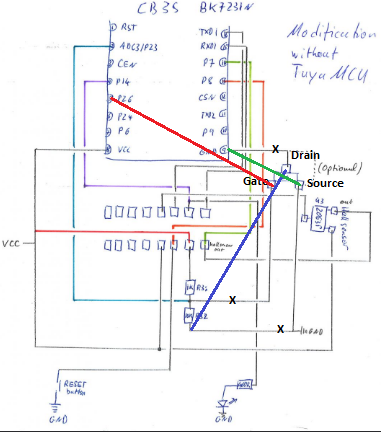

  • Need schematic or bridge points for tuyaless mode

    I didn't do any more, but the steps to date can be boiled down to:
    -remove TuyaMCU with solder sausage method (demonstrated here https://www.youtube.com/watch?v=fSbeKwCCMHM)
    -solder wires between these points:
    Circuit board with soldered wires marked with colors: VCC in red, LED in blue, SENSOR in green, BTN in yellow.
    -set pin assignments as in previous post

    bit more info. The P558K component is a hall-effect sensor. This is what the magnet needs to get close to
    Close-up of a circuit board with a marked P558K element, which is a Hall effect sensor.

    I’m using the ZY-D02, which seems nearly identical to the D06 (mine uses a 2063P hall sensor and lacks the CB3S metal shield).
    In case someone else is looking for this, here a short summary:
    Power Management:
    The ZY-D02 uses hardware-based power control. Instead of firmware deep sleep, the TuyaMCU (8-pin IC) controls Q1 (a transistor or MOSFET) to physically cut the CB3S ground, completely powering it down.
    Wake-Up Behavior:
    The Hall sensor (2063P) detects state changes (magnet present/removed) and signals the TuyaMCU, which temporarily restores power to the CB3S ~ less than a minute (?).
    This makes it impossible to access the OpenBK AP unless you manually short the CB3S ground (pin 9) to the board ground, bypassing the power cutting Q1. Once bypassed the AP becomes accessible - the board draws 0.2W.
    (CB3S: https://developer.tuya.com/en/docs/iot/cb3s?id=Kai94mec0s076)
    TuyaMCU Communication of state changes
    The Hall sensor does not connect directly to the CB3S but communicates with it via the TuyaMCU over UART (TXD1 and RXD1 of the CB3S).
    A state change wakes up the CB3S by changing pin 3 of the MCU to high, which will turn on Q1 and restore the GND connection to the CB3S.
    The same can be achieved via the Reset button, which will pull down pin 2 of the MCU.
    As long as pin 3 of the MCU is high (3V), the MCU communicates the state via UART to the CB3S (MCU pin 5/7, CB3S pin 15/16).
    The following drawing shows the traces I tracked by continuity measurements and the potentials on the previously mentioned components when the door sensor is awake and sleeping:
    Connection diagram of ZY-D02 door sensor with MCU and hall sensor.
    At this point I found this board/thread and like the proposal to remove the MCU and just solder some wires.
    However, I am wondering whether there is not a solution by decoding the UART signal. In that case the MCU would not have to be removed. Unfortunately, I don't know how any information sniffed from the UART communication could be integrated into OpenBK. I am new to this. Anyhow, maybe there is someone out there who might know?
    [edit]
    My MCU has a label (below): Y46D44A .... unfortunately, google doesn't know it
    Close-up of ZY-D02 electronic board with CB3S
    [/edit]
    100% yes but this thread morphed into how one would take the TuyaMCU out of the equation if desired. This would mean giving OpenBeken complete control over the device for features like deepsleep, rather than being at the mercy of the TuyaMCU.
  • Battery voltage readout via CB3S ADC3 divider
    #24 21352505
    daherbst85
    Level 4  
    Posts: 8
    Ok, I also did it this way and it works fine. The only thing I did differently was that I soldered pin 9 (GND) of the CB3S to GND instead of pin 8 (VCC) to the former MCU pin 3 pad, which switching the NPN transistor ...
    Anyhow, the remaining modification would be to read the battery voltage as you guys pointed out earlier.
    For that I used the internal voltage divider (R3:, 1k and R23, 10k). If you wired VCC to the former MCU pin 3 pad, it can be used directly (see my previous drawing).
    Then I soldered a wire between P23 / ADC3 / pin 2 (CB3S) and the two resistors.
    This should give me a multiplier of 1.1.
    Close-up of a circuit board with soldered wires and a CB3S module.
    (I removed the NPN transistor because I started melting wires when trying to solder the CB3S GND to the transistors GND ... it is not necessary to remove it - and you shouldn't if you don't add the GND connection ...)
    Somewhere I read that the maximum for the pin is 3.3V. (so it might be even fine without voltage divider?!?)
    "7": "DoorSnsrWSleep;1;0",
    "8": "Btn;1;1",
    "14": "LED;1",
    "23": "BAT_ADC;3"
    Since I am new to openBK, could someone advise me on setting this up in the interface?
    In the configure mode there is an BAT_ADC option, but I can't find any option to add a multiplier. For BAT_ADC the documentation says that 2400mV is the maximum and is measured as a reference to some other pin?!?
    When I change the option to ADC, no voltage is reported at all.
    Could anyone give me some advise?
    Thanks!
    [edit]
    @divadiow: I think there is a little mistake in your wiring diagram. The P14 / LED pin 4 (CB3S) should be wired to the former pad of the MCU pin 6 (second from the right), not 8. Otherwise the LED doesn't work.
    Wiring diagram for CB3S with Tuya MCU.
    Wiring diagram of a circuit with CB3S and BK7231N.
    [/edit]

    This is the configuration of a door sensor with CB3S module:
    "pines": {
    "7": "Btn;0",
    "14": "BAT_Relay;3",
    "8": "DoorSnsrWSleep_nPup;1",
    "23" : "BAT_ADC;4",
    "26": "WifiLED;2"
    P7 and P8 coincide, but you have P14 connected to the LED. You can change it to P26 and use P14 to connect it to the gate of Q1 (which is now connected to the junction of R31/R32).
    In my opinion, the correct connection of Q1 would be:
    Gate -> P14
    Source -> GND
    Drain -> R32
    When P14 High Q1 saturates and sets R32 to GND To read the battery level through P23.
    Or you can leave P14 as is and connect P26 to the gate of Q1. Then change:
    "pines": {
    "8": "Btn;0",
    "26": "BAT_Relay;3",
    "7": "DoorSnsrWSleep_nPup;1",
    "23" : "BAT_ADC;4",
    "14": "WifiLED;2"
    Door sensor wiring diagram with CB3S module
    autoexec.bat:
    Battery_Setup 2000 3300 2.15 2400 4096
    //Battery_Setup 2200 2800 2.02 2400 4096
    Battery_Cycle 4
    addEventHandler OnHold 8 DSTime 2400
    DSTime 5
    DSEdge 0
  • Clarifying BAT_Relay cutoff and Q1 trace swap
    #26 21353496
    daherbst85
    Level 4  
    Posts: 8
    Interesting, thanks!
    I was already wondering how an under voltage state could be avoided. So does the BAT_Relay take care of that via cutting the GND connection of the CB3S?
    Can I assume that the cutoff voltage is 2.5V (for two AAA batteries in series) or is it possible to set the level somewhere?
    So you suggest to cut the trace between R3:/R32 and the gate of Q1 and connecting it to P26, which makes perfectly sense!
    However, in case of an N-channel mosfet (Q1), the other two traces should be just fine as they are, aren't they (your X-es and new connections indicate a swap)?
    I am not sure what the autoexec.bat part means (I am new to OpenBK ... sorry).
    Thanks!
    (I think I damaged the mosfet when I removed it ... I have ordered more sensors and it might take a few weeks until I can try it.)
  • BAT_Relay cuts CB3S ground and battery threshold is configurable
    #27 21353795
    spin55
    Posts: 209
    Help: 17
    Rate: 42
    BAT_Relay takes care of that by cutting the GND connection of Q1 through P26 controlling Gate. Pin 9 of CB3S has to be at GND permanently.
    Battery_Setup 2000 3300 2.15 2400 4096. Via parameter (2.15) corrects the R31-R32 divider ratio that is applied to P23 ADC.
    The X mean track interruption.

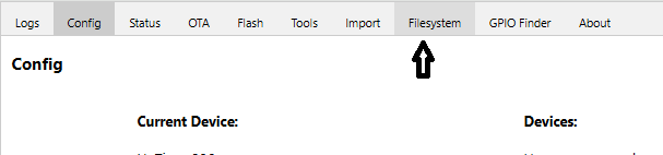

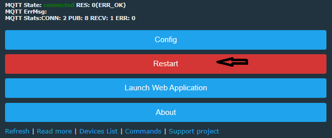

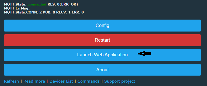

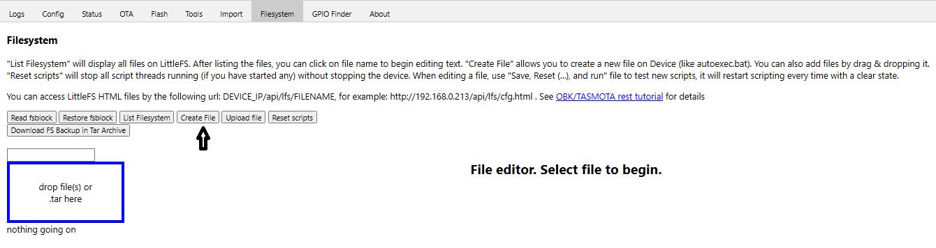

    autoexec.bat is a file that must be created from the Openbeken website to load the corresponding drivers.
    User interface of a web application with buttons: Config, Restart, Launch Web Application, About. Screenshot of a navigation menu with the Filesystem option highlighted. Screenshot of the Filesystem interface in the OpenBeken panel with the Create File button highlighted. Screenshot of the Openbeken interface with file editor, including autoexec.bat. Screenshot of the user interface with a Restart button.
    And the Vcc connection is missing in the hall effect transistor.
    Electronic schematic with highlighted connections and breaks.
  • Questioning BAT_Relay wiring and cutoff behavior
    #28 21354059
    daherbst85
    Level 4  
    Posts: 8
    Thanks for the clarification! Very helpful!
    (Sidenote: Everything worked as I drew it before, just without battery)
    But I feel a few things got more confusing.
    I got that X means that the trace should be cut, but you draw 3 cut. One makes sense to me, the other two don't:
    spin55 wrote:
    To me that sounds contradictory. You have drawn a line from Pin 9 (GND) of the CB3S to the pin that you labeled correctly as source (Q1), which is already at GND level. Like that Pin 9 is always grounded. Now, in case of an under voltage, P26 should go low at the gate and Q1 should interrupt the connection from the drain to the source. Since you labeled the connection of P9 to the drain with an X, the trace should be cut and the GND connection (as in the original circuitry with the MCU) will never be interrupted. Instead, now the GND connection of R23 (sorry I previously wrote R32) is interrupted (your second modification X to GND and blue line to drain). This would eliminate the GND connection of the voltage divider and ADC3/P23 would be floating. So I guess it would read random values (?!?) and won't cut power to the CB3S chip.
    In short: When the BAT_relay triggers/goes low, it wouldn't cut power, but (probably) just mess with the ADC pin(?).
    That's why I said that I don't understand why you swapped the connections and think/thought/don't understand, why the two traces were not fine as they were.
    Did you really mean it like that?
    Moreover, I think it might also not be the best idea to have R23 connected to GND via a mosfet, because the drain to source on resistance (RDS(on)) would add to R23 of the voltage divider, influencing the measurement.
    spin55 wrote:
    Nice! Thanks!
    So here it would be:
    Battery_Setup 2000 3300 1.1 2500 4096 // ADC_min_mV, ADC_max_mV, multiplier, real_critical_mV, ADC_resolution // BAT_Relay triggers at real_critical_mV
    [/quote]
    Excellent that you noticed the missing connection, but it is not VCC that is missing. GND is missing! VCC is already connected to pin 1 of U3, pin 2 is the output, and pin 3 is connected to GND. I forgot the line in my drawing (sorry!). I updated my drawings and hope nobody uses the previous version. The pad of the former MCU pin 8 was GND too.
    The drawn connection would create a shortage and potentially fry something.
    Original (corrected)
    Circuit diagram with CB3S module and MCU, showing power and ground connection modifications.
    Updated with Battery Relay P26 and Q1
    (notably, Q1 is cutting power in exactly the same way to the CB3S as the TuyaMCU did, just with the difference that P26 cuts power when it goes low instead of pin/pad 3 of the former MCU.
    Circuit diagram with CB3S and BK7231N modifications, including BAT_Relay.
    ... please challenge me ... I am not a professional, but just a hobbyist ...
  • Missing GND prevents Hall sensor wake-up
    #29 21354283
    spin55
    Posts: 209
    Help: 17
    Rate: 42
    Yes, you are right it was GND that was missing in the Hall transistor, not Vcc as I said. I'm sorry.
    The reason for adapting to the "standard" one is to correctly use the autoexec.bat drivers. Specifically, BAT_Relay would control Q1 to set GND R32 to read the battery level through P23 (ADC). I suppose this is floating until the measurement needs to be made so that there is no consumption when the device is not online. Please note that it is a battery powered device.
    I think PinDeepSleep is integrated into the drivers. To cause the chip to reset when there is a state change in P7/P8, you need to have GND connected. But in your setup, GND is controlled by Q1 and P26. And I don't think it will wake up because there is no GND and it cannot detect a change of state in P7/P8 (I have not verified this but it is evident that if you do not close a circuit to ground it is floating and there is no current consumption).
    Then, since you have to have P9 connected to GND permanently, take advantage of Q1 so that the drivers are compatible and work with the standard configuration.
    Circuit modification schematic of a transistor with marked connections.

What is the tmSensor driver in OpenBeken, and why does a battery-powered TuyaMCU sensor still need startDriver tmSensor even though its code was merged into the TuyaMCU driver?
You still need startDriver tmSensor because OpenBeken keeps that startup hook for battery sensors, even after moving the logic into the TuyaMCU code path. "tmSensor" is a legacy OpenBeken driver entry that enables battery-powered TuyaMCU sensor handling, preserving old startup behavior even though the functional code now lives inside the merged TuyaMCU driver. A maintainer stated that this requirement remains for compatibility, and the sensor should work once both drivers are started. [#20918886]

How can I add battery voltage measurement to a TuyaMCU-removed D06/ZY-D02 using P23 ADC, the existing resistor divider, and OpenBeken battery settings?
Use the existing divider, route it to P23 / ADC3, and configure both BAT_ADC and a relay-controlled measurement path. One working idea reused the onboard 1 kΩ and 10 kΩ divider, then wired CB3S pin 2 / P23 to that node. A tested OBK-style configuration used BAT_ADC on P23, a separate BAT_Relay, and Battery_Setup in autoexec.bat to define min, max, divider ratio, critical voltage, and 4096 ADC counts. The thread also corrected an LED wiring mistake: P14 should go to the former MCU pin 6 pad. [#21352505]

What is the hall sensor used in the D06 board, such as P558K or 2063P, and how does it signal the TuyaMCU or BK7231N when the magnet opens or closes?
The D06 family uses a hall-effect sensor, reported as P558K on one board and 2063P on a near-identical ZY-D02 variant. It senses the nearby magnet and changes its digital output, which the TuyaMCU reads to decide when to wake CB3S and report state. In the stock design, the hall sensor does not talk directly to BK7231N. In a TuyaMCU-less conversion, that same signal can instead feed a CB3S door input role. [#21350150]
How can I replace the original hall sensor input with a simple NO switch or button while keeping the stock firmware or OpenBeken behavior intact?
You can replace the hall output with a simple contact that pulls the MCU input high or low through a resistor. One working stock-firmware test cut the hall line, tied the MCU input to BAT+ through 10 kΩ, and connected a NO pushbutton from that input to BAT-. Pressing the button produced Door Sensor Close; releasing it produced Door Sensor Open. For OpenBeken, a maintainer added that DoorSensorWithDeepSleep already includes an internal pull-up, so a contact to ground should be enough. [#21474825]
Why does a flashed Flood Sensor D06 with OpenBeken show almost no TuyaMCU responses, restart when the sensor input changes, or ignore query-state commands, and what baud rate or driver setup should be checked first?
Check the driver pair and UART speed first. Battery TuyaMCU sensors need both startDriver TuyaMCU and startDriver tmSensor, and they may not answer manual query-state commands at all. The first settings to verify are 9600 and 115200 baud, because both were identified as common. If the flood input change restarts CB3S, the MCU may be trying to wake a module that is normally power-cycled rather than permanently powered. A maintainer also pointed to a newer, more stable tmSensor implementation. [#21708842]
