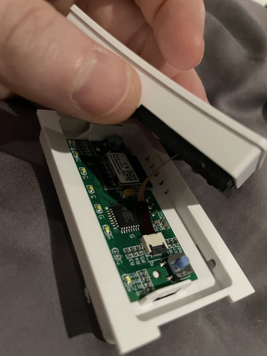

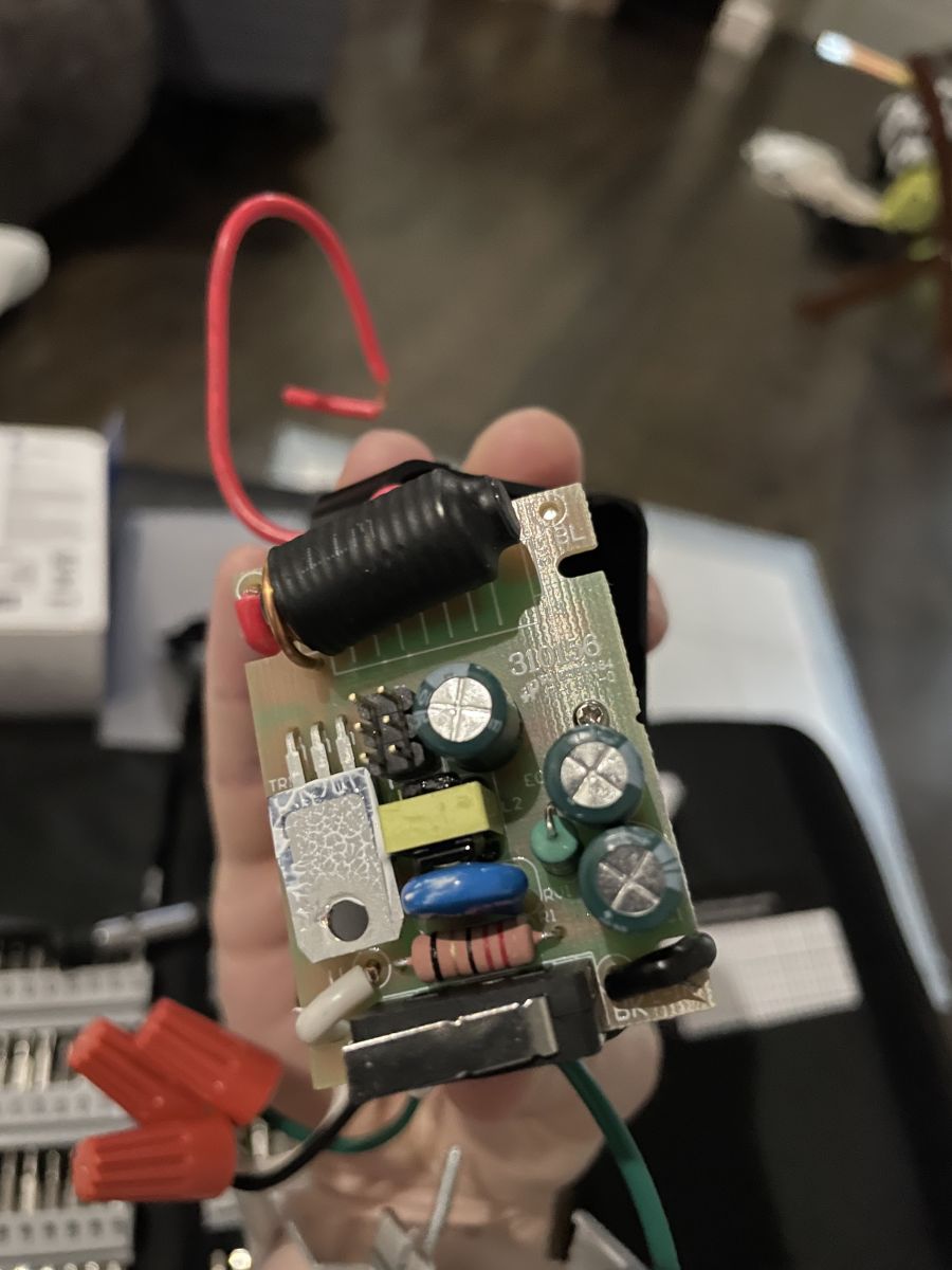

    This is a tear down of the ELEGRP Smart Dimmer DPR10, which is a dimmer switch with a slick touch-sensitive dimmer strip. It can be connected to the ELEGRP app, or to Tuya Smart Life app. The chip inside is a CB2S (Beken BK7231N) and should be compatible with OpenBeken.
    The body of the switch is held together by four T7 screws. The black back of the switch has a board that contains the relay and other electrical components. It's covered by a metal piece that's held in by another T7, and held to the body with a small Philips head screw. For flashing purposes, there's no reason to actually disassemble this part.
    [CB2S/BK7231N] TuyaMCU Elegrp DPR10 Smart Dimmer Switch Teardown: Tuya, OpenBeken
    Front of the component board

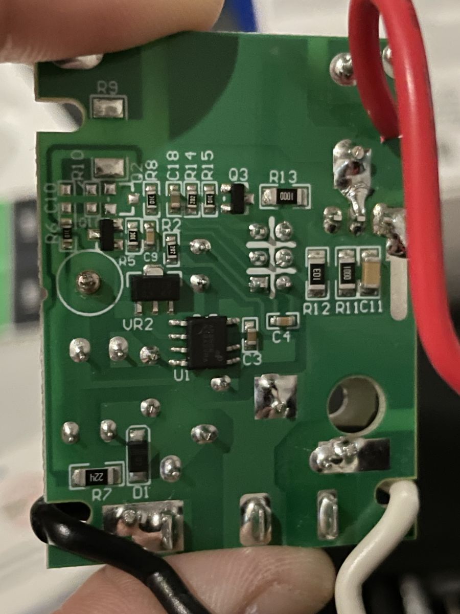

    Back of the component board

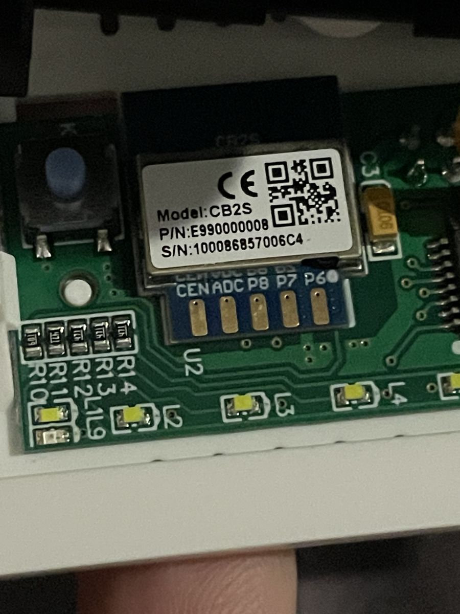

    Close up of the main chip

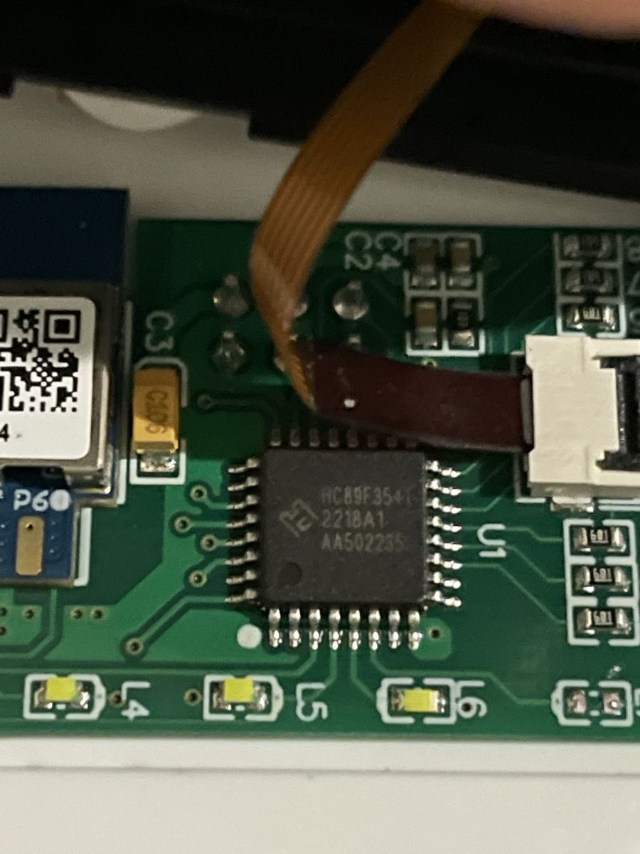

    Close up of the secondary chip

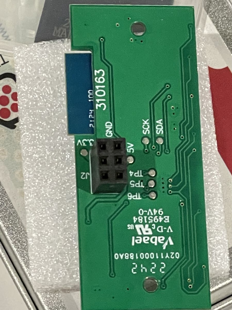

    Back of the chip board

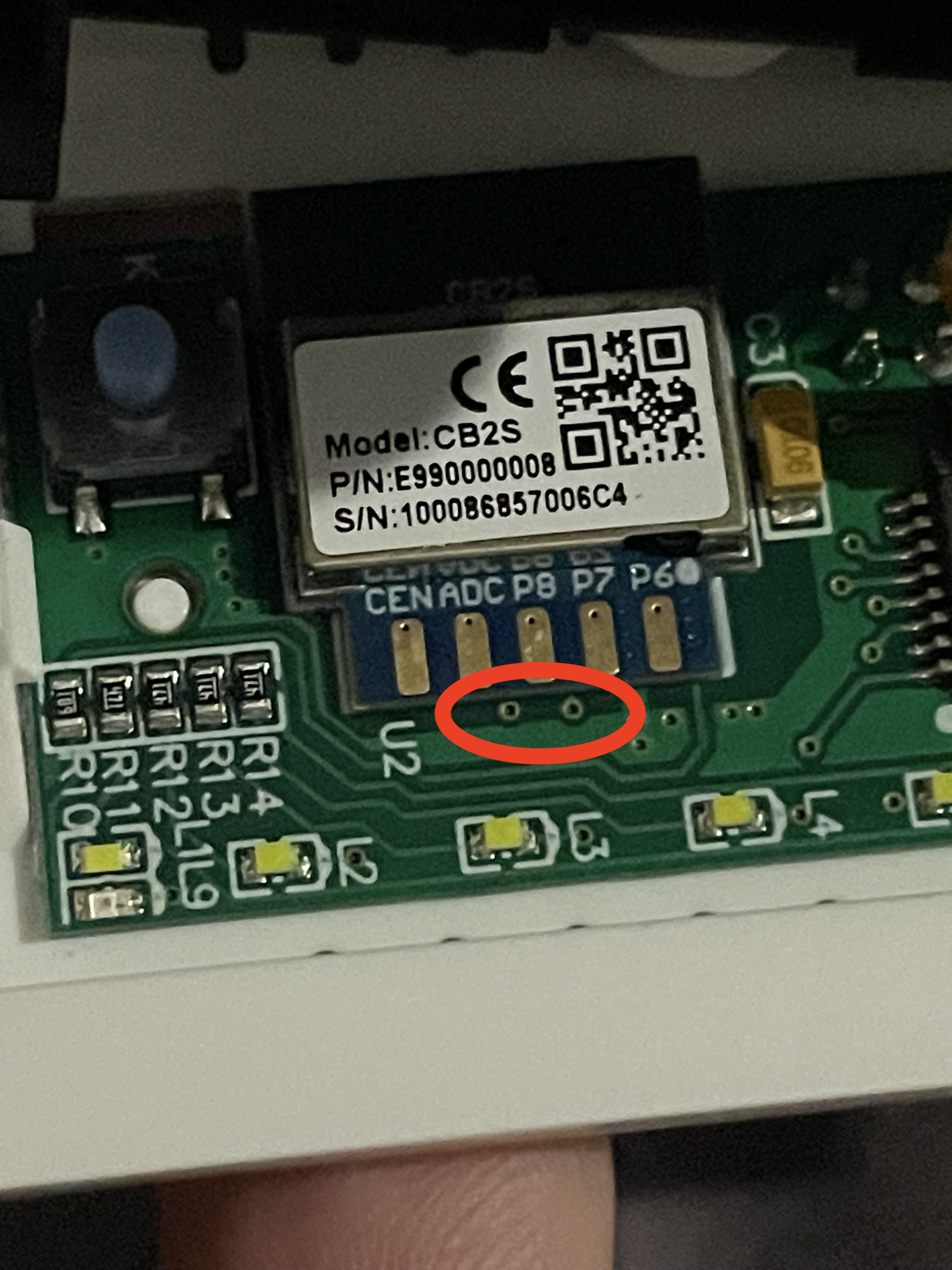

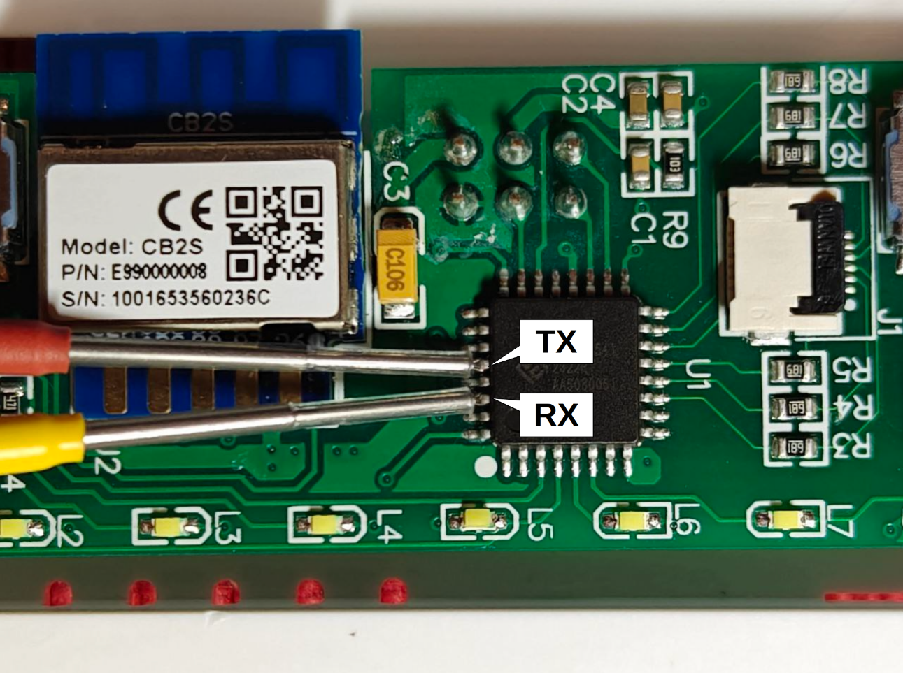

    I haven't yet tried flashing the chip with OpenBeken
    Added after 12 [minutes]:
    I'd like to try flashing this with OpenBeken, but I'm not sure the best way to get to the Tx and Rx pins, which appear to be underneath the BK7231N based on the datasheet. Can I solder to the two circles in front of the chip, which look to align with those pins on the underside? The same circles are available on the underside too if that's preferred for whatever reason.

    Hello, thank you for detailed teardown.
    This device appears to be a TuyaMCU dimmer.
    You can read about TuyaMCU dimmers here:
    Dimmer EDM-01AA-EU 300W for BK7231 and TuyaMCU - configuration
    MoesHouse DIY Smart WiFi Light LED Dimmer Switch Smart Life
    The problem is that you will most likely not be able to flash without disconnecting TuyaMCU first. But try it anyway.
    In worst case you will have to cut traces or desolder something.
    We have hot air tutorial on our channel: https://www.youtube.com/@elektrodacom
    Don't forget to make 2MB firmware backup of your device and attach it here. Thanks!

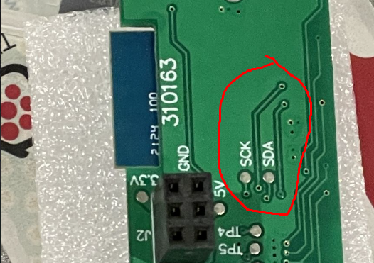

    PS: My quess would be that those two traces are RX/TX lines between UART1 of WiFi module and TuyaMCU:
    So worst case scenario is that you will have to cut them for the time of the flashing, but maybe first try without cutting.

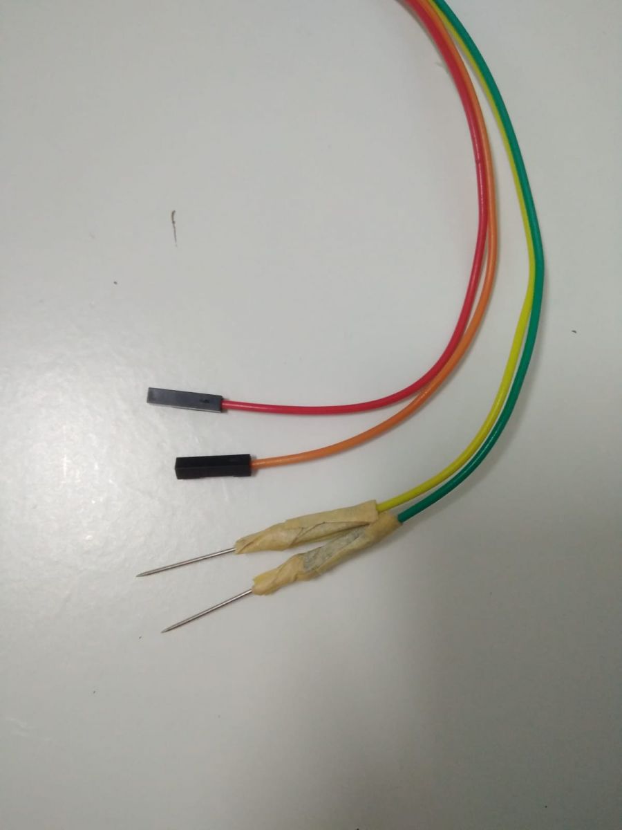

    Add two pins (pre-cut the head) to the Rx and Tx terminals of USB cable and try without soldering.

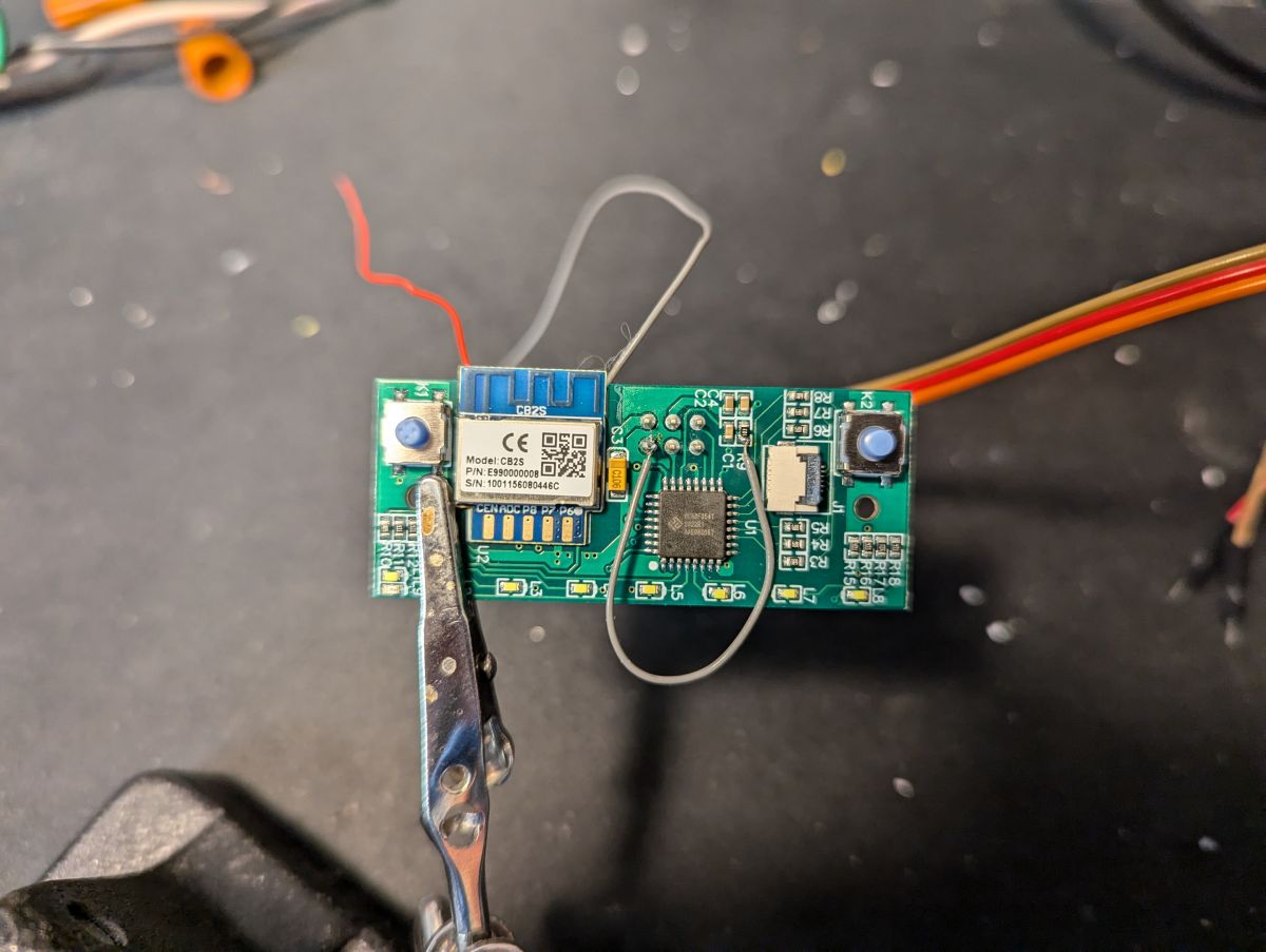

    I bought an ELEGRP DPR30, which is basically the same hardware except there's extra circuitry on the back of the component board to support the traveler wire this model has extra over the DPR10.
    Other than that, same hardware.
    I managed to flash OpenBK on it on the first try.
    Instead of cutting traces to silence the TuyaMCU, I went with a more delicate approach. I forced RST of the MCU to GND in order to keep it in RESET state. The TuyaMC has a 10K pullup to 5V on that /RST signal. So bridging it to GND is fairly easy.
    A circuit board with a CB2S communication module, visible with several connected wires.
    As it turns out, this is not needed. More on that below.

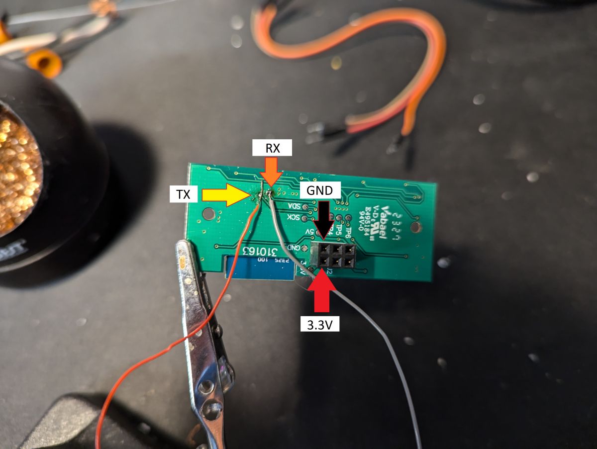

    Turns out @efirestone was right about the 2 vias being TX and RX. I took a leap of faith and soldered straight on the vias. I had to scrape the solder mask a bit to get a good connection.
    Close-up of a circuit board with labeled TX, RX, GND, and 3.3V pins.
    Then I used the BK GUI Flash tool. Everything went smoothly. No config to extract other than a baud rate value of 9600.
    As I mentioned earlier, it turns out I did not need to hold the TuyaMCU in RESET. After soldering the wires, I did a spot check and noticed the CB2S wasn't connected to the 5V rail. Double-checked its datasheet and yep, it's a 3.3V part.
    Then I noticed the 3.3V test point right beside the header.
    It turns out the TuyaMCU is powered via 5V and the CB2S through a dedicated 3.3V supply coming from the base PCB. So effectively, you can keep the TuyaMCU at bay by simply not powering the board through the 5V pin.
    I tried first with /RST tied to ground as I had already soldered it but I later retried without it, just to be sure.
    In both cases, I was able to access the flash of the CB2S without issue.

  • IC chip clamps for safer CB2S flashing
    #6 21399706
    xapienz
    Hello!
    Thank you for the detailed teardown of this dimmer.

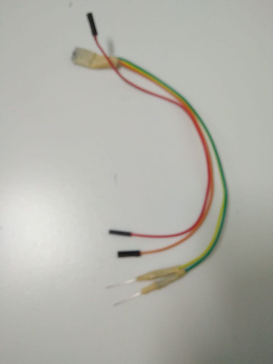

    I found that if you are not comfortable soldering or messing with the board, you can use tiny IC chip clamps and connect directly to the legs of TuyaMCU, where RX and TX of CB2S are going to. You can see the trace between the chips on the back side of the board, and it will make it easier to do less damage.
    Then I could flash CB2S using `ltchiptool` and ESPHome firmware.
