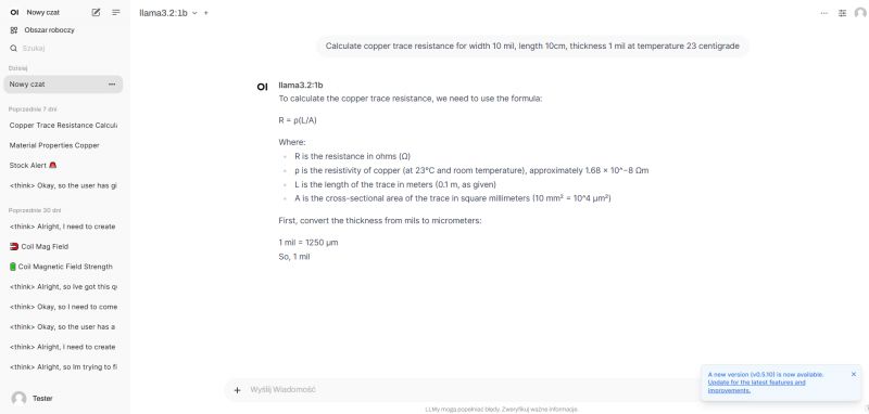

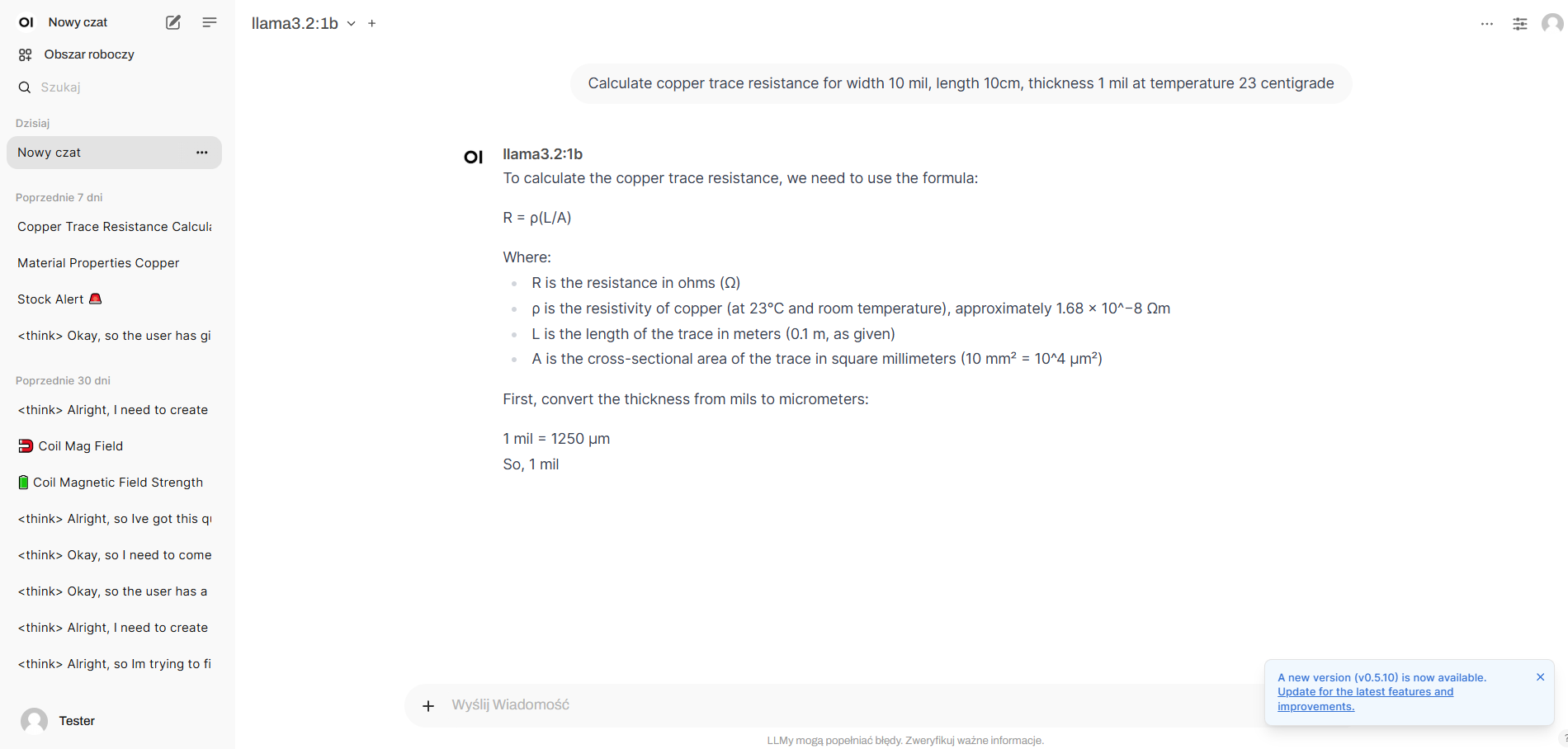

    In the theme I assume we already have the WebUI set up along with some sample models downloaded, this can be done according to my old tutorial .
    As a check that everything is working, we fire up our WebUI in Docker and ask it a question:
    User interface with content on calculating copper trace resistance. .
    We make sure that everything works. Only then can we move on.

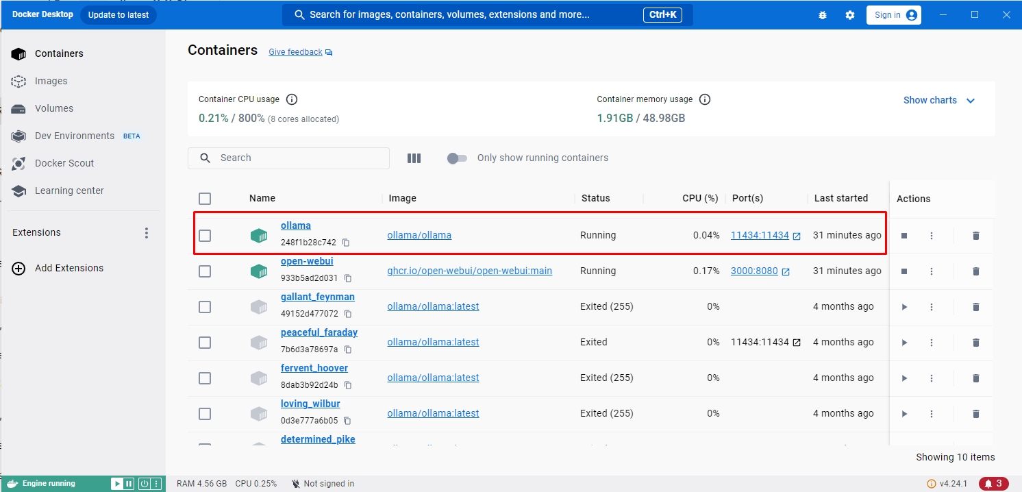

    First we need to know the port on which Ollama is set up. This is not the same port that WebUI is on. It is easy to find it in Docker:
    Docker Desktop screen showing the ollama container highlighted .

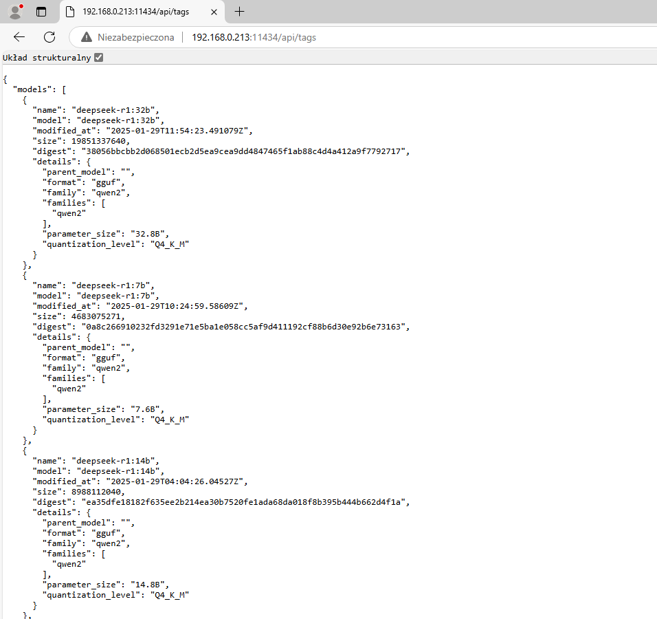

    Then, as a test, you can look in your browser at the address listing the available models:
    http://192.168.0.213:11434/api/tags
    We should receive the list in JSON format:
    Screenshot of a browser displaying an API model list. .
    This confirms that the API is working and allows us to move on to the next step.

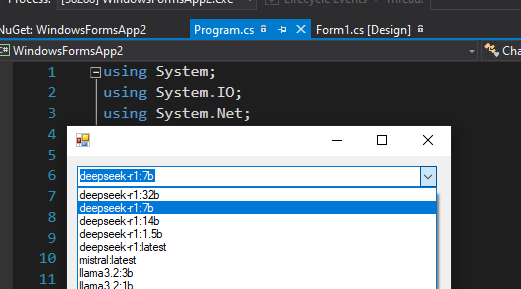

    Listing models in practice .

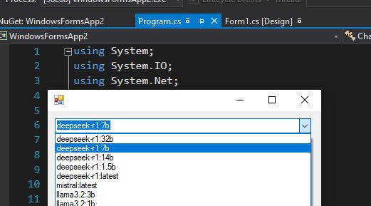

    So let's make a simple chat imitation application for a test. I decided to make it in C# - based on WinForms, or Windows windows. I wrote in Visual Studio 2017, but of course you can pick up a newer version.

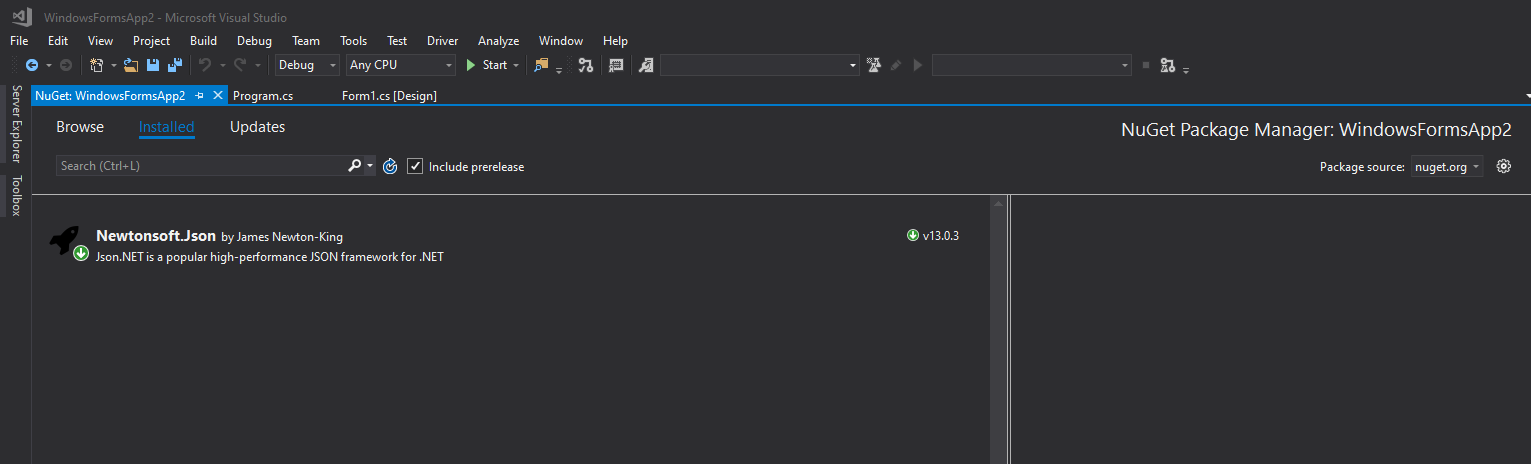

    We start by inserting the available models into the ComboBox dropdown list. We retrieve the models from the aforementioned API via HttpWebRequest, which returns JSON for us to parse via Newtonsoft.Json. We install this library beforehand:
    Screenshot from Visual Studio showing the NuGet Package Manager with Newtonsoft.Json installed. .
    And now the code - all in one file, without a visual editor:
    Code: C#
    Subsequently the web request HttpWebRequest fetched data, we read it into the StreamReader stream and then create a JSON object from it using JObject.Parse. There we iterate through the array of models.
    It works:
    Screenshot of an application with a dropdown menu for selecting language models. .

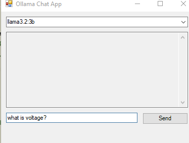

    Simple query and response streaming .
    We already have the models available. Now it is time to put them to use.
    An endpoint is used to simply complete the text:
    http://192.168.0.213:11434/api/generate
    We send a POST request with the data in the format:
    There is also an optional stream argument - this specifies whether the response is streamed. We rather care about this, then there is a better effect and you can see in real time what is happening.
    This way we get a stream of JSON files in the response - word by word. This is the same effect as in ChatGPT. We have to add the received words to the displayed window ourselves.
    The done field specifies whether the given JSON is the last fragment of the response.
    Updated code (I added a text box, button, etc):
    Code: C#
    Now StreamReader reads line by line - and we convert these lines into separate JSONs.
    Example result:

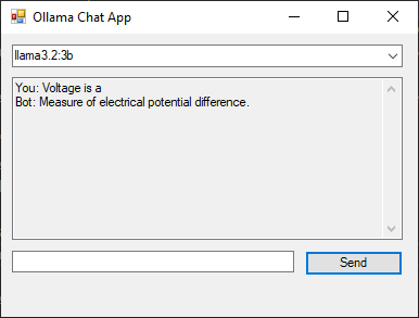

    Household minichat - basis .

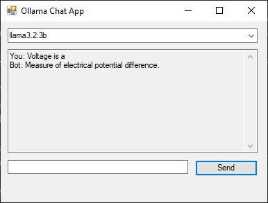

    The chat allows you to send a conversation history split between the user and the assistant. An endpoint is used to create the chat:
    http://192.168.0.213:11434/api/chat
    A POST request with data in JSON format needs to be sent there. At the very least, we need model selection (model field), conversation history (user messages and AI).
    An example of the JSON sent:
    In response, we will receive a JSON stream of this format:
    The last JSON received will be different:
    Code: C / C++
    I've added a text box, button, etc to the code here, but that's the least important.
    Updated code:
    Code: C#
    The most interesting thing is the SendButton_Click method - this is where the request is sent. I do this in a blocking way, so I suspend the GUI for the duration of the query, but this is just a demo version.
    The result:
    Screenshot of the Ollama Chat App with a model dropdown and chat fields. .

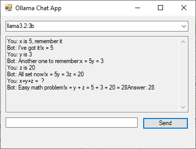

    His own minichat - a history of exchanges .
    One thing left to do is to keep the full history of the conversation. Then the query looks like this for example:
    So we separate the messageHistory into a window class and update it when the AI response is received.
    Code: C#
    With each query we resend it. It's time to check the AI's memory:
    Screenshot of the Ollama Chat App application showing a chat conversation. .
    It works!
    Forgive the lack of spaces in the conversation, it's just a display issue. You can immediately have a longer conversation.

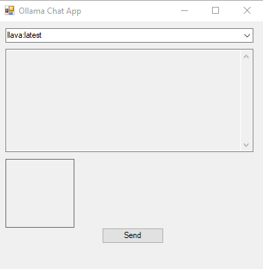

    Recognition of photos .
    Some AI models also support photos - llava, for example. Photos can be sent to them encoded in Base64. We append them to the chat query or autocomplete as an image array. The example query then looks like this:
    Endpoint:
    The answer will be obtained in the format:
    It is easy to convert bytes in C# to a string in Base64 format, we have a function ready for this:
    Code: C#

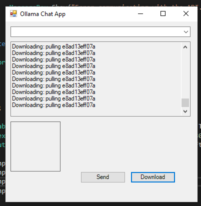

    In this way, we can convert our chat so that it also supports images. By the way, we will use the drag&drop mechanism to be able to simply drag files onto our window:
    Code: C#
    Result:
    Screenshot of the Ollama chat application with a model dropdown and Send button. .
    Ollama chat app interface with a model selection box, text entry window, image field, and Send button. .
    Analogously, you can attach images to a chat conversation. We then place them in the chat history, example below: .

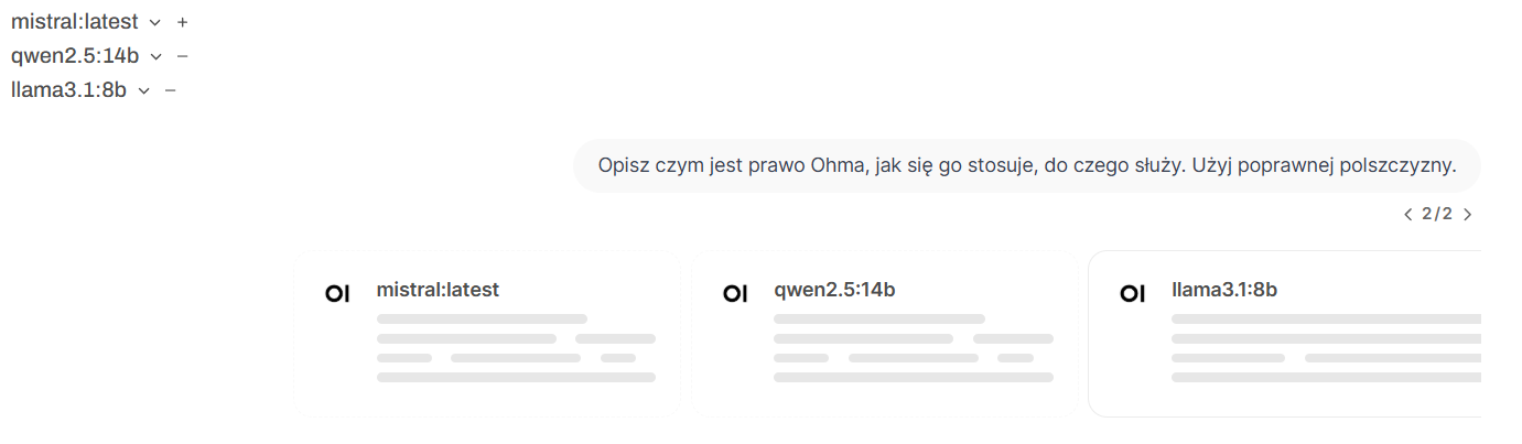

    I have a question - how do these simplified deepseek models cope with the Polish language?
  • Testing AI models on electronics exam tasks
    #6 21431823
    Posts: 14790
    Rate: 12936
    At the moment, in my spare time, I'm working on an electronics exam for AI - I want to automatically see how these models will cope with various tasks. For this there will be a ready-made program so that I don't have to do anything manually.
    @krzbor let's test.
    Prompt:
    Describe what Ohm's law is, how it is applied, what it is used for. Use correct Polish. .

    Version 1.5b of the parameters did not comprehend and answered in English, the two larger versions think in English but answer in "Polish" (?).
    Resistance in "ohms"? Electrical "mach"? Tension...
    Ok, now the other models.
    Interface for selecting an AI model with responses to a question about Ohm's law. .
    mistral:latest wrote:
    Ohm's law is a law of electronics that describes the relationship between the current of a fin and the voltage in a metal conductor. The law is formulated by the equation:
    J = I + α * V^2
    Where:
    J - ionic current,
    I - electron current,
    V - voltage in a metal conductor,
    α - Ohm's constant (property of the material).
    For the flow of small electron currents (ordinary current), this law can be simplified to the simpler Ohm's equation:
    V = R * I
    Where:
    V - voltage,
    R - resistance of the conductor,
    I - electron current.
    This law is fundamental to the theory and design of electrical systems and the analysis of their operation. It serves for the determination of voltages, currents, resistances and other properties of metal conductors in a variety of configurations. It is helpful for designing power systems, measuring voltages and currents and fault diagnosis in electrical systems.
    Flame current?
    llama3.1:8b wrote:
    Ohm's law - an electrical relationship for single-phase generators describing the relationship between voltage, current flow and electrical resistance of a circuit.
    According to Ohm's law, if the basic circuit consists of a voltage source with a voltage U, an internal resistance R and a battery with a voltage -U and a resistance r b (independent of current), then:
    U=I(R+rb) ,
    Where:
    U: the voltage between the two ends of the battery, in Volts,
    I: the current flowing through the circuit, in Amperes,
    R and rb : electrical resistances of the circuit and battery, in Ohms.
    This law was formulated in 1827 by the German physicist Georg S.J. Ohm (1789-1849).
    qwen2.5:14b wrote:
    Ohm's law is one of the most important laws in electricity and electrical engineering. It explains the relationship between electric current, electric resistance and electric voltage in a simple electrical system (e.g. a chain with a conductor and a current source).
    According to Ohm's law, the current intensity I flowing through a system is inversely proportional to the electrical resistance R of that system and directly proportional to the electrical voltage U at its ends. The mathematical formula for this law is:
    U=R⋅I
    or
    I= U/R
    Where:
    I is the current [A] (amps),
    U is the electrical voltage [V] (volts),
    R is the electrical resistance [Ω] (ohms).
    Ohm's law is used in many technical situations such as:
    Calculation of current: If the values of voltage and resistance are known, this law can be used to calculate the current flowing through a system.
    Calculation of voltage: If you know how much current flows and what the resistance is, you can calculate the voltage at the ends of an electrical circuit.
    Calculating resistance: If we know the current and voltage in the circuit, we can determine its electrical resistance.
    Ohm's law is of great importance in the design and analysis of electrical systems, from simple circuits to complex power installations. It is the basis for many engineering calculations relating to electricity and electronics.
    phi4 wrote:
    Ohm's law is one of the fundamental laws of direct current in electricity, which describes the relationship between voltage (V), current (I) and resistance (R) of a circuit. The formula for Ohm's law is V=I×R. This means that the drop voltage of an electrical component is the product of the current flowing through the component and its resistance.
    Application of Ohm's Law
    Calculations in simple circuits :
    If the values of voltage and resistance are known, the current can be easily determined.
    For example : Given a voltage V=12 W (watts) and a resistance R=4 Ω (ohms), we calculate the current as I= V/R = 12/4 =3 A (amps).
    Electrical circuit design and analysis :
    Ohm's law is used to design and analyse simple electrical circuits, especially those operating on direct current, such as power systems for electronic devices.
    Diagnosis and troubleshooting :
    If there is a fault or abnormality in a circuit, analysing the voltage and current values can help to locate the problem.
    Applications
    Electrical circuit design : Engineers and designers use Ohm's law to ensure the correct operation of electrical circuits, such as installations in buildings or in electronic devices.
    Selection of suitable components : When selecting resistors or other passive components, we must always consider their properties as described by Ohm's law to avoid overloads or power shortages.
    Education : This is a fundamental concept taught in technical schools and in the field of electrical engineering.
    Ohm's law is an invaluable tool for understanding how currents flow through different materials and how to control these currents by changing the value of resistance in a circuit. Despite its simplicity, this law has wide applications in everyday life and technology.
    gemma2:2b wrote:
    Description of Ohm's law
    Ohm's law describes the relationship between current (I), voltage (V) and resistance (R) in an electrical system.
    Here are the basic definitions:
    Voltage (V): The level of potential difference at a given point in a system that causes current to flow.
    Current (I): The number of electrons flowing through a circuit in a given time.
    R: Resistance - is the deviation of voltage under the influence of current.
    By your own comparison, how does current differ from voltage?
    Voltage is the 'force' that prompts the current to flow, and current is the 'recognition' of this force - it's like a motor that needs voltage to speed up (current).
    The principle of Ohm's law: V = I * R , i.e. the voltage in a circuit is equal to the product of the current and the resistance.
    What is the application of Ohm's law based on?
    Ohm's law is used to:
    Calculating the voltage (V) in electrical circuits: If we know the current (I) and resistance (R), we can calculate the voltage (V) using the formula V = I * R.
    Calculation of current (I): If we know the voltage (V) and the resistance (R), we can calculate the current (I) using the formula I = V / R.
    Diagnostics and analysis of electrical systems: Ohm's law is a fundamental element in research to better understand the functioning of electronic circuits and their performance.
    Use of Ohm's law in practice:
    Ohm's law is used in many areas such as:
    Electronics: Determining the voltage in the power supply of an electronic device or analysing its performance.
    Power engineering: Calculation of voltage and current in an electrical network.
    Mechatronics engineering: Analysis of the force generated by electrical systems, such as in electric motors.
    Remember that Ohm's law is a key element for understanding the operation and regulation of electrical systems.
    llava wrote:
    Ohm's law is a physical law that determines the values of the input signal at the output of a given inverter. It is defined as follows:
    If the input is a voltage V, then the value of the output signal I is proportional to V and is:
    I= V/R
    where R is the resistance of the source.
    If the input is a current I, then the value of the output signal V is proportional to I and is:
    V=I⋅R
    This correct formula is used in electronics to predict the performance of regulator circuits, such as a power supply or a surge suppressor. By becoming familiar with its use, it is possible to verify that the performance of these devices is improved and that there is no translation between voltages and currents.
    "A power supply or surge protector"?
    Which model do you think has coped best?

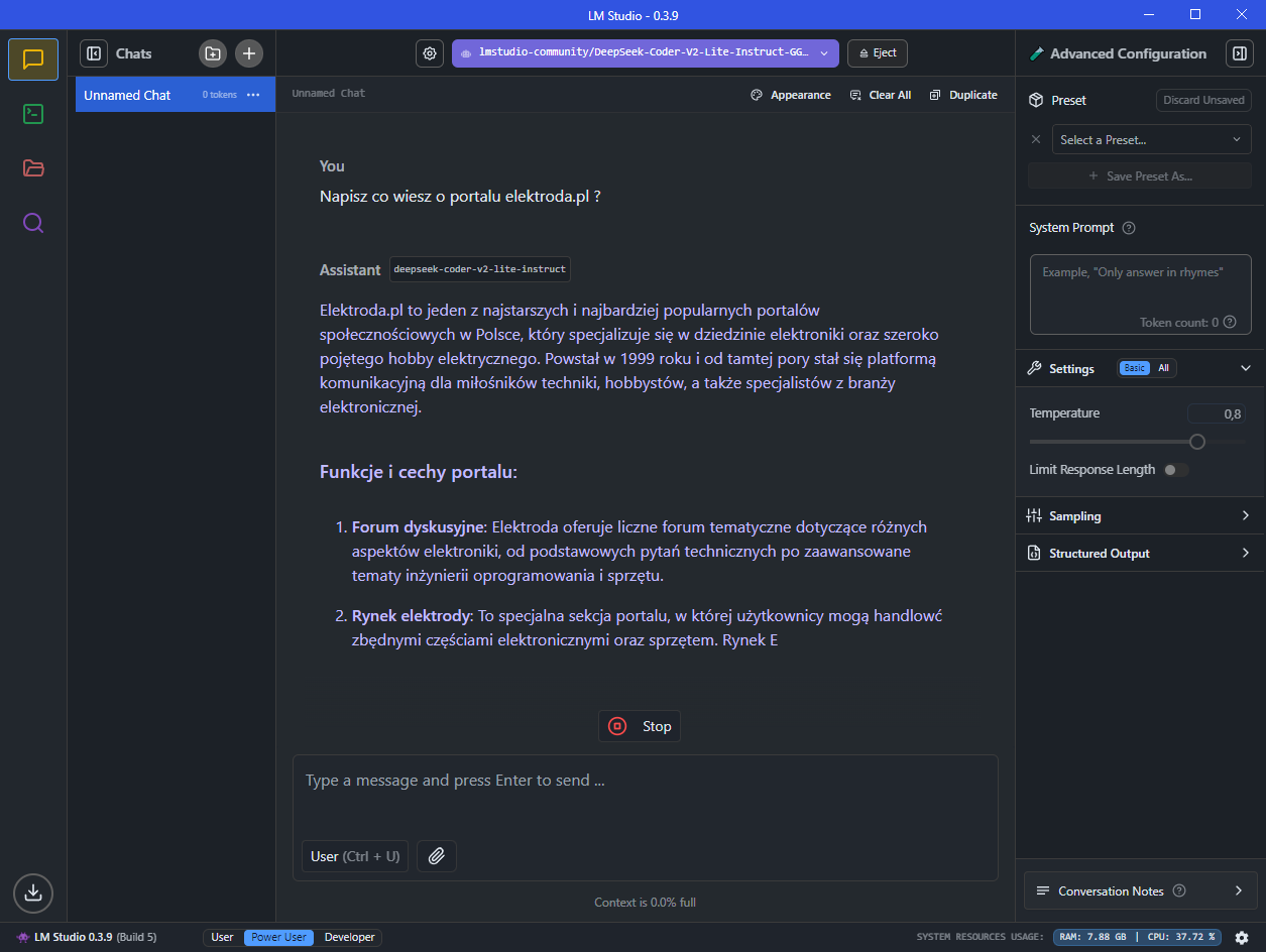

    If anyone wants to test different models without, as it were, complicated games of manual configuration and editing JSON files I recommend:
    https://lmstudio.ai/
    The Windows application installs like any "setup". The whole thing requires virtually no skill on the part of the user other than reading skills.
    Models are added by "clicking" on the page. https://lmstudio.ai/models (this is a list of available models).
    It is also possible to fire up a model in API mode over HTTP.... Also a few clicks in the options and we have an API over HTTP on localhost.
    However, let's be honest... On a home computer without a good accelerated card it all runs very poorly compared to commercial services that are a pittance....
    On top of this, the models available as free for home use are quite a distance from their commercial counterparts. It makes little economic sense to put up a model at home.
    Perhaps it makes sense for someone who is particularly keen on privacy or simply to play on their own.
    Screenshot of LM Studio with text about elektroda.pl

    I add to the mini-program the option to download a new model, just endpoint for this:
    http://192.168.0.213:11434/api/pull
    I will then attach the new code to the post.
