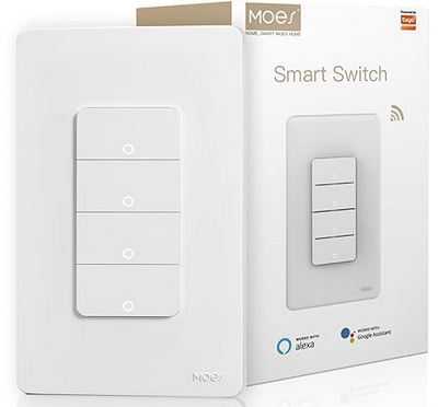

    Moes smart switch with three buttons and packaging.

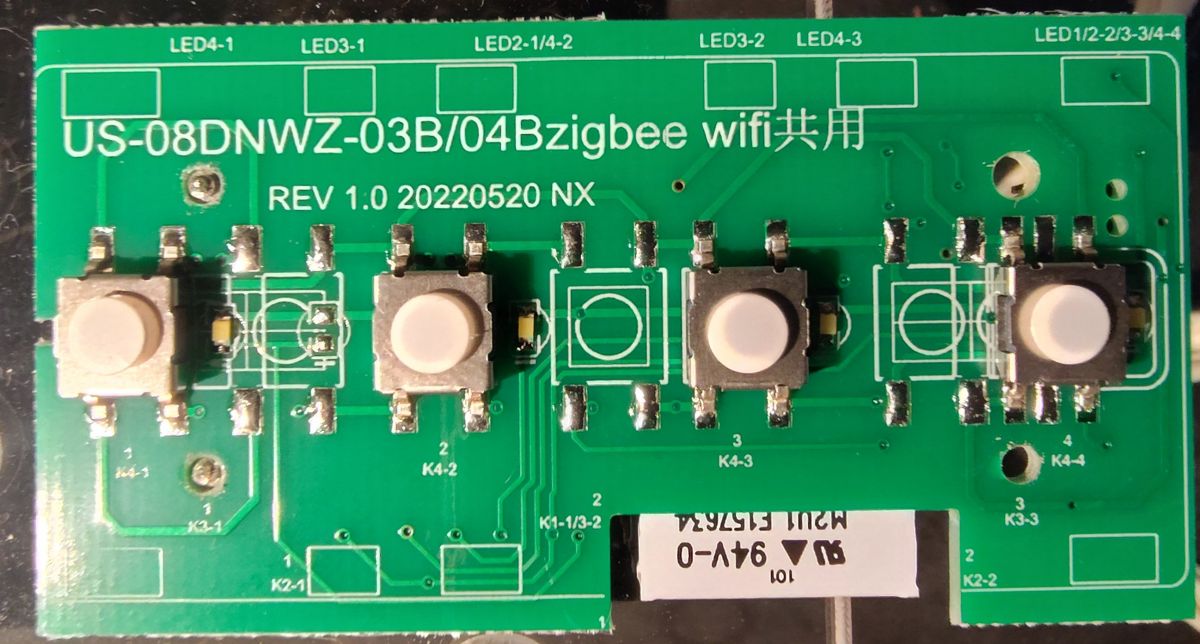

    P24 - Relay L1 (low output turns it on)
    P23 - Button 1
    P14 - Led 1
    P26 - Relay L2 (low output turns it on)
    P9 - Button 2
    P16 - Led 2
    P6 - Relay L3 (low output turns it on)
    P28 - Button 3
    P20 - Led 3
    P7 - Relay L4 (low output turns it on)
    P8 - Button 4
    P22 - Led 4
    Printed circuit board with visible buttons and LED markings.

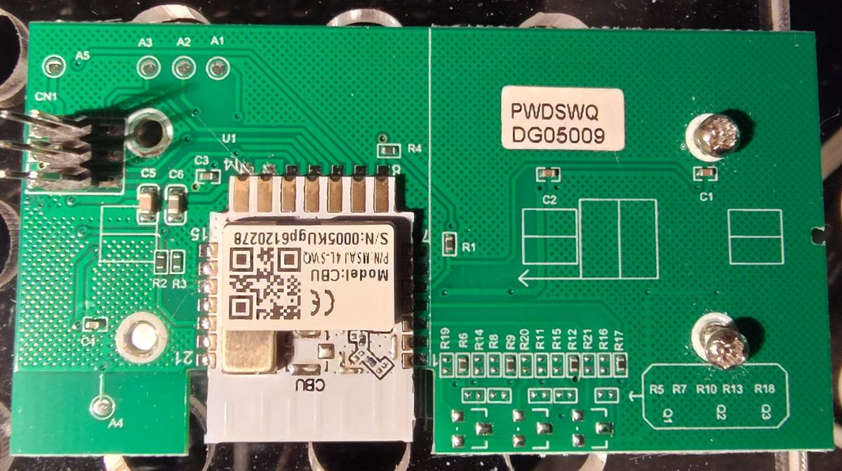

    Printed circuit board with electronic components and a module with a QR code.
    To flash
    +3.3vdc - pin 14
    Ground - pin 13
    TX - pin 15
    RX - pin 16
      "pins":
        "6": "Rel;3",
        "7": "Rel;4",
        "8": "Btn;4",
        "9": "Btn;2",
        "14": "LED_n;1",
        "16": "LED_n;2",
        "20": "LED_n;3",
        "22": "LED_n;4",
        "23": "Btn;1",
        "24": "Rel;1",
        "26": "Rel;2",
        "28": "Btn;3"

    Thanks for sharing. Finally a device that is using microswitches! With these, you can easily employ OBK button events like single click, double click, hold, etc:
