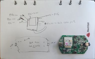

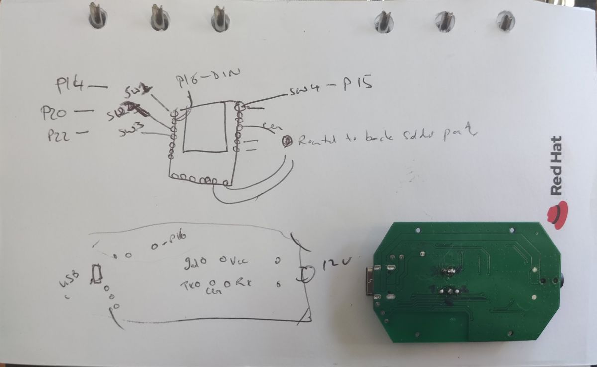

    Everything seems to be working fine, except that I get continuous press SPAM from Pin14 which is SW1 in the console- I am wondering if this is possibly something to do with how the Microphone on the board is wired in? Inverting the pin doesn't resolve. It doesn't seem to affect functionality and you could just leave pin14 undefined If you want to silence it.
    The controller board is very nice to open, just pop from an easily priable gap along the USB-C connector, no hot-glue etc . There are convenient solder pads on the reverse of the board for initial flashing.
    Pin-map sketch with PCB
    Diagram and photo of the LED controller PCB.
    Reverse
    Pin diagram and reverse side of the LED light controller board.

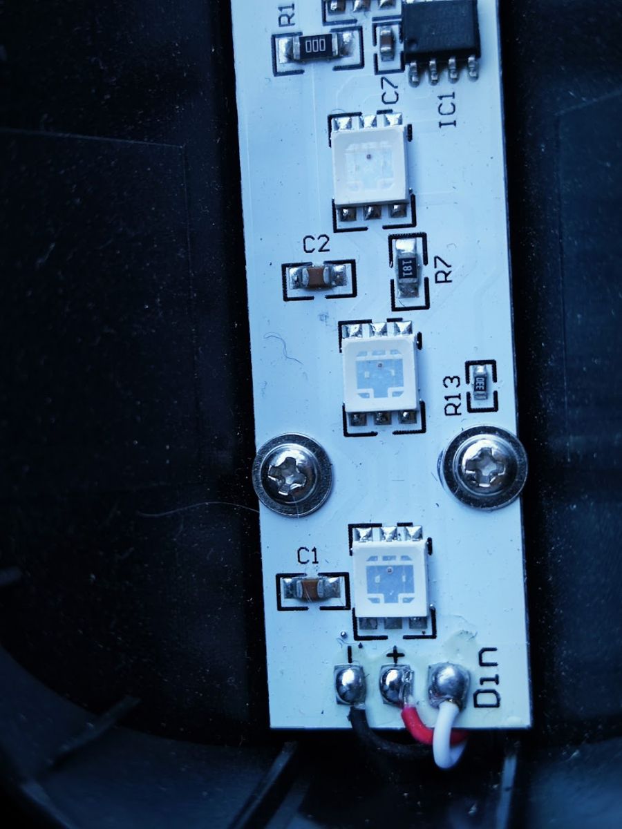

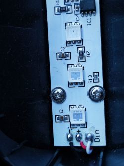

    LED Strip inside case/diffuser:

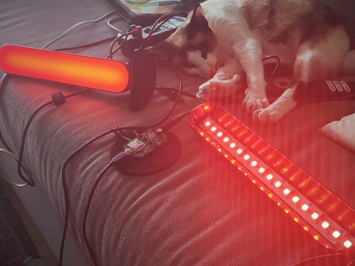

    Cat approved result:
    Two red LED light bars on a table, with a sleeping cat and a control board nearby.
    They are using WS2811C 12V Controllers in Groups of 3 LED (for a total of 6 addressable segments per Light). For whatever reason (probably voltage drop) Each of the pairs are wired in parallel so the second light in a chain just mimics the first. You could probably, cut the 2nd light cord , drill a hole and solder the second light to the top of the first and get a single strip of 12 addressable, but I didn't try as the form factor and diffusion of these units is quite nice as is.
    I have these attached as DDP segments to existing WLED controlled lights. In the example I provide basic stand-alone dimmer and colour control (taken directly from https://www.elektroda.com/rtvforum/topic4036716.html ) as commented section in the attached autoexec.bat script. I would like to use the 4 switches and have local colour/brightness control along-side the DDP receiver. Currently however it appears that any local dimmer controls etc override the DDP. So I leave them configured as basic DDP targets OOTB. WLED handles this by poping up an overide when a DDP packet is received asking the user if they want to ignore DDP in tthe WebUI once or until reboot. Something like this could probably be scripted so that a button press for power down overrides the DDP until another press. But I haven't investigated how openbk handles button actions.
    Since there are 4 available momentary switches on the control unit, I would ideally like to map each one to a rolling over 0-255 per color channel control and the 4th as a On - Off + Long Press Dimmer. If anyone has an example for doing any of the above - would be keen to see how.

    Thanks for sharing. It's really not good to see them using USB-C connector for 12V. Using it for some other devices would certainly end badly.
    Regarding the buttons on the device, I am planning to make an extended version of per-pixel lights driver, but currently, if you are using RGBW method:
    SM16703P_SetPixel all $led_enableAll*$led_red*$led_dimmer/255 $led_enableAll*$led_green*$led_dimmer/255
    then you can use both button roles like SmartButtonForLEDs, Button_NextColor you can also use click events with commands like led_basecolor_rgb, etc. I would need to think about that wrap.
    So both Btn and Btn_b are spamming? But wait, is P14 really a button? Why do you think it's mic? Isn't mic on ADC, P23?
