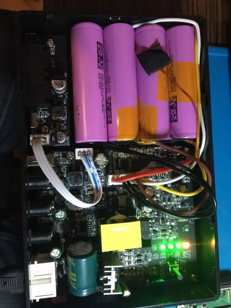

    I have such a ready-made DC1036P MINI DC36W 2A 5V/9V/12V
    but it heats up a lot
    Open electronic device showing batteries and circuit board.
  • Recommend 3.9V cutoff and 4S1P pack
    #15 21445050
    VPSA132
    Level 26  
    Posts: 727
    Help: 74
    Rate: 185
    The nice thing about this project would be that it would be possible to set the charging voltage of the cells. I would prefer that the cells are not sustained at 4.2V all the time. This will be detrimental to their service life.
    The charge cut-off would have to be set at 3.9V, maybe even less. It is obvious that the capacity of the pack is lower, but it is something for something.
    In addition, a design based on a 1SxP pack for 20W and above is a dud.
    The cells will draw a current of 5.5A and higher and this generates large voltage drops and a lot of losses on the inverter.
    For this purpose, I suggest only a step-down inverter with e.g. 4S1P.
