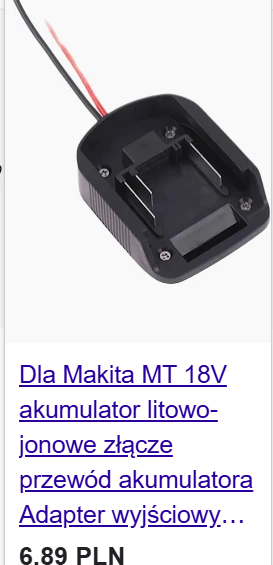

    If someone has power tools then a USB adapter with a battery from a drill can be used as a cool powerbank.
    So you can use such rechargeable batteries for yourself if you need to, likewise system torches from a particular manufacturer are sometimes at a good price.
