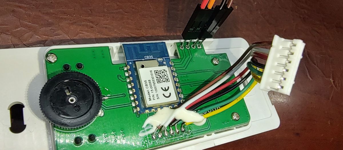

    Rx Tx Gnd and 3.3V are provided on the board.
    Flashing was simple with a power cycle.
    Circuit board with Wi-Fi module and connected cables.
    The BKFlasher did most of the work.
    I had to track the route from the BL0937 to the CB3S for BL0973SEL to 14
    Then use the Web App, Tools, and Calibration utility for Power Metering to calibrate.
    Don't forget the autoexec.bat to start the BL0937 driver. StartDriver BL0937
    VCPPublishThreshold can also be useful.

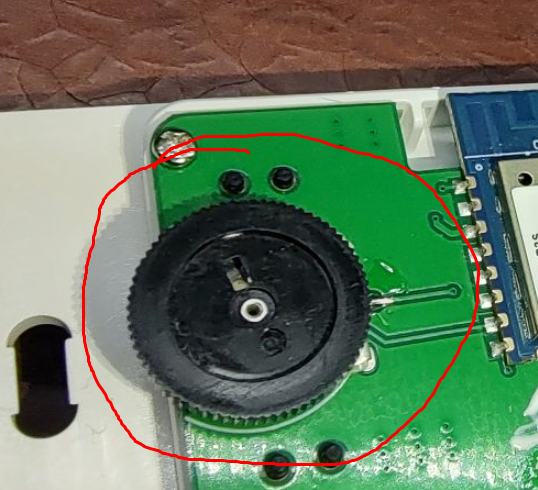

    Interesting, what's this element?
    Image of a green circuit board with a large black knob mounted on it.
  • #4 21454209
    stvrdl
    It's a potentiometer to adjust the brightness on an indicator LED on the front of the switch. (Not for the wifi LED)
    It's a bit odd that a smart switch has a potentiometer to make an adjustment especially considering it's not accessible after the switch is installed.

    >>21454209
    It's a function like for my son. He can't live and won't fall asleep if there's anything lit in the room. Not even the smallest LED. Everything is taped up with thick black tape. I also had to reprogram his heating switch so it wouldn't light up. It couldn't be taped up. ;-]
  • #6 21457726
    Posts: 14694
    Help: 656
    Rate: 12731
    Couldn't they just use PWM or software PWM to give us option to dim the LED?
    Actually, maybe we should add that kind of thing to OBK?
