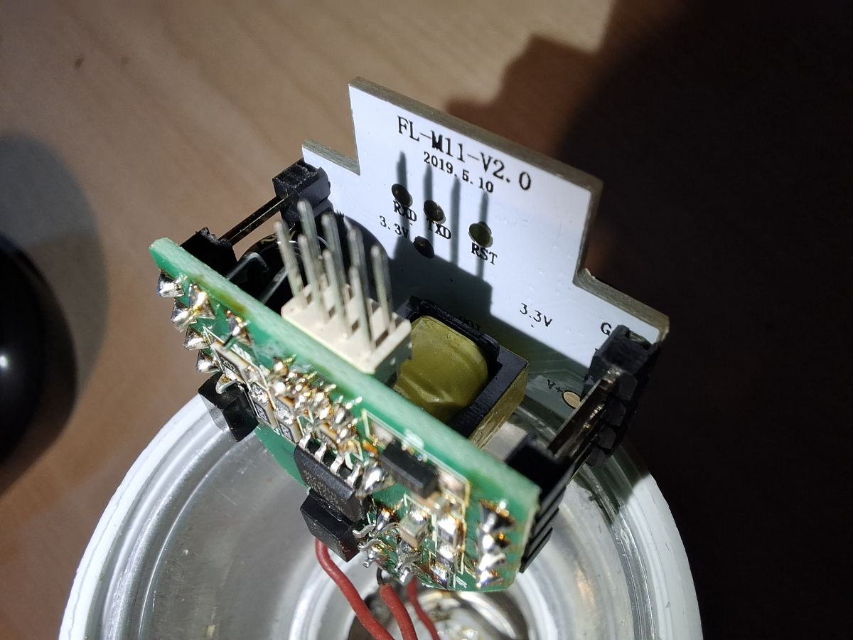

    I've rummaged through the nooks and crannies for 2 "Aliexpress" branded light bulbs. Both are signed that they can be paired with SmartLife. But well, the pairing does not work. The bulbs have been lying around since 2019 unmoved.

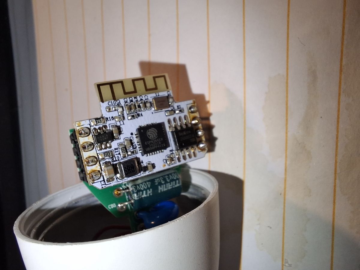

    Both pieces based on the well-known and well-loved ESP8266. The difference is that I don't have the RX, TX, GND and GPIO0 clearly shown on the PCB. PCB view below
    PCB marked FL-M11-V2.0 with visible pins. .
    ESP8266 module on a circuit board inside a smart bulb. .
    Do you have any tips on how to go about flashing this FL-M11-V2.0 and what would play best there? Tasmota?

    Maybe Tuya-convert will work?
    The SC3-01 SmartLife switch and ESP firmware upload via WIFI (tuya-convert/OTA) .
    And if not then it's worth either looking at the underside of the module to see if the pins are labelled on the underside, or taking a multimeter and searching with a multimeter where GPIO0 leads.
    Tasmota should work fine on these bulbs.

    I have unsoldered the 2 boards and there is a set of rx tx 3.3v gnd pins and I00 I02. I checked the transition and I00 is gpio0. The esp itself is alive because I can read the serial
