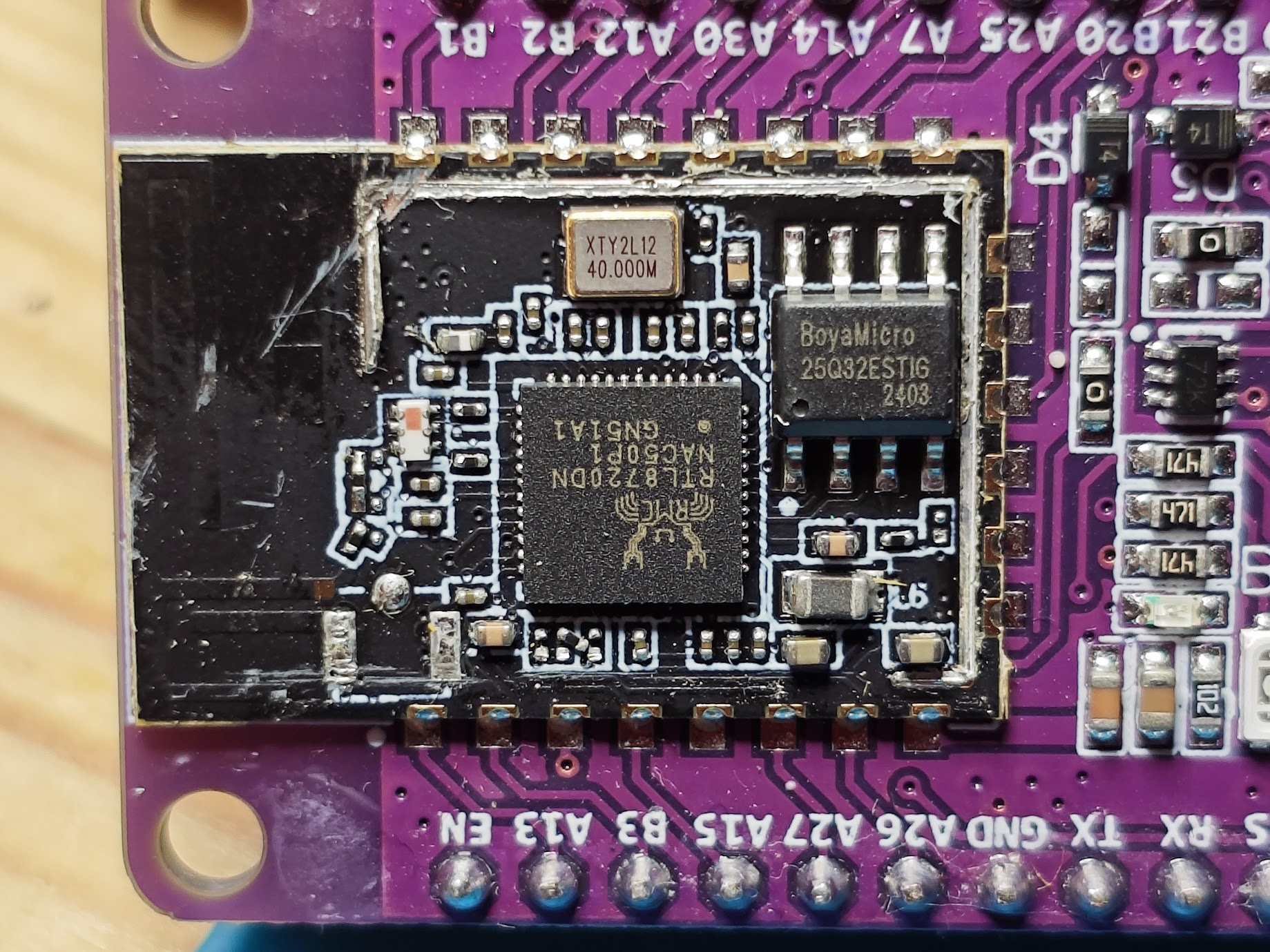

    wait. I'm a fool. I've made an assumption about the BW16E. It is 4mb, not 2mb.
    Electronic module on a purple PCB with visible components and chips.
    Screenshot showing Flash setting with a default value of 4MB.
  • #212 21444415
    Posts: 14677
    Help: 656
    Rate: 12702
    I didn't notice it as well, but now imagine how much drivers it could fit. Everything enabled by default, even charts...

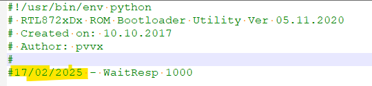

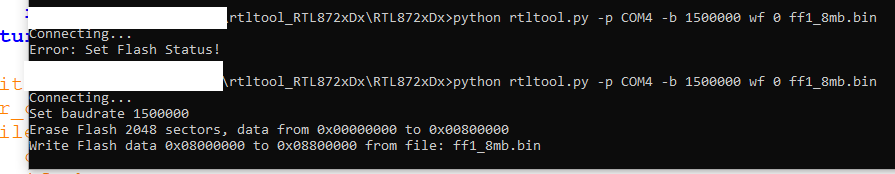

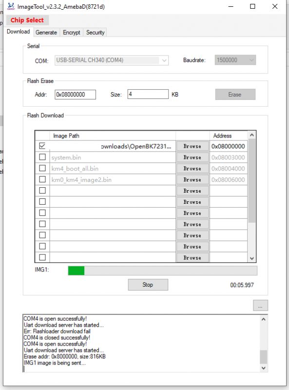

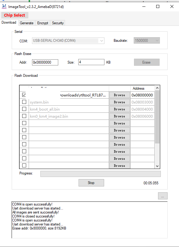

    the FlashTools GH has more bits in now including the original pvvx rtltool and an unzipped one with adjusted delay
    List of software tool files for Ameba chips.
    Screenshot showing two files in a folder: RTL872xDx and rtltool_RTL872xDx_orig.zip.
    Screenshot of ROM Bootloader code with creation date 17/02/2025.

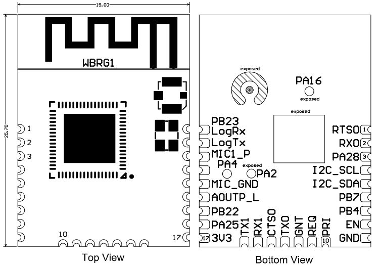

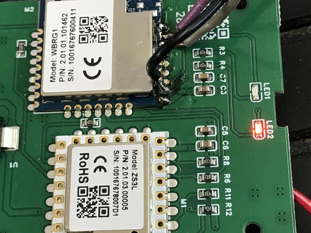

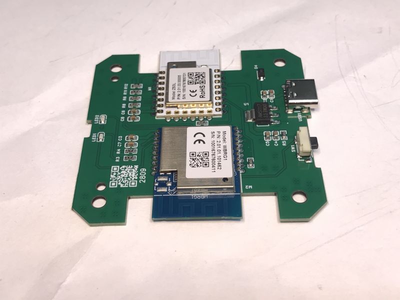

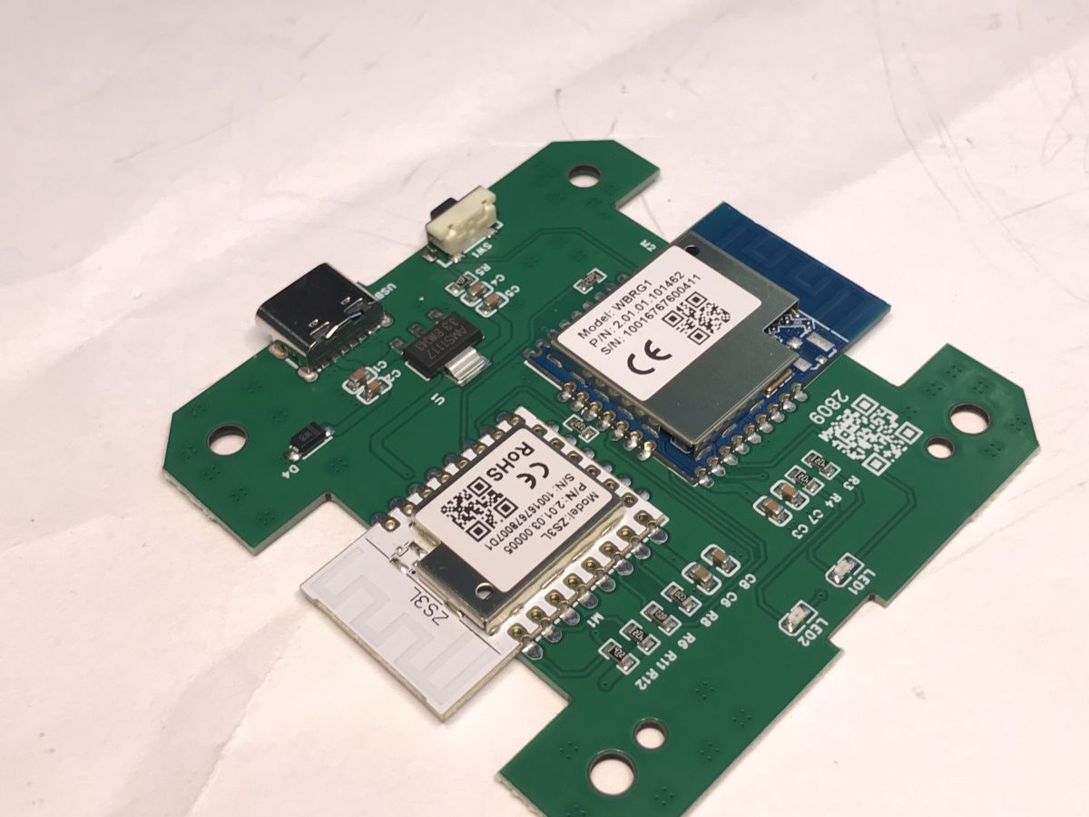

    My gateway arrived, how does one flash WBRG1? It seems only UART port is needed?
    Schematic of WBRG1 module with top and bottom view.
    Green circuit board with mounted modules labeled WBRG1 and Z3L.
    WBRG1 circuit board with visible components and USB port.
    Green electronic module with visible traces on a white background.
  • UART pin grounded at reboot to enter boot mode
    #216 21446909
    Posts: 14677
    Help: 656
    Rate: 12702

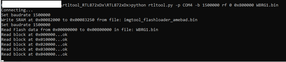

    Ah, so I just ground UART pin at reboot time. Ok.
    It's not from Alie, I haven't found a suitable one on Ali yet, I got one locally.
    Console reading flash data using rtltool.
    Added after 5 [minutes]:
    https://github.com/openshwprojects/FlashDumps/commit/09d910414a3f3fe190f754f4a4d5f1583fe6f186

    it worked with second attempt, it's flashing now, offset is strange?
    Screenshot of a terminal showing a flashing process with a device error related to setting flash status.
    Screenshot with error messages related to Flash memory writing.
  • #219 21447390
    Posts: 5121
    Help: 441
    Rate: 904
    I don't understand the RTL 0x08000000 = 0x0 thing
    But isn't the 8mb file just 4mb read twice, so 4mb is the full correct dump?
  • #220 21447392
    Posts: 14677
    Help: 656
    Rate: 12702
    Trying lower speed now.
  • #221 21447393
    Posts: 5121
    Help: 441
    Rate: 904
    I was also getting "error: Set Flash Status" when trying to write to RTL8720DN with rtltool so switched to official RTL AmebaD tool
  • Flashing 4 MB image still boots as invalid image
    #222 21447441

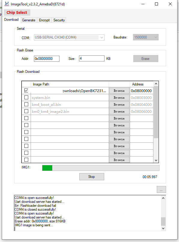

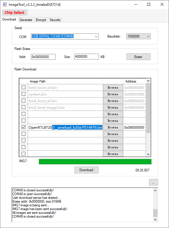

    python rtltool.py -p COM4 -b 100000 wf 0 ff1_8mb.bin
    Connecting...
    Erase Flash 2048 sectors, data from 0x00000000 to 0x00800000
    Write Flash data 0x08000000 to 0x08800000 from file: ff1_8mb.bin
    Flash block checksum retrieval error!
    Ok it seems I need to try other tool
    Added after 15 [minutes]:
    ImageTool_v2.3.2_AmebaD window with selected serial port COM4 and loading binary files.
    Added after 4 [minutes]:
    COM4 is open successfully!
    Uart download server has started...
    All images are sent successfully!
    COM4 is closed successfully!
    Erase addr: 0x8000000, size:8192KB
    IMG1 image is being sent...
    IMG1 image has been sent successfully!
    Added after 57 [seconds]:
    divadiow wrote:
    Does this 4mb file do anything if flashed? Anything different to my result flashing to DN board? https://www.elektroda.com/rtvforum/topic4106646.html#21443892
    #calibration_ok:[2:23:13]
    [MEM DBG] heap init-------size:256000 addr:0x1003a740---------
    #Invalid image, reboot

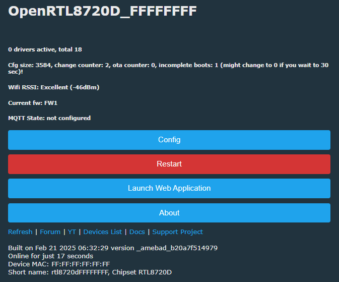

    OpenBeken boots on RTL8710B wbrg1 with flash warnings

    Basics are done, i can at least get it to boot. Decided to do it all on wbrg1, not bw16.

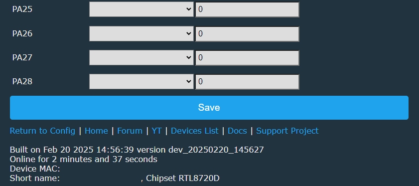

    Added after 1 [hours] 30 [minutes]:

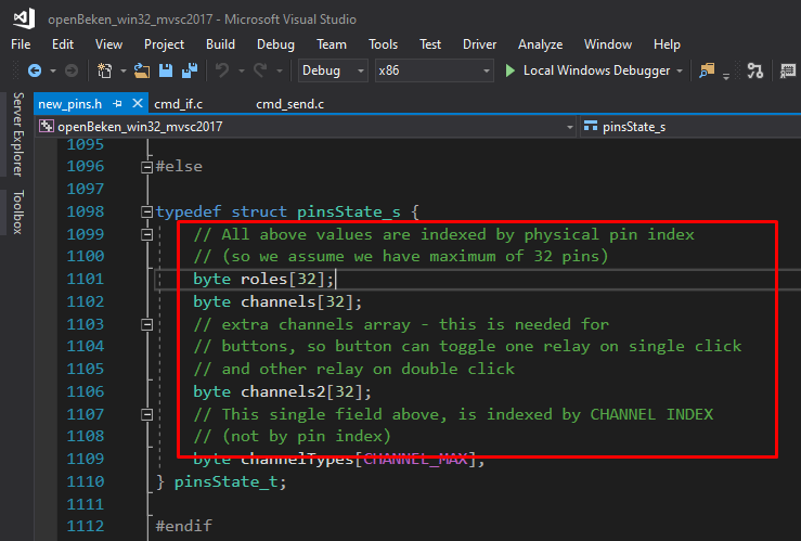

    Is there a limit on maximum pins displayed in cfg_pins? i set up pins PA0-PA31 and PB0-PB31, but only PA0-PA28 are displayed.
    Screenshot of a user interface with PA25-PA28 options and a save button.
  • #229 21448209
    Posts: 14677
    Help: 656
    Rate: 12702
    32?
    Screenshot from Microsoft Visual Studio showing a code snippet in C language.
    There is also PLATFORM_GPIO_MAX...
  • #230 21448216
    insmod
    Posts: 1412
    Help: 164
    Rate: 445
    >>21448209 My bad, i forgot to define PLATFORM_GPIO_MAX

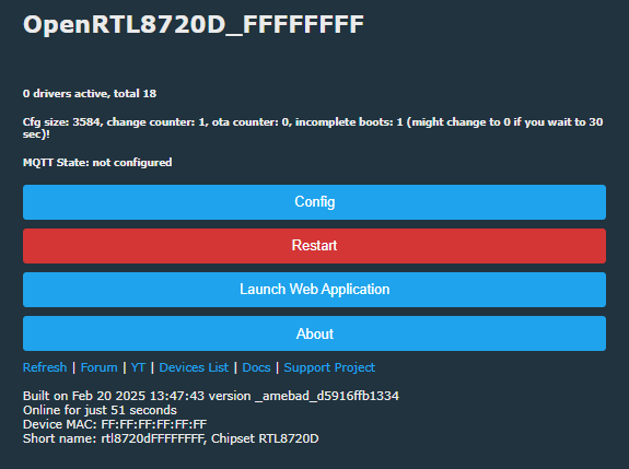

    BW16E
    User interface of the OpenRTL8720D device with buttons for configuration and restart.
  • Advanced channel types discovery may be missing

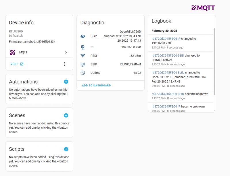

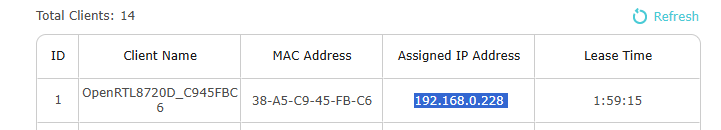

    Screenshot of ImageTool v2.3.2 program with process for AmebaD chip.
    List of available Wi-Fi networks with a visible network named OpenRTL8720D_C945FC6.
    First page open at 192.168.4.1:
    OpenRTL8720D user interface with configuration and restart options.
    Page loads quickly, but not always fully.
    Table with information about a network client with the assigned IP address 192.168.0.228.

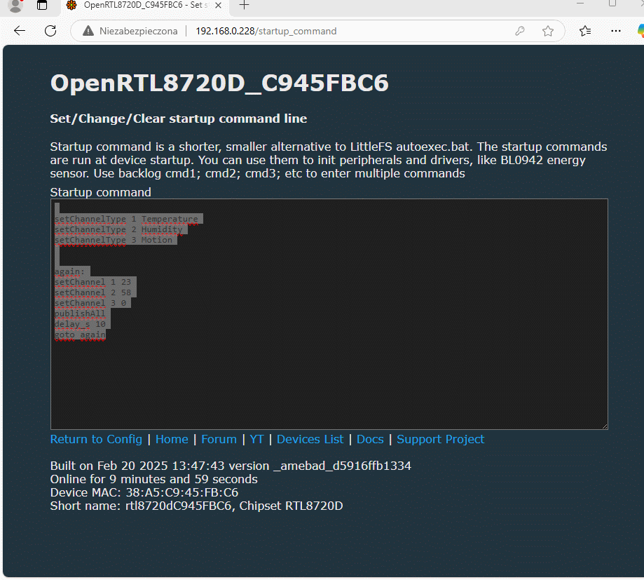

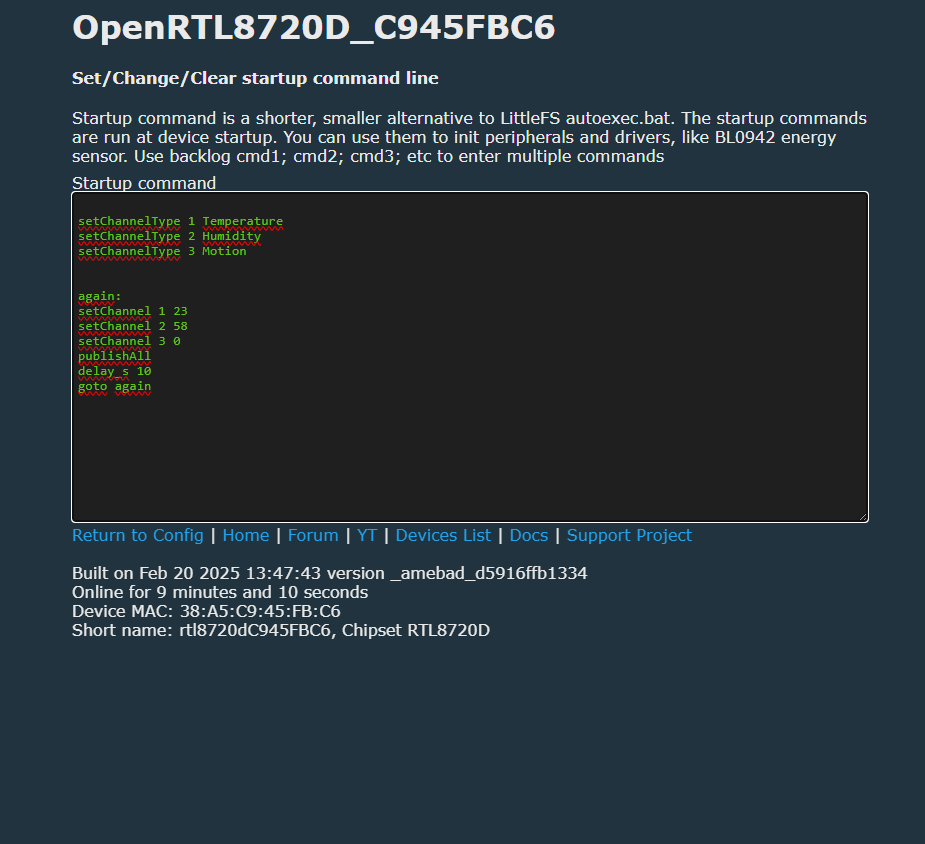

    Let me prepare something for testing...
    Added after 8 [minutes]:
    Wait a sec, where is save button:
    Startup command interface for OpenRTL8720D device.
    setChannelType 1 Temperature
    setChannelType 2 Humidity
    setChannelType 3 Motion
    again:
    setChannel 1 23
    setChannel 2 58
    setChannel 3 0
    publishAll
    delay_s 10
    goto again
    OpenRTL8720D configuration page with startup command console.

    No Humidity/Temperature/etc in HA?
    Screenshot of the device information panel with sections Device info, Diagnostic, and Logbook.
    Is
    Code: C / C++
    present in obk_config.h ?

  • Initial flash and boot log on BW16E/DN
    #238 21449607
    Posts: 5121
    Help: 441
    Rate: 904
    initial flash to BW16E/DN after full erase
    ImageTool v2.3.2.3 window with a list of files for download.
    First boot, join AP and then join test wifi as a client
    doesn't like something about mac
