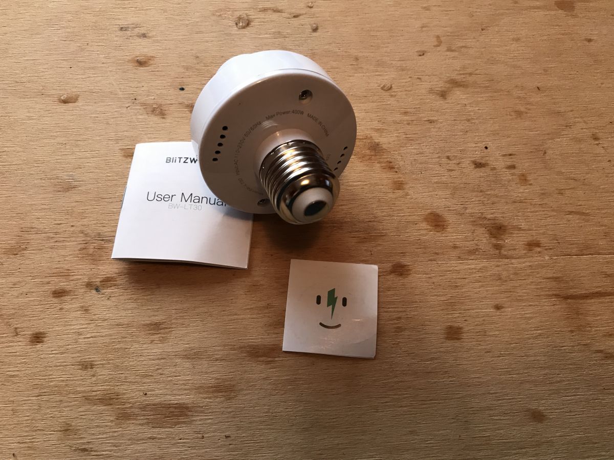

    There was also the usual short instructions inside:
    BW-LT30, a WiFi adapter for a light bulb - test, teardown and ESP firmware uploa

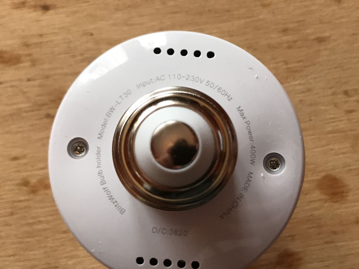

    Fortunately, the adapter itself looked untouched:
    BW-LT30, a WiFi adapter for a light bulb - test, teardown and ESP firmware uploa BW-LT30, a WiFi adapter for a light bulb - test, teardown and ESP firmware uploa BW-LT30, a WiFi adapter for a light bulb - test, teardown and ESP firmware uploa BW-LT30, a WiFi adapter for a light bulb - test, teardown and ESP firmware uploa
    The button immediately catches the eye, after all, it is a classic tactile switch and it can be seen from the outside. Shouldn't there be some kind of cap on it, a rubber band? But from the pictures on the internet it seems that no...

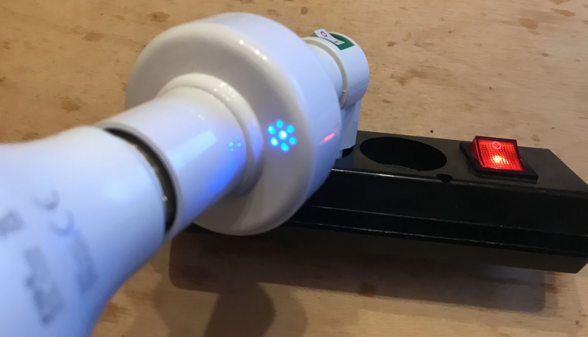

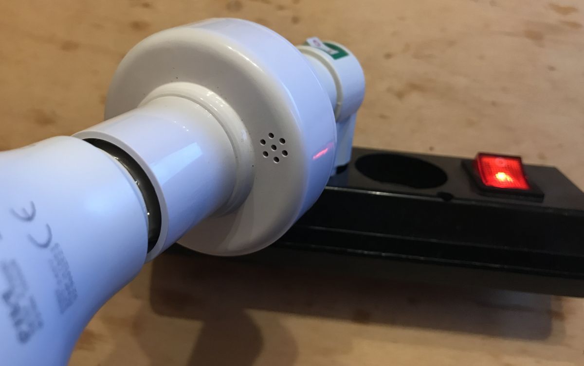

    I turned the device on and off (with the button on it) several times, according to the instructions:
    This caused the LED on the device to flash:

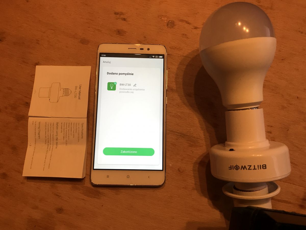

    I checked the "Confirm blinking" box, clicked "Next" and the rest of the pairing was successful by itself:

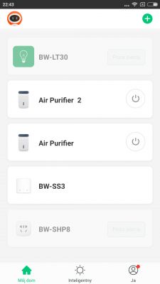

    Since then, the device has appeared in my list of Blitzwolf devices:

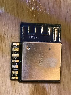

    On the cover of the WiFi module there is only the name of the whole device - LT30:
    So it's not sure what kind of module it is, but it looks like an ESP8266 (often used in this type of devices). This is also suggested by the pins signed on his board (GND, TXD0, IO5, IO2, IO15, Tout).
    In addition, soldering points (VCC33V, GND, IO0, TX, RX) are signed next to it, which look like a programming connector:

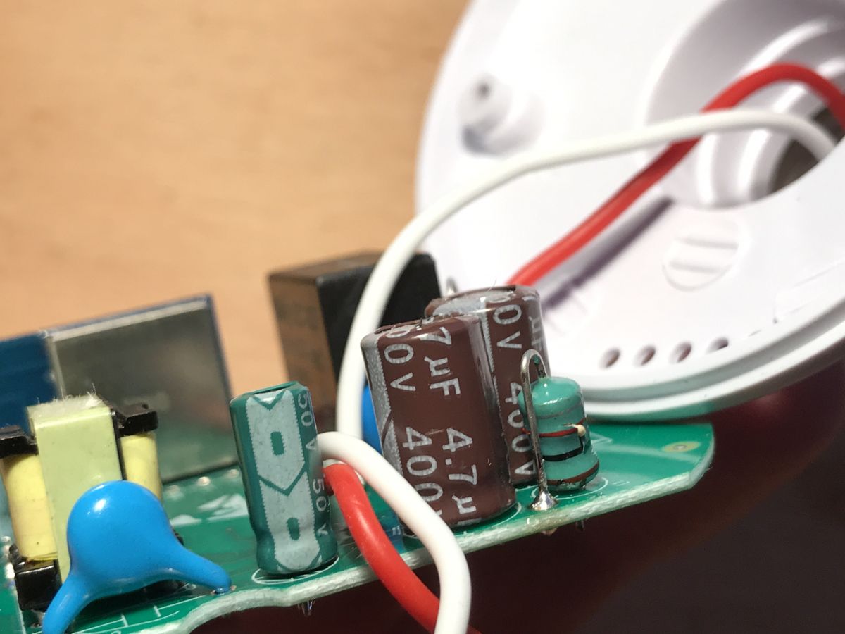

    On top of the board you can also see 4.7uF 400V capacitors, a choke:
    You can also see a small transformer, so there is probably a small impulse power supply on board.
    As well as the element signed "F1", probably from Fuse (fuse / fuse resistor) and VR1 (varistor):

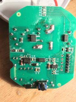

    There are a lot of SMD components on the bottom.

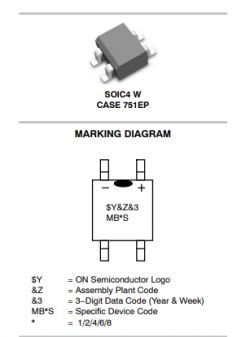

    First of all, the MB6S mains voltage rectifier bridge in the SOIC4 housing:
    His datasheet for those interested:
    MB8S-D.PDF (345.88 kB)You must be logged in to download this attachment.
    A little further behind it is the THX208:
    This is the PWM controller of the converter, i.e. the system on which the module is powered from the ESP. It creates a small switched-mode power supply that runs all the time as soon as the BW-LT30 is connected to the mains.

    JC3H7 is just an optocoupler. It looks like the more famous one
    JC817:
    Also nearby are the rectifier diodes required for the THX208 to function:

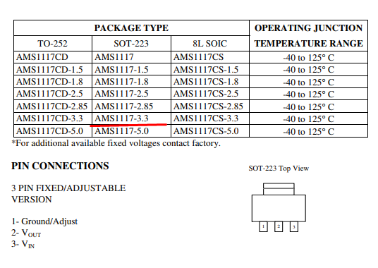

    In addition, there is also AMS1117 3.3, which is an LDO regulator providing a stable 3.3V for ESP:
    In addition, on the board we see one small transistor that simply turns on/off the relay and is controlled directly from the GPIO from ESP.

    But then I decided that I would not guess what kind of ESP is inside (although I know that it would be possible without it) and I just decided to desolder it from the board with a braid:
    After desoldering, I saw that its pins on the other side are signed - it will come in handy for sure . Before desoldering, it was covered by a laminate.
    I also took off its cover:
    My initial suspicions were confirmed. It's an ESP8266, along with a 26MHz clock and a BoyaMicro Flash memory chip.

    As well as the element signed "F1", probably from Fuse (fuse / fuse resistor) and VR1 (interference suppression capacitor):
    F1 is the fuse, VR1 is the varistor (surge protection).
  • #3 18976663
    Posts: 14760
    Rate: 12887
    Thank you, I corrected. VR1 somehow reminded me visually of CY1 (also on this board), this 1nF capacitor connecting the primary and secondary sides of the converter and I mistakenly treated these elements as one.

    It would be a good idea to check what size this Flash memory is.
    I noticed this, but I was suggested by the message from the Arduino IDE:
    and I found that it correctly detects itself.
    But OK:
    25Q80BSTIG, I think 25Q80BSIG.
    This would be consistent with what has been discovered...
