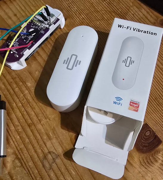

    Has anyone ever converted a Tuya Vibration Sensor to Openbeken?
    I have flashed the device but now I am pretty clueless on how to proceed as I have not found a similar device in the tutorials.
    I am not even sure there is a driver yet.

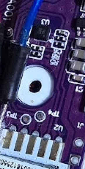

    The MCU is a CBU /BK7231N and the acceleration sensor seems to be a LIS2DW12. There is at least a development board with this sensor and it seems pretty identical.
    It seems the communication works via I2C and then there is an interrupt to give out the signal.
    PIN8 (P8) is the button, PIN19 (P9) the LED.
    Pinning out the sensor is difficult but TP4 is Pin10(P6), TP3 is Pin11 (P26) and i am measuring 10K from TP1 to PIN18 (CEN)
    Maybe someone has already done a similar device or it is not as hard as I assume to make it work.

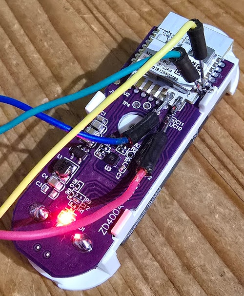

    This is a lot of helpful information, especially the boot sequence. I tried reading out the I2C, but it seems I have not found the right pinout.
    I have noticed some of my multimetered results have been wrong - nevertheless.
    The boot sequence suggests:
    PIN16=Reset button (tested - correct)
    PIN9=Status LED (tested - correct)
    PIN26= Basic pin / Gate PIN (????)
    PIN20=Battery ADC?
    PIN17=Wifi LED (I don't think there is a second LED on the board)
    PIN6= Tamper Pin (I guess the output of the I2C Sensor)
    I tried Pin6 (that's obviously wrong) and 26 for SDA and SCL with soft I2c,
    reversed it and later did the same with P8 and P7.
    Also I noticed sometimes I do see the scan running from 1 to 128, and sometimes I just get the the "Result OK" message.
    Strange.

    If the attached is the correct datasheet, and looking at one of the pics, could it be that SDA/SCL is P8/P7 via two resistors? Bit of a guess, can't really see enough.

    Okay, now I got I2C - and am probably stuck missing a driver :-D
    The address is 0x26.
    Is it possible that it won't start / connect to WiFi anymore after putting in P20 BAT ADC 1?
    Really strange. I experienced something like this earlier when I put it into deepsleep and could not wake it anymore. Ended with reflashing .
