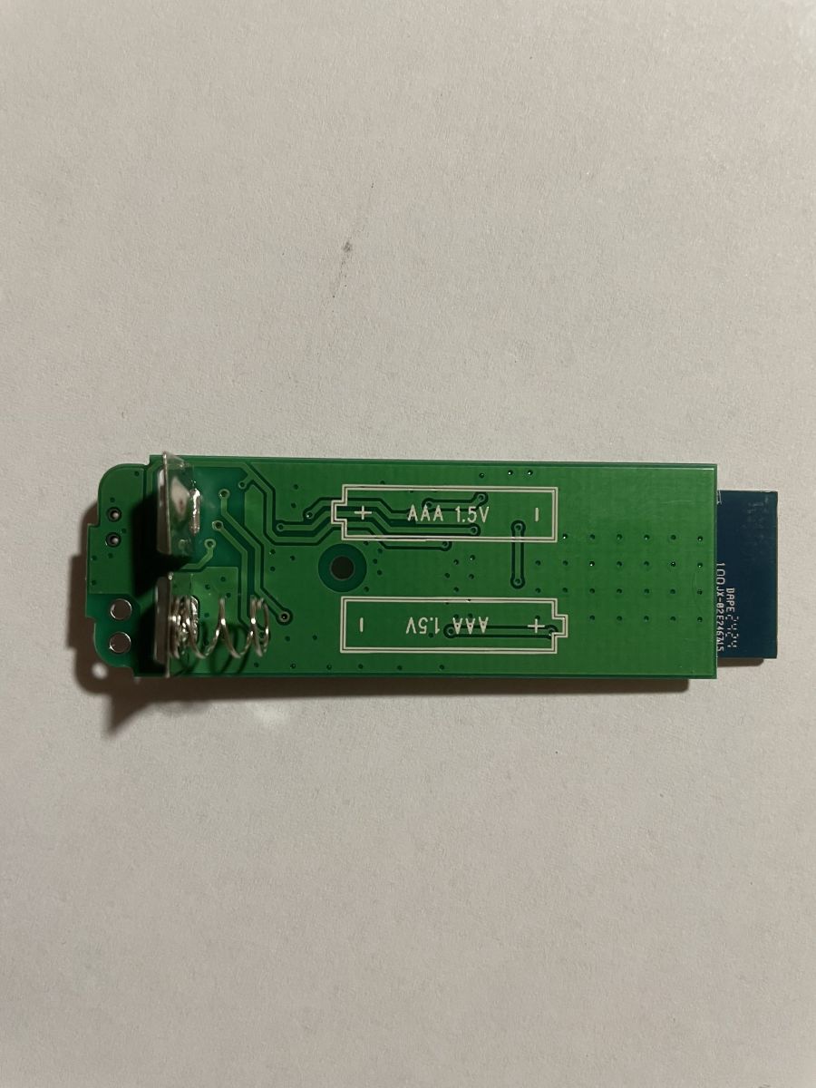

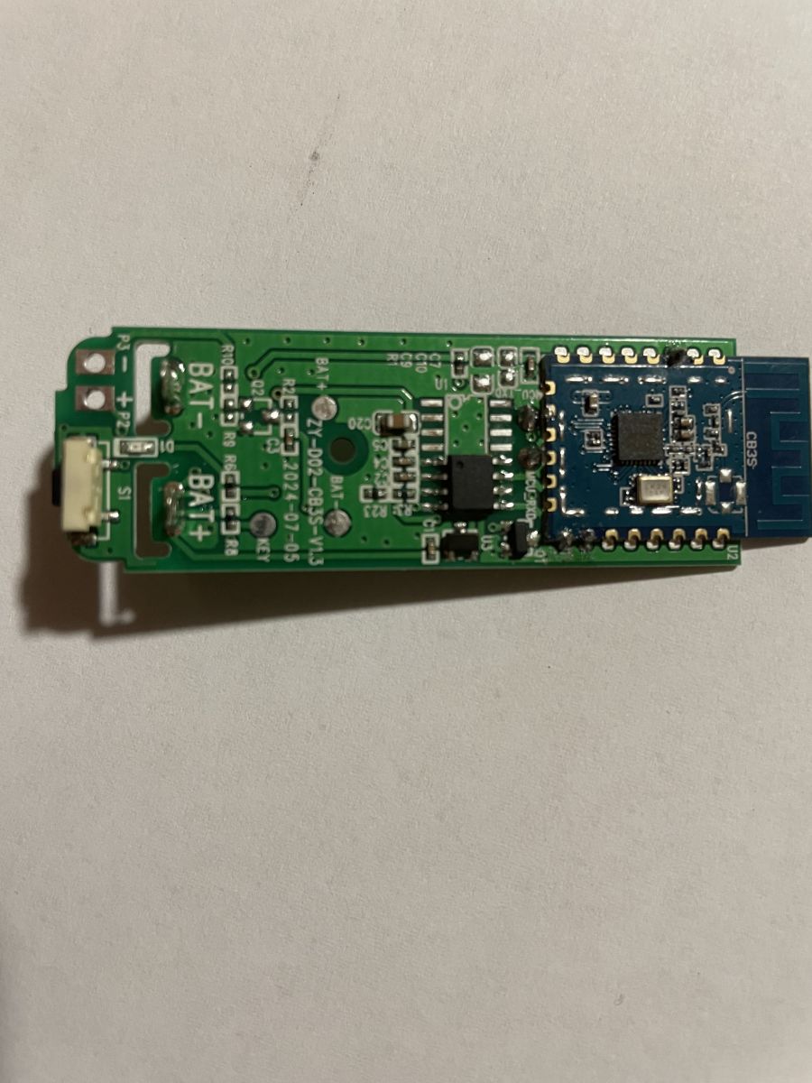

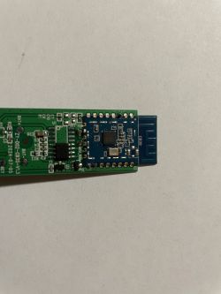

    So bought these door sensors
    https://vi.aliexpress.com/item/1005007537059674.html

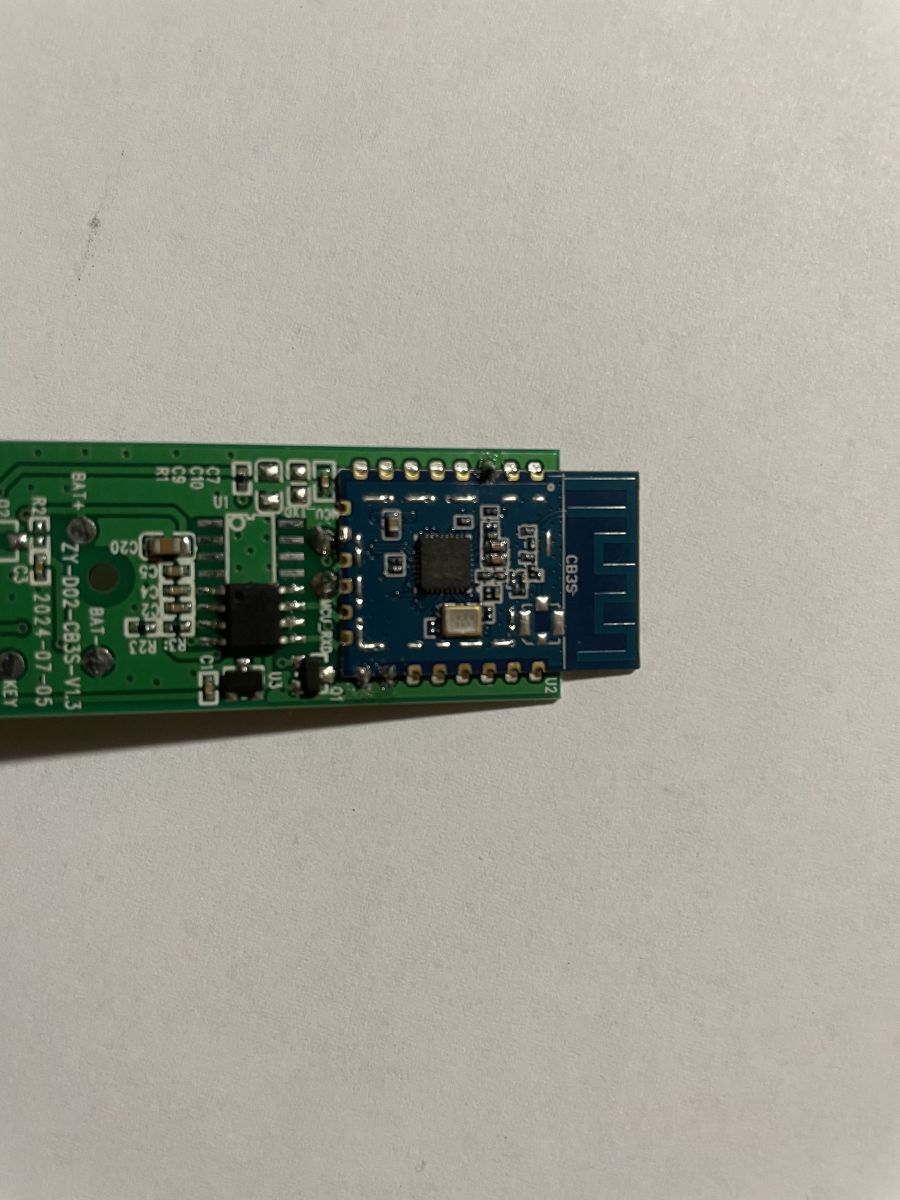

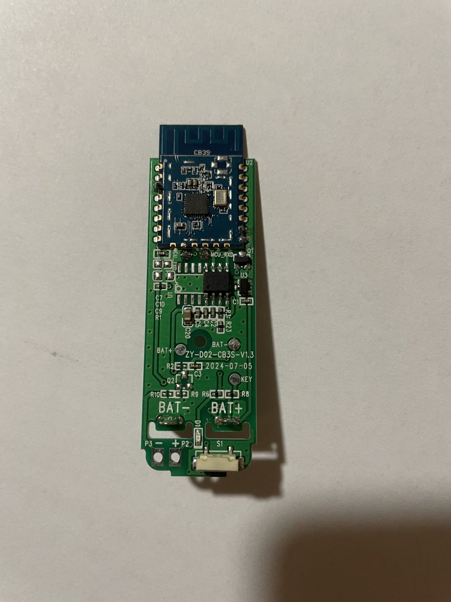

    Upon first inspection, they appear to be using BK7231N and an unmarked 8pin MCU (or some other chip, TuyaMCU maybe?).
    Now flashing openbeken was no trouble, but now I'm stuck because the device does not appear to get any power to the BK7231N. It appears that the unmarked MCU might be turning on/off the BK7231N chip.
    Any such devices out there and how to get this working?
    Circuit of a door sensor on a green PCB with slots for two AAA batteries. Close-up of a circuit board featuring a BK7231N module and an unmarked chip. Electronic module with visible integrated circuits and traces on a PCB. Electronic circuit board with CB3S wireless module on a white background.
    Added after 2 [hours] 47 [minutes]:
    Ok so i've made some progress;
    Device is pretty much identical to this one
    https://www.elektroda.com/rtvforum/topic4028222.html
    Except TuyaMCU channels are different, so the supplied config doesn't work
    I've corrected this and it works now. Channel 103 mightbe the battery state.

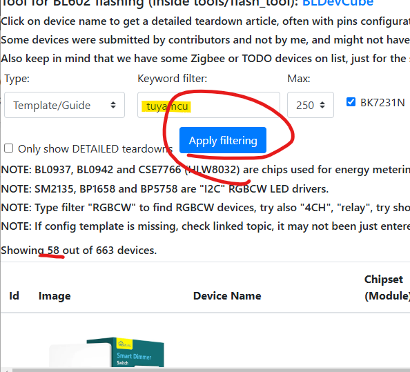

    This device is TuyaMCU controlled so there will be no pin assignments to extract from the factory firmware to then import into OpenBeken. Setup of these devices requires the user to create and populate an autoexec.bat file on the LFS file storage within OpenBeken. Post number 1 of this thread has such content.
    TuyaMCU flashing, setup and configuration guide - configure dpIDs for Home Assistant
    The process can also be gleaned by sifting through other TuyaMCU device threads like:
    [BK7231N] [CB3S] [AHT20] TH01 Generic Temperature and Humidity Sensor Teardown
    or many others in devicelist https://openbekeniot.github.io/webapp/devicesList.html
