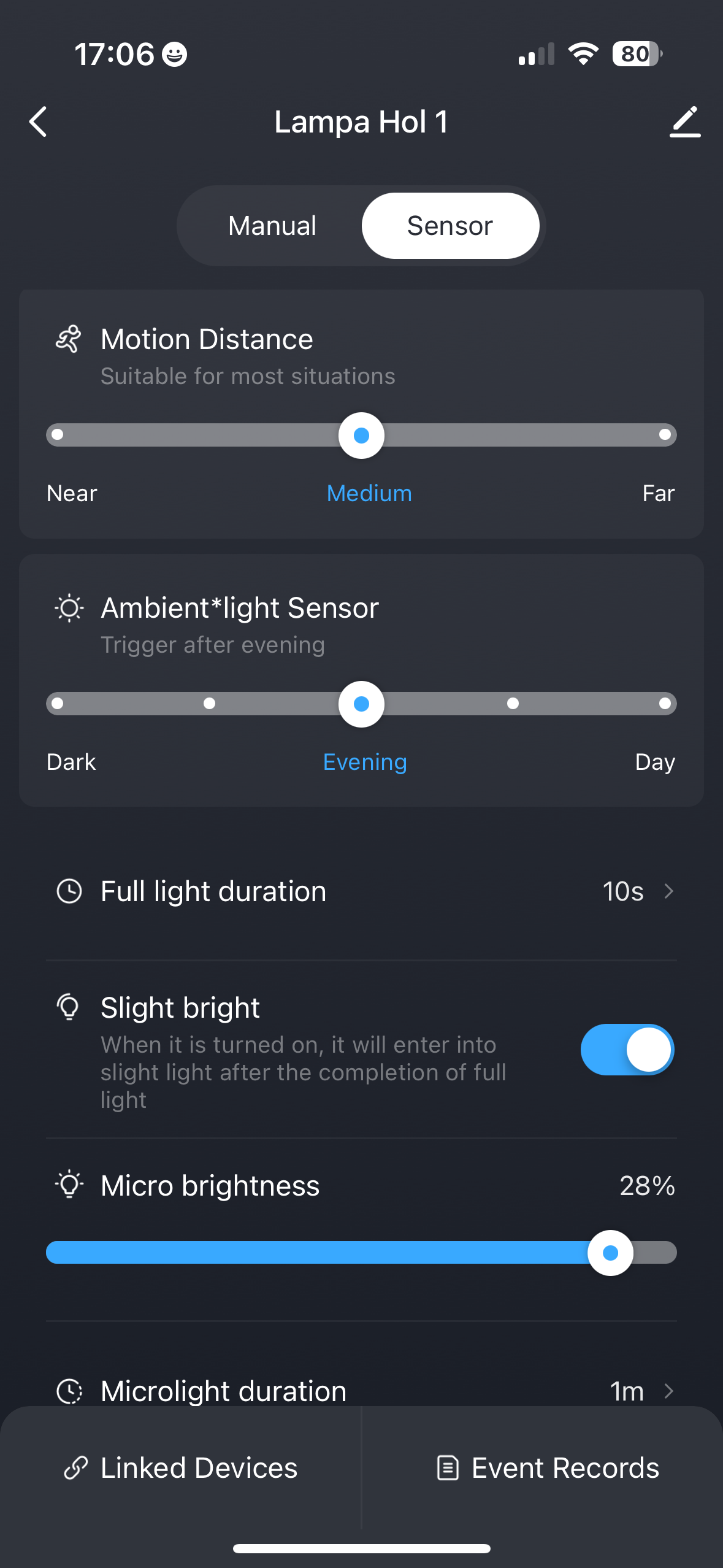

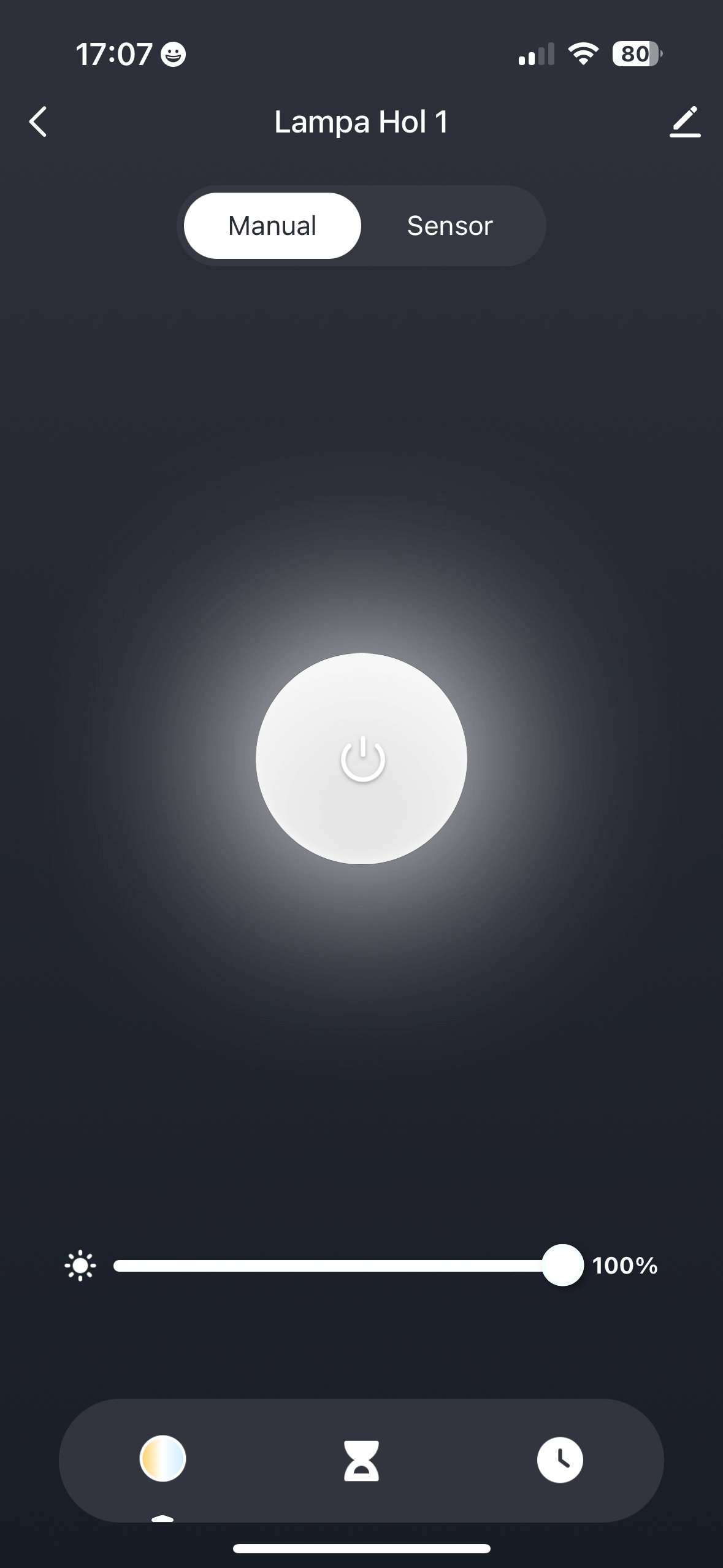

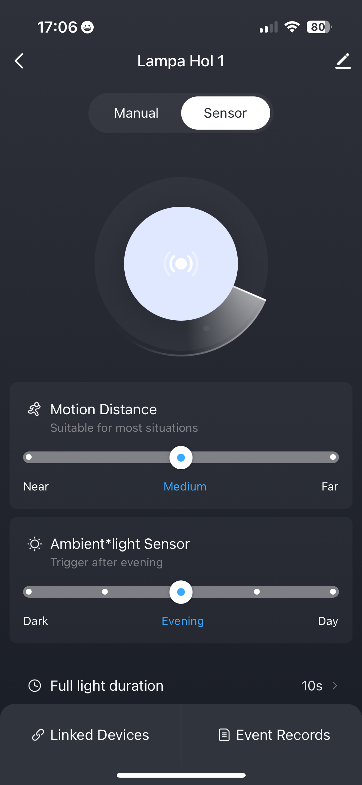

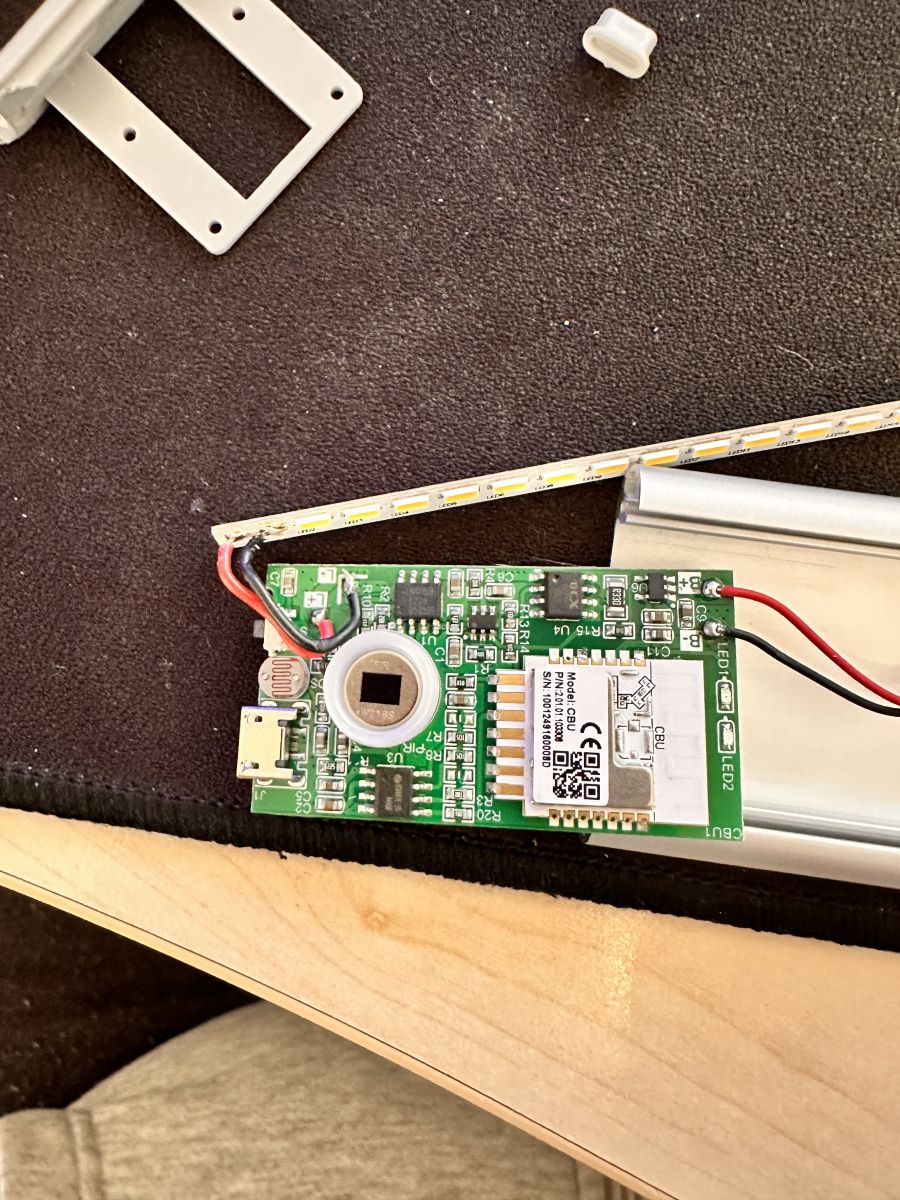

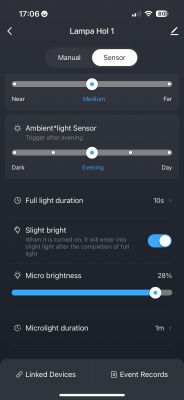

    Today I bought a new device with CBU on it. Flashing only works via UART, and the version is MCU v1.0.10.
    WiFi cabinet LED lamp for smart home lighting.
    https://vi.aliexpress.com/item/10050056714858...t_main.16.4e5f1c24BrcPTA&gatewayAdapt=glo2vnm
    After I did a full backup, I tried to put Open Beken on it, but it is not working. I can only control the LED, but not the PIR and Lux sensors, which I have from the extracted bin file.
    - LED Cool (Channel 4) on P24
    - PWM Frequency 1000
    - PIR Sensitivity 8
    - PIR Frequency 20000
    - Control Pin (TODO) on P26
    - PIR Low Duty 16
    - PIR High Duty 7
    - PIR Input 6
    Device seems to be using CBU module, which is using BK7231N.
    On ESPHome, I have the same problem. But on ESPHome, I can control the LUX and PIR sensors, but not like on the Tuya App. On the Tuya App, you can control the LED as a switch and can control the LED with the PIR and Lux sensors.
    Lighting control panel Lampa Hol 1 with on/off button. App interface with settings for Lamp Hol 1 User interface of a lighting control app for Lampa Hol 1”. App screen for Lampa Hol 1 with sensor settings. Close-up of a circuit board with a micro USB connector and LEDs on a strip.

  • ESP32-C3 replacement with ESPHome deep sleep config
    #4 20976457
    lionboy
    Posts: 69
    Yes i change CBU with ESP32-C3 and now i am running on ESP32 with deep sleep implemented and Esphome;
