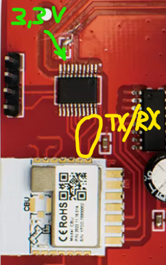

    Today I tried to make a backup and flash it, using the BK7231 Flasher. I did set it to "BK7231N" and tried a firmware read, but it can not connect to bus. Instead, the device can be accessed in the SmartLife-App. TX and RX are connected to Pins 15/16 (as always), CBU's Pin 14 is connected to a dedicated power supply 3,3 Volt, ground is connected to Pin 13 and the UART adapter as well. Pin 18 ist Reset and pulled to ground for a short moment.
    Serial connector shows up in Device Manager, COM-Port is selcted accordingly.
    After trying for about a hour, de- and resoldering connections, restarting Flasher-App, dozens of resets on CEN, I gave up for now.
    A cross-check with the 8-channel model gave expected results: succesful backup in a few seconds.
    What can I do? Desoldering the CBU isn't an option. This could only be done by using a heat gun, but even if I manage to detach it without destroying, I couldn't resolder it again. The CBU is soldered invisible (on the backside) to the mainboard
    What could be done, if it helps: Disconnect the TX/RX lines between CBU and MCU (quite easy) or disconnecting 3,3V line to the MCU (very difficult). Which option is more promising?
    Electronic board with 3.3V and TX/RX markings
    Impossible to read anything on the MCU, thus I can't find any information about this chip
    Hinzugefügt nach 8 [Stunden] 23 [Minuten]:

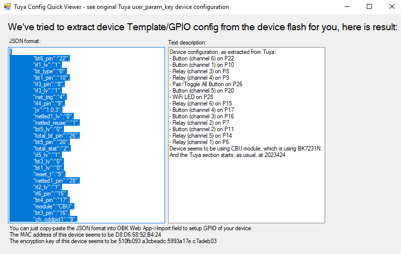

    I did cut RX/TX Pins to the MCU, then I managed to do a Readback and finally flash the device.
    The readback provides a proper JSON, that can be easily imported:
    Screenshot of Tuya Config Quick Viewer tool extracting Tuya device GPIO configuration.

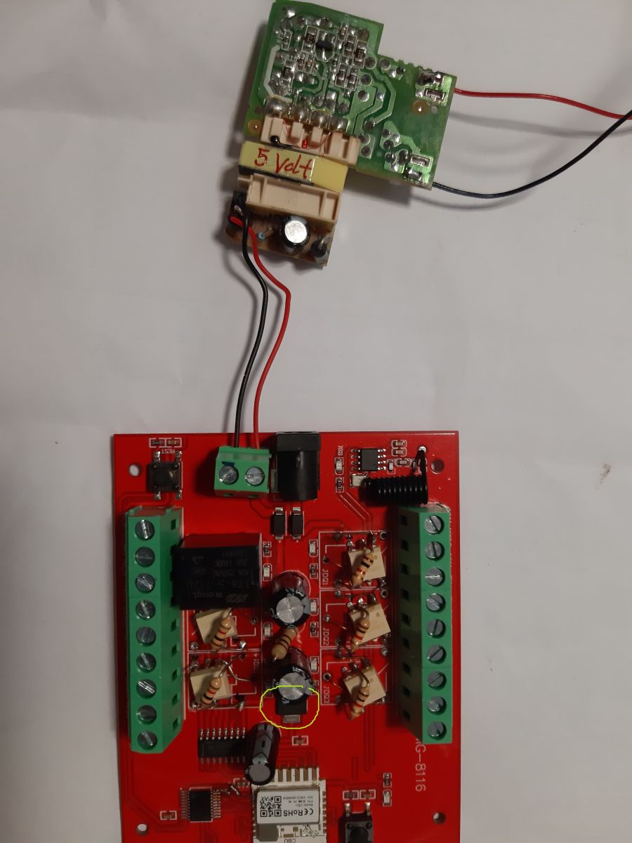

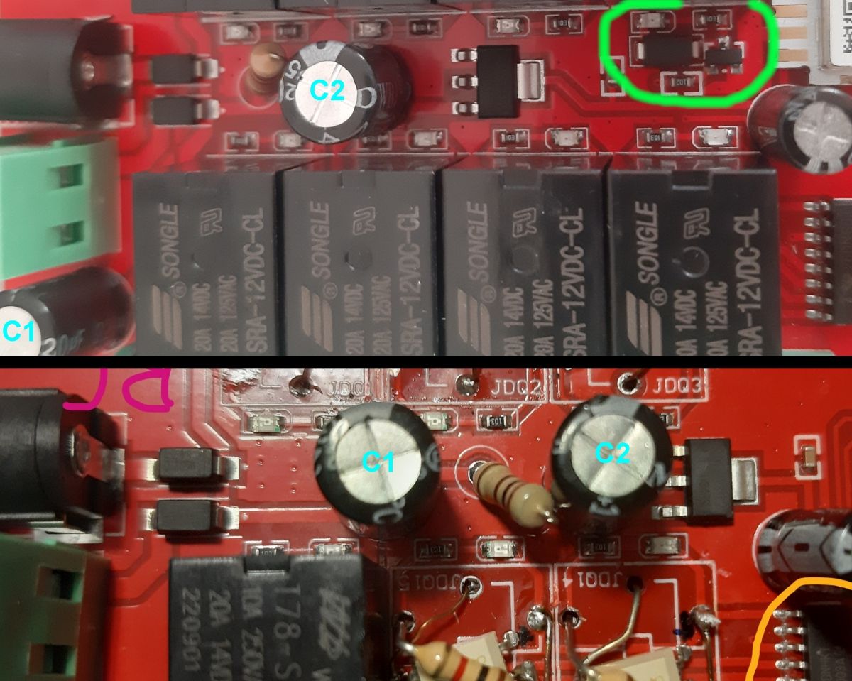

    My module is running on 5V.
    The power for the electronics part is supplied by a voltage regulator (green circle). (This board is running on 5 channels only, the remaining 12V relay isn't functional)
    Circuit board with electronic components and wires.
    Hinzugefügt nach 6 [Stunden] 44 [Minuten]:
    Just discovered, that I have a problem: For the five inputs, that I would need to have (they sense the status of the thermostat switches) I have only two unused, free pins on the CBU. All other are taken: six channels control the hardware relays, one is the hardware switch for "toggle all relays", one for the Wifi LED, two are +3,3V and ground, four for RX/TX and RX2/TX2. Six more (and here starts the riddle) are non-hardware buttons. They connect from the chip that (I thought) is the MCU. So what function has this "MCU" (if it is one), if it doesn't control the relays? In the above picture (in Post #2) it is the chip where the green arrow points to. The other chip (where the yellow X is on it) probably could be the driver for the hardware relays (they are originally 12V types).
    This board is intended to ship with a remote control, maybe this is the function of the supposed MCU? Maybe it forwards separate signals for each relay that has to be switched - thus the configuration as "button" ???
    Sadly my board was shipped without RC (maybe by mistake), so I can't verify that. But if my thoughts are correct, I wouldn't need this MCU (?) at all, and could re-use the CBU pins, that it occupies.

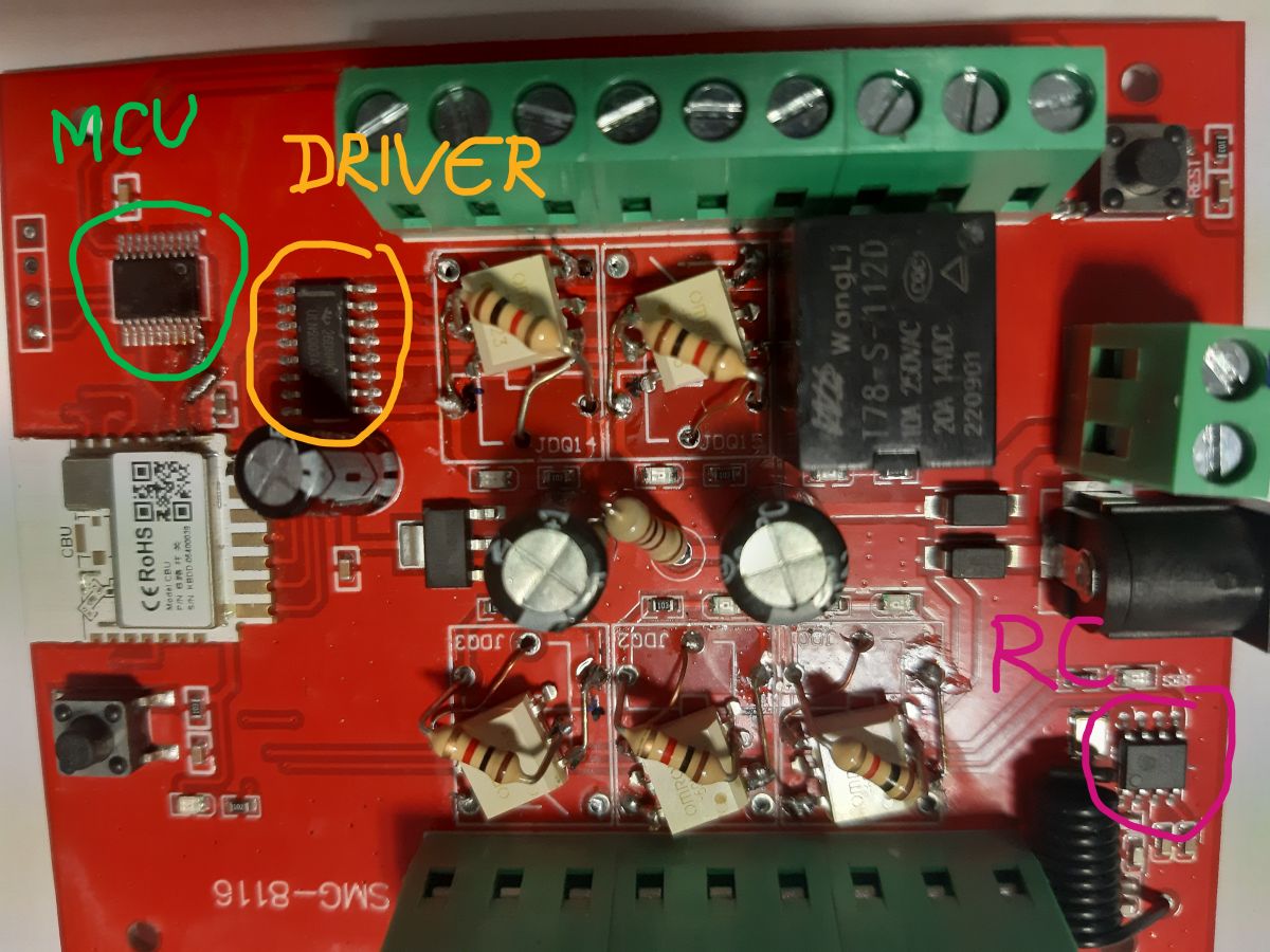

    Could one of the moderators please change the title of this thread from "Exploring eon0r4..." to "Exploring Scimagic-RC SMG-8116..."
    Can't do it by myself.

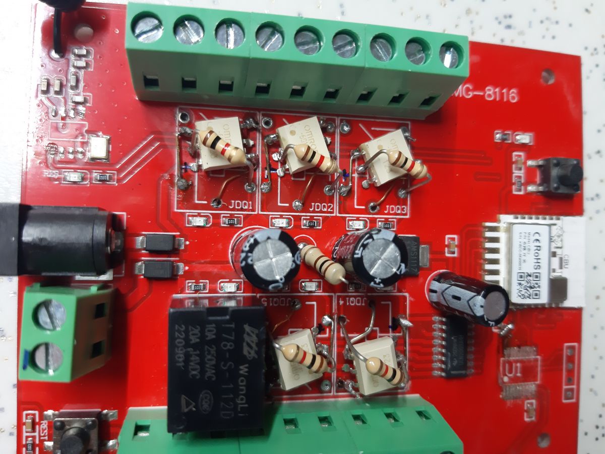

    Hinzugefügt nach 38 [Minuten]:
    It's as expected: The MCU connects on various Pins directly to the RC-chip (at least that's what I call it). And the yellow marked chip is really the relay driver. All it's inputs (on the CBU side) connect directly to the CBU, all it's outputs (on the relay side) connect individually to the GROUND Pins of the hardware relays.
    So I'd guess, that this MCU isn't needed at all, unless one plans to use a remote controller 433 MHz.
    Anyone who shares my thoughts?
    Electronic board with markings MCU, DRIVER, and RC in different colors.

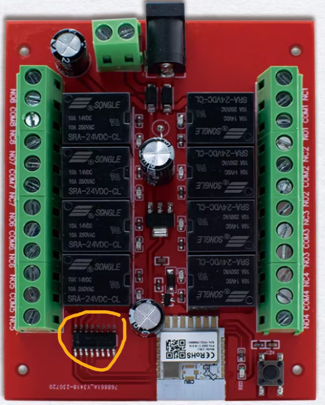

    Another idea, to proof that I'm probably right: This board is available also in a 8-channel version without RC, and this board lacks completely the MCU and RC chips. There is only the hardware driver:
    Red electronic board with green connectors, relays, and markings.

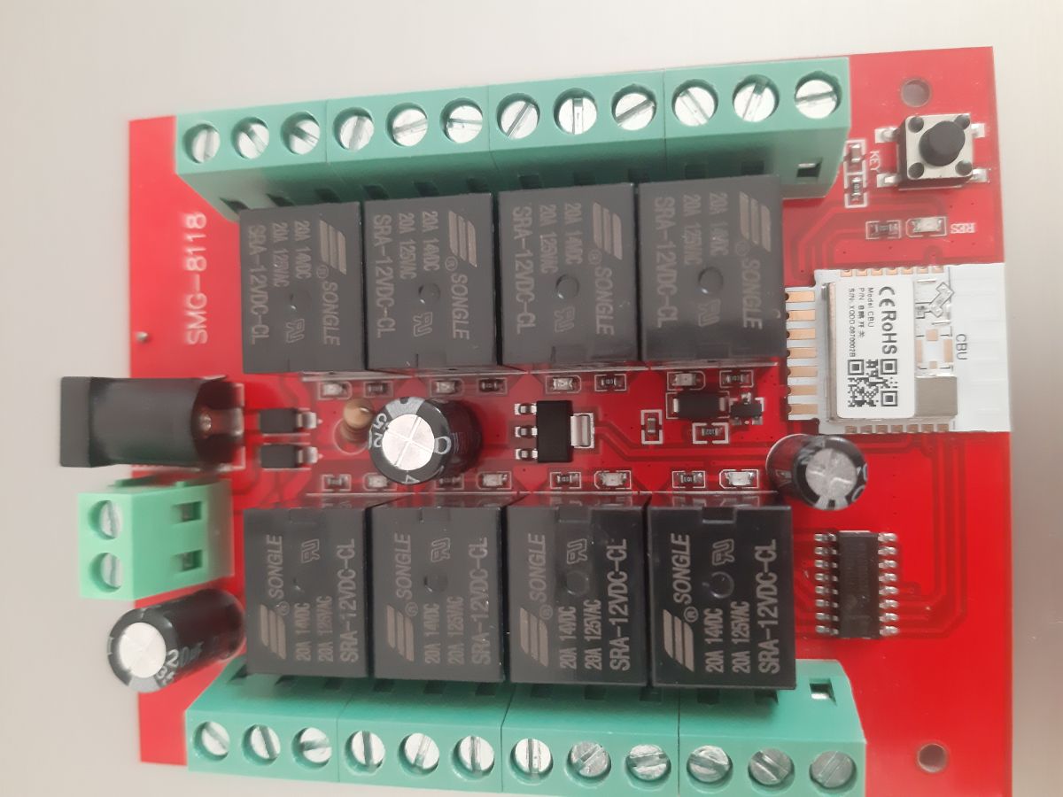

    Now we have also the 8-channel version, SMG - 8118
    Scimagic-RC SMG-8116 electronic board with various components.
    What we get in Tuya Developer Platform for this type is:

    As always, I have a lack of available, untaken pins on the CBU for input purpose of the thermostat switches. There are only three available by scratch and I need six in total. The "Toggle all" hardware button is unnecessary for me and I could use this pin, so two are still missing. Probably I could missuse the pin for Wifi-LED, but one would still be missing. So I should opt for the control lines for the two unused relays and disconnect them from the relays driver chip. Let's wait and see what turns out to be easier.
  • 5v mod by bridging 100 ohm resistor
    #8 21527976
    io2345
    Posts: 273
    Rate: 7
    >>21511708 I used the relays control lines, they are easy to reach.
    It might be worth to mention, that the 8-channel board can not be run with a 5 volts power supply initially. They changed the power rail slightly, shifted C1 to the periphery and introduced an additional circuit (green circle). Now the 3,3 Voltage regulator doesn't get enough power on the input side (in fact only 3,3 V, which gives an output of 2,3 Volts). Until now I didn't understand the sense of the additional circuit, will have to think about that a little more.
    In the picture the upper board is the 8-channel, the lower the 6-channel version:
    Close-up of two printed circuit boards with electronic components, including capacitors, relays, and resistors.
    ======================0
    Edit: Just throw out the 100 Ohm resistor next to C2 and insert a bridge instead. It will run on 5V now (which makes only sense, if you substitute the stock relays by electronic ones).
