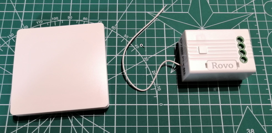

    I recently bought few ERC309 kinematic relays and switches.
    Relay: https://www.rovo.ro/produse-smart/releu-rovo-erc309-kinetic-1-canal-5a-wifi-rf433-tuya.html
    Switch: https://www.vonmag.ro/produse/info/es2154-pre...6emeWXD--N5MyjGiiAk4gMZ_FcufOVxcaAiAmEALw_wcB
    Rovo ERC309 relay with wires connected to a rectangular panel on a green measuring mat.
    I like that the switch does not require any power, battery or wires.

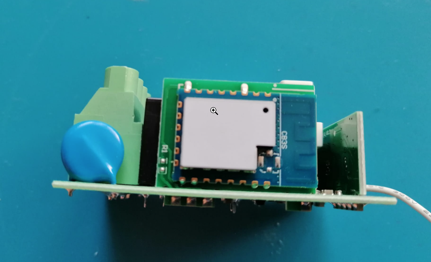

    However, after receiving them and disassemble the first one, I get a big surprise. There is not ESP8266 inside anymore, TYWE3S has been replaced by CB3S.
    CB3S module on a circuit board with electronic components.

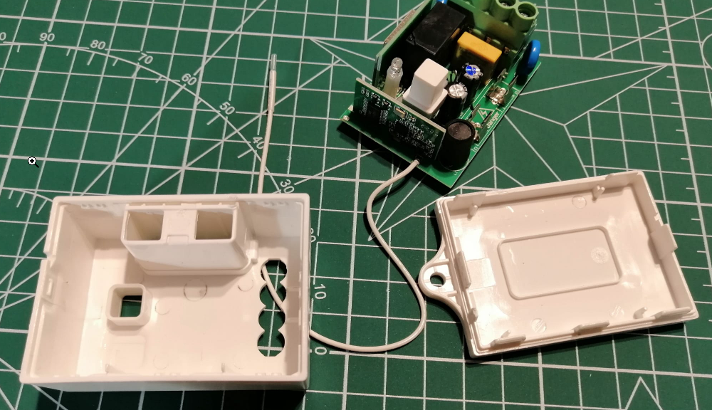

    The housing is two parts, fixed together by 7 clips. Not so easy to open without small scratches (for me at least), but doesn't matter, the relay is supposed to be hidden anyhow.
    Open relay housing of Rovo ERC309 with visible internal electronics.

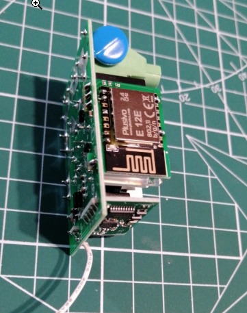

    I take out the wifi pcb, replaced the CB3S with an ESP12F flashed with Tasmota, then solder back the wifi pcb.
    Relay with ESP12F module mounted on a desk.
    Template: {"NAME":"Kinetic Switch","GPIO":[1,2272,1,2304,1,1,0,0,1,1,1,1,1,0],"FLAG":0,"BASE":54}
    It works like a charm!
