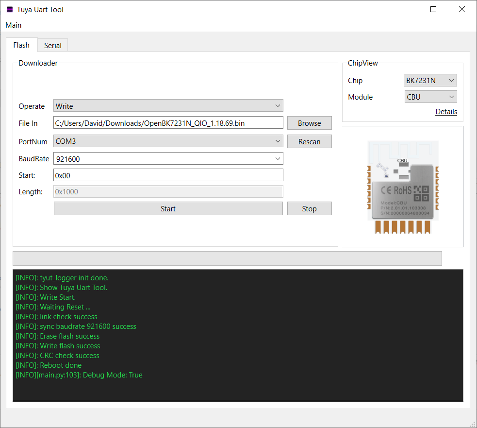

    I was searching through Gittee for random interesting stuff and came across this. I see it's had a related mention here by @niterian https://www.elektroda.com/rtvforum/find.php?q=tyutool
    https://gitee.com/tuya-open/tuyaopen#gui-tool-flashing
    Also available on GitHub
    https://github.com/tuya/TuyaOpen
    I am travelling at the moment so haven't really had a chance to test it properly, but it did read and write fine to BK7231N. OBK AP broadcast after write.

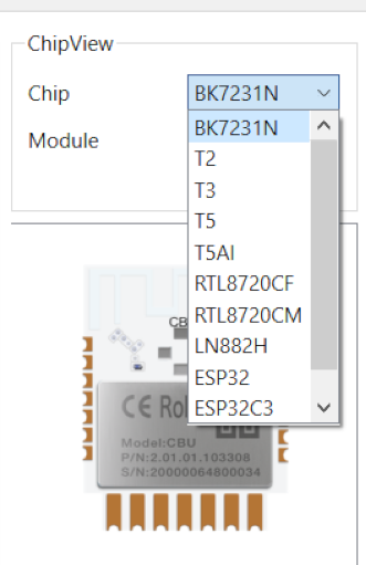

    supports quite a few chips

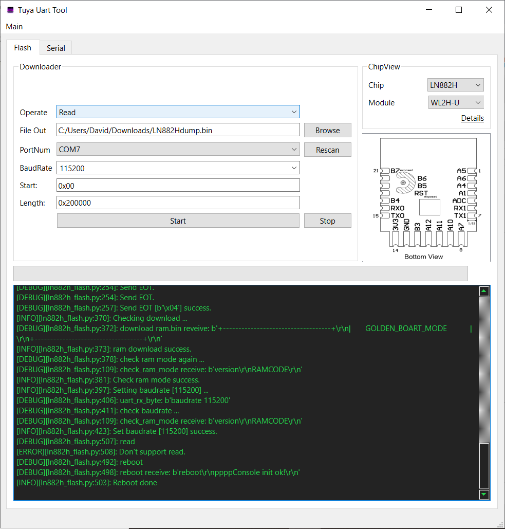

    LN882H doesn't seem to like reading though
    Screenshot of Tuya Uart Tool software interface with selected options for reading data from the LN882H chip.
    flash on OpenLN882H was a success but no AP, so not sure what's happening with that.

    well, TuyaOpen seems to be a Tuya thing and the downloads are hosted by Tuya, so yes. Annoying about the flash read. Tried ESP32 earlier and it said the same.
