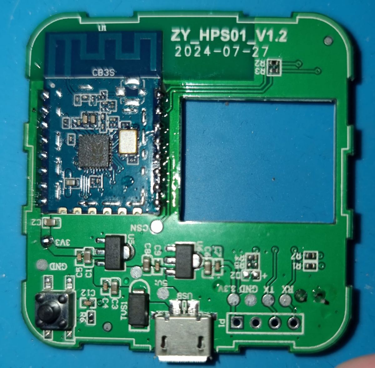

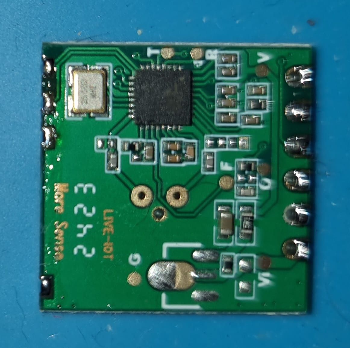

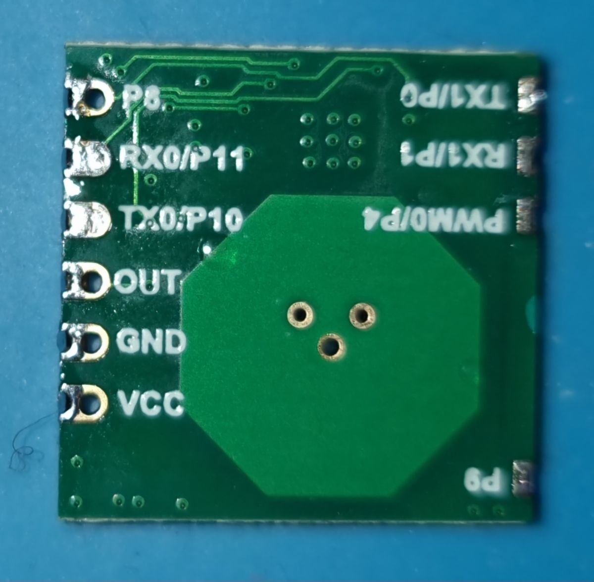

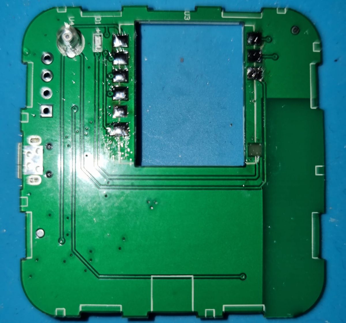

    It is actually completely different on the inside as can be seen in the images below. Note that in these images the TuyaMCU chip is temporarily taken off the board to provide a clearer overview.
    The image shows a circuit board of a device with an integrated circuit visible in the upper left corner and an empty space where a central chip was removed. PCB with CB3S Beken module. Top view of a sensor board with visible pin labels. 5.8G MmWave Radar sensor PCB
    The sensor uses a CB3S Beken MCU for wifi communication, which is connected to a "more sense" board which has a MCU on it labeled 58h32.
    Reading the post by p.kaczmarek2 provided me with the tools to debug and investigate the communication between the Wifi MCU and the TuyaMCU, which appears to use the TuyaMCU protocol at 9600 baud.

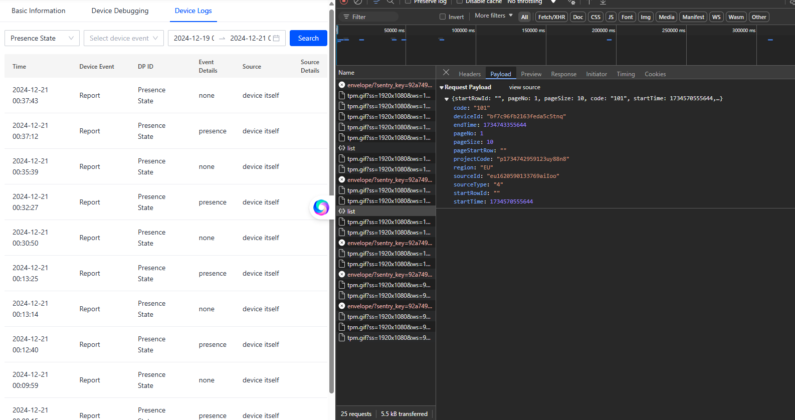

    Just for verification purposes, I looked up the dpid that the presence state should use in the Tuya Developer Cloud environment, which can be seen in the image below:
    Presence sensor event log showing status and communication details.
    This image shows that the "code" or dpid should be 101, which matches with the "65" in the packet sent by the TuyaMCU.

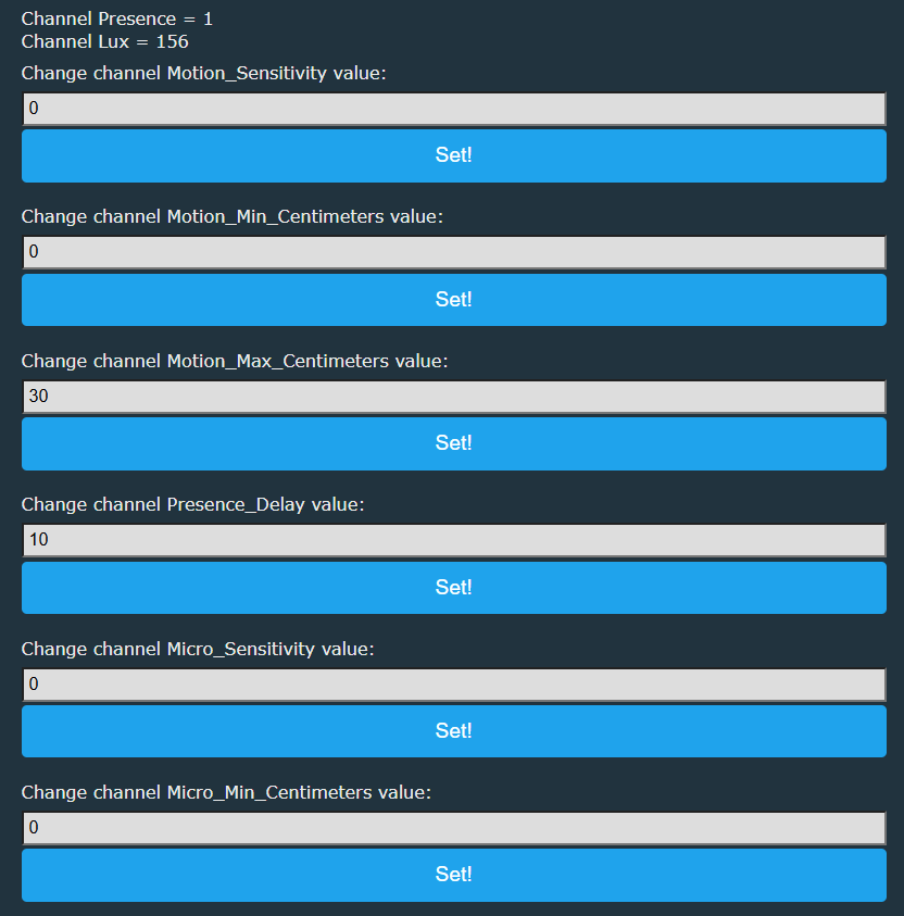

  • TuyaMCU driver reads presence and sensor DPs correctly
    #5 21360585
    vandenelsenkoen
    Good news!
    The presence value does seem to get picked up by the TuyaMCU driver within OpenBeken, and its value is updated correctly.
    For reference, this is the autoexec.bat file that I'm now using/testing with:
    startDriver TuyaMCU
    // always report paired
    tuyaMcu_defWiFiState 4
    // baud
    tuyaMcu_setBaudRate 9600
    // 101 is presence alarm
    setChannelType 1 ReadOnly
    setChannelLabel 1 Presence
    linkTuyaMCUOutputToChannel 101 bool 1
    // 103 is light sensor
    setChannelType 2 ReadOnly
    setChannelLabel 2 Lux
    linkTuyaMCUOutputToChannel 103 val 2
    // 105 is dp_motion_sensitivity
    setChannelType 3 TextField
    setChannelLabel 3 Motion_Sensitivity
    linkTuyaMCUOutputToChannel 105 val 3
    // 110 is dp_motion_range_lower
    setChannelType 4 TextField
    setChannelLabel 4 Motion_Min_Centimeters
    linkTuyaMCUOutputToChannel 110 val 4
    // 109 is dp_motion_range_upper
    setChannelType 5 TextField
    setChannelLabel 5 Motion_Max_Centimeters
    linkTuyaMCUOutputToChannel 109 val 5
    //104 is presence delay
    setChannelType 6 TextField
    setChannelLabel 6 Presence_Delay
    linkTuyaMCUOutputToChannel 104 val 6
    // 107 is dp_micro_sensitivity
    setChannelType 7 TextField
    setChannelLabel 7 Micro_Sensitivity
    linkTuyaMCUOutputToChannel 107 val 7
    // 112 is dp_micro_range_lower
    setChannelType 8 TextField
    setChannelLabel 8 Micro_Min_Centimeters
    linkTuyaMCUOutputToChannel 112 val 8
    // 111 is dp_micro_range_upper
    setChannelType 9 TextField
    setChannelLabel 9 Micro_Max_Centimeters
    linkTuyaMCUOutputToChannel 111 val 9
    Still no clue why the dpid 101 is for some reason sent using different command types and message formatting, but the TuyaMCU driver seems to be able to handle it without any problems thus far...!

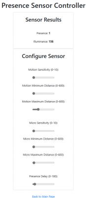

    Below two images that depict the working state of the sensor, do note that the presence value is inverted (as expected), so 0 means someone has been detected. (this can also be seen in the lower luminance value, since I placed my hand over the sensor to detect presence, resulting in a lower light value detected by the sensor)
    Screenshot showing a sensor configuration page with various adjustable settings. Screenshot of the presence sensor configuration page with channel settings.

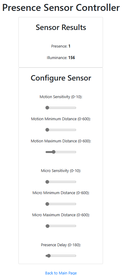

    Added after 2 [hours] 3 [minutes]:
    Update:
    Based on this post by P.Kaczmarek2:
    topic3987582
    I updated the autoexec.bat file to now contain a button reference to a config page and implemented that config page.
    I'll add both below.
    Autoexec:
    startDriver TuyaMCU
    startDriver httpButtons
    setButtonEnabled 0 1
    setButtonLabel 0 "Open Sensor Config"
    setButtonCommand 0 "*/api/lfs/cfg.html"
    setButtonColor 0 "#FF0000"
    // baud
    setChannelType 1 Motion_n
    setChannelType 2 Illuminance

    This all results in the configuration page that can be seen in the image below:
    Presence sensor control panel with results and configuration options
    Visually it could definitely be improved, but functionally it is working properly.
