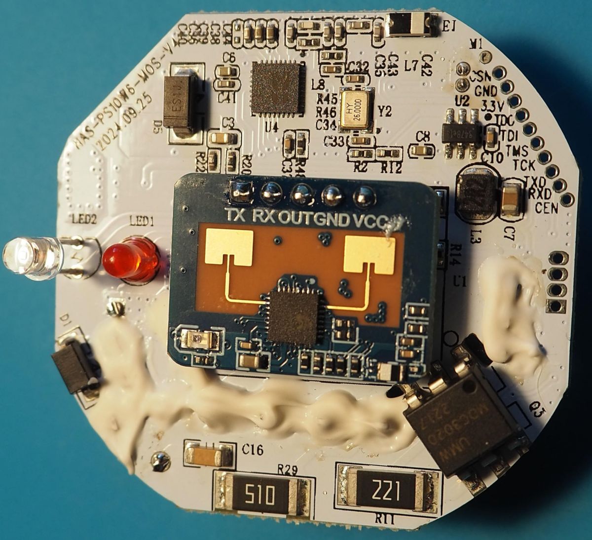

    The bk7231n is on board, so no module transplant possible.. But the triac BTB24-800BWRG keeps me hoping for light dimming possibility :)
    https://www.st.com/resource/en/datasheet/bta24.pdf
    The two other identifiable chips on board are:
    UMW MOC3020, an Random-Phase Triac Driver Output Optocoupler
    https://www.micros.com.pl/mediaserver/ORMOC3023_UMW_0001.pdf
    KP3210BSGA, an High Performance Low Cost Off-line PWM Power Switch
    https://www.lcsc.com/datasheet/lcsc_datasheet...91005_Kiwi-Instruments-KP3210BSGA_C554027.pdf
    Photos of the PCB board:
    Printed circuit board with electronic components, including LEDs and integrated circuits.
    Electronic module with green connector and various components.
    I didn't do any pairing, just powered it on and the wifi name was "SmartLife-D32C".
    After soldering TX0, RX0, GND and 33V I was able to dump the flash (attached below).

  • Identified the PCB as a Hi-Link HLK-LD2410C module

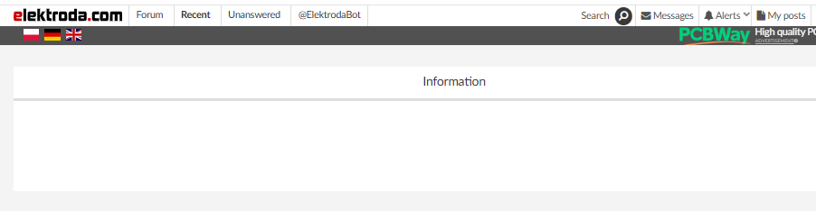

    I could find out more but the download just takes me to this
    Screenshot of the elektroda.com website with a navigation bar and information section.
    I do recognise that blue PCB though from Ali https://www.aliexpress.com/item/1005007765988010.html
    Hi-Link HLK-LD2410C https://www.hlktech.net/index.php?id=1095

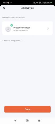

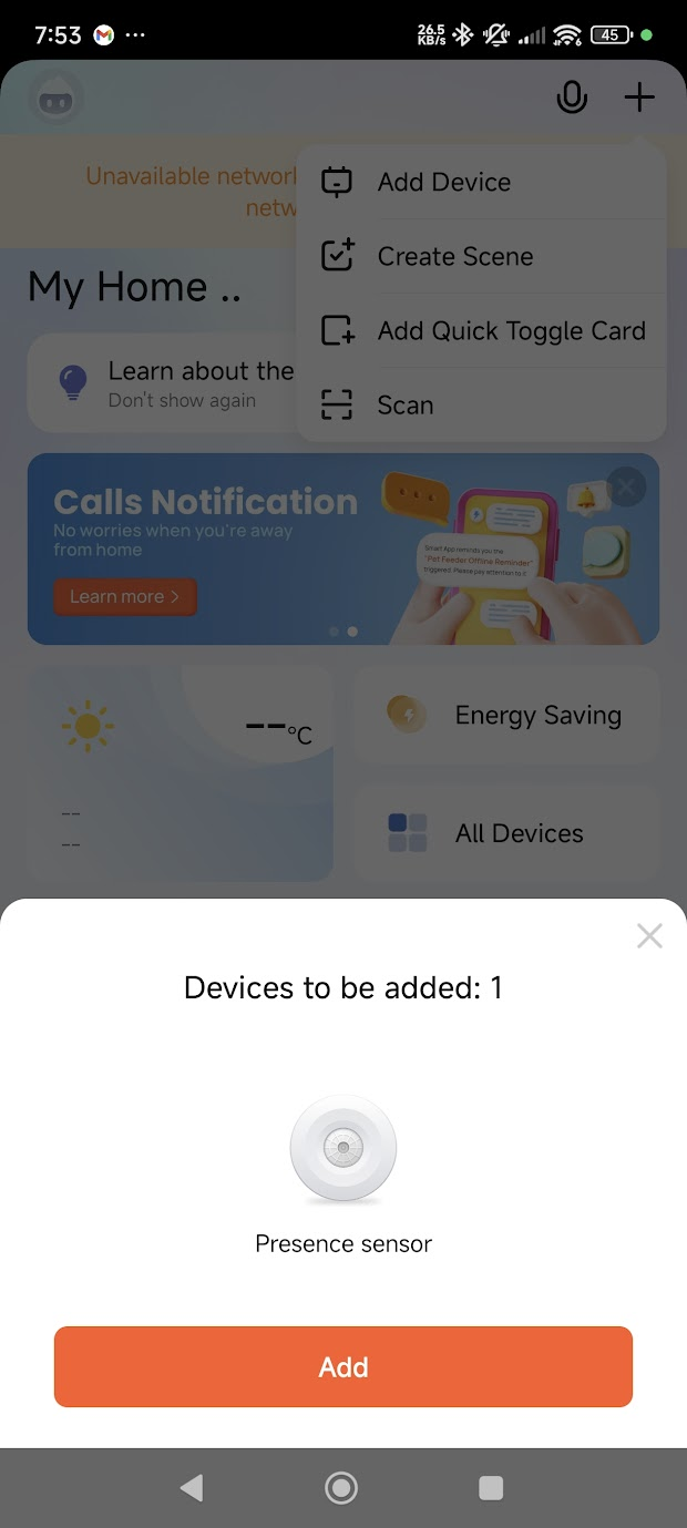

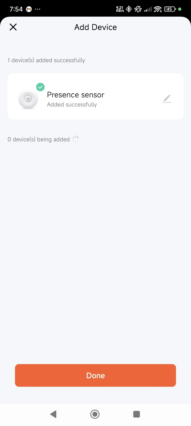

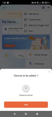

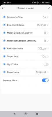

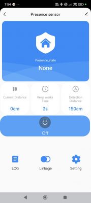

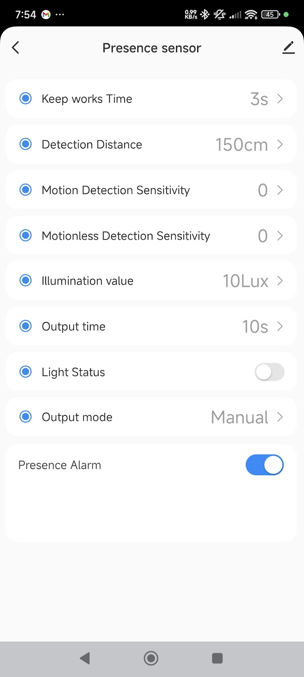

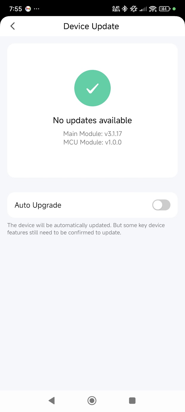

    boot log through to paired status with Tuya. MCU simulator used
    Tuya app experience:
    Screenshot of a smart home management app with a message about adding a device. App screen showing added presence sensor. Presence sensor app screen. Presence sensor settings screen with various options and values. Device update screen showing no updates available.
    Added after 8 [minutes]:
    dev site:
    which tidies to:

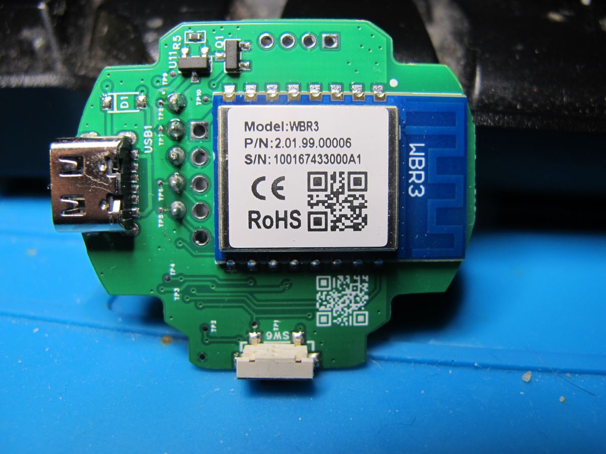

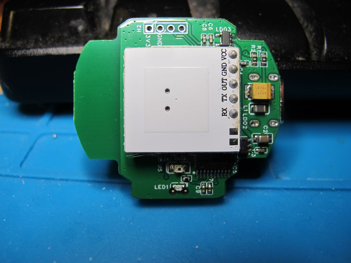

    In the meantime, I've had this arrive. A little different.
    Close-up of an electronic module with a label showing model WBR3 and a QR code. GigaDevice microchip on a green circuit board with markings GD32E230F8P6TR ARM. Electronic module with visible components on a printed circuit board.
    :D To be frank, there is already another presence sensor on my desk also.. And it seems to be using the same radar module as you have, on mine is "ZY-M100", but equal otherwise, even the pinout is the same.. It seems to be a common tuya component:
    https://smarthomescene.com/reviews/tuya-zigbee-human-presence-sensor-zy-m100-review/
    Are you going to reflash it?

What’s inside the Tuya WiFi 24G mmWave presence sensor (PS10)?
It uses a BK7231N SoC on a NAS‑PS10W6‑MOS‑V PCB. Power/control includes KP3210BSGA PSU, MOC3020 optotriac driver, and BTB24‑800BWRG triac. The package is Ø 60 mm × 28.5 mm. It boots broadcasting SmartLife‑D32C without pairing. The board exposes UART pads used for flashing and logs. [Elektroda, peter_v, post #21457747]

What datapoints (dpIDs) does it expose and what do they do?
Schema shows 12 dpIDs: presence_state (1), work_mode (101), human_motion_state (102), presence_time 3–10 s (103), motion_far_detection 150–600 cm in 75 cm steps (104), motion and micro‑motion sensitivities 0–7 (105–106), current distance cm (107), lux thresholds enum (108), output_time 10–1800 s in 10 s steps (109), switch_1 (110), and status LED (111). [Elektroda, divadiow, post #21458036]

Can the onboard triac be used for dimming?
Not via the exposed TuyaMCU schema. The device exposes an on/off switch dpID, but no level control dpID for dimming. As noted, "you’ll be at the mercy of the TuyaMCU for everything." That means dimming is unavailable without changing the MCU firmware. [Elektroda, divadiow, post #21470593]
Do I get actual lux values, or only thresholds?
Only thresholds. The schema’s lux_value dpID is an enum with 10Lux, 20Lux, 50Lux, and 24H options. It does not report a numeric lux measurement. Use the enum to gate switching behavior rather than read light levels. [Elektroda, divadiow, post #21458036]
