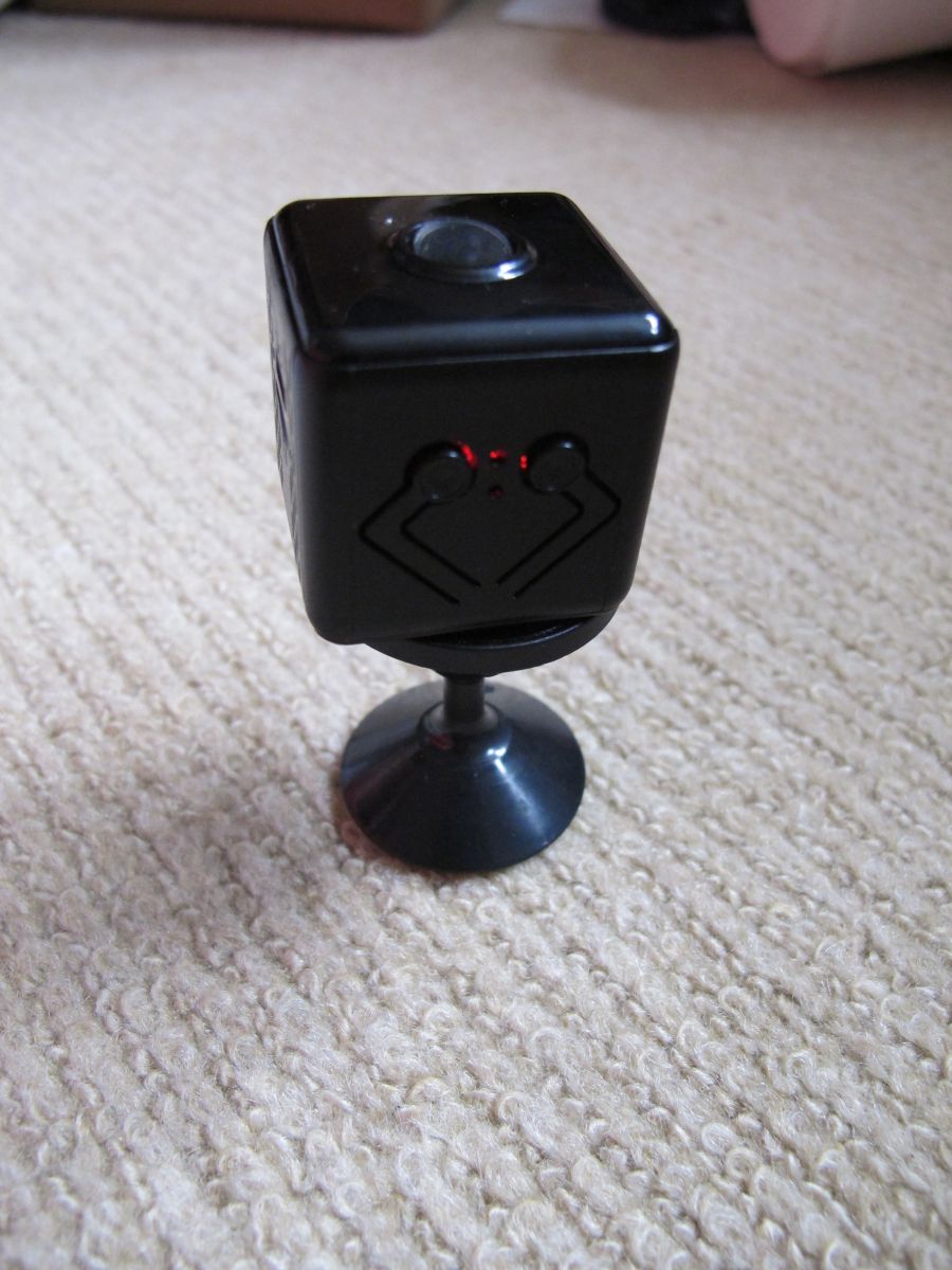

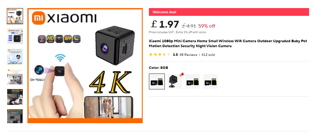

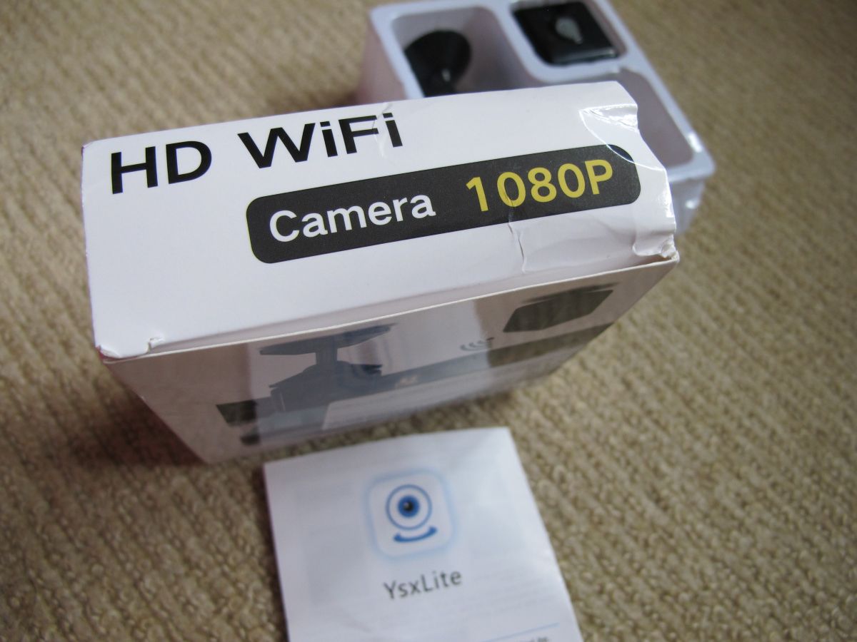

    Here's some info about a "Xiaomi" X6 "1080P" ("4K" on Ali page) mini spy camera. Very familiar YsxLite manual/app setup - same as many A9 type cams.
    It was bought from Ali Express at https://www.aliexpress.com/item/1005008608595789.html
    Image of a Xiaomi X6 mini camera offer on AliExpress, with large 4K text and a small black cube camera next to a smartphone, on a white background.

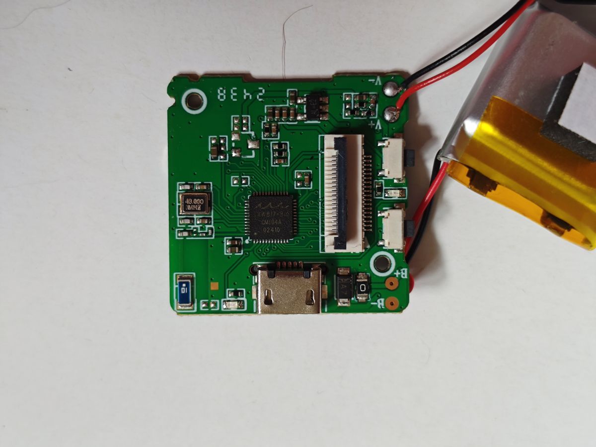

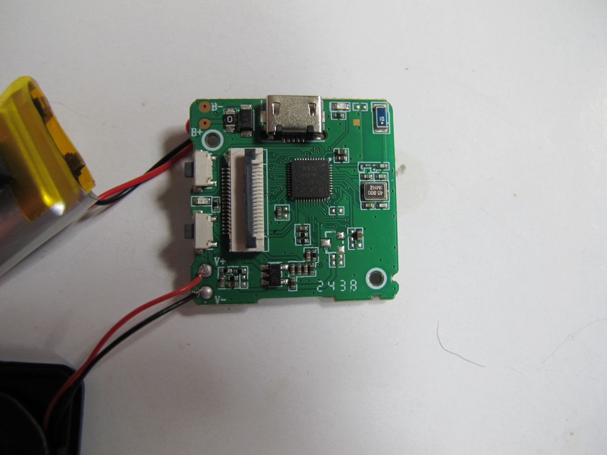

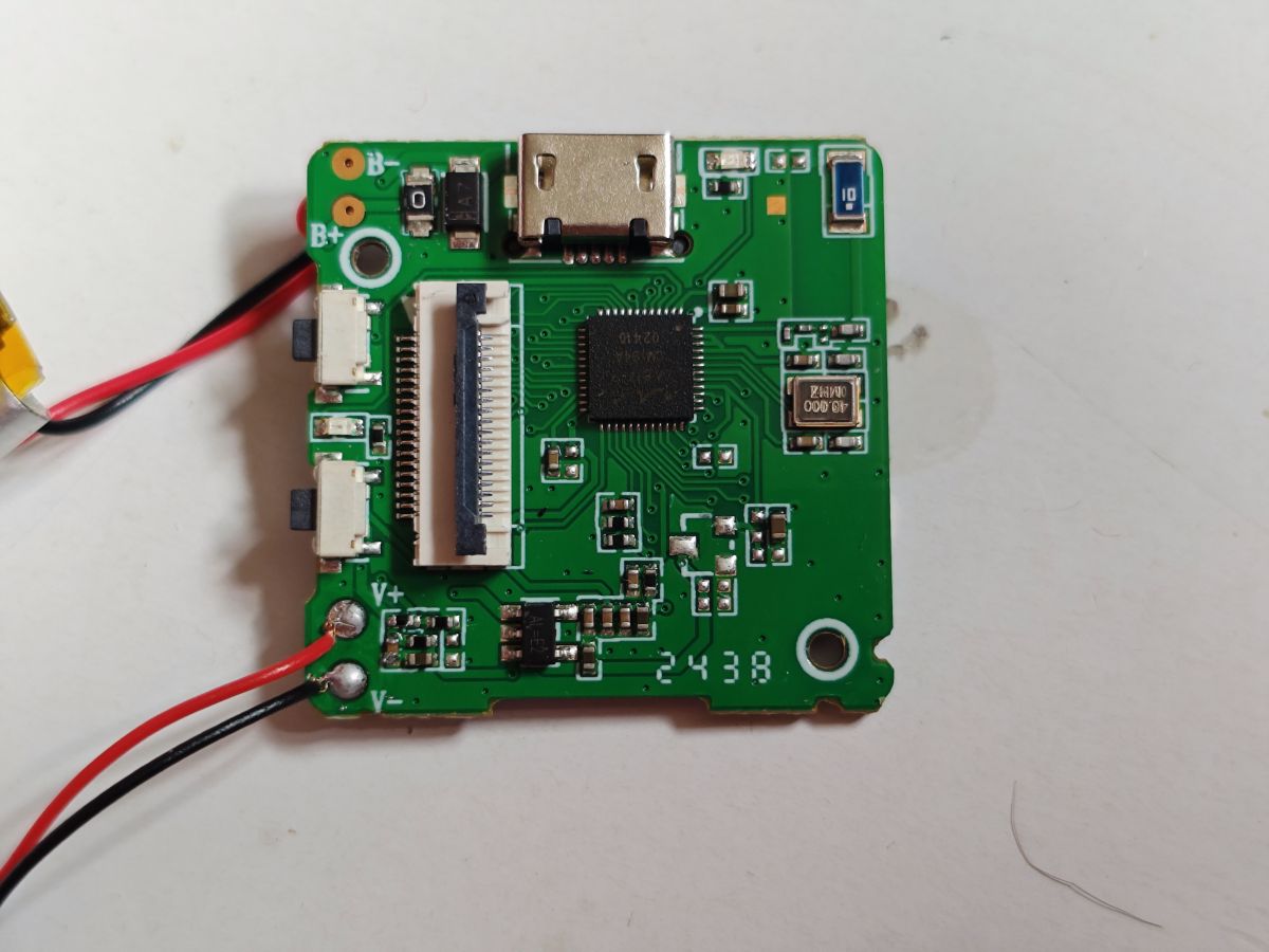

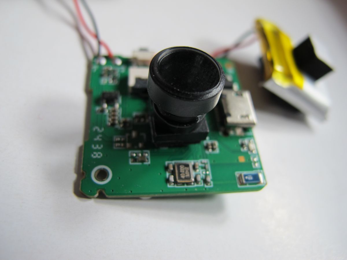

    Like several of my A9s, this comes with the Taixin Semi (HugeIC) TXW817-810 MCU at its heart. The TXW817 line consists of these two variations

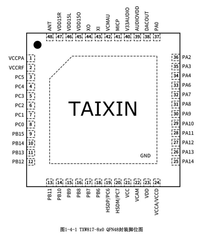

    Pinout diagram for the Taixin TXW817-8x0 QFN48 chip with labeled pins.
    Like the WinnerMicro W80x, these are based on the C-SKY architecture. CK803 in the case of the TXW817s

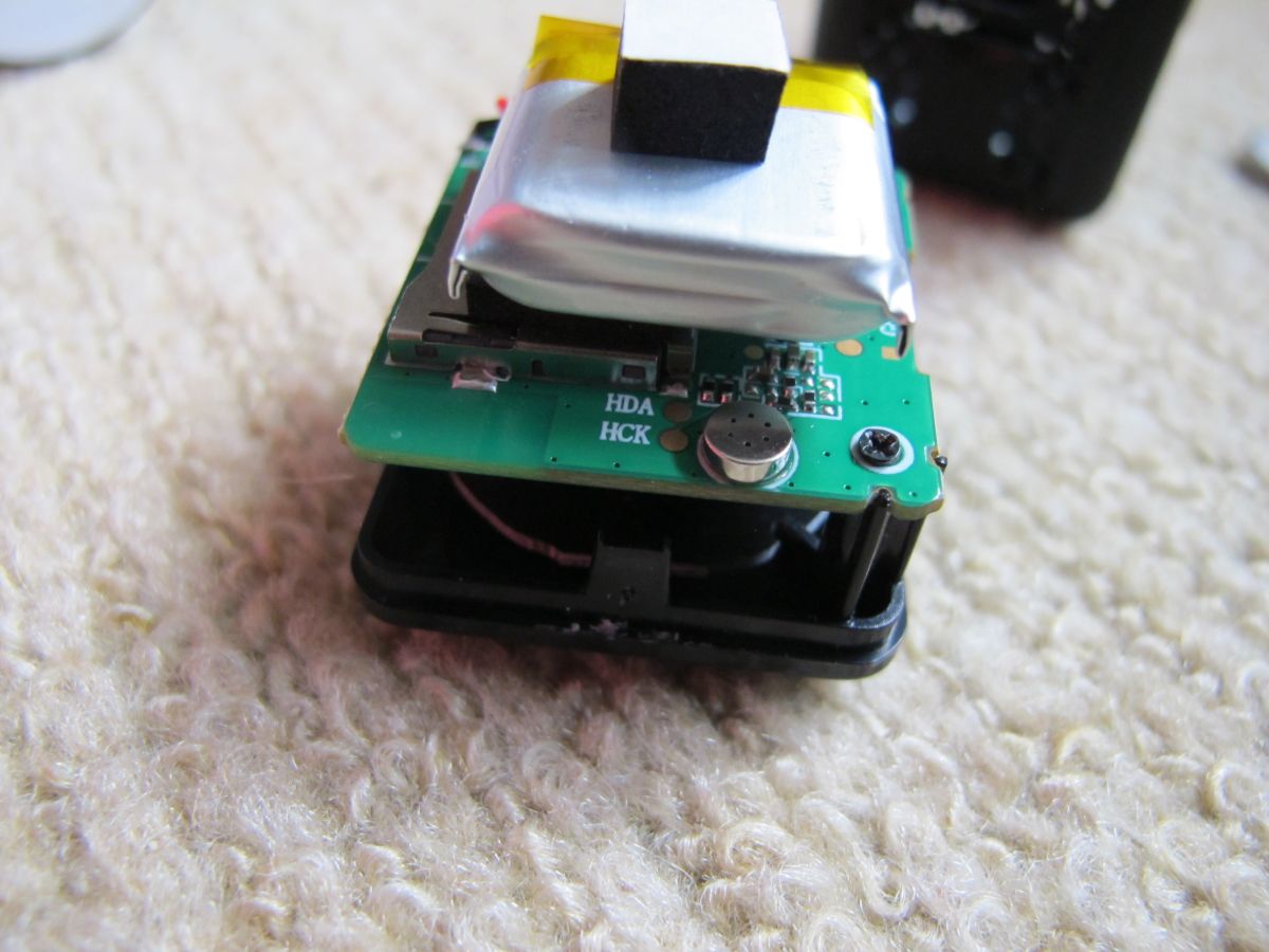

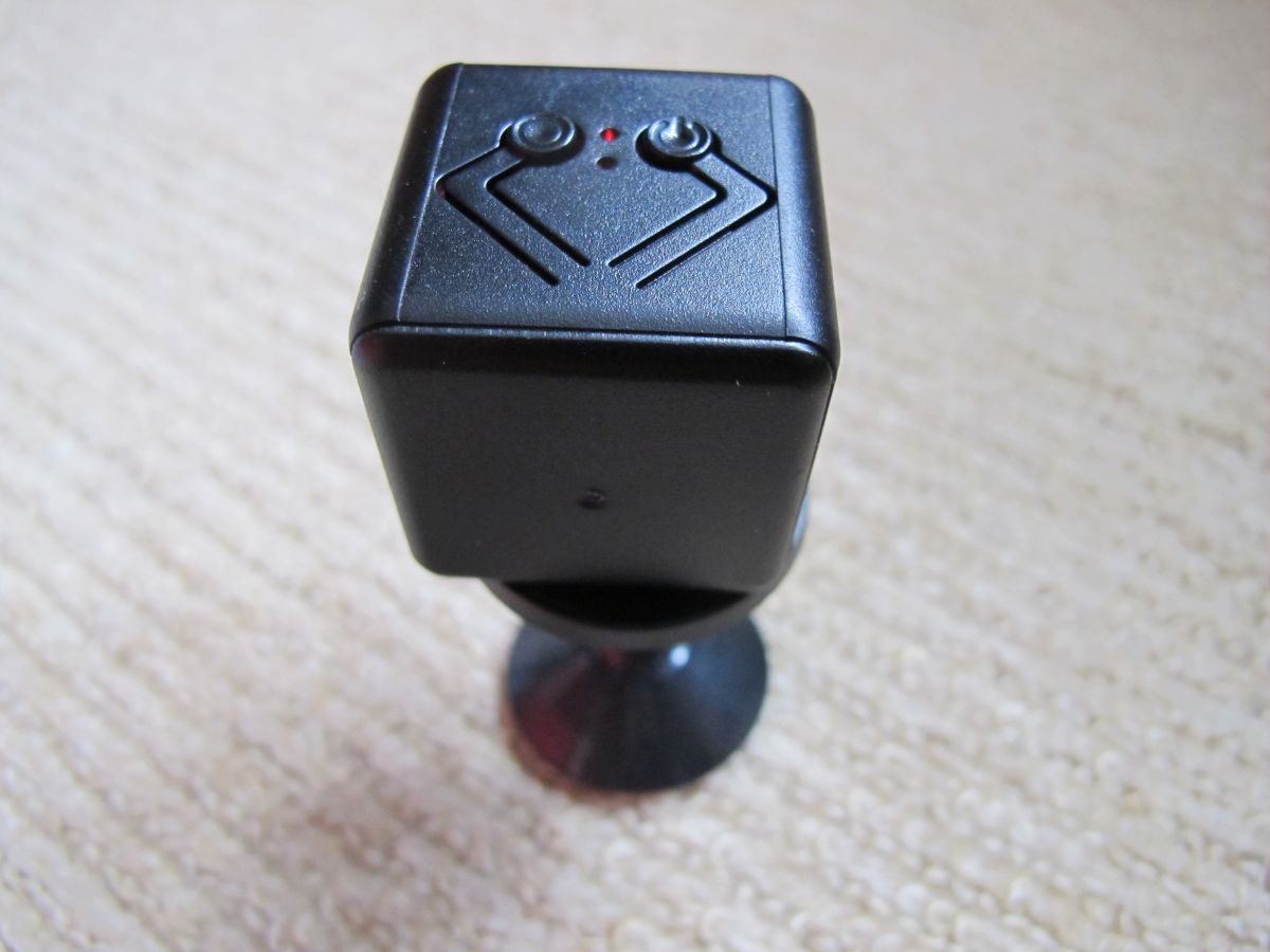

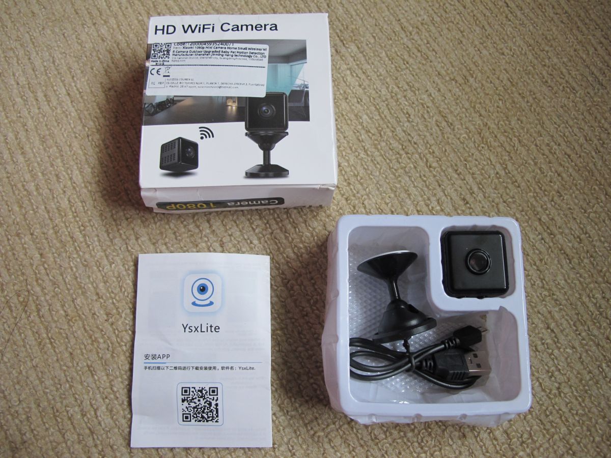

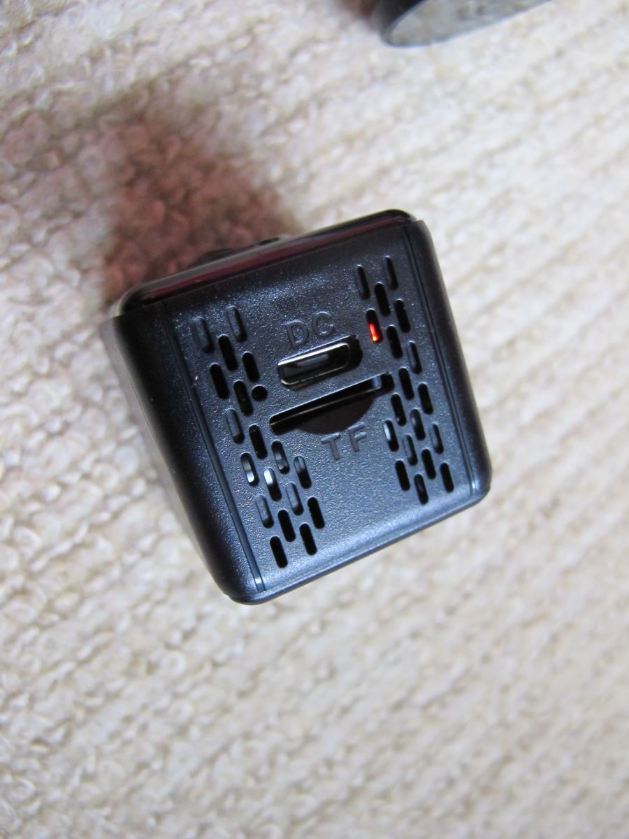

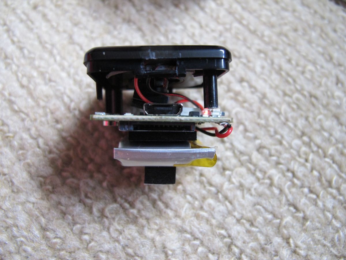

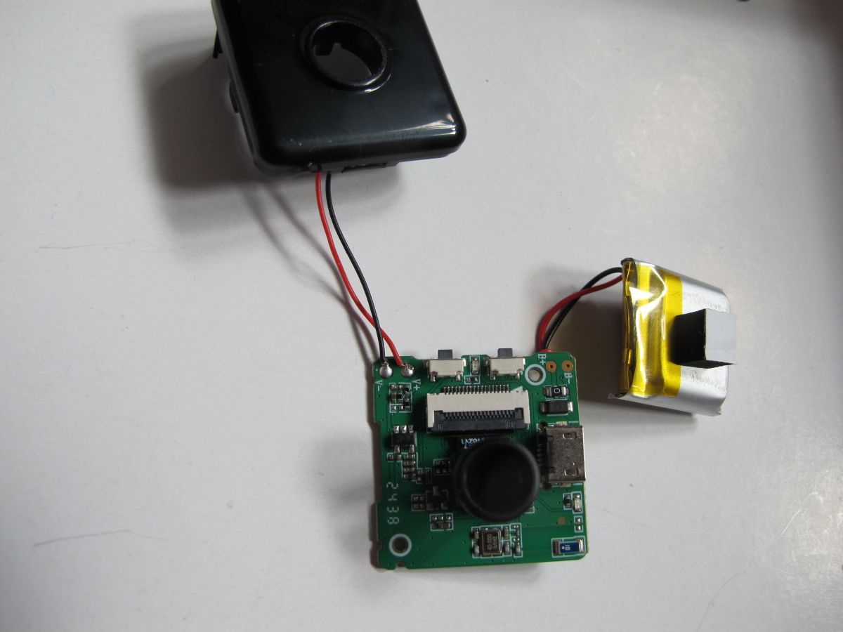

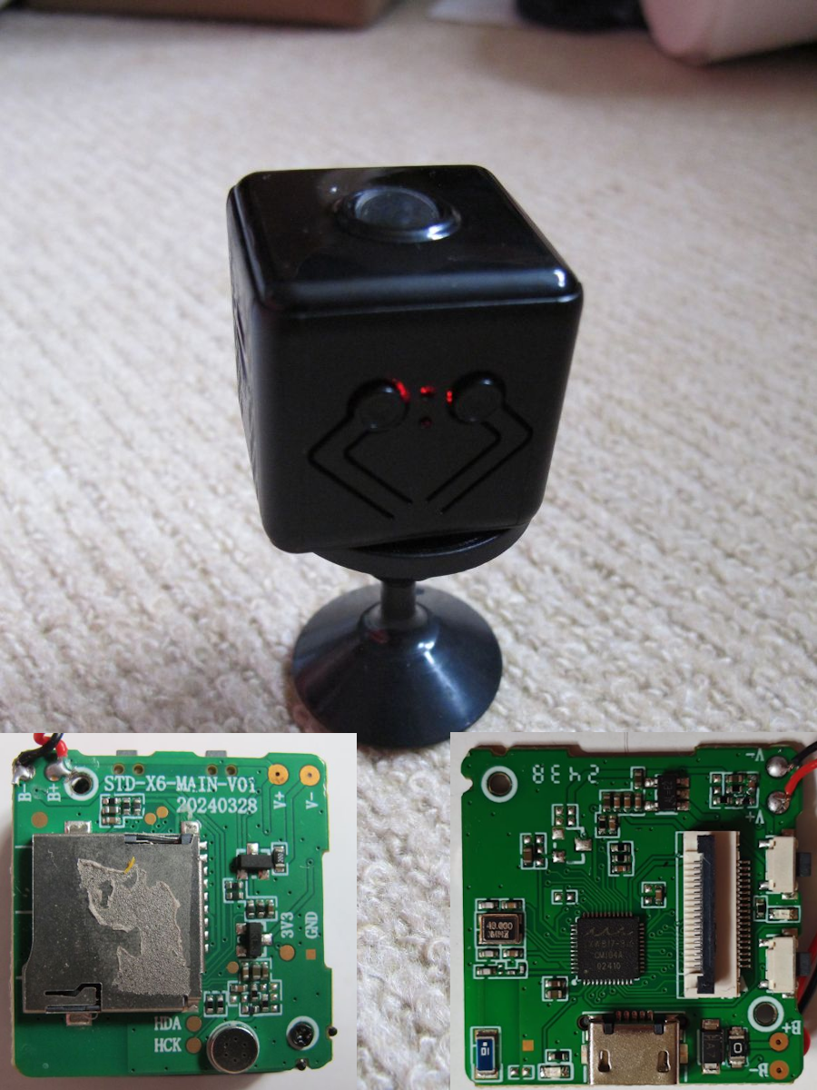

    Pics of packaging and device inside and out.
    HD WiFi mini camera set including packaging, user manual, the camera, mount, and USB cable on a light carpet. Packaging of a mini spy camera showing four example uses: house, shop, child, and sports. Packaging of a mini spy camera labeled HD WiFi Camera with a product and manufacturer information sticker. Photo of a mini spy camera HD WiFi 1080P package and YsxLite manual on a carpet.
    Small black cube-shaped spy camera on a round magnetic stand, placed on a light-colored carpet. Close-up of the bottom of a mini spy camera with a micro USB port labeled DC, a TF microSD slot, and a red LED indicator. Mini spy camera in a black cube shape with two buttons and an LED on top, mounted on a stand. Disassembled mini spy camera with visible electronics and casing on a light brown carpet. A disassembled mini sports camera without a case on a light beige carpet. Disassembled electronic device with a visible battery and circuit board on a carpet. Printed circuit board with microSD card slot, microphone, and lithium polymer battery. A printed circuit board with electronics, a battery, and a black plastic casing on a white background. Camera module on a green PCB with visible electronic components. PCB board with connected wires and visible micro USB port. Disassembled components of a small camera: PCB, lithium-polymer battery, and lens. Printed circuit board with electronic components and connected wires. Printed circuit board with electronic components and a connected lithium-polymer battery. A printed circuit board with a microSD card slot and a connected battery. A printed circuit board with electronic components, a memory card slot, and connected wires. Digital camera module on a white background.

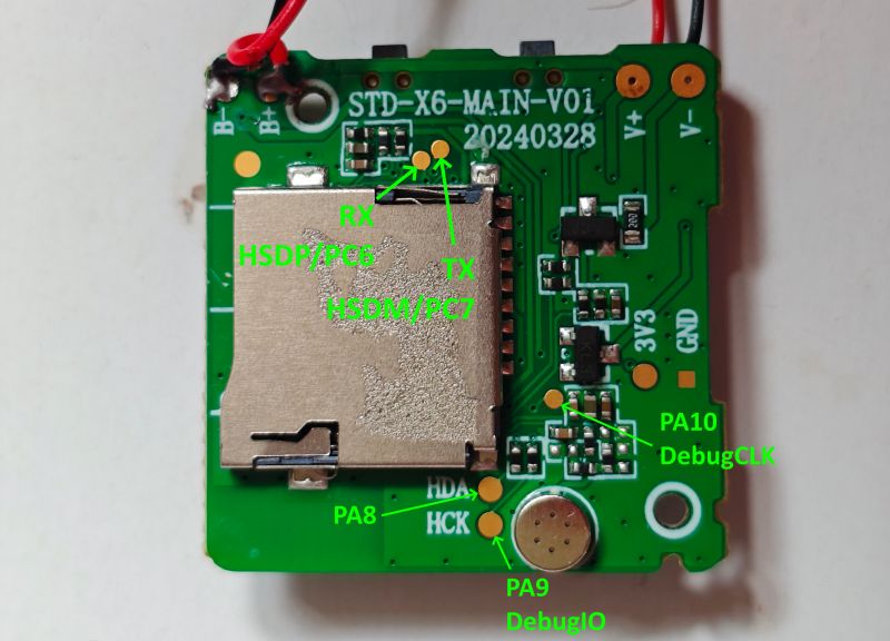

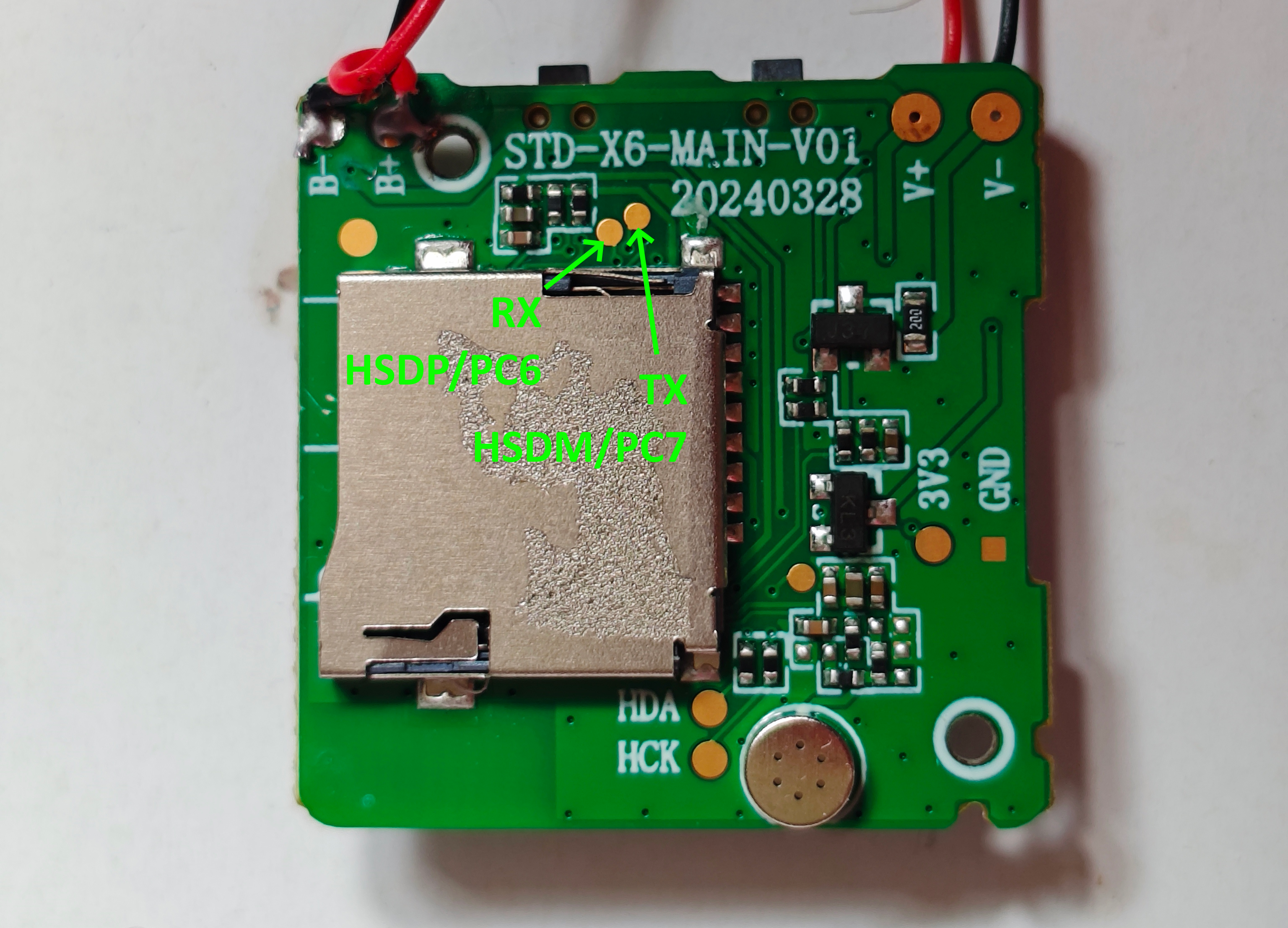

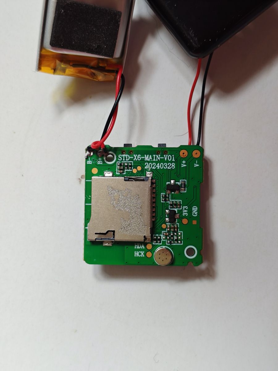

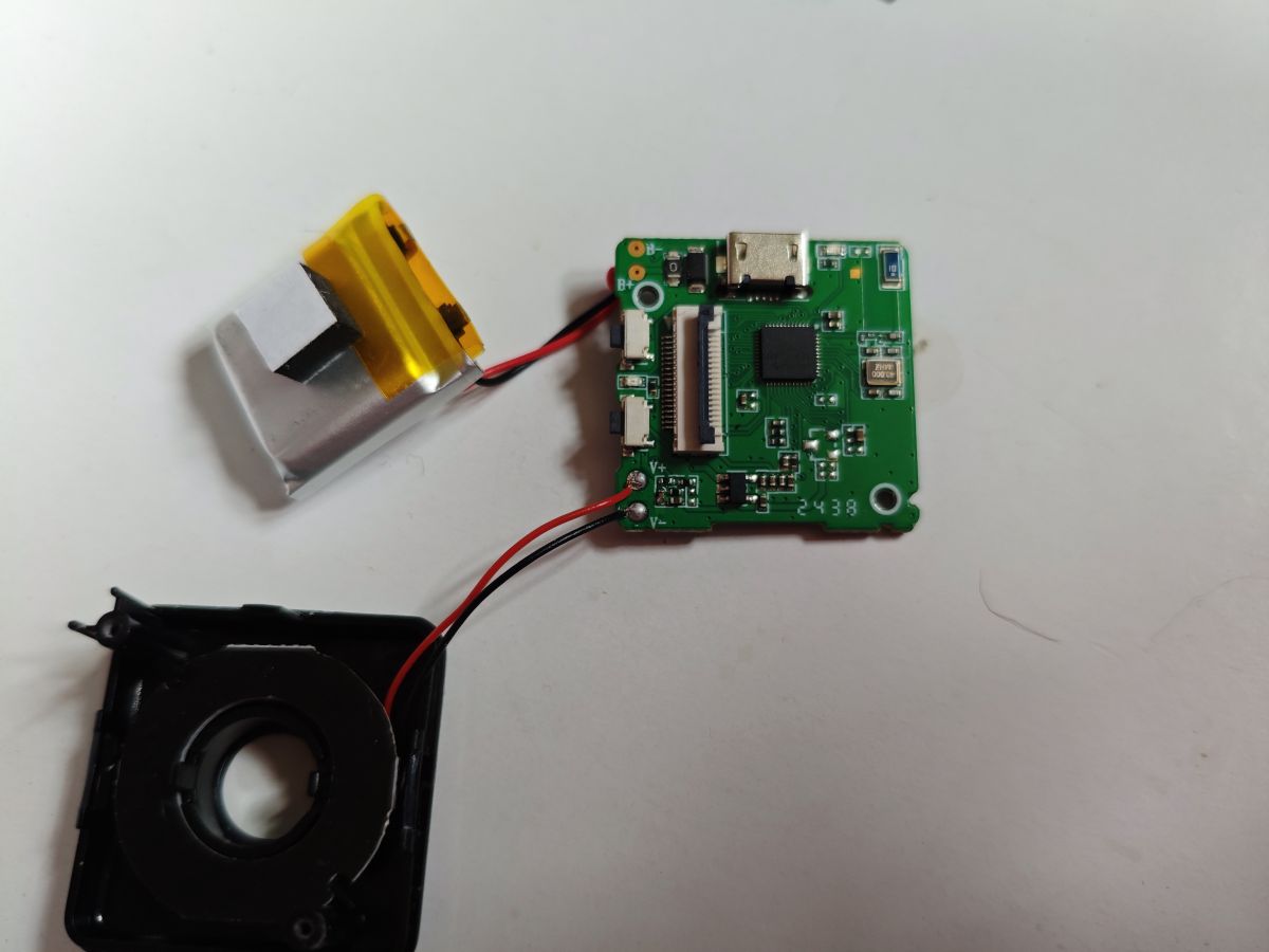

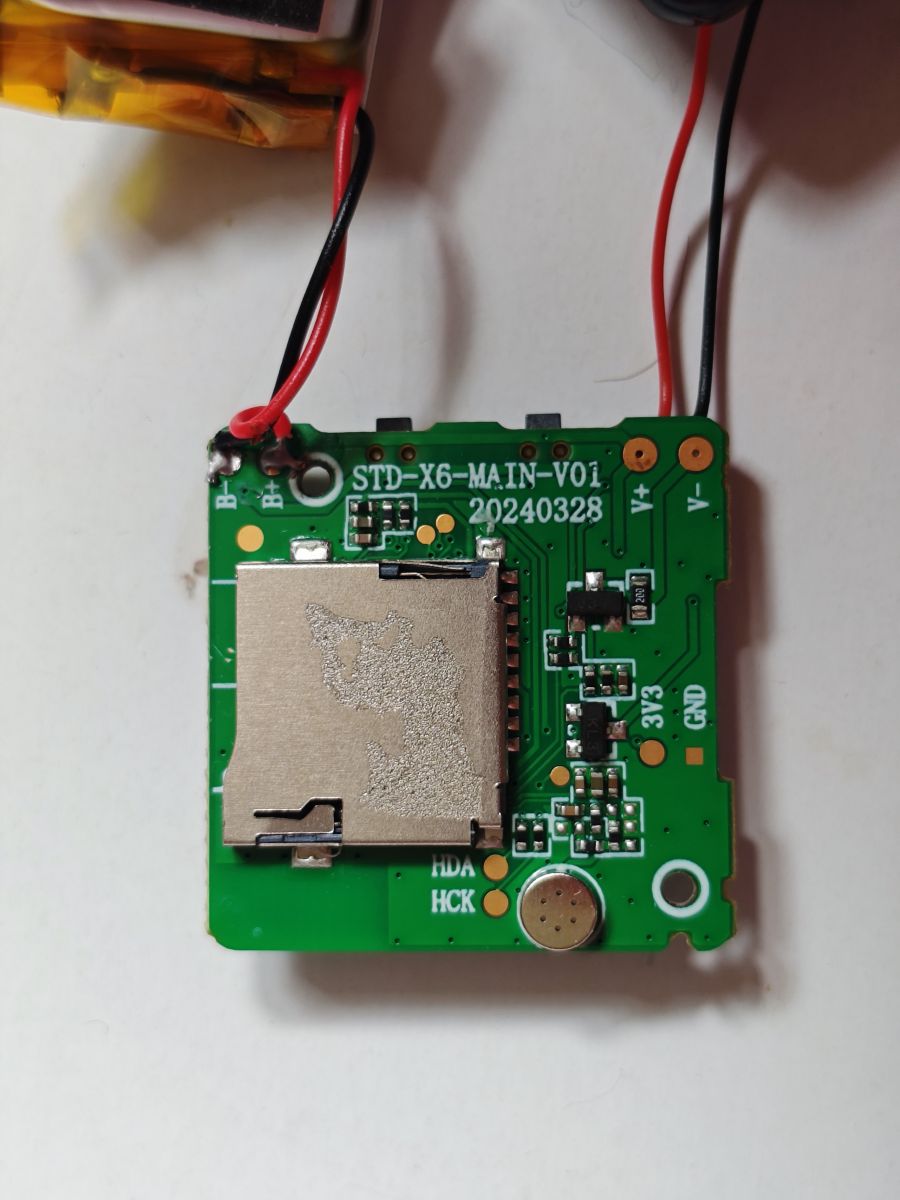

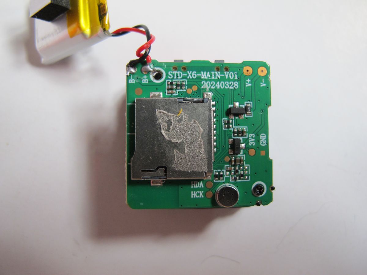

    silkscreen marking:
    STD-X6-MAIN-V01
    20240328

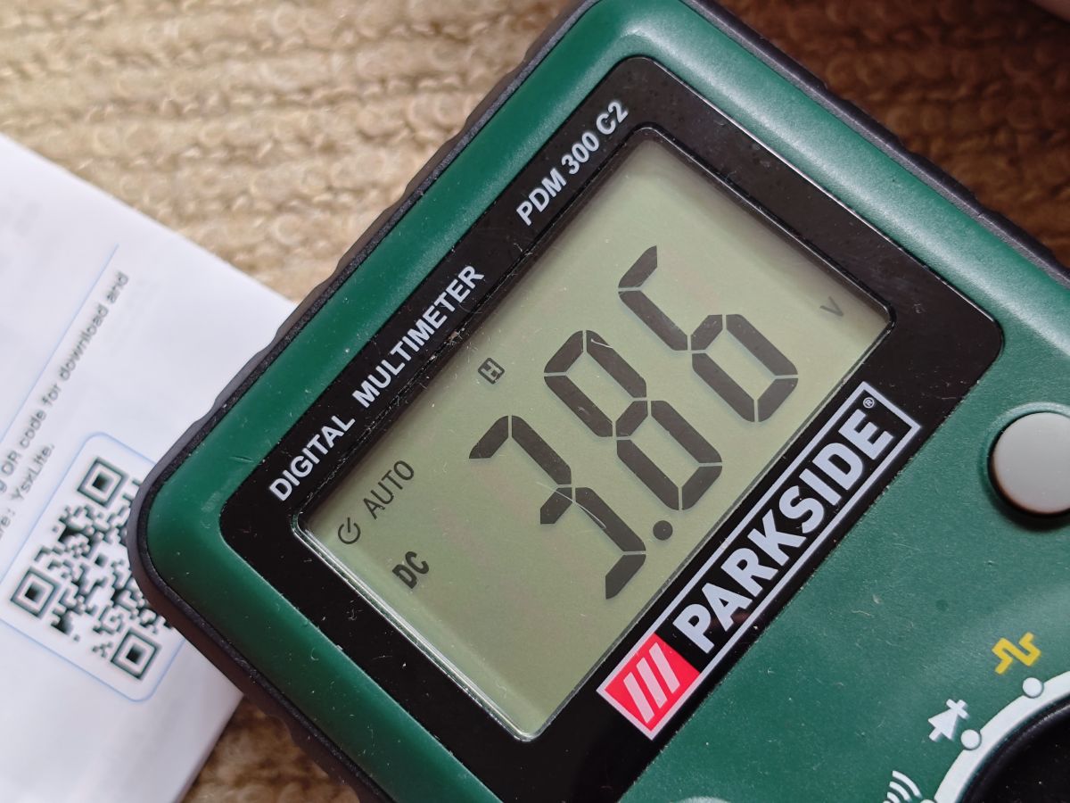

    No markings on the battery but it's measuring at 3.86v
    A digital multimeter by Parkside showing a 3.86 V voltage reading on the display.
    These two unlabelled pads are RX/TX so from TX at 921600 baud the boot log can be captured
    PCB with a microSD card slot and labeled UART RX/TX connection points.
    we can see the real resolution of the camera in the initialisation in log - VGA

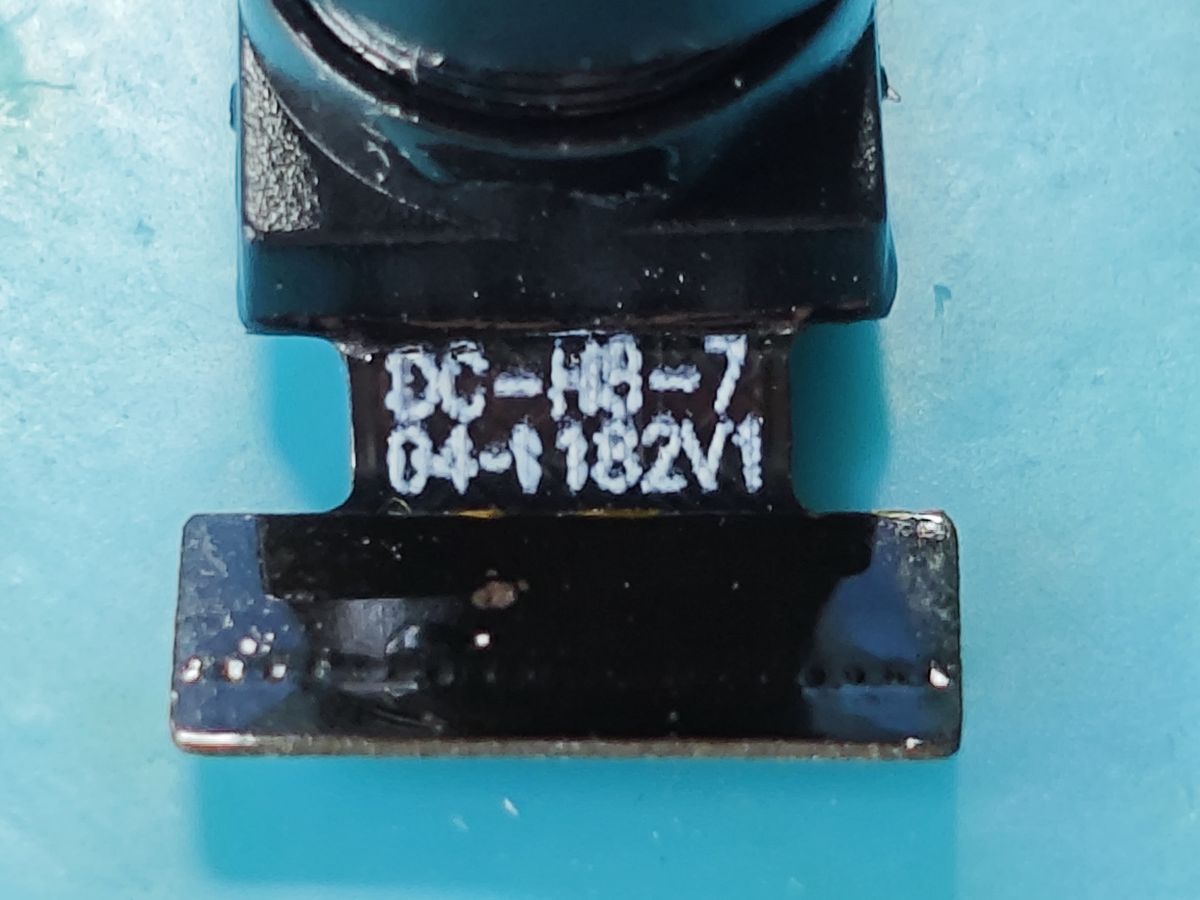

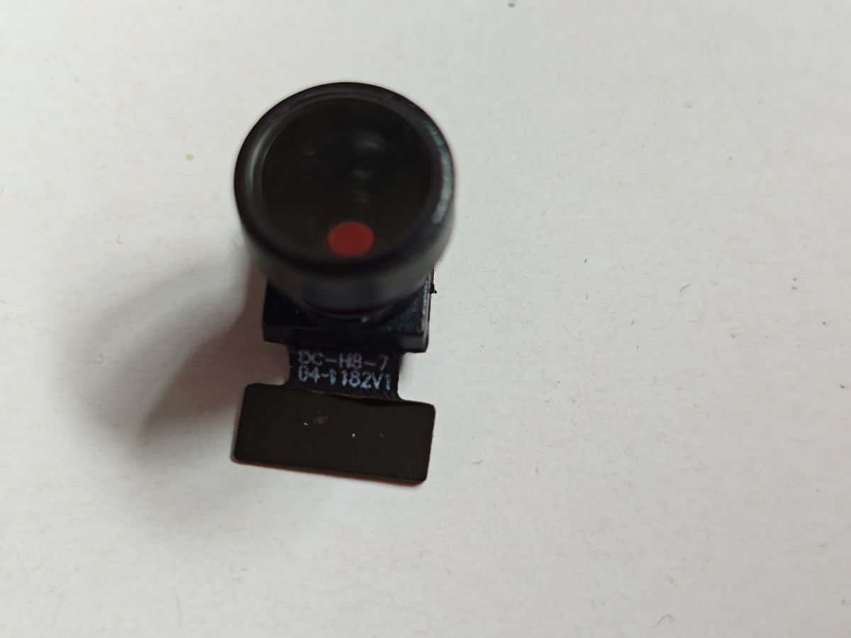

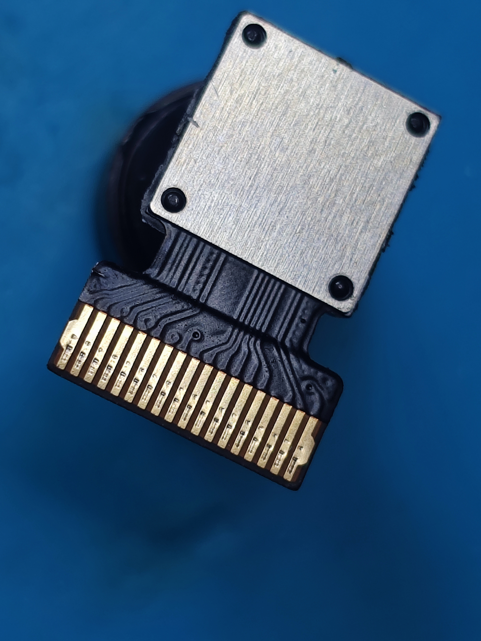

    The camera ribbon has printed on it DC-H8-7 04-6182V1 (I think) - not sure who this cam is by yet.
    Electronic camera module labeled DC-HB-7 on a blue background.

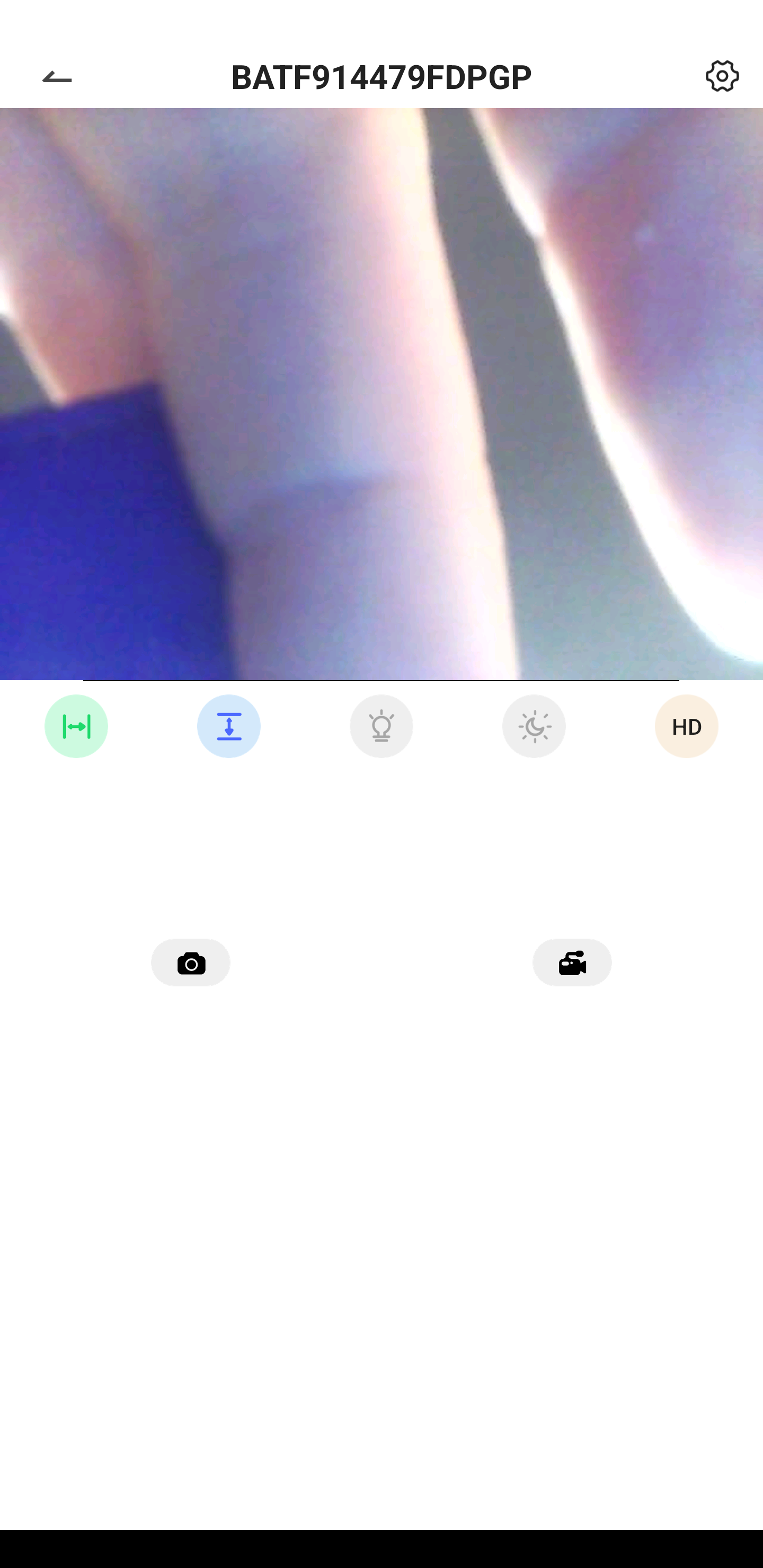

    I plugged this cam into an XF16 to see which driver initialised re https://www.elektroda.com/rtvforum/topic4074636-180.html#21547719
    maybe the "8" is a "0" H0704 = HI0704
    and it works in XF16
    Close-up of fingers holding a blue object in front of the camera lens with an app interface in the background.
  • #4 21548811
    Posts: 14754
    Rate: 12875
    So the camera from this device is compatible with XF16 cameras? That's a good to know information. Now we need to know the pinout of the camera
  • #5 21548825
    Posts: 5208
    Help: 446
    Rate: 914
    seems to be, and I'm guessing/hoping all the other cam modules I have are too - the connector *looks* the same across them all - the ribbon and print is different so I'm expecting a variety of cam models to be detected. I'll label and photo them all in the process when I get to it.
    We do need to know pin-out. 18 pins
    Close-up of a 18-pin electronic connector with gold-plated pins and a metal housing.

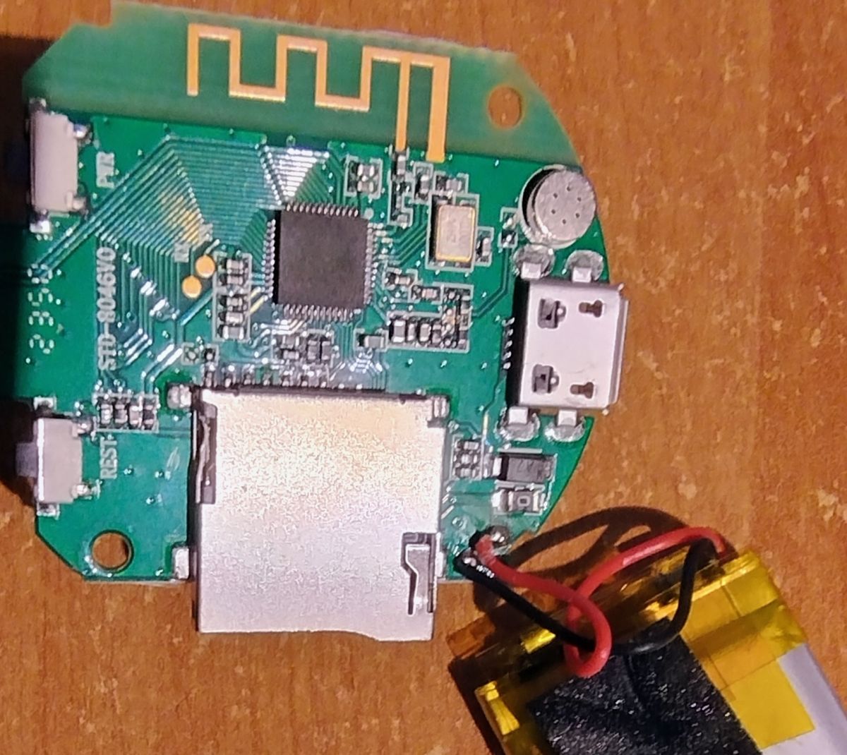

    I have a TXW817-810 on the same chip
    Electronic module with TXW817-810 chip, microSD card slot, micro USB port, and battery. .
    Is it possible to drop alternative FW into it?
    I will probably have access to about a hundred of these camcorders

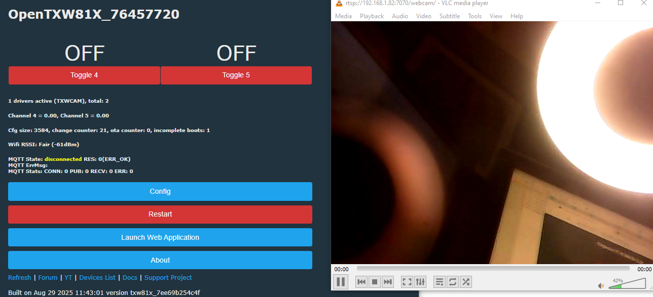

    development thread: https://www.elektroda.com/rtvforum/topic4033757.html
    development for OpenTXW81X heats up from: https://www.elektroda.com/rtvforum/topic4033757.html#21638429
    OpenTXW81X system user interface showing diagnostic information and a video stream from a webcam in VLC media player.

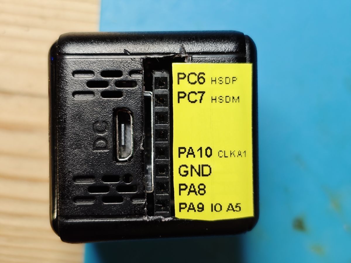

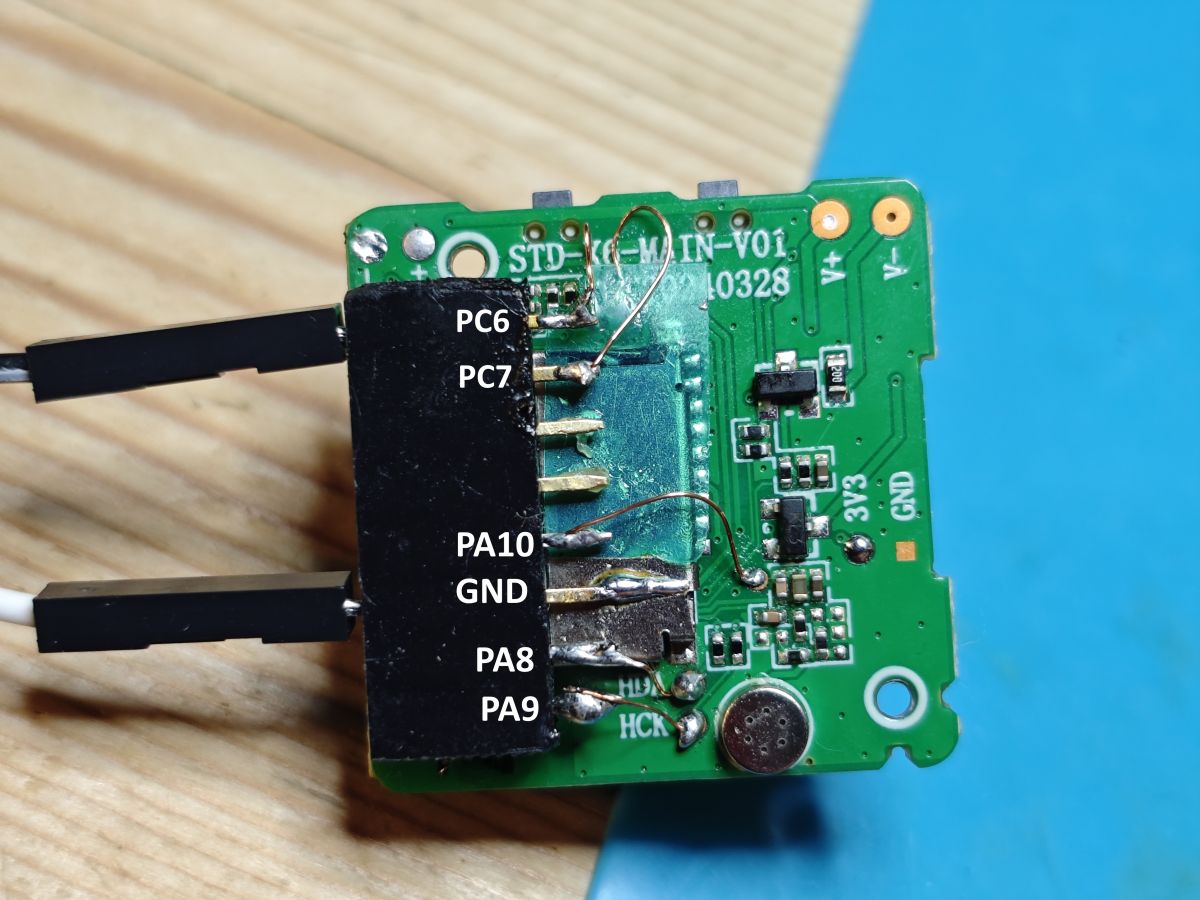

    Additional info regarding this X6 that is the subject of this thread:
    Close-up of a PCB with a microcontroller, connectors, and labeled pins PC04, PC05, and PA11.
    adding more useful image for device list

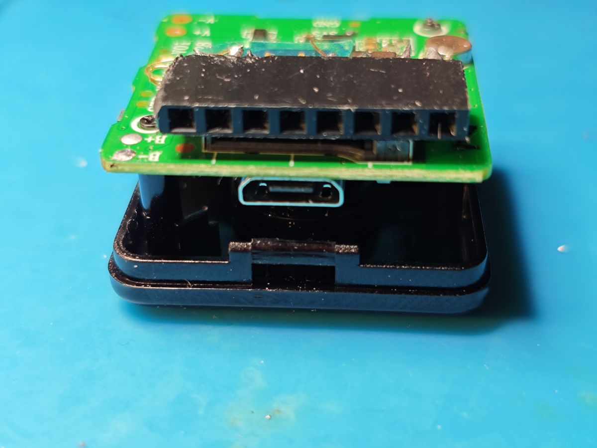

    I present the TXWDevCube
    TXWDevCube circuit board with visible connectors and labeled signal pinsPCB with USB-C port and black pin header on blue surfaceTXWDevCube module wired to a development board on a blue matClose-up of TXWDevCube connectors and labeled pin functions
  • #12 21742117

    It's been fluxed more since pic and the enameled wires are a bit more secure ;)
    It was very fiddly!

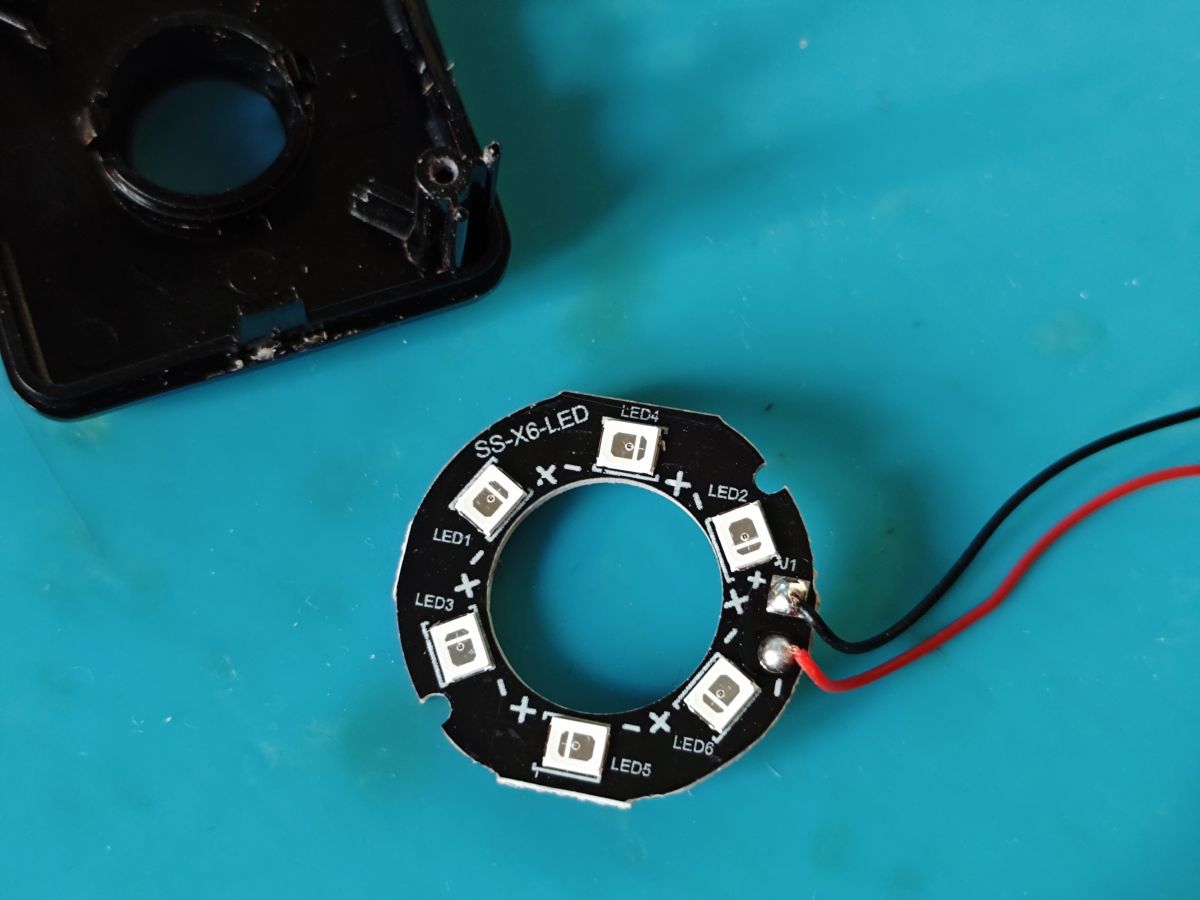

Does the X6 include IR LEDs or a light ring?
Yes, the lens is surrounded by an LED ring, as highlighted by the author. If repurposing the module, budget current for the ring and test thermal behavior in enclosures. [Elektroda, divadiow, post #21546395]
