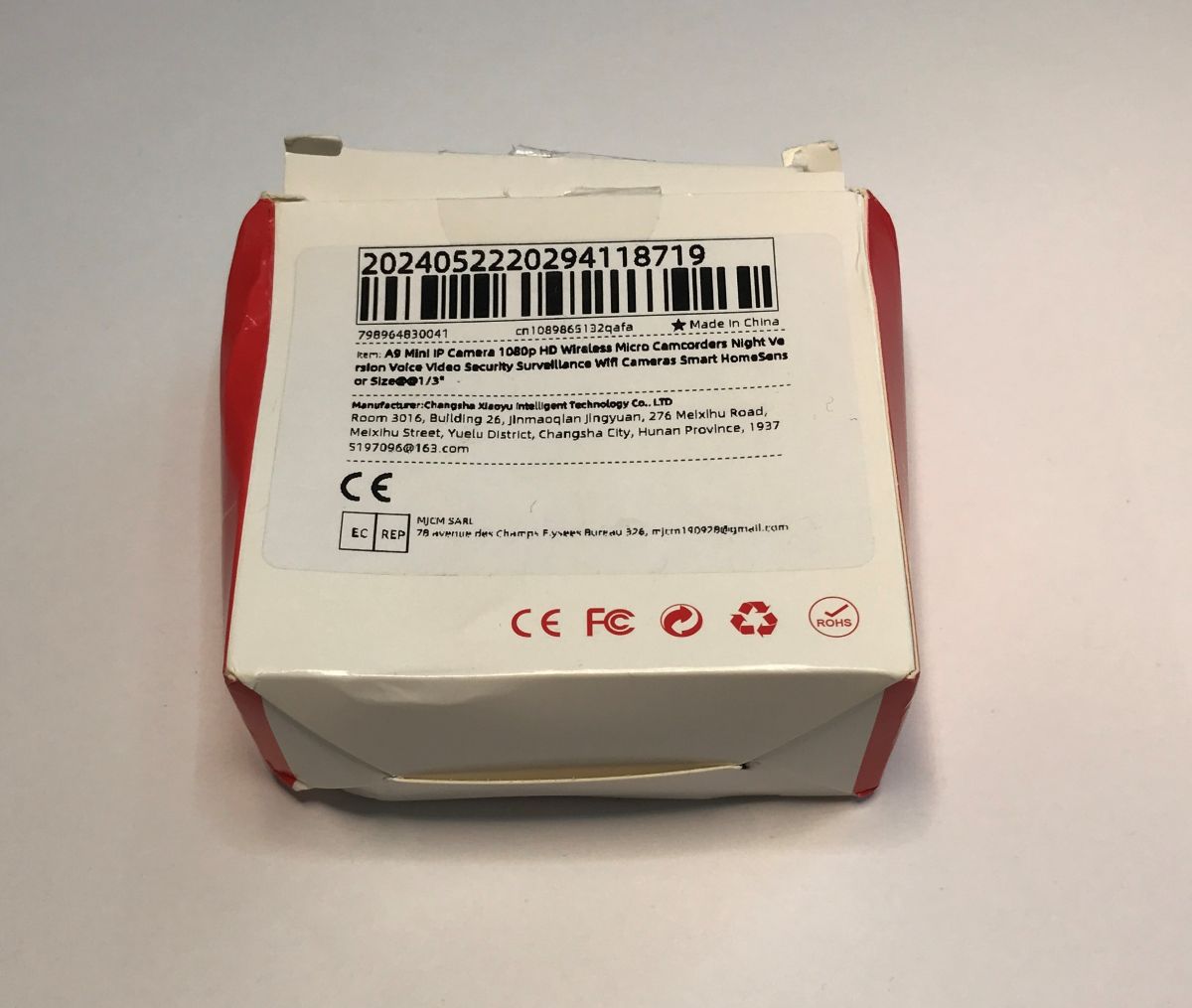

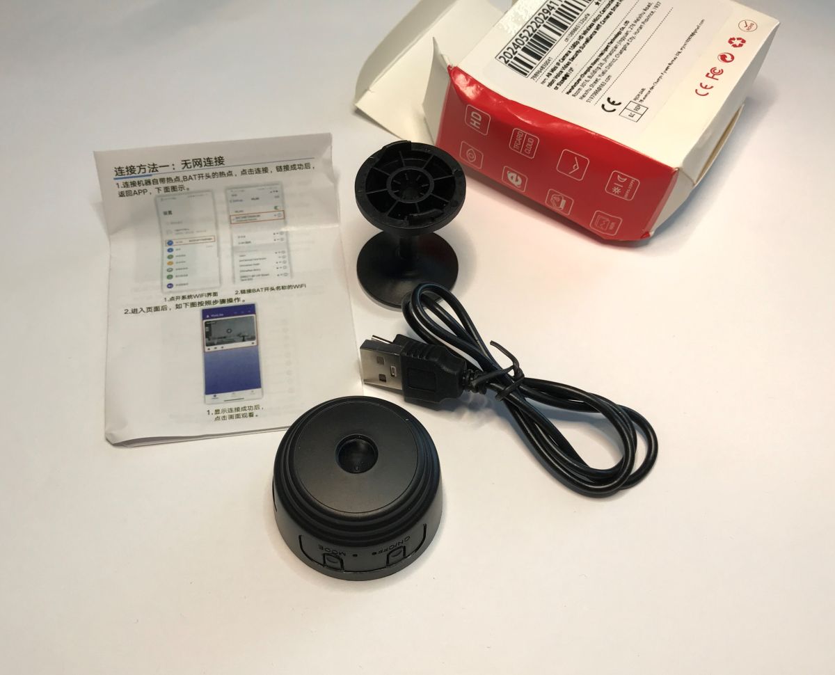

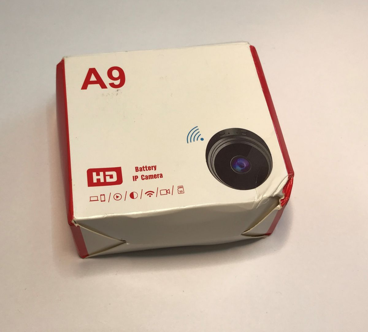

    First, you need a camera. I bought one here:
    Miniature wireless spy camera with a display showing its use in a living room.
    The box arrived slightly dent, but camera is still in one piece:
    Back side of A9 Mini IP camera packaging with barcode and product information. A box of A9 model HD IP camera with a camera illustration and function icons. Mini Wi-Fi camera set with accessories: USB cable, mounting bracket, Chinese manual, and box.
    By the way, my camera is using XF16 chip, you can see details here: https://www.elektroda.com/rtvforum/topic4074636.html
    Still, we don't need to open the case now. Just power it via USB.

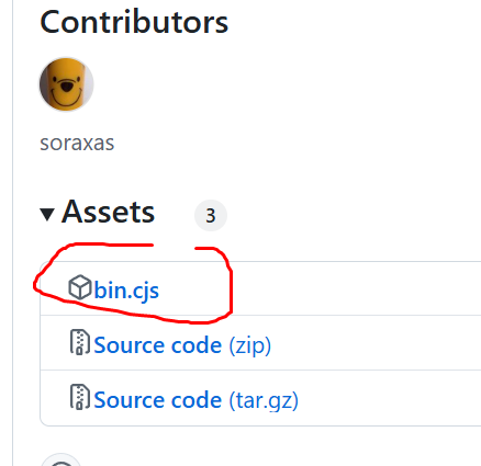

    Then, you need to run cam-reverse with NodeJS. You can build it from source, but I'd recommend to get precompiled CJS file:
    A section of a webpage showing downloadable assets, with the bin.cjs file highlighted.
    Of course, also install NodeJS if you don't have it yet.

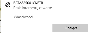

    For the start, we will just put camera in AP mode and connect to its WiFi:
    Wi-Fi network window showing no Internet connection and network name BATA825001CKETR.

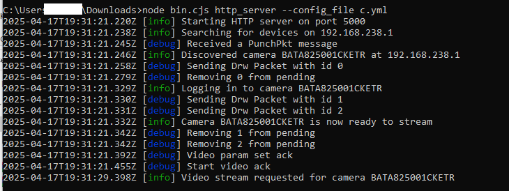

    Run the app with config specified:
    node bin.cjs http_server --config_file <your_config.yml>
    This should detect the cam:
    HTTP server and IP camera connection logs displayed in a Windows console.

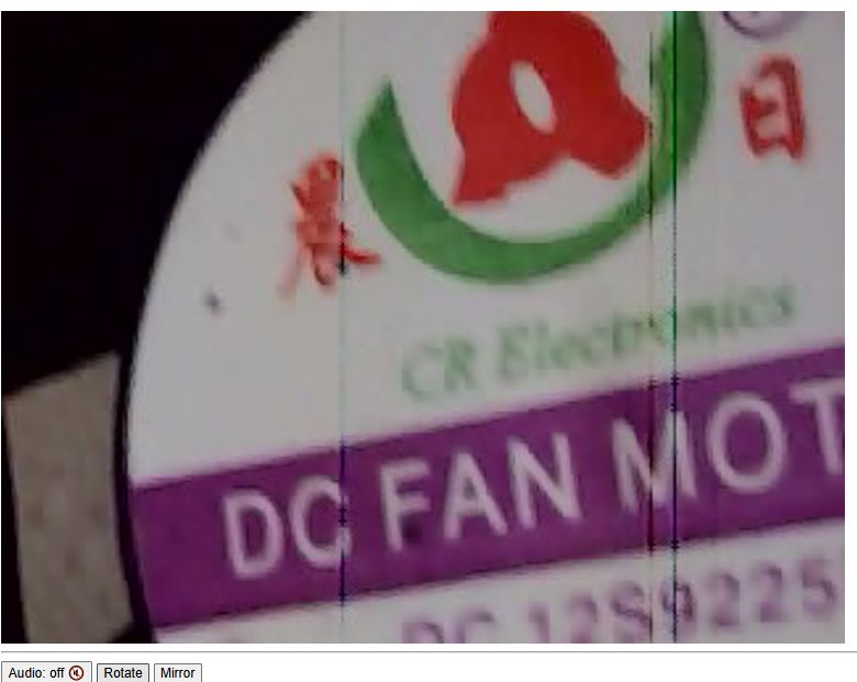

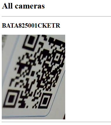

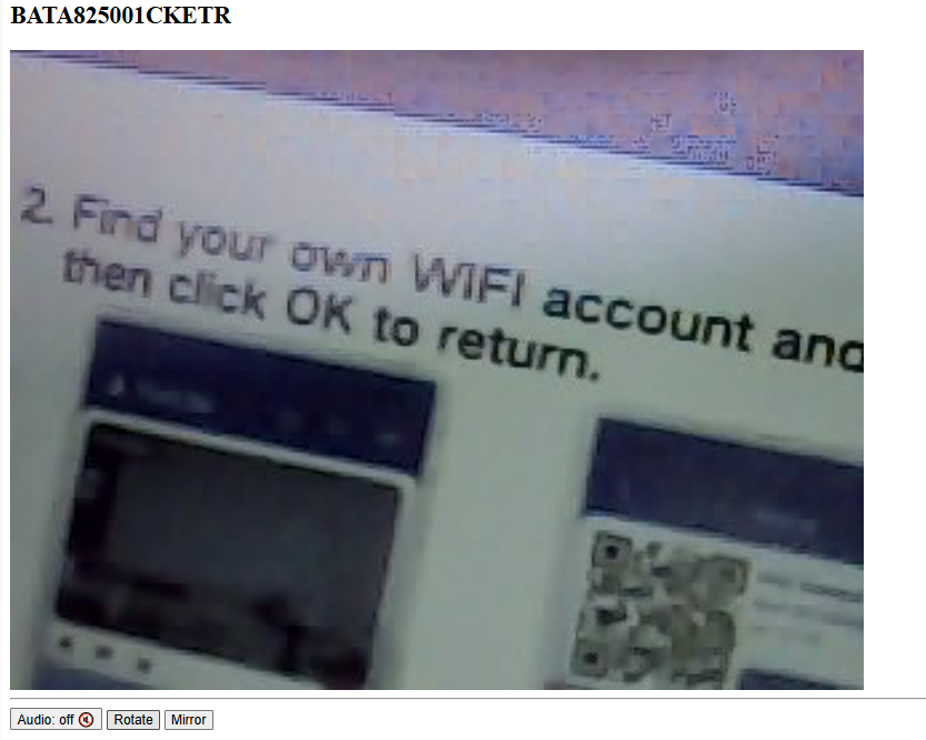

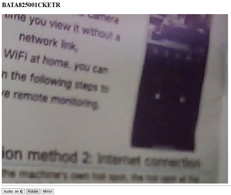

    Now you can access the stream:
    Close-up of a QR code on a white label with a partially visible border.

    I have such a camcorder A9 and I have such a strange issue , when the camcorder is powered from usb the recorded image is good when recording is from the battery itself the video contains some transitions and stripes as if part of the image was in a different place, even with another battery it is the same. What could it be?
  • #6 21523575
    gulson
    System Administrator
    Posts: 29234
    Help: 148
    Rate: 5984
    I had this when I plugged in the battery power - UPS under USB as a powerbank, as if something was introducing interference.
    It gets excited very easily. Possibly an inverter of some kind.

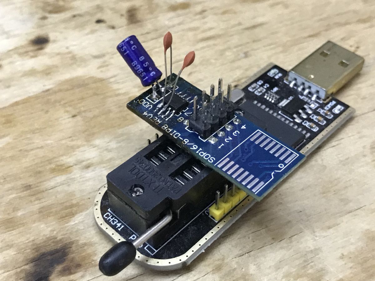

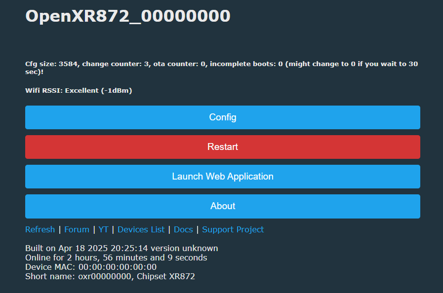

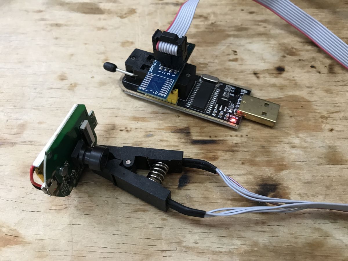

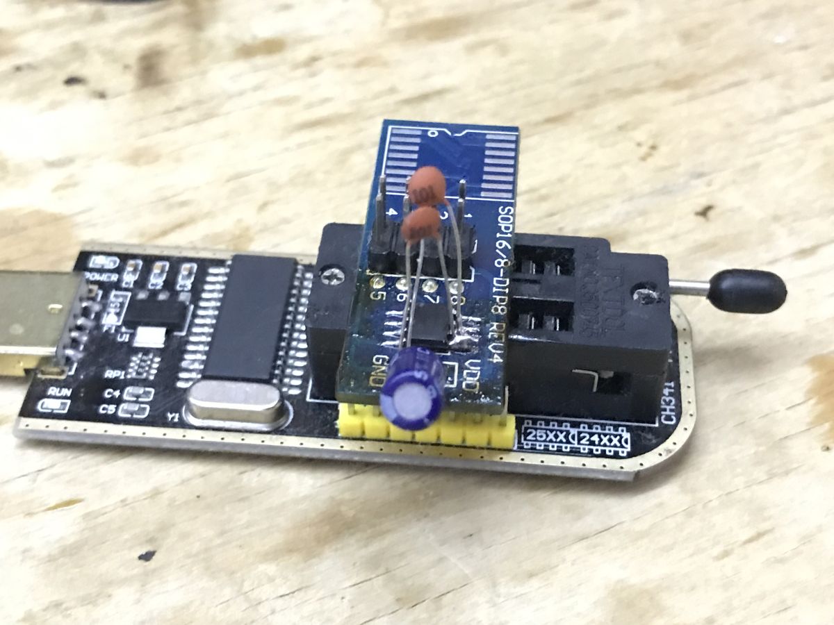

    And if that's still not enough - I managed to upload my own firmware to this camcorder today, but for now I've only got the basics up and running, WiFi, flash, no video support yet:
    Web interface of OpenXR872 firmware with configuration, restart, web application launch, and about buttons, plus device status info. .
    I also added the possibility to compile firmware for it online, here: https://github.com/openshwprojects/OpenBK7231T_App/pull/1609
    Thus, the XR872 platform joined the other platforms supported by my project , namely BK7231T, BK7231N, BK7238, XR809, BL602, W800, W600, LN882H, BK7231M, TR6260, RTL87X0C, RTL8710A, RTL8710B, RTL8720D, ECR6600, ESP32, ESP32 S2, ESP32 S3, ESP32 C2, ESP32 C3, ESP32 C6, Windows (simulator).

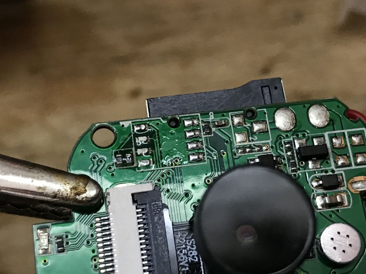

    Details coming soon, but I'll already hint that this camcorder has.... derived RX/TX on D+ and D- from the USB port. A bit unnecessarily I soldered out its flash bone earlier.
    Programmer connected to a Wi-Fi camera PCB using a test clip and wires, placed on a wooden table. Close-up of a webcam's PCB with visible electronic components and a soldering clamp. CH341A programmer with SOP16 adapter and capacitors on a wooden surface. Close-up of a USB programmer with a DIP8 adapter and flash memory chip, placed on a wooden surface. Close-up of an electronic setup with a USB port and connected wires with goldpin connectors. .
    Added after 11 [hours] 31 [minutes]: .
    I also tried changing the Flash bone from 1MB to 2MB, the flash is read correctly, worse is that the bootloader (from ROM) doesn't want an image other than the 880K size:
    [img E] image_get_raw_cfg():774, fdcm read failed
    use default flash chip mJedec 0x0
    [FD I]: mode: 0x4, freq: 96000000Hz, drv: 0
    [img E] image_init():157, the image max size is invalid
    [fwk ERR] no xip section
    Details: https://www.elektroda.com/rtvforum/topic4074636-30.html#21523067

    Then run the cam-reverse using NodeJS. You can build it from source, but I recommend downloading the pre-compiled CJS file
    What does this mean? Somehow, as simple as "cow on a ditch" :)
  • #9 21763506
    Posts: 14408
    Help: 650
    Rate: 12345
    Which stage exactly are you asking about? About compiling from 0, or about running the finished CJS? Running the finished one is better.
    You can build it from source, but I recommend downloading the pre-compiled CJS file:
    A section of a webpage showing downloadable assets, with the bin.cjs file highlighted. .
    Of course, also install NodeJS if you don't already have it.
    The default command to start the server is very simple:
    node dist/bin.cjs http_server
    You simply download the finished CJS from GitHub and then make sure you have NodeJS installed. If not, you need to install it. You need to have the node command running in the cmd. You then use this to run the downloaded CJS file. If the console doesn't see this command, then make sure that the path to NodeJS is added to path.

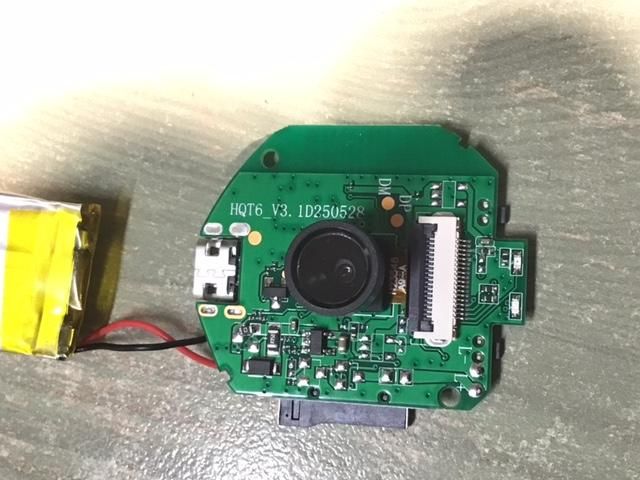

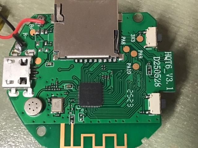

    I'm trying it too - I have a version of it:
    Camera PCB module labeled HQT6 V3 with lens and connectors visible IP camera PCB board marked HQT6 v3.1 with microSD slot and micro USB port
    and a second one with newer software but with the same hardware.
    My camcorder is in AP mode - I switch on appears network: DGON-HCAM..... with which I can connect.
    The camcorder gives IP: 192.168.1.100 itself has the address 192.168.1.1
    I am connected to it I start node.js:
    **** node dist/bin.cjs http_server --config_file dist/config.yml
    2026-01-05T23:10:08.089Z [info] Starting HTTP server on port 5000
    2026-01-05T23:10:08.124Z [info] Searching for devices on 192.168.1.1
    relatively without config:
    2026-01-05T23:47:34.467Z [info] Starting HTTP server on port 5000
    2026-01-05T23:47:34.503Z [info] Searching for devices on 192.168.1.255
    and unfortunately nothing happens.
    i tried pairing with my WiFi with the command:
    node dist/bin.cjs pair --ssid <SSID> --password <PASSWORD>
    and also zero effect.
    Maybe a different port is necessary?
    The TXW817 heats up a lot but is "touchable" i.e. about 60-70 degrees.

Why does my A9 camera video show stripes, tearing, or shifted image sections when running from battery but look fine on USB power?
The thread points to power-related interference. One user reported good video on USB but stripes and shifted image sections on battery, and another reported similar artifacts when powering through a USB UPS or powerbank, suggesting electrical noise from an inverter or unstable supply path. The concrete edge case is clear: the same camera can look normal on USB and visibly corrupted on battery or noisy external power. [#21523575]

How can I troubleshoot an A9 camera in AP mode at 192.168.1.1 when cam-reverse keeps searching but never finds the device?
Check subnet matching first, then force the correct discovery target. 1. Confirm your PC got an address from the camera AP, such as 192.168.1.100, and that the camera is 192.168.1.1. 2. Start http_server with a config file and set discovery to the active interface or AP subnet. 3. If pairing also does nothing, treat it as a compatibility issue rather than a port issue; the thread shows searches on 192.168.1.1 and 192.168.1.255 with zero detection. [#21800147]
