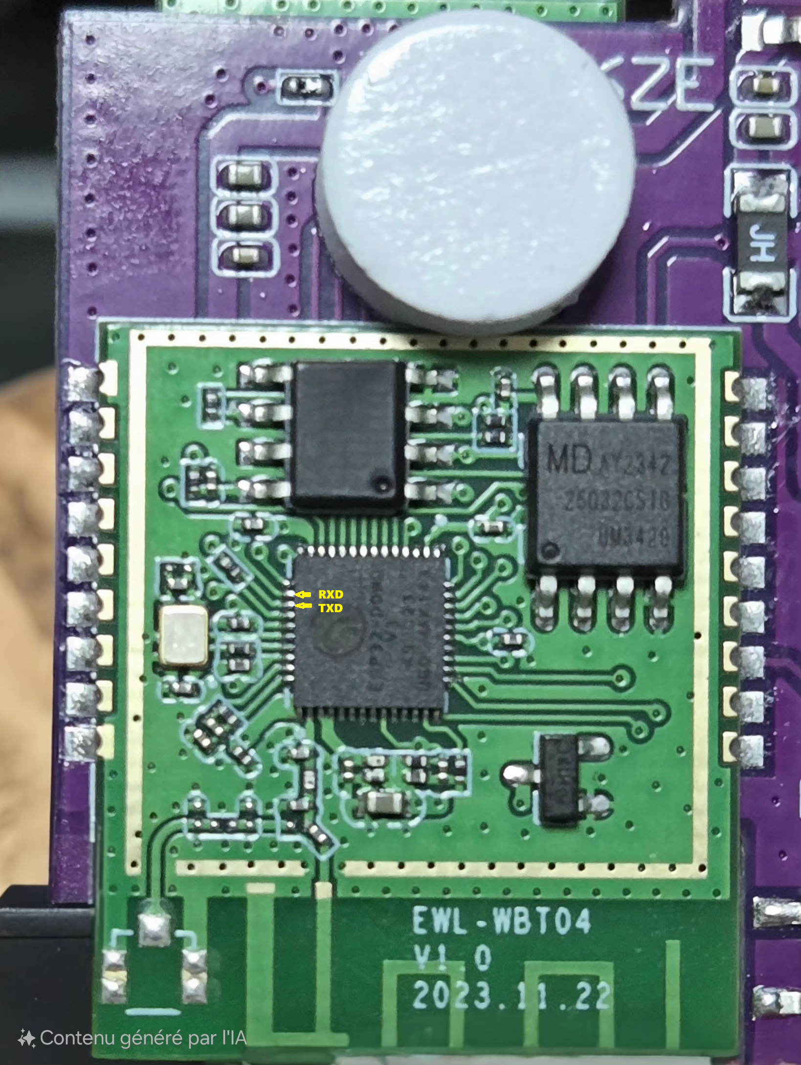

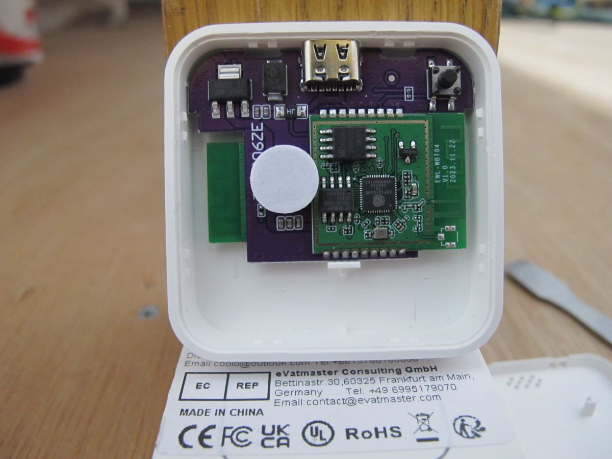

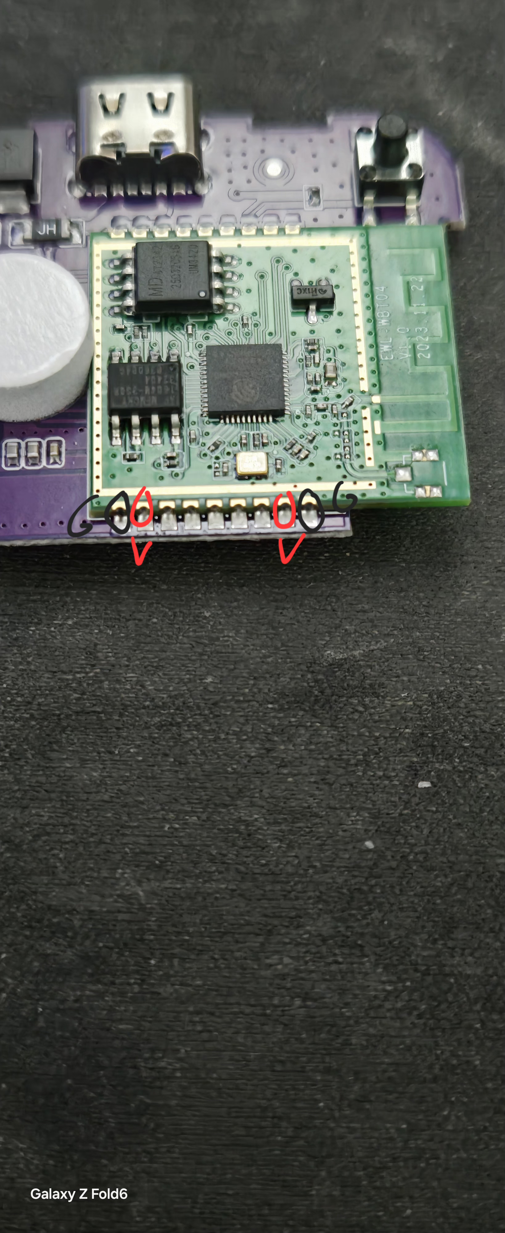

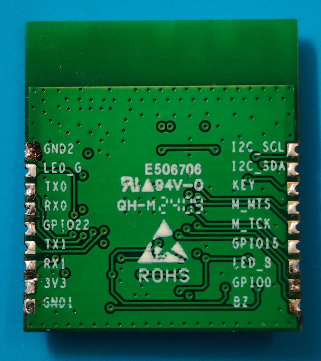

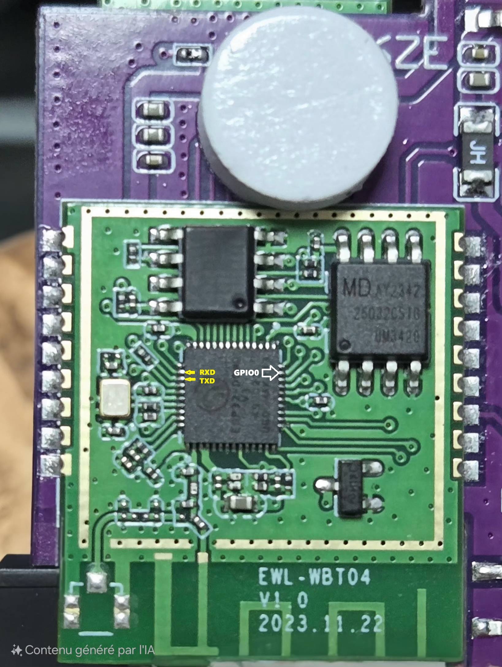

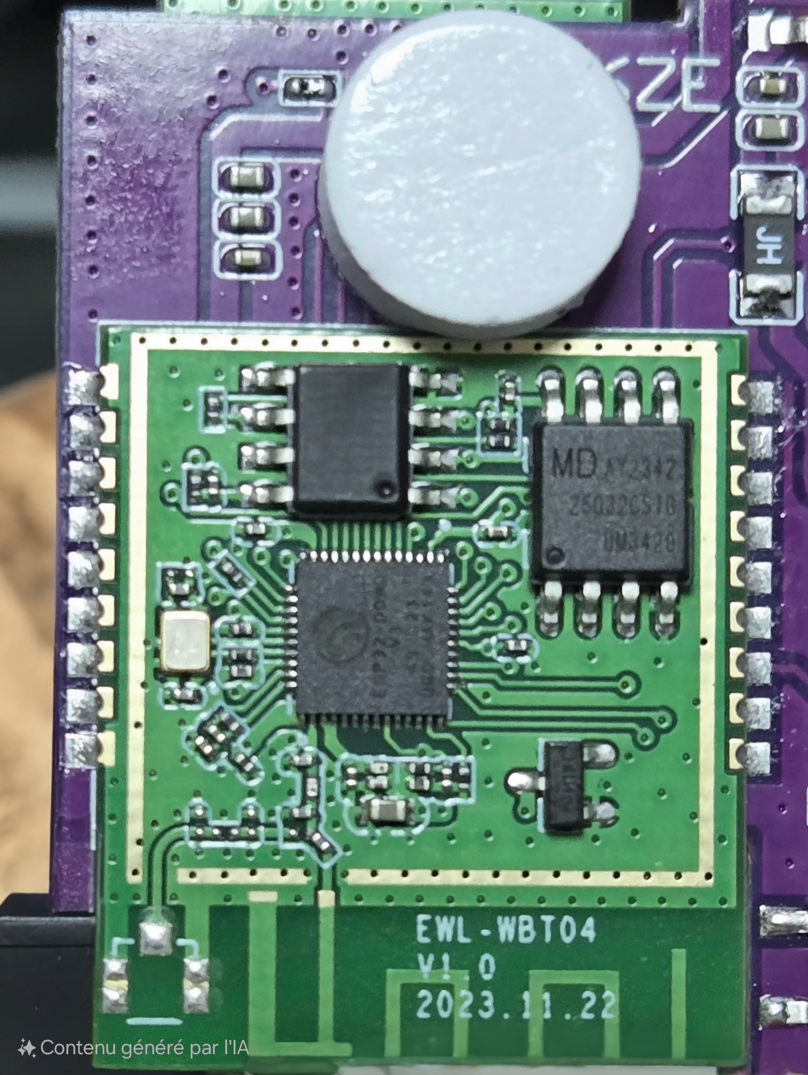

    I am currently working on an EWELINK Zigbee gateway that uses an ESP32 chip. This device includes a module labeled EWL-WBT04, but I’ve been unable to find any documentation or information about it online.
    So far, I’ve successfully identified the GND and VCC pins. The module has a 2x9 pin layout, with two ground pins and two 3.5V VCC pins.
    I’m now trying to locate the TX and RX pins but have encountered difficulties. I attempted to connect my UART controller to each pin individually to find the TX port. However, on some pins, I only receive garbled data (”?????”), and on others, there’s no output during the device boot sequence, suggesting these might not be the correct pins.
    Do you have any tips or methods to help me correctly identify the TX and RX pins?
    Thank you in advance for your assistance!
    EWL-WBT04 circuit module on a printed circuit board.
    Electronic module on a circuit board with pin markings.
    AI: Could you provide more details on the method or tools you used to test the pins for TX and RX?
    I connected a cable from the RX port of my UART controller to each pin of the module.
    AI: Are there any additional markings or identifiers on the EWL-WBT04 module that might help in identifying the pins?
    Nope

    There is lots of different esp32 chips. If it's zigbee you probably should NOT try to flash it. Likely you will brick it.
    If REALLY you want to try pinout looks similar to the one on page 13. pins 40 and 41.

    You can trace the path of the signals marked in the attachment.
    You can trace (traverse) the path of the signals marked in the attachment.

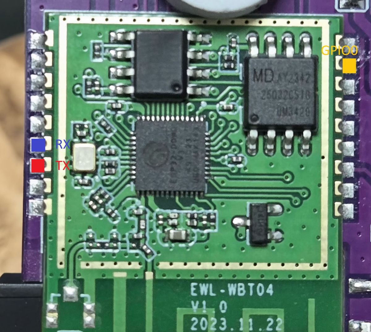

    Thank you for your response!
    The chip I’m working with is an ESP32 D0WD, which serves as a WiFi module. Additionally, the board includes another module featuring a Zigbee chip (CC2652).
    I’ve managed to locate the TX and RX pins, and I’m trying to enter bootloader mode by grounding GPIO0. Unfortunately, it seems I don’t have direct access to this pin. Do you have any suggestions on how to proceed?
    For reference, here’s some additional information that might help: https://kdrive.bagou450.com/app/share/763082/10c05739-3e48-4751-8a52-ee38994626ed
    Apologies if my questions seem a bit basic—this is my first time working on something this advanced with a board! 😊
    [url=https://obrazki.elektroda.pl/5718286300_1737102141.png]Close-up of a circuit board with marked pins GND, VCC, RX, and TX.[/url>]

    Proceed in the same way as before, i.e. find where the GPIO0 signal path leads.

    I don’t fully understand how to proceed, as the GPIO pins seem to connect to another layer of the PCB.
    However, I noticed that one pin switches from 3V to 0V when I press the button. Could this be GPIO0? I tried holding the button while powering it up, but instead of entering bootloader mode, it just boots normally.
    This is most likely the CHIP_PU pin that serves as a reset.
    yotapaki wrote:
    I don't fully understand how to proceed
    I thought you knew what I meant by finding the TX and RX pins as I described.
    To check where the GPIO0 signal path goes, use a multimeter and measure whether there is a connection between it and the other pins (one of the eighteen).

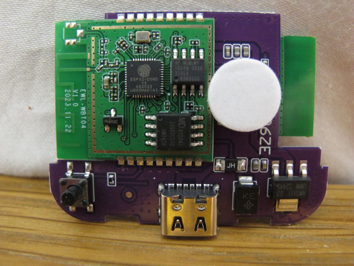

    >>21395282 I received that gateway today, and managed to flash and connect it to Z2M successfully.
    Close-up of an electronic module with clearly marked RX, TX, and GPIO0 pins.
    For pins, treat it like ZBBridge-P that lack some features (i2c rtc, buzzer).
    There is also a PSRAM chip that i haven't managed to get to work.
    ESP32 backup attached.

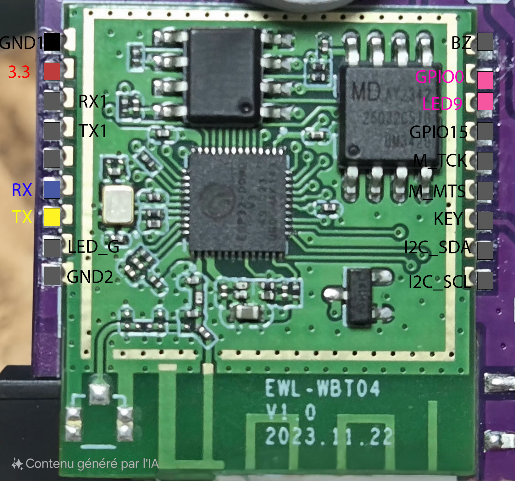

    And now i've managed to enable PSRAM by doing some pin tracing.
    ESPHome sdkconfig_options are
    CONFIG_D0WD_PSRAM_CLK_IO: "5"
    CONFIG_D0WD_PSRAM_CS_IO: "18"
    I haven't seen any config for ZBBridge-P with psram enabled, but since all pins are the same those would probably work for ZBBridge-P too.

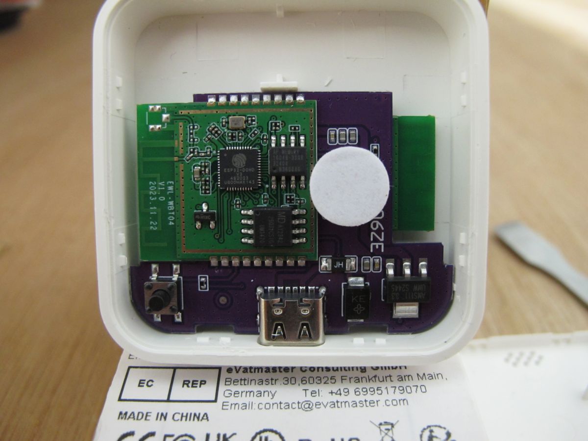

    didn't know there was a thread for this already. mine arrived today too.
    more pics for library:
    Packaging of Ewelink Zigbee 3.0 Gateway Hub EZ-MG-ZG-806. Close-up of the Zigbee Wireless Gateway packaging with manufacturer's information. Zigbee gateway starter kit contents on a wooden table. Cardboard packaging with a white label displaying the technical specifications of a wireless device. Zigbee wireless gateway placed on a wooden surface. White square sensor on a wooden surface. Device setup instructions on a wooden table. Zigbee Gateway user manual on a wooden surface. Close-up of an electronic circuit board with visible integrated circuit components. Electronic circuit board with visible USB port and components on a PCB. Interior of an electronic device showing PCBs and a USB port. Close-up of a green printed circuit board with an integrated circuit.
    Added after 37 [minutes]:
    log from that TX labelled. 115200 then 921600

    They cannot be wrong, i've traced them and flashed successfully via them.
    Perhaps you've accidentally swapped RX and TX? And as far as i remember, they aren't used for logging, so don't expect any output.

    >>21582540 Connect the module's RX to the UART's TX and TX to RX. I tried to flash it with Tasmota and without success. I tried to do it with Esphome using the script you posted and the same result, GPIO to ground to be able to enter programming mode, voltage at 3.3 volts.

    I was using usb to power it, and connecting uart module gnd to any gnd on the whole board (even usb socket body would work). GPIO0 to gnd before powering up.
    Alternatively you could try to read/write firmware via ch341a and a clip.

    >>21583025 In the end it was my USB adapter, I managed to flash it with Tasmota and it's working fine for the moment.

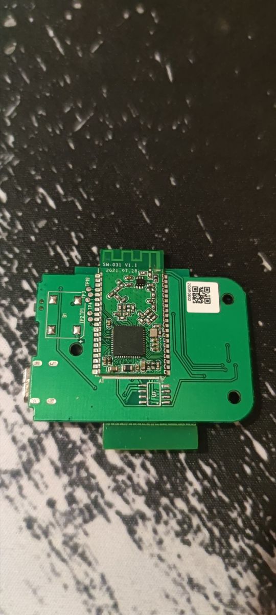

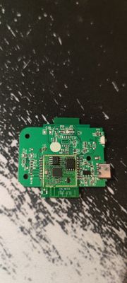

  • #24 21621420
    LeMaxime
    Posts: 16

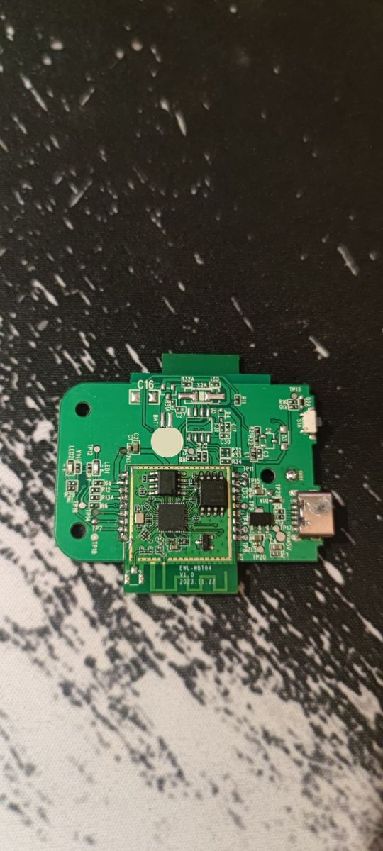

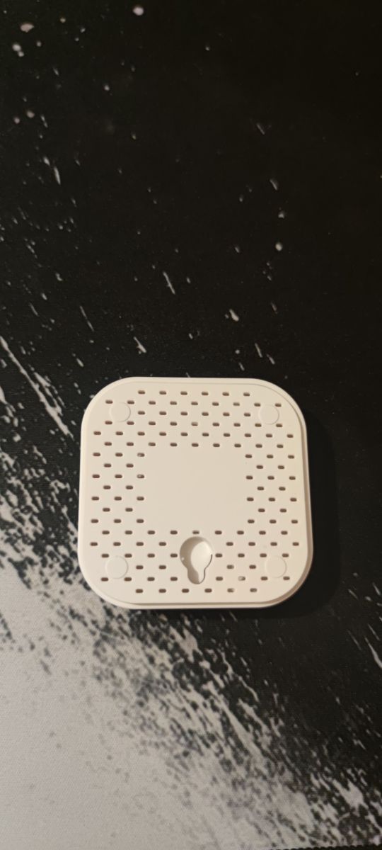

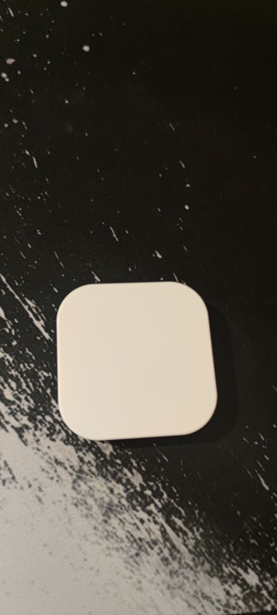

    Same device, same module
    But can't launch ESP in download mode
    tried even with external power - same result
    rx-tx, tx-rx, gnd-gnd, gpio0-gnd

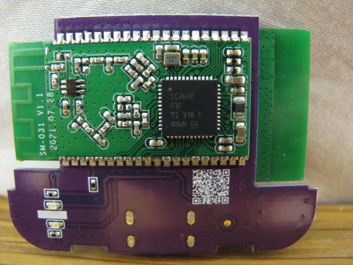

    Well, after a few days of thinking and the help of a very smart guy, there are a few things that need to be described.

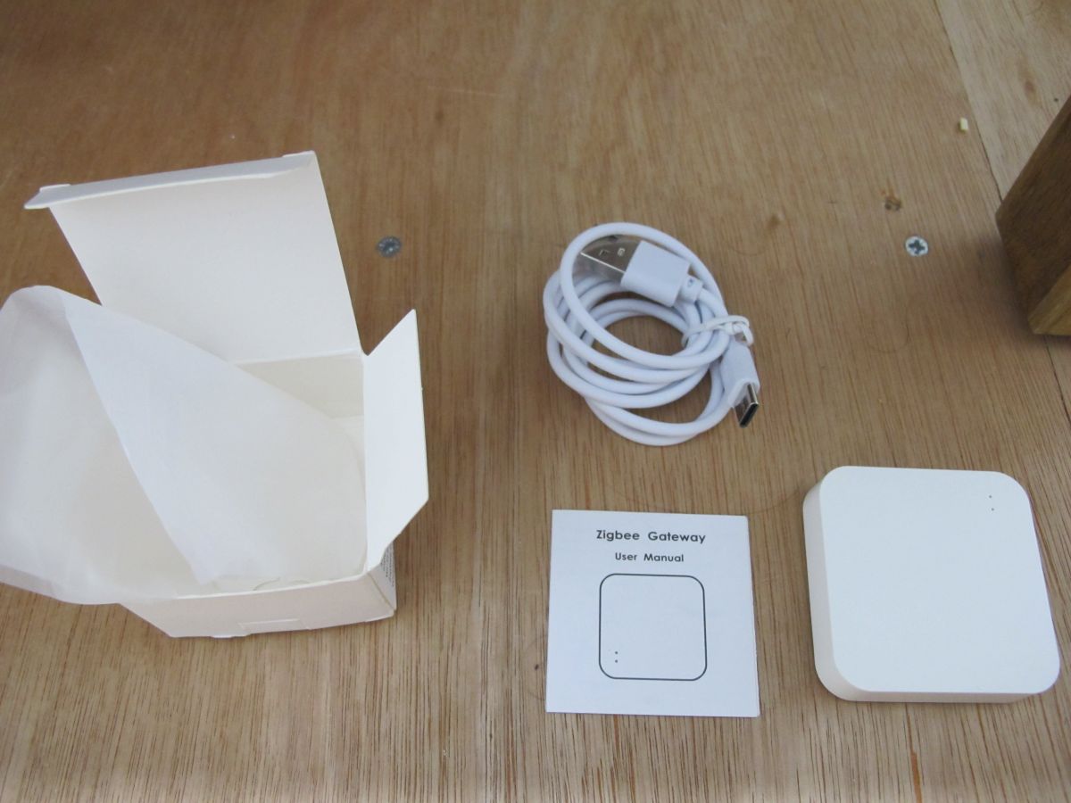

    My Ewelink Zigbee Gateway is different from the one described above. I attach photos. There is also a photo of the back side of the EWL-WBT04 module
    Package and case photos
    Spoiler:
    White square device with rounded corners on a black surface with white speckles
    Back of a white device case with vent holes on a dark splattered background
    White box labeled “Mini Wireless Gateway” on a dark splattered background

    Board photos
    Spoiler:
    PCB with EWL-WBT04 module, label SM-031 V1.1, back view
    PCB with EWL-WBT04 module, USB-C connector, surface-mounted components visible
    Backside photo EWL-WBT04
    Spoiler:
    Back side of EWL-WBT04 module with labeled pins on green PCB.
    Front photo EWL-WBT04 with pins describe
    Spoiler:
    Close-up of EWL-WBT04 module with labeled pins and GPIO connections
    In order to switch to download mode on this board, additional actions are required.
    Connect RX-TX, TX-RX, 3.3 - 3.3, GND-GND from EWL-WBT04 to your programmer (there are 2 GND on the board - choose any you like) You also need to additionally connect GPIO0-GND and LED9-GND. - Then connect the programmer to the computer.
    Now flash any firmware you want.
