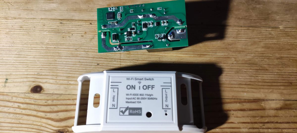

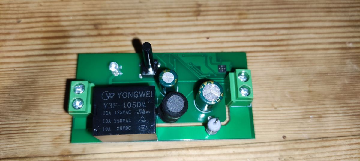

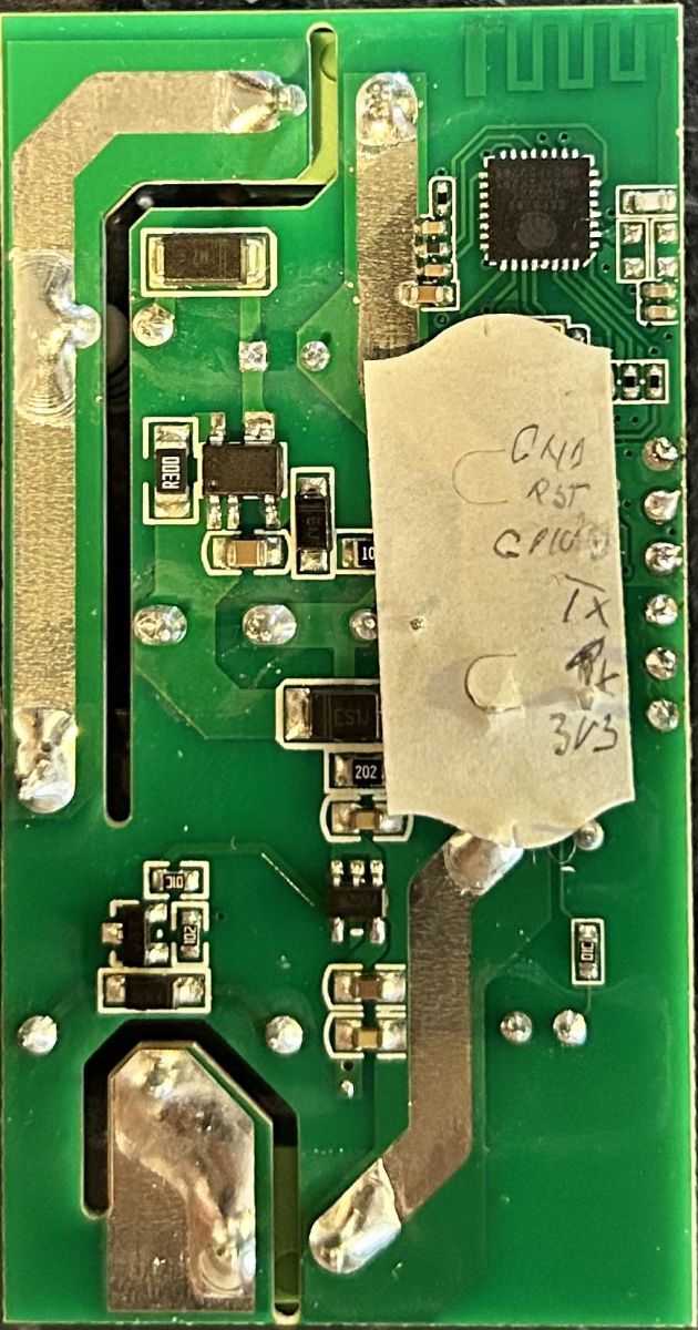

    I cannot for the life of me find this exact PCB on any forums. It's an ESP8285 10A generic smart wifi module from Ali. Single gang. item # 1005004792119903
    No PCB markings to help. Any idea what it is and what the pinouts are? thanks

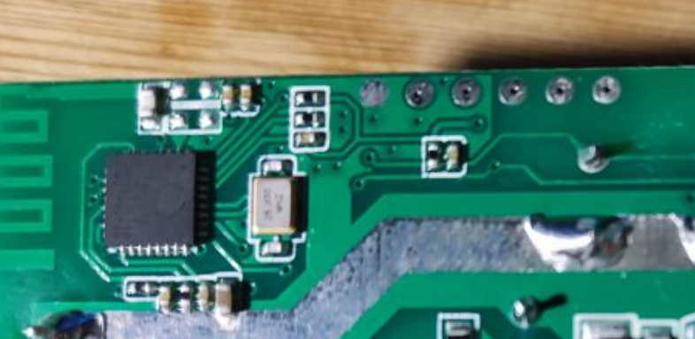

    Hello, the best method to do this is to just look at the ESP8266 datasheet. Here, I copied the pinout to Paint for you:
    Image of ESP8285 board and ESP8266EX pinout diagram.

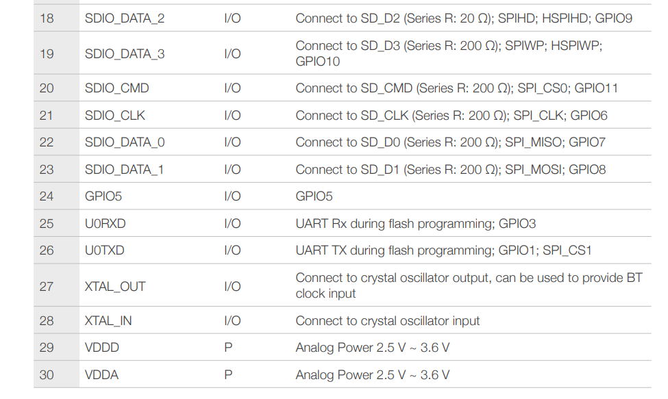

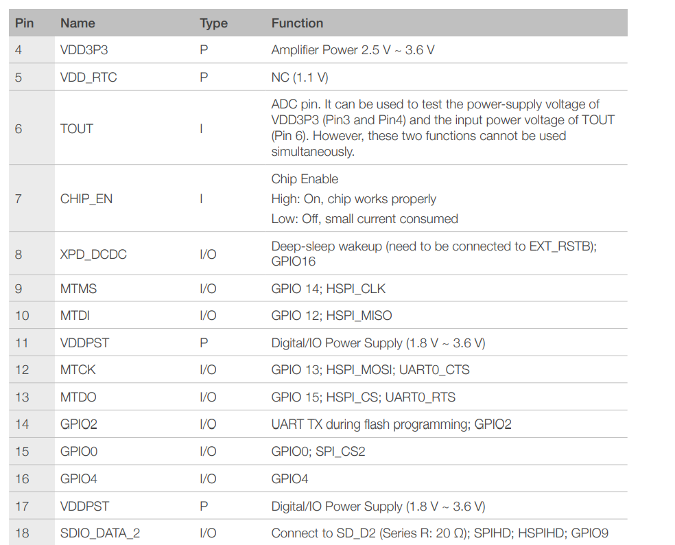

    Here is full GPIO list, as per datasheet:
    ESP8266 GPIO pin list with type and function.
    Extract from ESP8266 datasheet showing a list of pins and their functions.

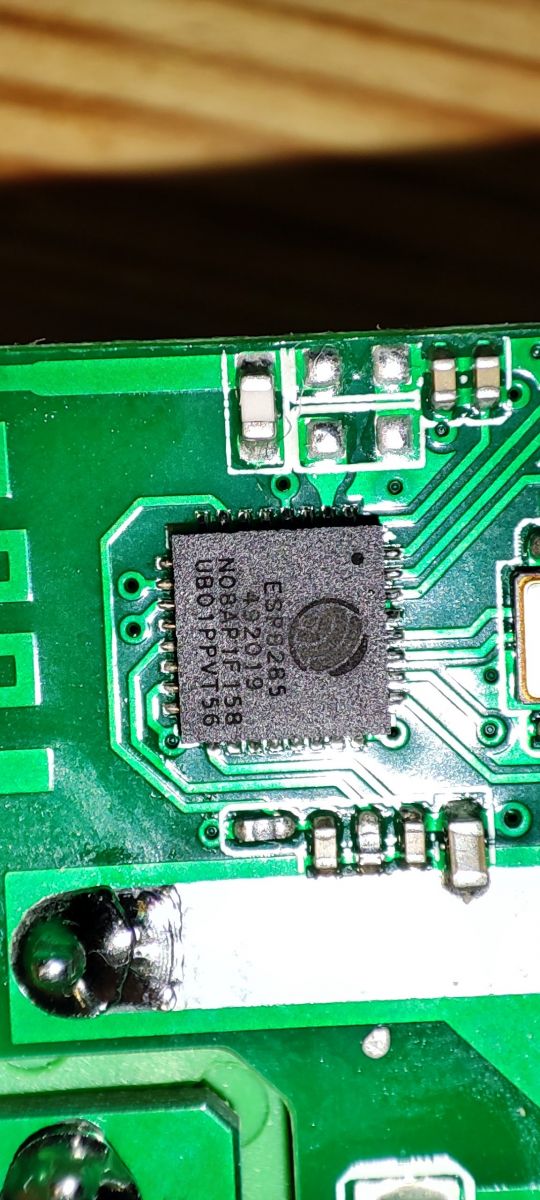

    And then, in Paint, you can map pins one by one, like that;
    Close-up of an ESP8285 circuit board and ESP8266EX pinout diagram.
    From a brief glance, it seems that GPIO12/MTDI and GPIO15/MTDO and maybe GPIO5 may be routed somewhere. I can also see U0TXD, U0RXD, etc routed but it's normal, its for programming header... same as GPIO0, but it's still worth to check that.
    Have you managed to flash Tasmota already to this device?
    You can continue to check pins just like I've shown, the method I've used can be very helpful

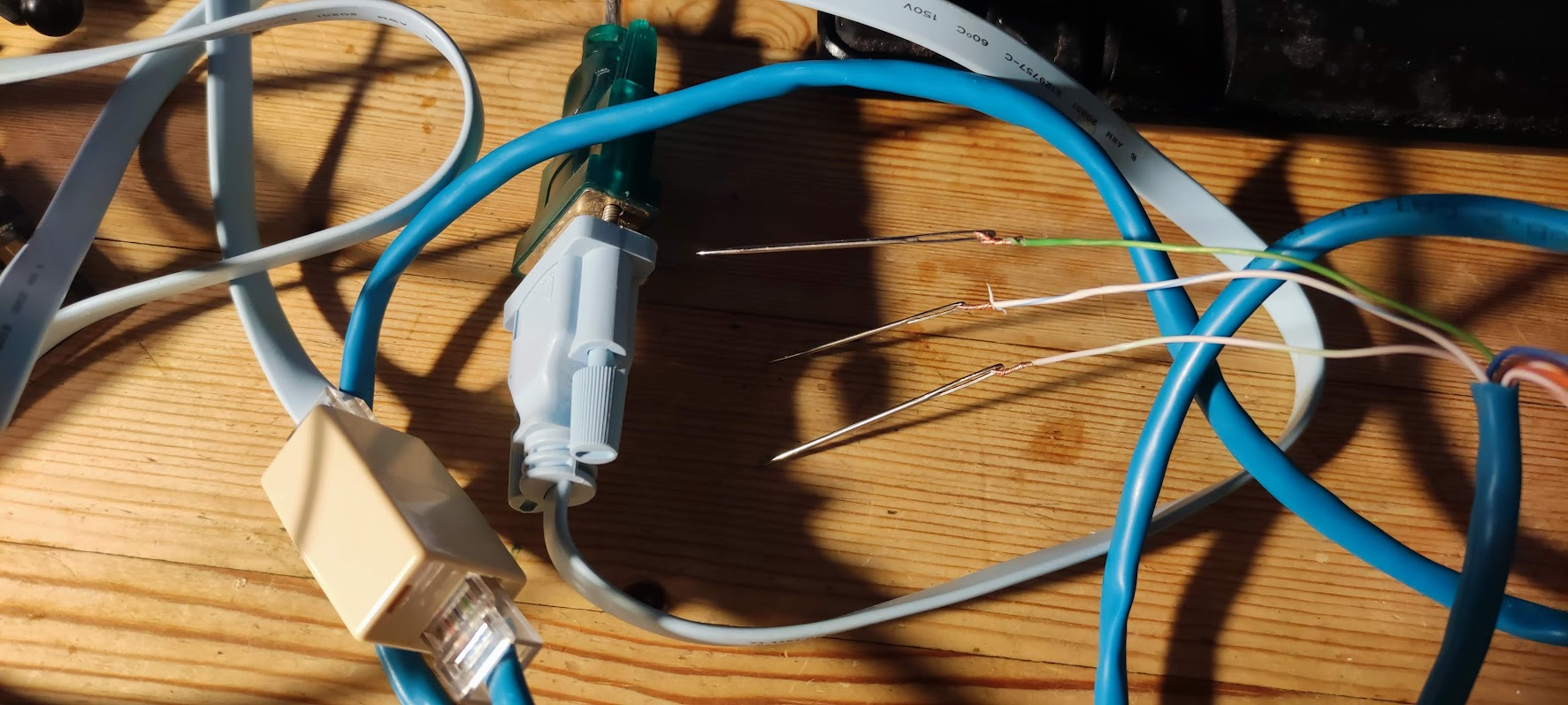

    I'll macro the whole board and trace all the pins. I think it's too small to attempt direct connection to the chip, even with my dodgy sewing needle usb-rs232 cable, which I've not yet tested,
    CH304 USB-DB9 -> Cisco DB9-RJ45 -> RJ45 straight coupler -> RJ45 UTP head cut off -> sewing needles
    Close-up of a makeshift cable: a USB-DB9 cable connected to wires ending in sewing needles.
    lol. I'll have to steady the pins with a giant blob of blu-tack or something.

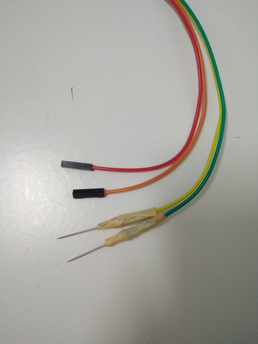

    I have used this to flash NEO sockets and it is quite effective.
    Close-up of colorful wires connected to test probes.
  • #5 20825666
    Posts: 5236
    Help: 449
    Rate: 918
    good to know my rig is in with a chance!

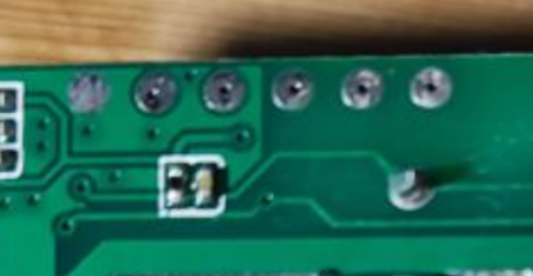

    If there is no Tasmota on this device yet, you also need to figure out the connector for flashing.
    Printed circuit board with visible traces, components, and solder pads.

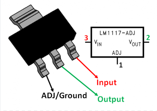

    1. Use multimeter to check which pin is GND, it should be connected to ground (-) of electrolytic capacitors
    2. Use multimeter to check which pin is 3.3V, it should be connected to positive terminal of electrolytic capacitors or 3.3V of ESP8266
    For points 1 and 2, if there is AMS1117-3.3V on board, you can also use this for reference:
    Diagram showing the pins of the LM1117-ADJ voltage regulator.
    3. Then you need to identify GPIO0 and RX and TX. Again, you can just look at the traces and try to identify where they go.
    The ground will be usually the large copper pool, but it's better to check it anyway. It seems there are 6 pads on the photo, not 5, but you need only 5.

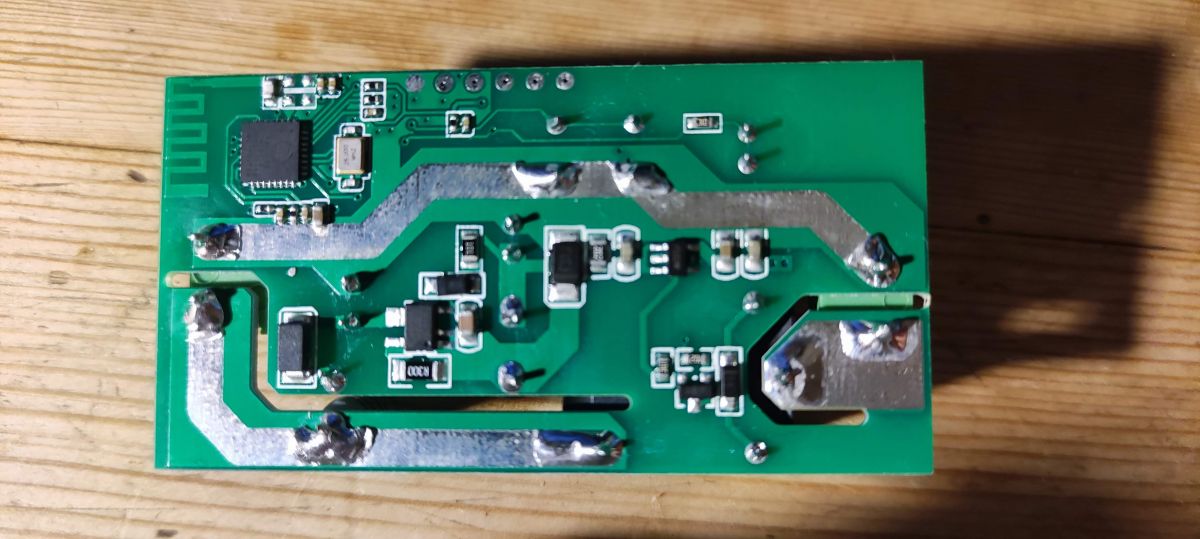

    I think I've done it with a continuity test between the esp chip pins and each of the circular factory pads in a row down the side.
    will do it properly later and maybe attempt a flash.
    Portion of a circuit board with several round pads and traces.

    I think we need to know first which pad is VDD (3.3V), as I said in previous post:
    https://www.elektroda.com/rtvforum/topic4016183.html#20825770

    #16 20942630
    Hgo11
    I got the same module - I did the measurements and successfully flashed Tasmota.
    See pins below (order from ESP chip):
    GND
    RST
    GPIO0
    TX
    RX
    3V3
