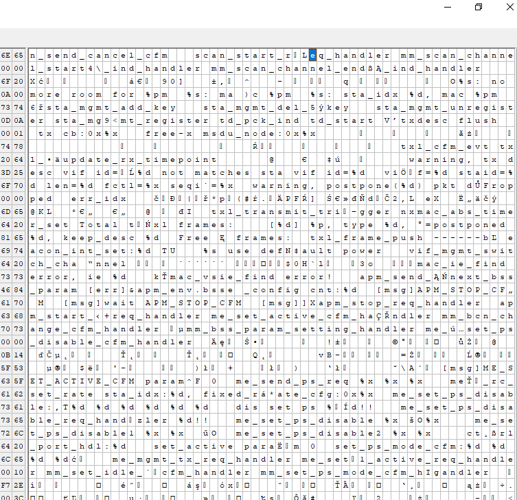

  • #33 21705509
    Posts: 14771
    Rate: 12914

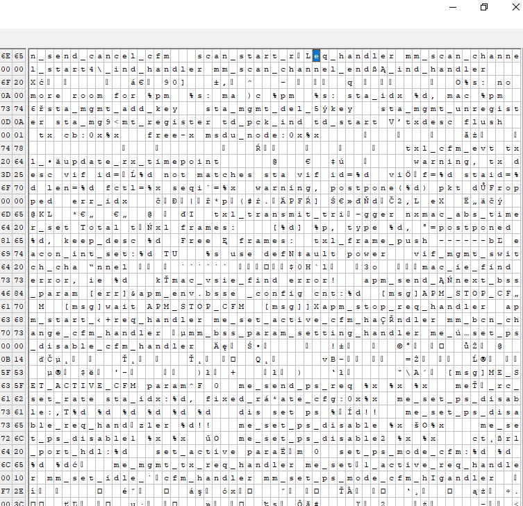

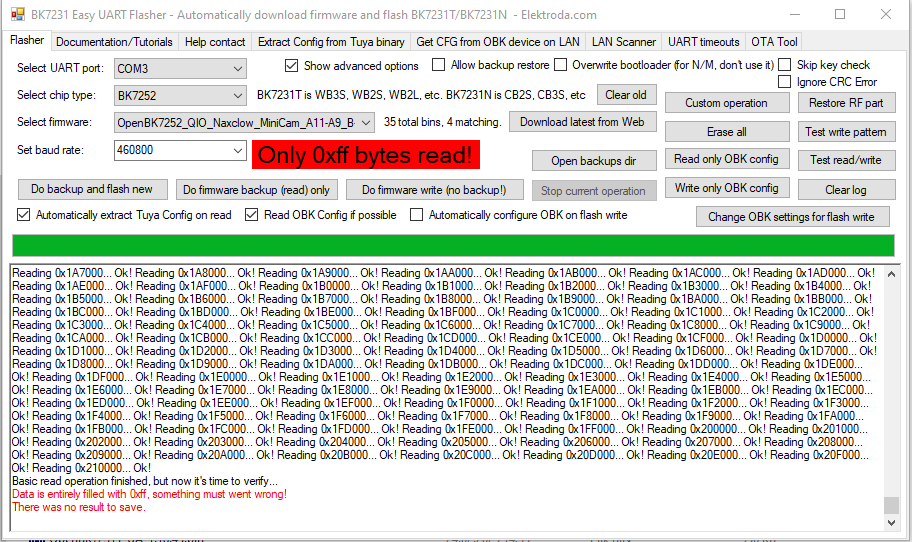

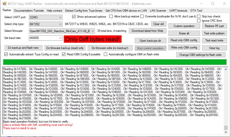

    Is bootloader readable via wrap around address hack?
    I did:
    1. EF erase all
    2. EF read:
    BK7231 Easy UART Flasher interface showing message Only 0xff bytes read!
    On BK7231T, I was able to read bootloader that way...
  • #34 21705531
    insmod
    Posts: 1432
    Help: 168
    Rate: 455
    >>21705509
    It was readable for me.
    Perhaps you got 4mb variant?

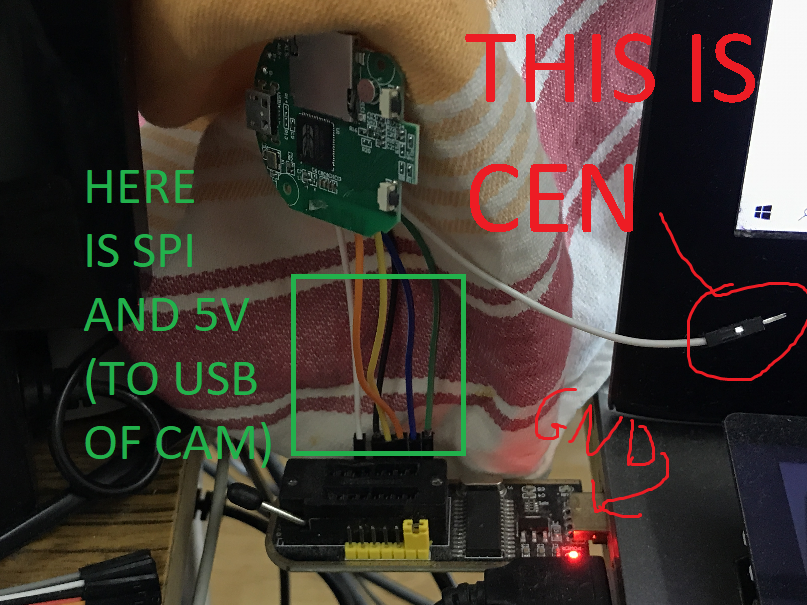

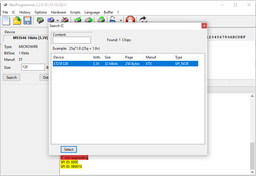

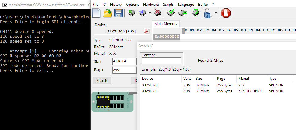

  • CH341 SPI recovery boots OpenBK7252 firmware
    #35 21705565
    Posts: 14771
    Rate: 12914

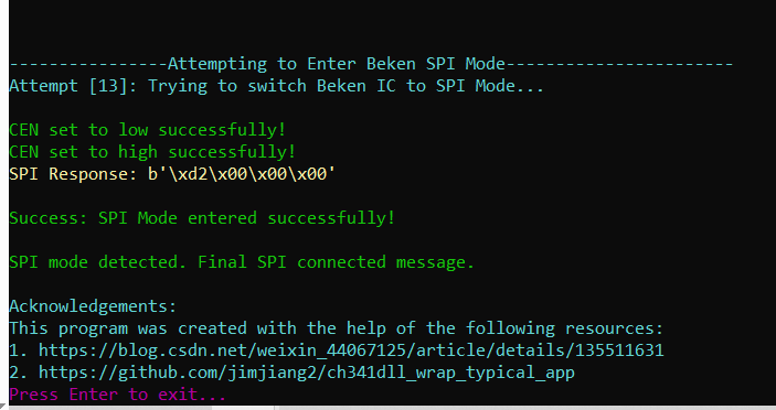

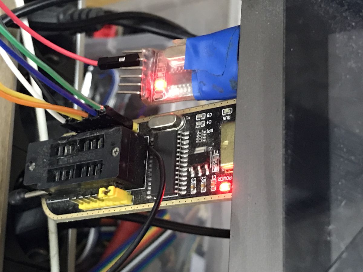

    Ah this explain things. Ok, now it seems I have overwritten bootloader and it no longer reacts to UART getting bus. Ok, let's try CH341 method as @divadiow described in the first post.
    Added after 41 [minutes]:

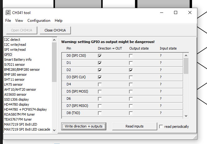

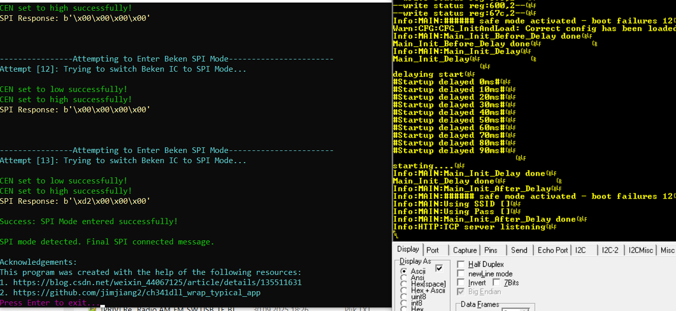

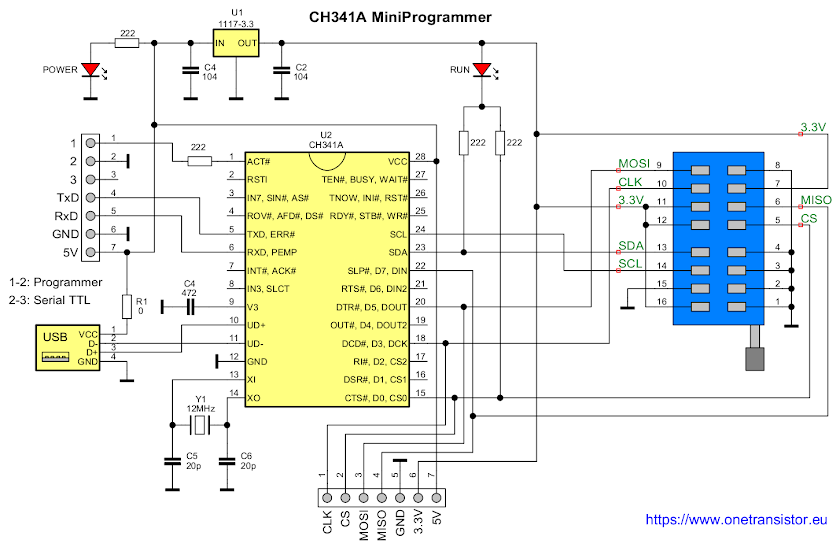

    Ok, progress report.
    CH341 from this vid:
    tool from @divadiow post.
    Taobao Tuya BK7252UQN68 Bare A9 Cam PCB (SC-10024 v1.0.0) - UART/SPI Flash Backup - OpenBK7252
    Method:
    1. run Beken SPI TOOL
    2. manually CEN to ground:
    3. it gets SPI:
    4. neo detects:
    5. OpenBK7252_QIO_1.18.184.bin boots

    yay cool. also cool you made use of the 341 SPI tool :D

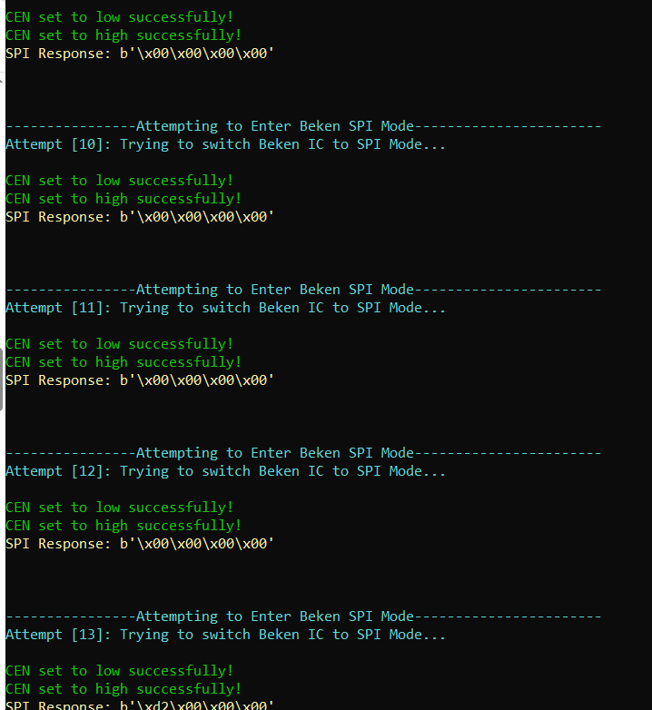

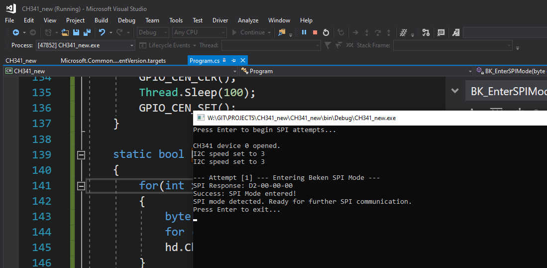

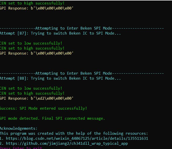

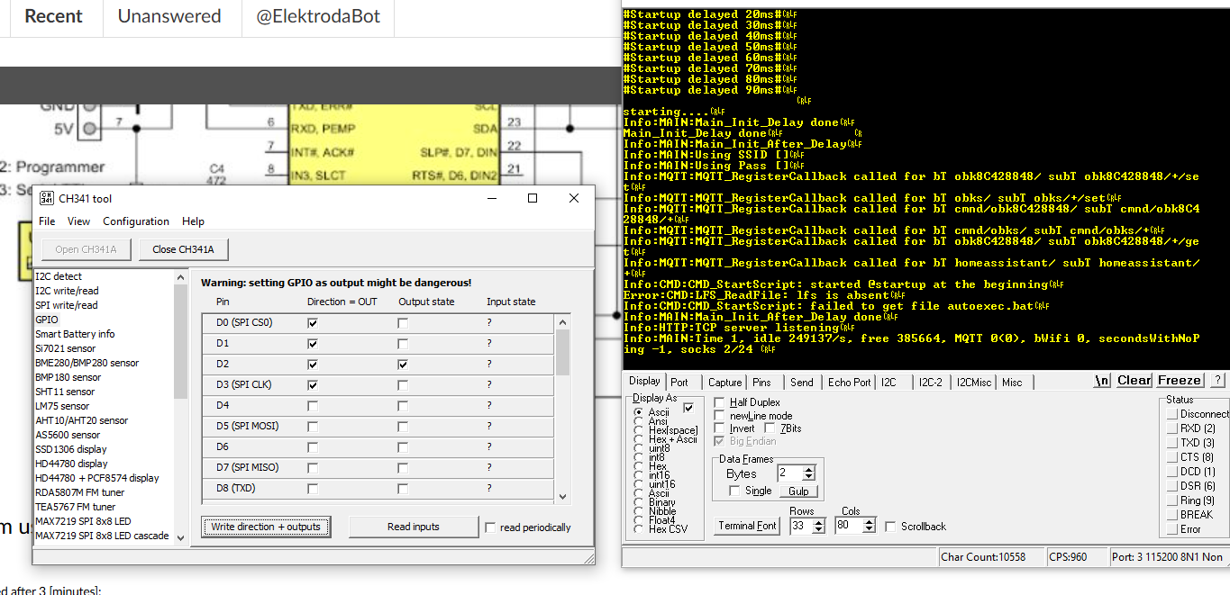

  • CH341-based SPI tool packaged with infinite retries
    #38 21705669
    Posts: 5220
    Help: 449
    Rate: 918
    Where does this SPI tool come from?
    here. source there for anyone who wants to fiddle because I think timings could be better. sometimes it takes many resets (if using D2)

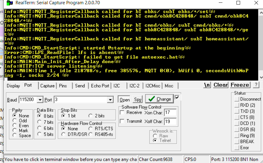

  • GC0329 and GC0310 not detected over soft I2C
    #43 21705726
    insmod
    Posts: 1432
    Help: 168
    Rate: 455
    I tried porting those changes, but it didn't work.
    I even tried via soft i2c from obk.
    gc0329 and gc0310 wasn't detected even via scani2c soft.
    Another strange thing is that on bk7238 i2c1 and i2c2 are somehow the same. I enabled OBK hw i2c on alt bekens, and scani2c i2c1 and scani2c i2c2 both detect aht10 connected to p20 and p21.
    https://github.com/NonPIayerCharacter/OpenBK7231T_App/actions/runs/18136281276 if interested

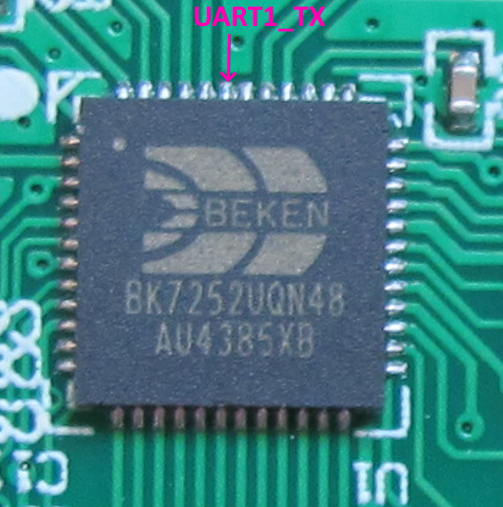

    BK7252N and BK7252 log is on UART1

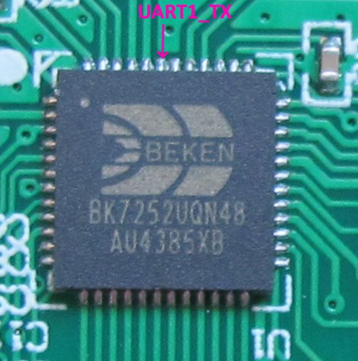

  • #51 21705973
    insmod
    Posts: 1432
    Help: 168
    Rate: 455
    >>21705944
    Perhaps log is on UART1?

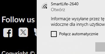

    This has booted:
    Tuya_A9_Cam_SC-10024_V1.0.0_(VGA卡片机-schemaID-000003uanz)_keyph8vwhadwsx3a_u0kmecmr7j8roazz_NEO_SPI_1.0.4.bin
    Wi-Fi window with SmartLife-2640 network and auto-connect checkbox
    Added after 17 [minutes]:
    Paired with Tuya App, but no video. Probably different camera sensor.

    just trying to locate UART1. Only 1 TX pad on this PCB. Not sure we ever did get the BK7252U48 datasheet/diagram, only 68
    Added after 56 [minutes]:
    location no great surprise given where TX2 can be traced to
    Close-up of BEKEN BK7252UQN48 chip with labeled UART1_TX pin

    Did you get OpenCam running?
    I am trying to improve my workflow. I need automatic CEN reset. Do you know is my CH341 same as yours, does it have D2? I've found:
    but it seems that connecting CEN To same pin does not work for me...
    I connected CEN to pin 17:
    I am using programmer jumper mode.
    Added after 3 [minutes]:
    Edit: found this tool
    Added after 8 [minutes]:
    Wait... my D2 works, I didn't click "write"....
    Added after 55 [seconds]:
    And since my D2 works from this tool, this brings the question, why it is not working with Beken_SPI_CH341A_1.0.exe?
    Also.... this has 5V logic level on CEN. That's not good in the long run.
    Yes, I can use D2 to reset Beken via CEN:
    Huh, I reconnected everything and it worked now:
    Screenshot showing debugging messages while initializing Beken chip via SPI
    Probably those timings are NOT that good, as you said.
    Added after 5 [minutes]:
    That's how I connected it:
    EEPROM programmer with connected wires and illuminated LEDs
    And again, it's attempting in a loop with no sucess. Oh wait... attempt 88
    Terminal window showing successful SPI mode entry for Beken IC
  • #55 21706724
    Posts: 5220
    Help: 449
    Rate: 918

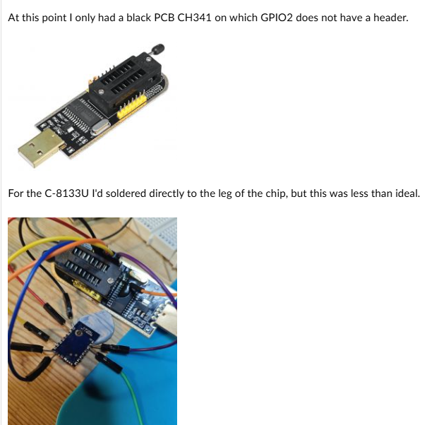

    Yeh. The timings suck. Sometimes it's hundreds of tries. If I'm not desperate I just let it run or if need quick result do CEN manually a few times.
    initially I had to solder to CH341A pin for IO2
    CH341 programmer on black PCB and wired microcontroller setup

    Ok I tried to improve it a bit, can you try this version?
    Visual Studio with C# code running and console showing SPI mode messages
    • ch341bkRelease.zip (6.33 KB) You must be logged in to download this attachment.
  • #57 21706832
    Posts: 5220
    Help: 449
    Rate: 918
    much better. almost straight away.
    Detected SPI NOR memory chips XT25F32B using a chip reading tool and CH341.
    are you thinking eventual EF integration?

  • #60 21706885
    Posts: 14771
    Rate: 12914
    OK i can read flash, however... at first it looked corrupt, but now it reminds me something. Is this a CRC? That one problematic CRC that was mentioned in one of the thread, every few bytes?
    I am referring to the string references.
