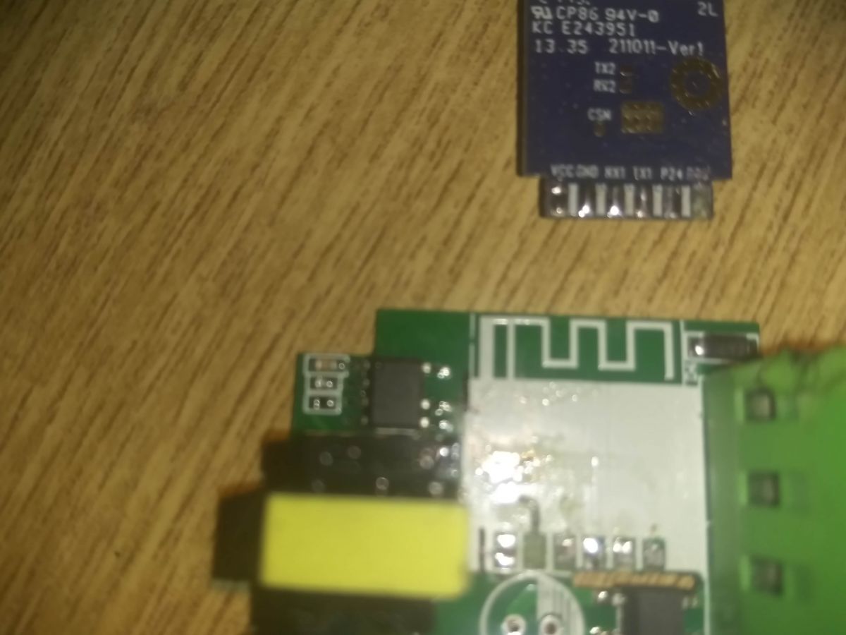

    Well hello, I'm glad that I found your work , because I've got this beautiful switch and its the CB2S version , but the plate is soldered i guess in that way that i cannot reach the RX TX side ,any suggestions how to remove it ? Thx
  • #3 20080797
    Posts: 14489
    Help: 651
    Rate: 12497
    Can you post a photo?
    Well, maybe a solder wick, soldering iron and some flux? First put flux on joints, then use solder wick and soldering iron to remove the solder, and when you're done (all solder is removed) then you can pull out CB2S module out....
    You can program CB2S outside of relay board, just provide 3.3V, GND and TX/RX (no CEN needed, I think)
    Of course, you have to solder it later.

    I did post a photo but the moderator needs to approve it, I just wanted to ask you that how on earth they are managed to solder it like this, with hotplate I guess, or with some dark magic. Soon the picture will be approved and you'll see this horrid technique.
    Added after 5 [minutes]:
    this is the tiny switch that goes into the wall socket behind the switch, and almost no testpoints are exposed on the PCB.I would say it's 20mmx20mmx10mm
    And it's a pain in the butt with localTuya in Homaeaasitant, so thats why your work is far superior to the original firmware

    Ah, you are asking for the soldering technique? Well, maybe I could make a short video clip, but for now text description should do it
    1. if board is dirty from your previous experiments, clear it with PCB cleaner, might be IPA or something
    2. also make sure that soldering iron tip is clean
    3. add flux to the joints/pads
    4. add some extra Pb solder (Pb has lower melting temperature and it's easier to use than pb-free solder) on the joints/pads (with the help of soldering iron, obviously)
    5. strip the wire, add some flux on the wire
    6. add some solder on the wire tip (without soldering it, just to make sure that solder penetrates the wire)
    7. then, finally, solder the wire (already coated with solder) to the PCB joint (both PCB joint and wire should be already pre-covered with solder on this step)
    This methods lets you to solder wires to test pads reliably, even with the cheapest aliexpress soldering irons

    the funny thing is that no soldered surface is exposed, it's like a sandwich

    ncore432
    Posts: 13
    I ve manged to take it off but I ripped some pads, it is worse than a BGA job, will send the pictures on PM
  • #9 20081039
    Posts: 14489
    Help: 651
    Rate: 12497
    So it seems that you have a very different relay than the one here and pads really are not accessible, because they are totally covered by PCB.
    ncore432 wrote:
    Qiachip Smart Switch - BK7231N / CB2S - interior, programming Qiachip Smart Switch - BK7231N / CB2S - interior, programming Qiachip Smart Switch - BK7231N / CB2S - interior, programming Qiachip Smart Switch - BK7231N / CB2S - interior, programming Qiachip Smart Switch - BK7231N / CB2S - interior, programming Qiachip Smart Switch - BK7231N / CB2S - interior, programming Qiachip Smart Switch - BK7231N / CB2S - interior, programming
    I would have try with hot air, but now you already have module off...
    You can program it now and try soldering it back. Since one of the pads might ripped of, maybe you should try using some small wires and let the WiFi module dangle in the air (or better secure it with glue later)
