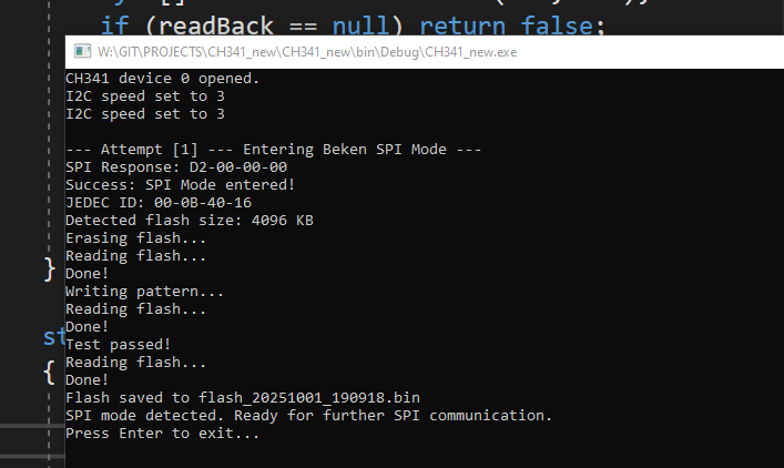

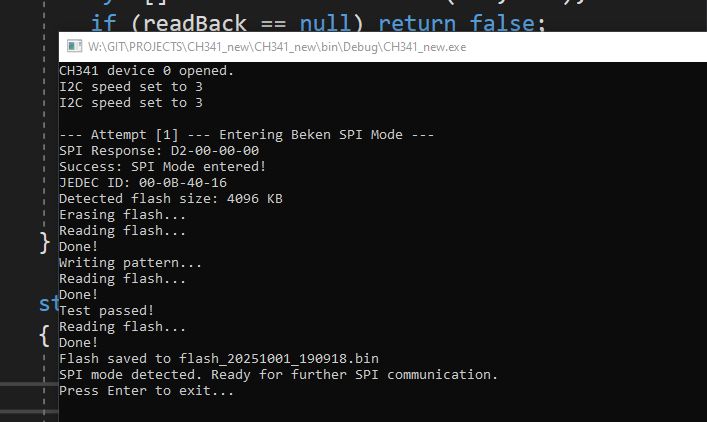

    SPI flash read, erase, and write now working
    #62 21706923
    Posts: 14771
    Rate: 12914
    That's a ... a very common occurence of CRC, isn't it? I was under impression that mere bits are needed to check the validity of very large buffers, and here they use 16 bits per 32 bytes...
    I think I can read, erase and write memory now - also with full chip erase (and with status register checks):
    Terminal window showing flash memory read/write via SPI interface
    Nothing really new here, the same I did there: https://github.com/openshwprojects/OpenBK7231T_App/blob/main/src/driver/drv_spi_flash.c
    I will pack this into some C# class and prepare either a standalone tool or a EF update.. or both, not sure.

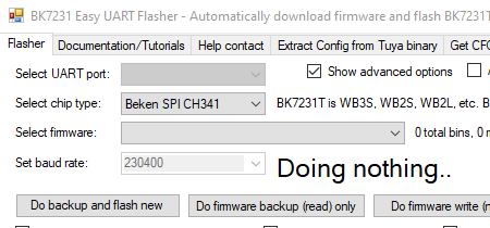

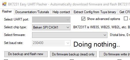

    @divadiow this Beken SPI is basically generic SPI + Beken RESET. As you probably know... since you've used NeoProgrammer.
    This brings the question - can we use EF as generic SPI flasher? I think we can! Do you have BIOS chips to try?
    My next camera is with delivery courier.

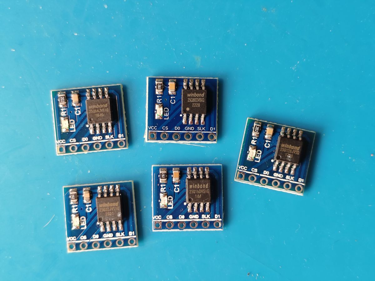

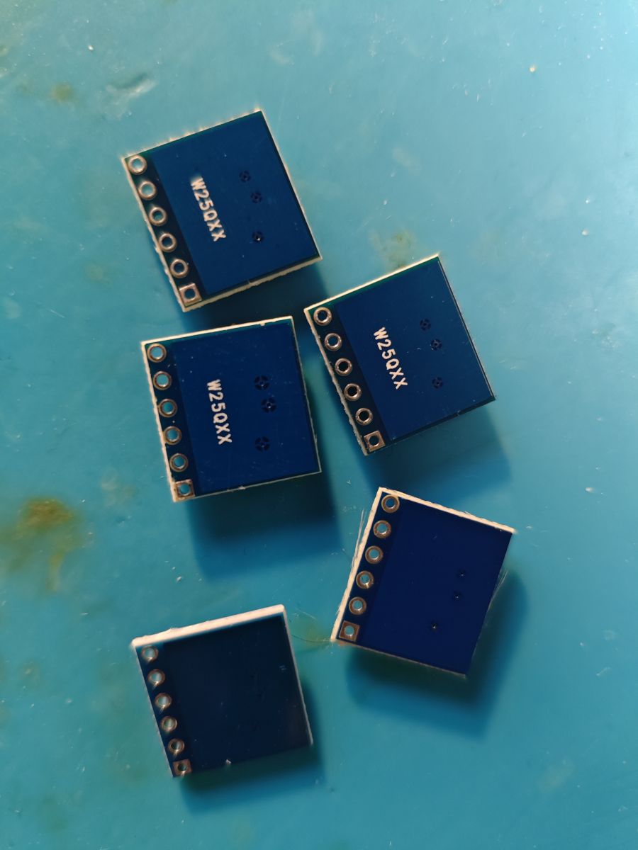

    What kind of board is it? I haven't seen it yet. I only do this that way:
    https://www.elektroda.pl/rtvforum/topic3993012.html
  • #68 21707518
    Posts: 14771
    Rate: 12914
    Ok I think I've found them. I was not aware that there is this kind of breakout, but it makes sense in a hindsight.
    W25Q32 flash memory module with SPI interface on blue PCB board

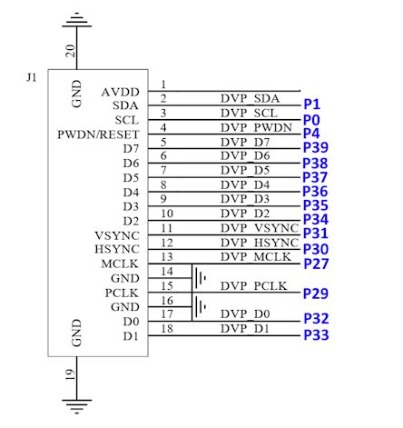

    #71 21761349
    Posts: 5220
    Help: 449
    Rate: 918
    insmod wrote:
    https://github.com/NonPIayerCharacter/OpenBK7231T_App/actions/runs/18136281276 if interested
    BK7252N and BK7252 log is on UART1
    thought I'd give this a go. not found where IOs set are used yet though in cam build.
    This is a new 18-pin cam doorbell BK7252UQN48, not Tuya, unencr.
    J1 camera module pinout diagram with DVP signal labels and P0–P39 mappings

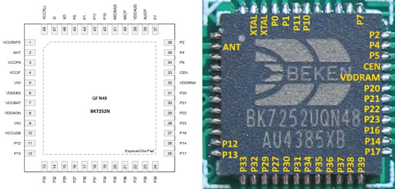

    #72 21773315
    easton
    >>21706031
    Based on the boot logs (SDK 3.0.33), the BK7252UQN48 appears to be the older BK7252 core (BLE 4.2), not the newer BK7252N (BLE 5.2). It looks like 'U' just denotes the QFN48 package for the original silicon.
    This naming matches the pattern seen in the BK72XX_SDK_User_Manual-3.0.3.pdf (attached) for the BK7231, where 'U' was the older BLE 4.2 core and 'N' was the upgrade to BLE 5.1.
    The pin mapping for BK7252UQN48 matches the BK7252N datasheet QFN48 (attached), so you can use that to trace the UART pins.
    • BK7252N 数据手册_V1.13_en.pdf (3.47 MB) You must be logged in to download this attachment.
    • BK7252_Data_Sheet_Chip_Specification_V1.3.pdf (682.14 KB) You must be logged in to download this attachment.
    • BK72XX_SDK_User_Manual-3.0.3.pdf (705.04 KB) You must be logged in to download this attachment.
    BK7252UQN48 pin tracing with VDDRAM correction

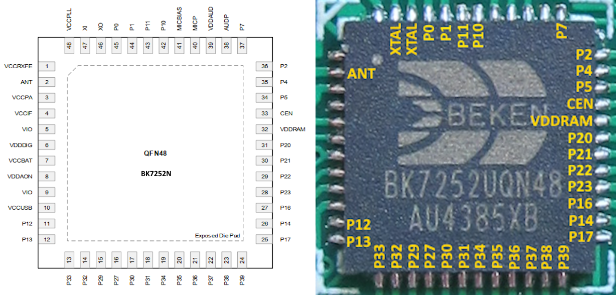

    well, regarding a QFN48 U and N pin comparison, here is my independent work-in-progress tracing of IOs on BK7252UQN48 alongside the BK7252N QFN48 from the datasheet. I'd not married the two until now.
    Pin mapping comparison of BK7252N and BK7252UQN48 in QFN48 package
    not sure what to make of the GNDDIG label now though. I'm sure it had continuity with GND. I'll recheck.
    EDIT: Updated image correcting GNDDIG label for VDDRAM

    Well that was my assumption based on BK7252U QFN68 label, which is known, and the fact that it had continuity with ground. The thing now is that, if it is indeed GNDDIG, then that differs from the BK7252N datasheet, and so the BK7252N pin diagram can't be totally relied on for understanding BK7252U QFN48. I hope that makes sense!
  • #76 21773630
    Posts: 14771
    Rate: 12914
    Well, putting VDD in place of GND is a serious change. Even the PIC microcontrollers, which I used to program during school days, try to keep their VDD/GND footprint compatible between MCU variations. And here we have a straight up power to ground swap...
    EDIT: IMAGE REMOVED TO AVOID CONFUSION
  • #77 21773645
    Posts: 5220
    Help: 449
    Rate: 918
    Yep ok. Will confirm with continuity and voltage measurement later today
    Added after 7 [hours] 7 [minutes]:
    yikes. it carries a voltage. 3.62v. original image updated. annoying because I usually triple-check to avoid exactly this.
