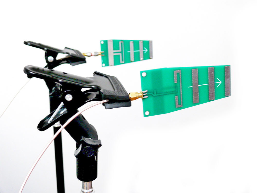

  • A 2.4GHz YAGI PCB Wi‑Fi antenna for ESP32 ESP-NOW links is tested as a range booster between two buildings.
  • The receiver uses the PCB YAGI instead of an omnidirectional antenna, with a u.FL-to-SMA adapter, and the board includes three directors, a dipole, and a reflector.
  • The antenna measures about 50mmx100mm and enabled one-way ESP-NOW transmission over approximately 430m.
  • Standard omnidirectional antennas worked at about 300m in one setup, but failed at 430m until the YAGI was fitted.
  • Urban 2.4GHz conditions and many Wi‑Fi APs can severely hamper propagation, so the antenna is not a guaranteed fix.
  • Two green PCB YAGI antennas on a white background.
    There are YAGI Wi-Fi PCB antennas available on Aliexpress for the 2.4GHz band. However, I didn't need such an antenna for a typical Wi-Fi card. I'm using ESP32 modules with omni-directional antennas, which transmit information between two buildings about 300m apart after ESP-NOW. One module sends information, the other receives information, it is a one-way transmission. There is no visibility between the buildings, which are obstructed by trees and other buildings. The distance of 300m is not a special achievement, as one can find information about successful attempts with ESP-NOW at 1km with optical visibility.
    Such a simple set-up allowed data transmission over a distance of 300m:
    Two ESP32 modules with attached omnidirectional antennas.

    What did I need the PCB YAGI antenna for?
    I wanted to use similar connectivity between two buildings about 430m apart. This time the omnidirectional antennas did not provide transmission. Unfortunately I did not know whether the problem was the distance or the terrain obstacles. It remained to do a practical test and the PCB antenna went into the receiver.
    Also, I had the opportunity to test whether the antenna responds to frequencies in the 2.4GHz band:

    After using a YAGI antenna on the receiver, transmission over approximately 430m was possible!

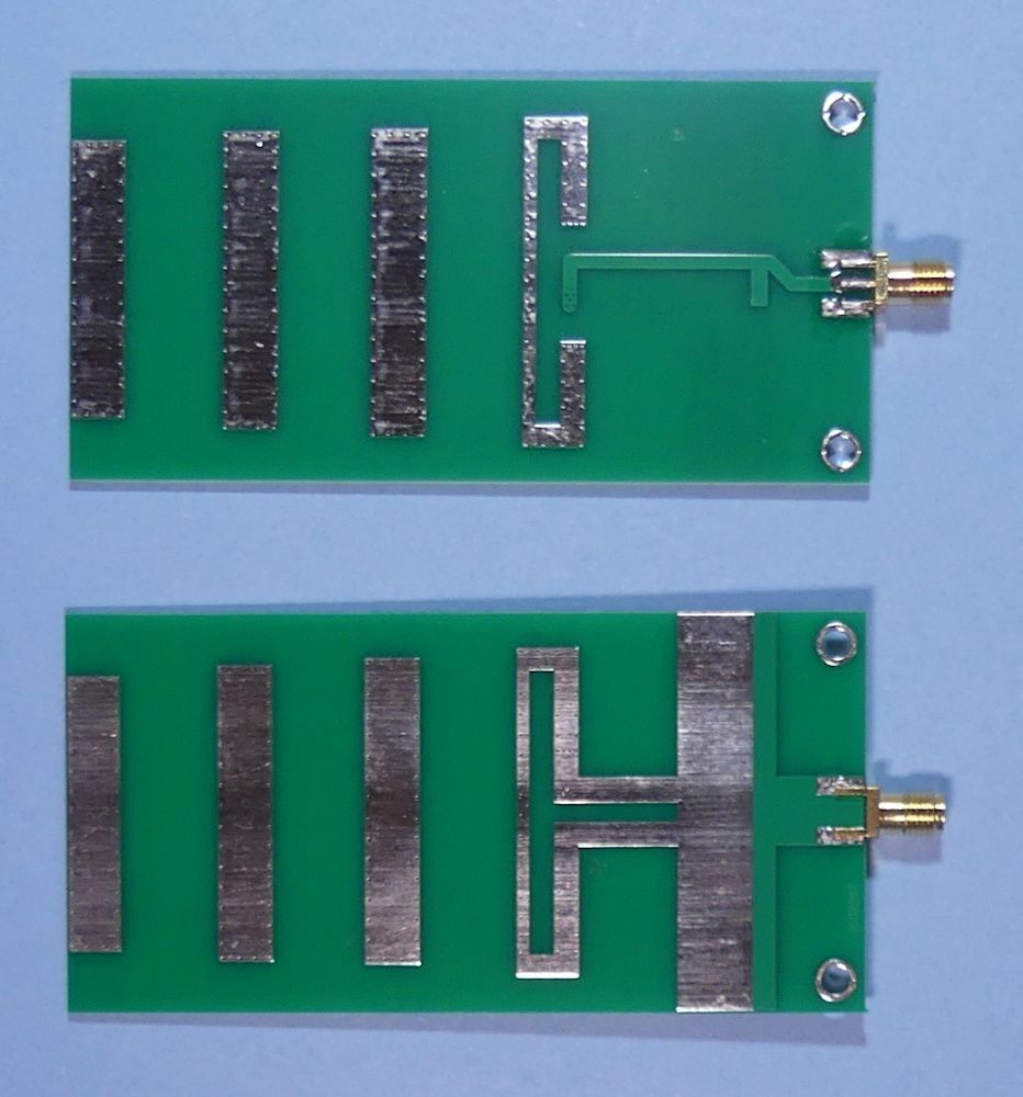

    The dimensions of the antenna are approximately 50mmx100mm so place greater mounting requirements than an omnidirectional antenna:
    PCB YAGI antenna board on green background with rulers on the side.
    The PCB shows three directors, a dipole and a reflector:
    PCB YAGI Wi-Fi antenna with three directors, a dipole, and a reflector.
    On the other side there is some magic with the paths concerning the w.cz ;)
    Request for a hint as to what is going on here, is this some kind of impedance matching?
    PCB YAGI Wi-Fi antenna on a green board with three metal strips and a connector.
    The antenna has proved successful in providing adequate range for transmission, but it is not always possible to transmit data using ESP-NOW in the 2.4GHz band,
    urban conditions severely hamper propagation in this band. The numerous Wi-Fi APs operating in this band also do not make the task any easier.
    Have you used PCB antennas or ESP-NOW, what kind of ranges have you been able to achieve? .

    A Yagi antenna is always a gain because of its directionality. For the same power, much more power radiated in the concurrent direction, also in reception increased gain.

    The magic mentioned may be the symmetrizer matching the impedance of the dipole to the coaxial cable.

    You've hit it - a Yagi antenna is a directional antenna as a rule.

    It has a directional characteristic, the transmitter had a vertical omnidirectional antenna so I vertically aligned the dipole in the receiver, then with the directors in the direction of the transmitter and found that a deviation of more than ~30 degrees causes a loss of signal.
    I could see nothing from the auction description, as it was some translation from Chinese along the lines of: "high power, low noise, range everywhere, powerful antenna, buy"....
    On the other hand, I found information that there are also PCB YAGI antennas cheated and there is an open dipole, and the connector is soldered in such a way that it makes a short circuit between the screen and the coaxial wire.
    I also looked for other types than YAGI PCBs however I eventually chose this solution. Others were panel/microstrip antennas and even a directional broadband logarithmic antenna.

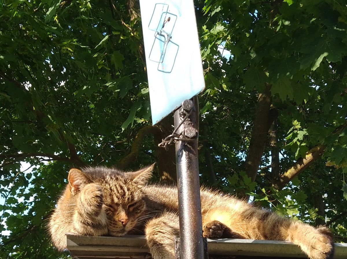

    Mine made from workshop junk and painted with some spray paint tip after 7 years;
    Cat lying on workshop roof with antenna in the background.
    I already have new cabling laid and it's practically redundant to me, but I need to put in an omnidirectional for my network instead. All I have to do is stand a few metres away and the phone loses signal. I can mount about 1.5 metres above the roof of the workshop. I am therefore looking for some simple DIY design.

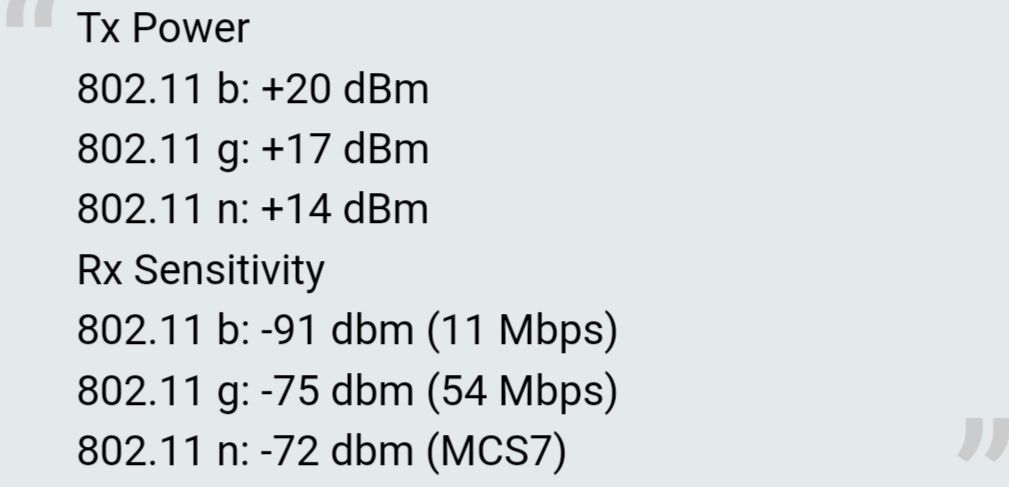

    If ESP Now packets are being lost, you could try switching the receiver and transmitter modems rigidly to the 802.11b standard.
    Table showing transmission power and reception sensitivity for Wi-Fi standards 802.11 b, g, n. .
    For the Arduino IDE ESP8266:
    extern "C" {
    #include "user_interface.h"
    Setup:
    wifi_set_phy_mode(PHY_MODE_11B)
  • Comparing 802.11b with WIFI_PROTOCOL_LR

    I have little experience with ESP32, but Espressif reports that up to 1km straight line range can be achieved in LR mode (ESP32 only) at the expense of speed.
    The gain over 802.11b is 4dB, which translates into 2 to 2.5 times the range of 11b mode. So much theory.
    The best way is to compare the two modes under specific conditions.

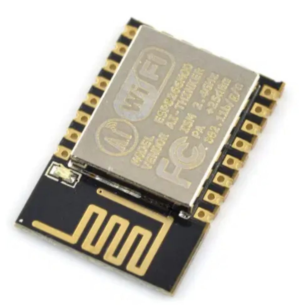

    WiFi module with built-in antenna on a white background. .
  • Humidity and heat can detune PCB antennas over time

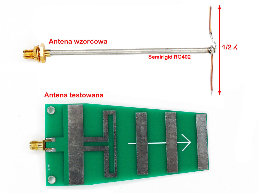

  • Measured 7–8.1 dB gain and 12–13 dB SWR on PCB Yagi antennas

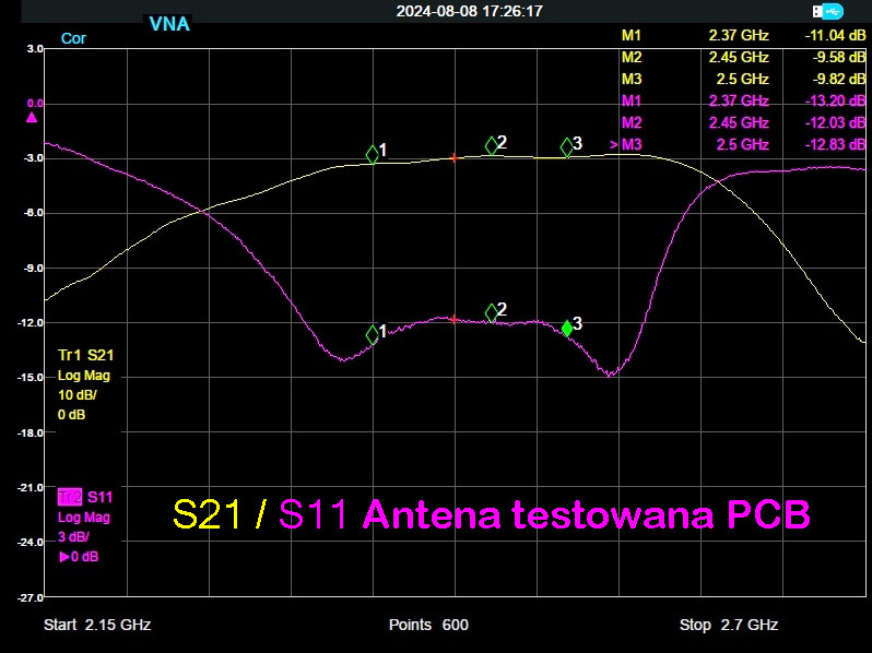

    I also bought the same antennas, I have similar needs, maybe a little shorter distance, about 100 m.
    I will give the details and results of measurements of the whole system- WiFi link in a separate post.

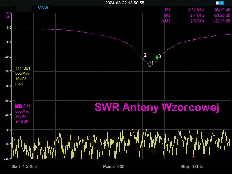

    I'll post some measurements, of course with the gain the seller exaggerated a bit - read this Link .

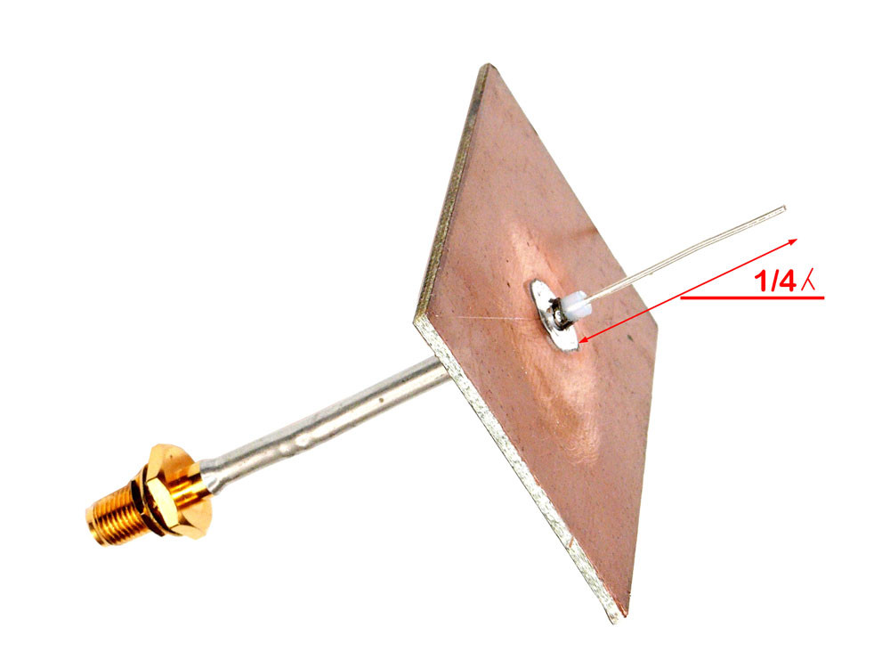

    The gain of the PCB antennas against a 1/4λ ground-plane was 7 dB, against a 1.2λ dipole(reference antenna) was 8.1 dB, SWR see screenshot - a little torii Link .
    SWRs of PCB antennas not crazy 12-13 dB. Reference dipole and ground-plane antennas at 2450 MHz SWR minimum 20 dB, reference dipole 26.7dB - see screenshot.
    Front-to-back attenuation around 14 dB - due to reflection interference it was difficult to measure this accurately.
    Noteworthy is the fact that the antenna works fairly evenly across the 2400 to 2500Mhz frequency range
    Signal level for testing 0 dBm, test distance between antennas 7 m.
    The tested antenna, in my opinion, has a flaw, it collects quite strongly from the side, the laterally placed dipole contributed to this.
    There were two antennas on the laptop and I also used these PCBs for two antennas, with one the system worked badly.
    However, they had to be at least 40 cm apart as they interfered with the transmission being close to each other (horizontal dipole).
    The antenna works quite stable in temperature and is mechanically stable.
    Mechanical distortion does not significantly affect SWR and passband.
    Like most antennas, and especially on microwaves, ours is sensitive to the immediate environment, metal objects, wooden objects.
    Placing it on a table, on the palm of your hand, etc. can shift the operating point (CF and SWR) by several tens of MHz.
    Such treatments can also lead to a condition where the antenna stops working definitively!
    The less of everything around, and especially in front, the better.
    When I buy an accurate digital protractor, I will measure the radiation angles and plot the antenna characteristics.
    Anyway, the antenna is directional and minimal deviations in direction caused significant dB drops.
    To get it to work properly, it needs to be placed in a free space, such as in a rack mount.
    This antenna is designed to work indoors, once the antenna is mounted e.g. in a yoghurt cup it will be suitable for outdoor use.
    I have already done tests and after such an upgrade with a plastic, foam lid, the parameters changed slightly - example application Link .
    In the future I will try to upgrade the antenna a bit more and put it in a proper waveguide.
    Such a solution will make the antenna more resistant to external factors, such solutions are known - see here - Link .

    Antennas are from left looking:
    - yagi - directional
    - dipole - depends on how you use it - in the plane of the dipole it is bi-directional (horizontal polarisation), in perpendicular it is omni-directional (vertical polarisation)
    - 1/4 wave or as above depends on how you use it.
    Such antennas are polarised and do not radiate spherically in every direction.
