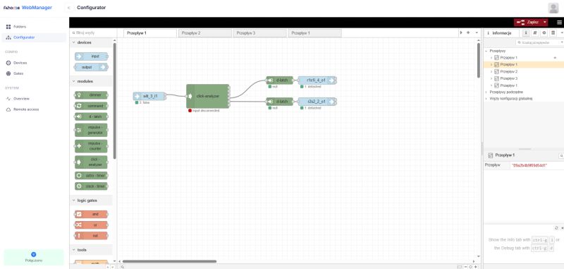

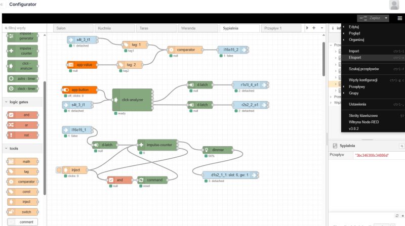

    We will now focus on the Configurator:
    Screenshot of the f&home WebManager configuration interface showing a logic flow diagram. .
    On the left-hand side we have the available nodes, such as inputs/outputs from devices, modules that perform given operations, logic gates, tools or there access blocks to the modbus interface and to the mobile application.

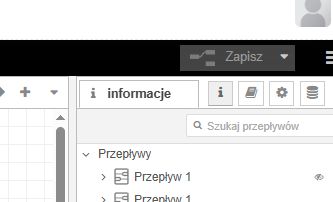

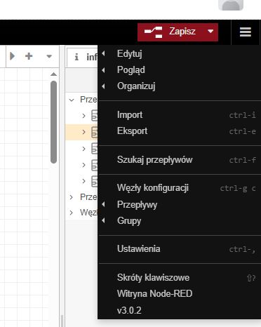

    On the right-hand side, we have information about the flows, a "Save" button and a menu allowing, among other things, the export and import of flows from a file.
    Screenshot of the options menu in the Node-RED application with the menu expanded. .
    In the middle, meanwhile, we have the flows in question - there can be many of them. Control is very simple:
    - a block is added to a flow by dragging it with the mouse
    - blocks are also connected by clicking and dragging between their inputs/outputs
    - double left click to activate block settings
    - single left click selects the object
    - delete deletes the selection
    - right click opens context menu
    - of course, shortcuts such as CTRL+C (copy) or there CTRL+Z (undo) also work

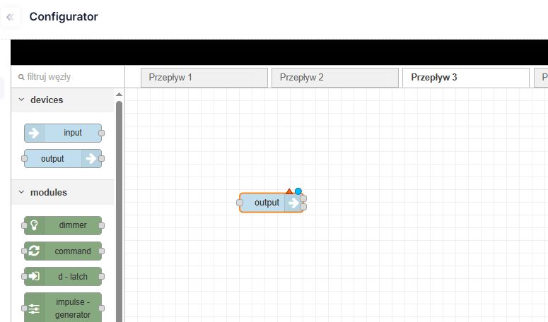

    First flow .
    Let us therefore drag the output node to the flow:
    Configurator interface for flow design with a visible output node on the grid. .
    Let's double-click it - in its options, let's at least select a button, maybe the one from rH-S4T:
    Window for editing the output node properties with a dropdown device selection list. .
    Let's save the flow:

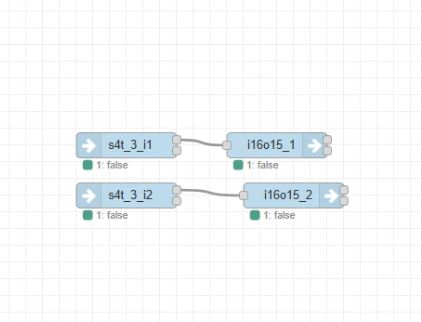

    From now on, the status on the selected input is visible at the node, the whole is refreshed in real time:
    Logic diagram showing a block named s4t_3_i1 with a green indicator 4: true and a red arrow. .
    So let's add a second node - the output node - and select some, say, relay in it. The whole thing also needs to be connected by a line:
    Screenshot of a flow editor with an open output node properties panel. .
    From now on, the state from the output is rewritten to the input. Simple. I put the whole thing together twice:
    Two horizontal rows of connected blocks in a Node-RED flow editor. .

    Logical gates .

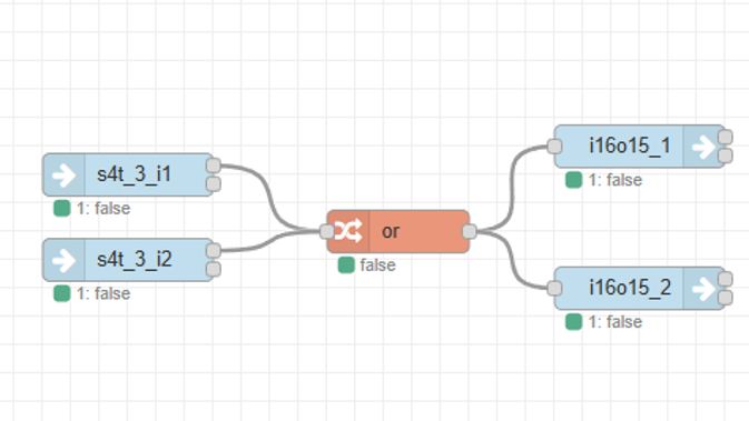

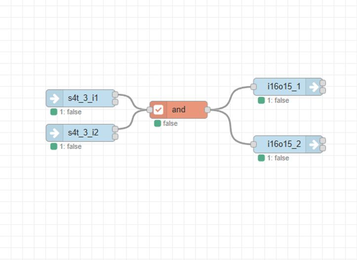

    Now that we have two inputs and two outputs, it is tempting to test logic gates. All we need to do is to drag such a gate into the flow and then connect it accordingly. An AND gate (logical product) only returns a high state when the inputs have high states alone, while an OR gate (logical sum) returns a high state when at least one input has a high state.
    AND gate:
    Logic scheme using an AND gate with two inputs and two outputs in the Node-RED editor.
    OR gateway:
    Logic diagram with an OR gate in the center, connected to two inputs and two outputs, all set to false. .
    Click state switching, i.e. a D-type flip-flop .
    The examples shown so far essentially directly transcribe state from input to output. This provides a good demonstration of the functionality, but is not practical. Typically, rather, monostable, momentary buttons are used in automation, which you press once and then they themselves return to their previous state. Such button presses should toggle the state of the relay, so you might as well flip the relay remotely.
    A flowchart with three connected blocks and an open node d-latch property editor on the right. .
    We add a node and set its trigger edge to rising.
    It is worth noting here that such a flip-flop has a memory and holds its state until the next change.

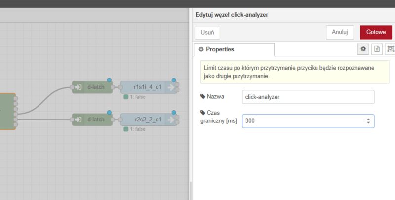

    Button events .
    We have already handled the flipping of device status in a simple way with a short click, but there is still room for improvement. After all, it is possible to separate separate events related to the button, such as short or long press (more precisely: release after a short or long press) or there a separate event of pressing, releasing, etc. A separate node is used for this:
    A Node-RED flow diagram with input, click analysis, and output blocks. .
    Its individual outputs correspond to separate events. It also allows you to set a cut-off time distinguishing between long and short click.
    Screenshot of a visual editor with the click-analyzer node properties window open. .
    The click analyser node has outputs in sequence:
    - pressed
    - long pressed
    - released
    - released after short press
    - released after long press
    - value from the input
    Accordingly, we connect further nodes to the outputs we are interested in. And don't forget the flip-flops. In this way, one button can control two receivers - example result:

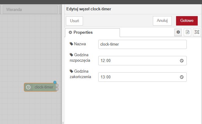

    Time and sunrise/sunset .
    The next two useful nodes are timers. We have two types of them:
    - clock timer, which issues logical values based on the current time
    Edit window for the clock-timer node with fields for name, start time, and end time.
    - an astro timer, which is based on the current time of sunrise and sunset (with configurable offset)
    Screenshot showing the configuration of the astro-timer node in the Node-RED interface with an event selection menu visible. .
    This allows, among other things, the lights to be automatically switched on when darkness falls or sprinklers to be activated at a selected time. Both timers have two outputs each, alternating between a low or high state, depending on whether the condition is met.
    A block diagram with three blocks: clock-timer, astro-timer, and output, connected by a single wire. .

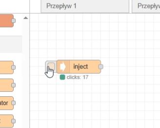

    Inject node .
    It is also useful to know the Inject node - it reacts to clicks in the configurator itself, this allows you to conveniently test the system. Under the node, the number of clicks is visible.
    Node-RED editor view with selected inject node and cursor pointing at its button. .
    In this way, flows can be triggered in the same way as normal buttons or a button from the Fox app (app-button).

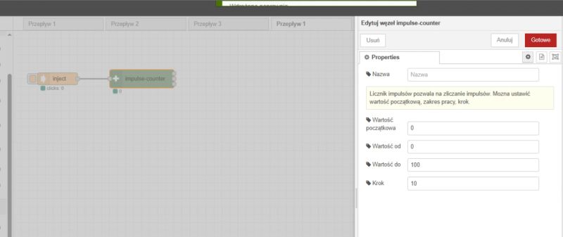

    Counter example (pulse-counter) .
    We will now learn about the counter node. The demonstration will be based on the mentioned inject. Let's configure the counter so that the initial value is zero, the range is from 0 to 100 and the step is set to 10:
    Screenshot of the Node-RED editor showing the setup of an impulse counter node with its property configuration panel open. .
    Increasing the counter works, however, there is a problem - the value stops at 100 and does not loop.
    Fragment of Node-RED interface with two connected blocks: inject and impulse-counter. .
    However, this can be easily fixed. This node has three outputs - the current value, a logic state telling us if the maximum value has been reached and a logic state telling us if the minimum has been reached.
    This allows us to use the logical product block and the reset command block (command block with the reset command selected) to reset the counter. When the value 100 is reached, another click sets the counter to zero.
    Node-RED flow diagram with inject, impulse-counter, and, and command nodes connected by wires. .
    The way this works is that the signal from the inject and from the pulse counter (the state of reaching the maximum) enters the AND node. So the AND will only give us a high state when both conditions are met, and then the command is triggered.

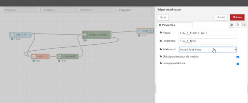

    Impulse-counter for dimmer control .
    We now have a numerical value from 0 to 100 that can be controlled by the user. This can be easily exposed to a dimmer for example:
    Screenshot of a graphical logic flow editor with an output node properties window open. .
    In this way, we have created our own dimmer control logic, which can always be adapted to your own preferences if necessary.

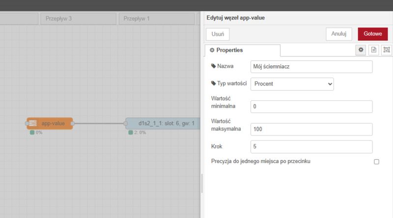

    Value from the dimmer control app .
    Numerical values can also be set from within the Fox application. This is done using the App-Value block, which can represent different quantities - temperature, percentages, number, etc. Limits and step size can also be selected.
    A view of an automation flow tool with the “app-value” node properties editor open. .
    In this case, we have selected a percentage, a range of 0 to 100, a step of 5, and connected the output of this node to the input of the dimmer.
    From now on, we essentially have ready control of the brightness of the bulb from within the app.
    A list of devices from an app, each with a name, description, and a percentage value or status. A mobile app screen showing a value set to 20%, with a slider and an icon of two balls with numbers. .

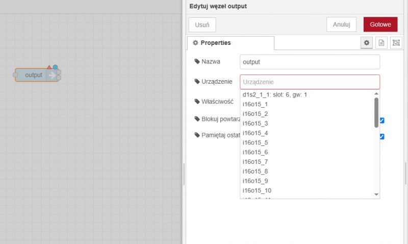

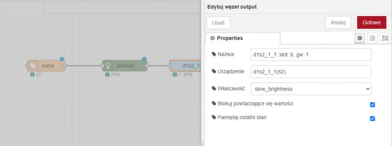

    Dimmer node .
    I didn't even use this in the previous example, but it's worth mentioning anyway that a ready-made dimmer offering configurable transition times is also available among the nodes.
    We add a general-purpose Output node. In it we select our dimmer, the node type will be refined.
    Edit node window for output in a graphical editor, showing a list of available devices. .
    You can now fine-tune the operation of the dimmer in it, e.g. set a slow brightness change.
    Screenshot of a home automation node editor showing output node properties configuration dialog. .

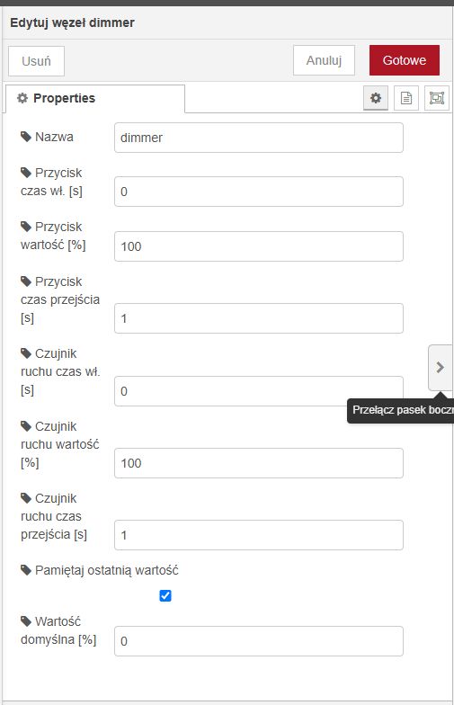

    We also add the Dimmer node, giving us additional functionality regarding light:
    Form for editing dimmer node settings with various text fields and an option to remember the last value. .
    Finally, for an example, a const node can be given as input - a constant value, say, 25% - 25% brightness.
    A flowchart with three connected blocks: const, dimmer, and d1s2_1_1. .

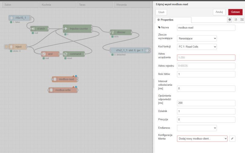

    Finally, it is worth mentioning the nodes that allow communication via Modbus. These allow connection to external systems.
    Screenshot of Node-RED editor with the properties window open for the modbus-read node. .
    Screenshot of Node-RED editor showing the “modbus-write” node being edited with its properties panel open. .

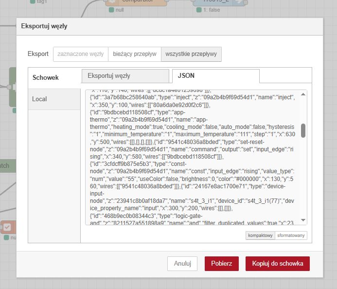

    Import and export to JSON .
    The visual layer also allows the logic to be easily written and read into a file in JSON format. The "Import" and "Export" options in the menu on the right are used for this:
    Screenshot of a graphical interface for home automation programming with blocks representing logic and functions. .
    A node export window in a software editor showing JSON code. .
    A given file can also be imported several times (as separate flows), which makes it easier to repeat the same logic when we have several pieces of a given set of devices.
