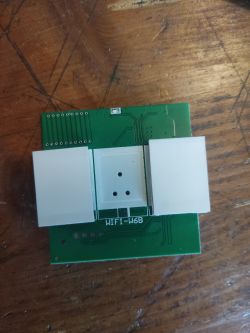

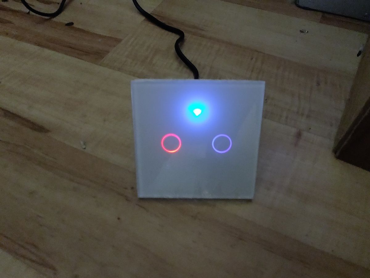

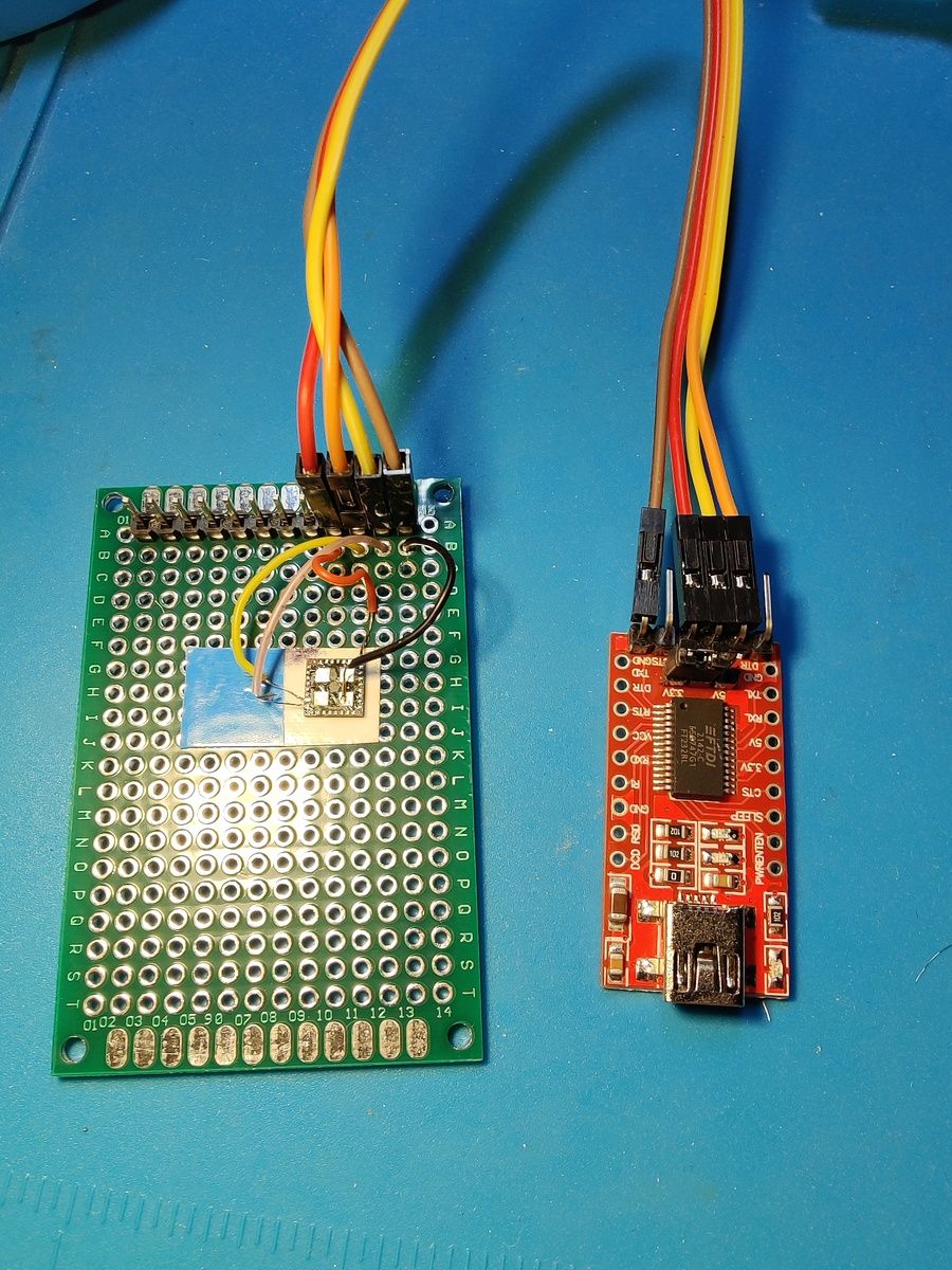

    #61 21111773
    johnypean
    Thanks for this thread. I have been successful, too.
    This is square 2-gang version.
    Square wall switch with two illuminated buttons on a wooden floor.
    Close-up of a blue circuit board with integrated circuits and yellow insulating tape.
    Prototype board next to a programmer with connecting wires.

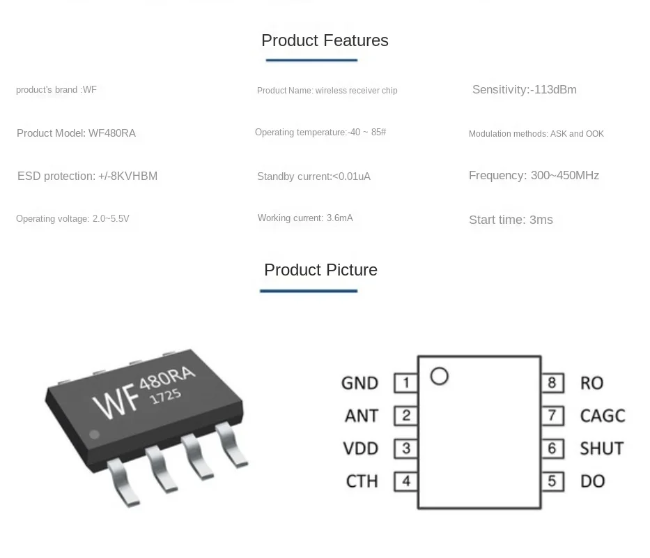

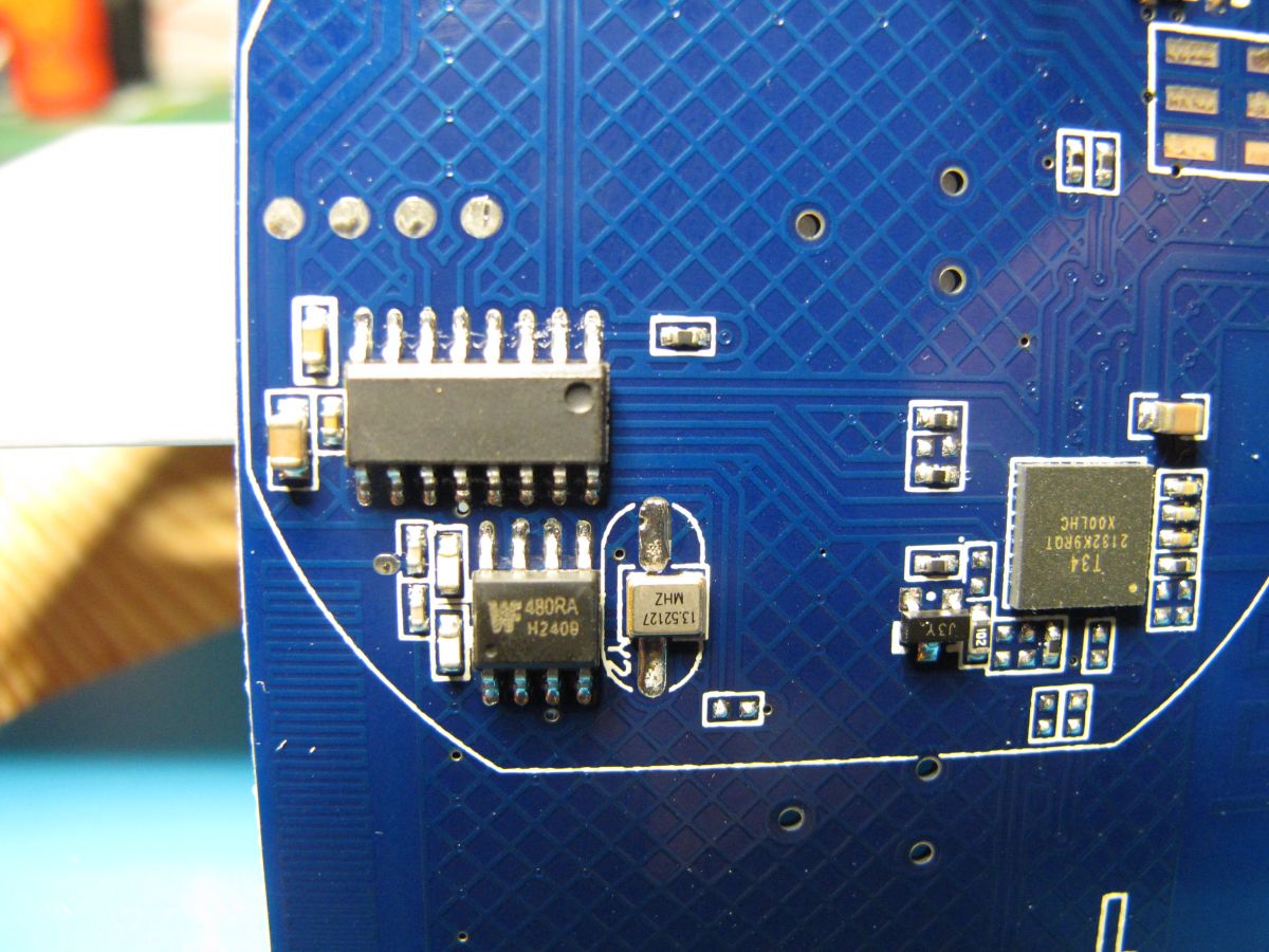

    Good job, but hey, is this Winbond memory chip? What's the purpose of that in the light switch?
  • #63 21111928
    johnypean
    WF480RA - 315/433MHz transceiver. It has its own antena on pcb opposite the T34s wifi antena. It seems to be connected to some of the T34 gpios. Haven't traced them. Looks like the device can be controlled by rf remote, but that wasn't mentioned in supplied manual.
  • #64 21111948
    Posts: 14755
    Rate: 12881
    Ah, it makes sense, especially with that oscillator nearby... I also had sometimes smart devices coming with RF support unannounced.

    Posts: 14755
    Rate: 12881
    The image shows the technical documentation of the WF480RA integrated circuit.
    We will need to add WF480RA support.,

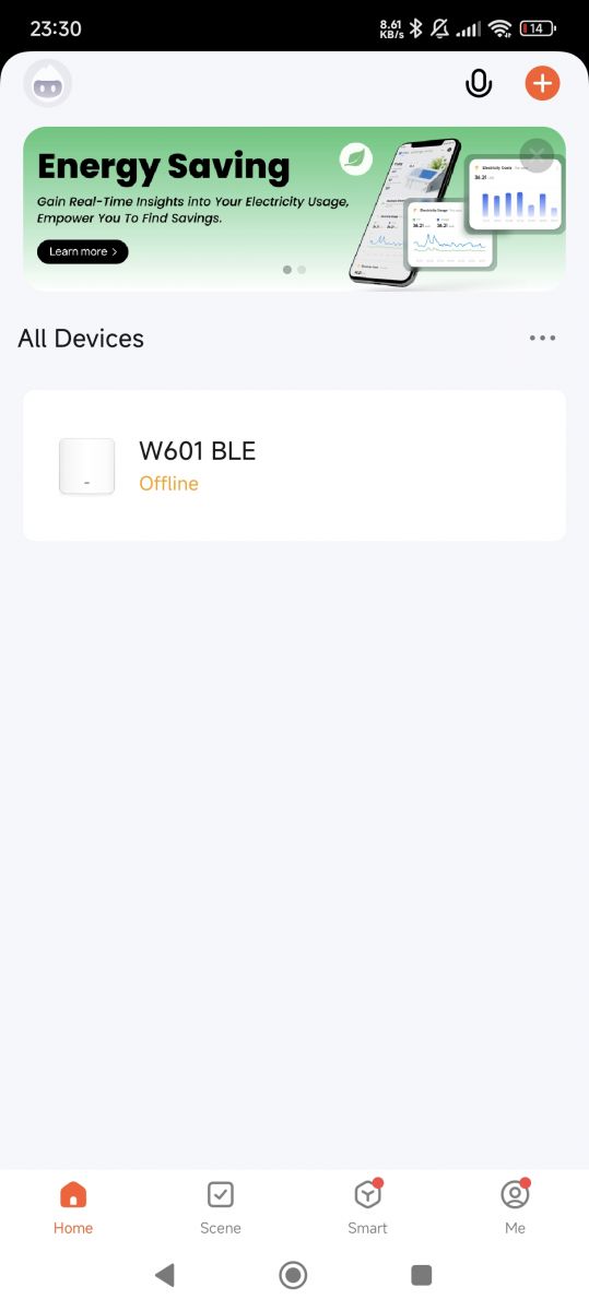

    I've had the misfortune of receiving one of these. A challenge for another day perhaps
    Packaging of a touch light switch in green, featuring an image of a hand touching icons on a panel. Product packaging with technical specifications and a barcode. Close-up of a circuit board with visible integrated circuits and components.
    maybe some traces can be exposed instead of removing the whole chip
    Added after 1 [hours] 25 [minutes]:

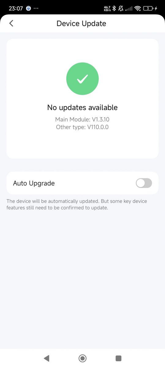

    Couldn't resist starting
    Device update screen showing no updates available and auto upgrade option turned off. Close-up of a blue printed circuit board with electronic components and connected wires.
    Known as W601 BLE
    App interface showing W601 BLE device, currently offline.

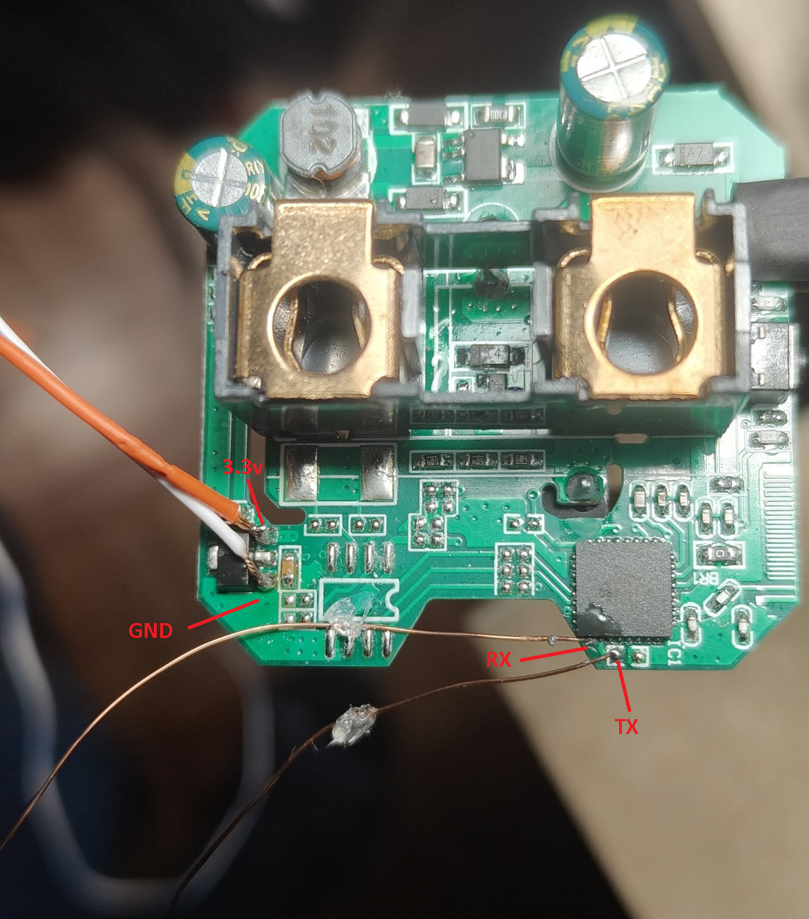

    an educated pin stab for 28 P0/UART2_TXD gives us this boot output
    Pin diagram of T34 LGA36 chip with UART lines highlighted.Image of a PCB with a microcontroller and soldered wires.

  • Needle access to P11/P10 enables in-circuit dump and flash

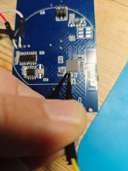

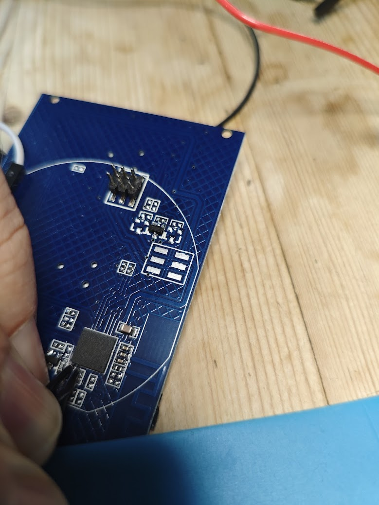

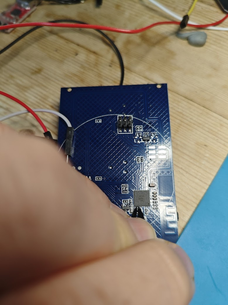

    #69 21117908
    Posts: 5212
    Help: 446
    Rate: 914
    it all looks like standard Tuya. The zipped dump in the first post gives this in Easy Flasher
    Error message stating Failed to extract keys with an OK button.
    but the user stuff is still decipherable. maybe a little tweak to Easy Flasher is all that's needed.
    I have not progressed to dump/flash my one yet

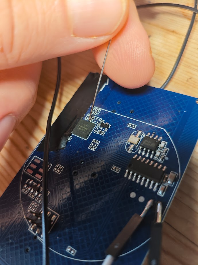

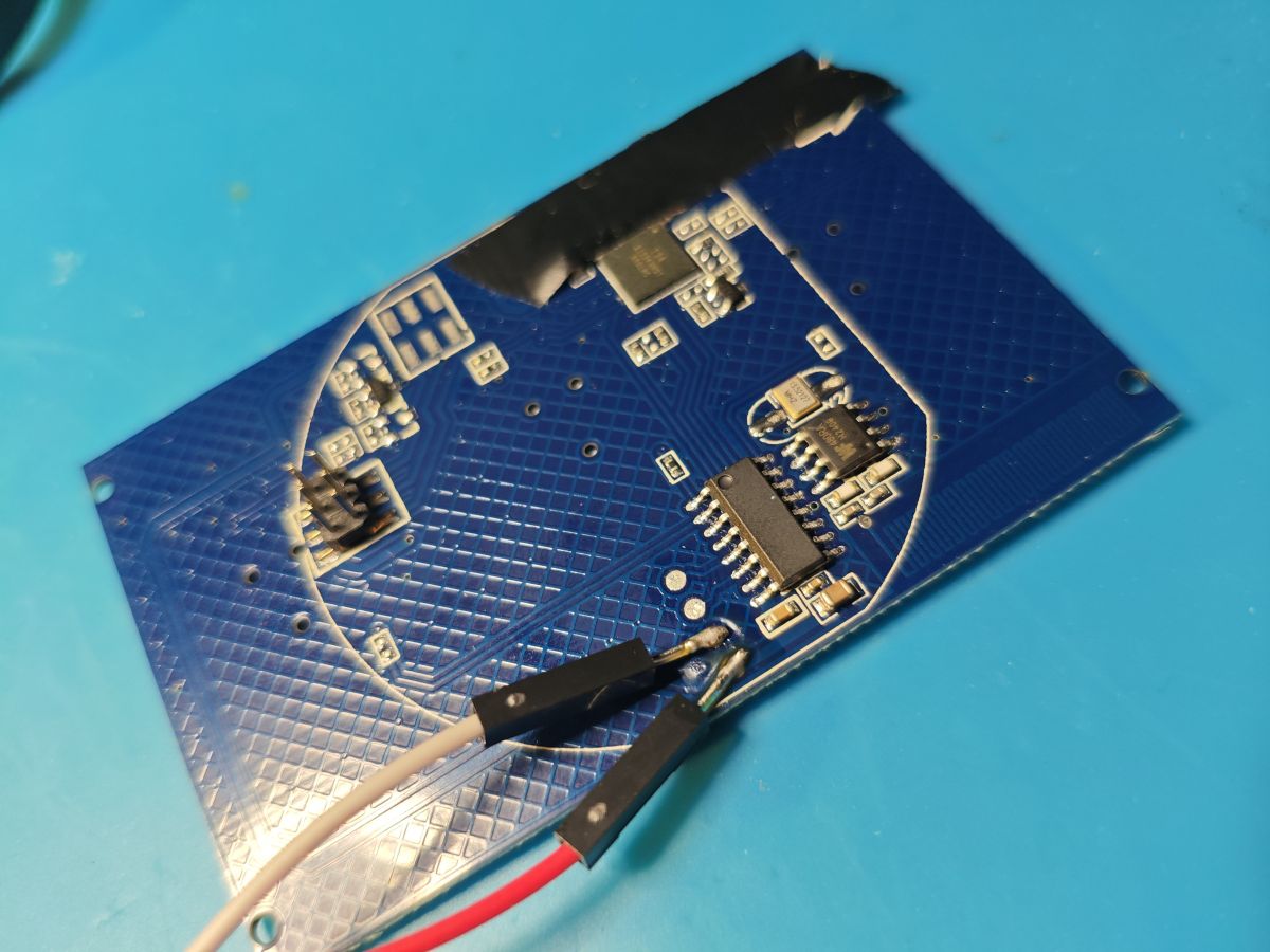

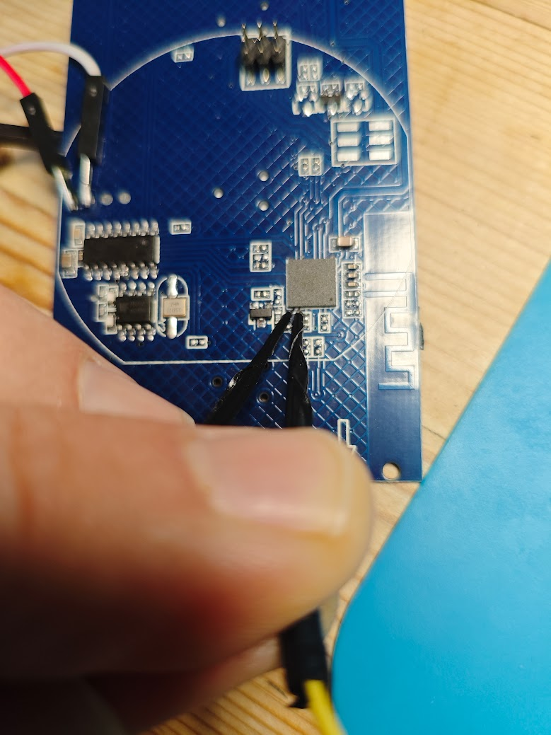

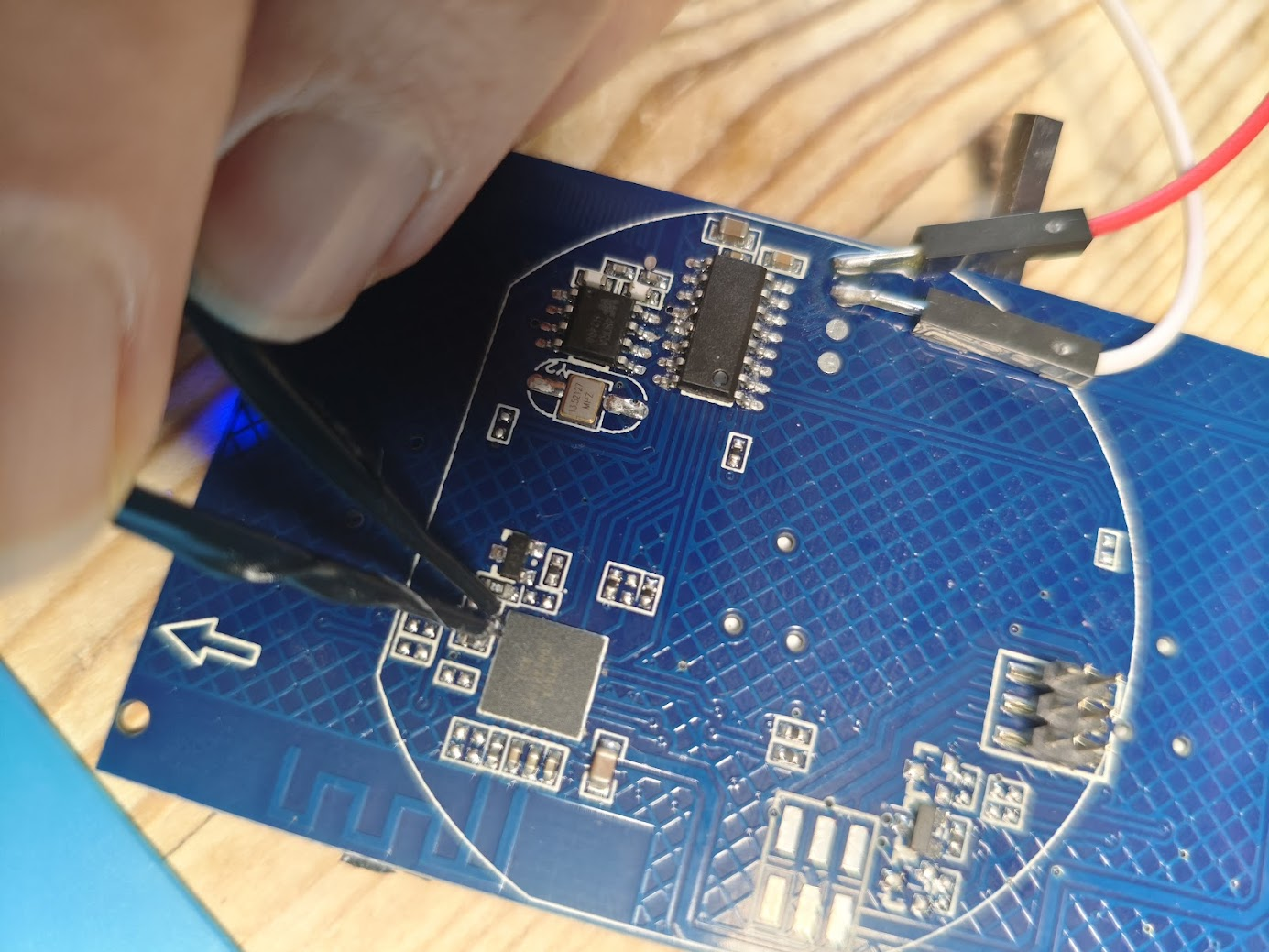

    Added after 2 [hours] 27 [minutes]:
    that was a mission. USB-TTL-> sewing needles to reach P11/P10.
    dumped and flashed without desoldering.

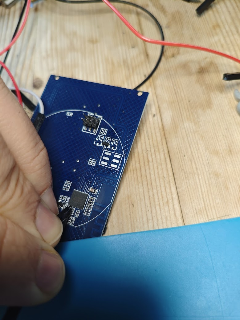

    Screenshot of Easy UART Flasher program after successful flashing of BK7231N chip.
    position of needles from a few angles:
    Hands holding needles connected to a circuit board A hand holding tweezers over a circuit board with attached wires. Electronic circuit board with wires and sewing needles attached to points P11/P10. A person holding a needle touching a PCB with wiring. Needles connected to a printed circuit board
    Wi-Fi connection icon with network name OpenBK7231N_0D1DD417.
    getting the right thickness of needle was key for me. It turned out one of mine was slightly thicker than the other and wasn't making contact. If you can feel the bumps of the legs then you're OK.
    • readResult_BK7231N_QIO_2024-13-6-16-26-01.bin (2 MB) You must be logged in to download this attachment.

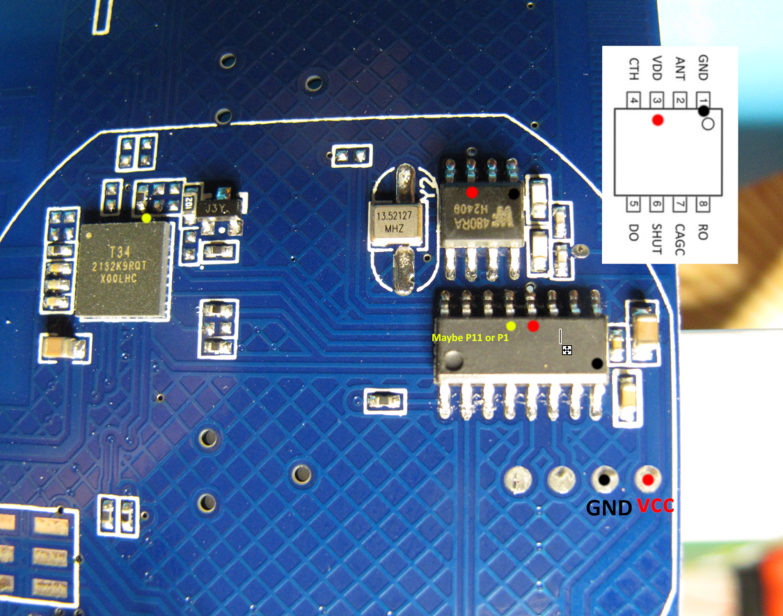

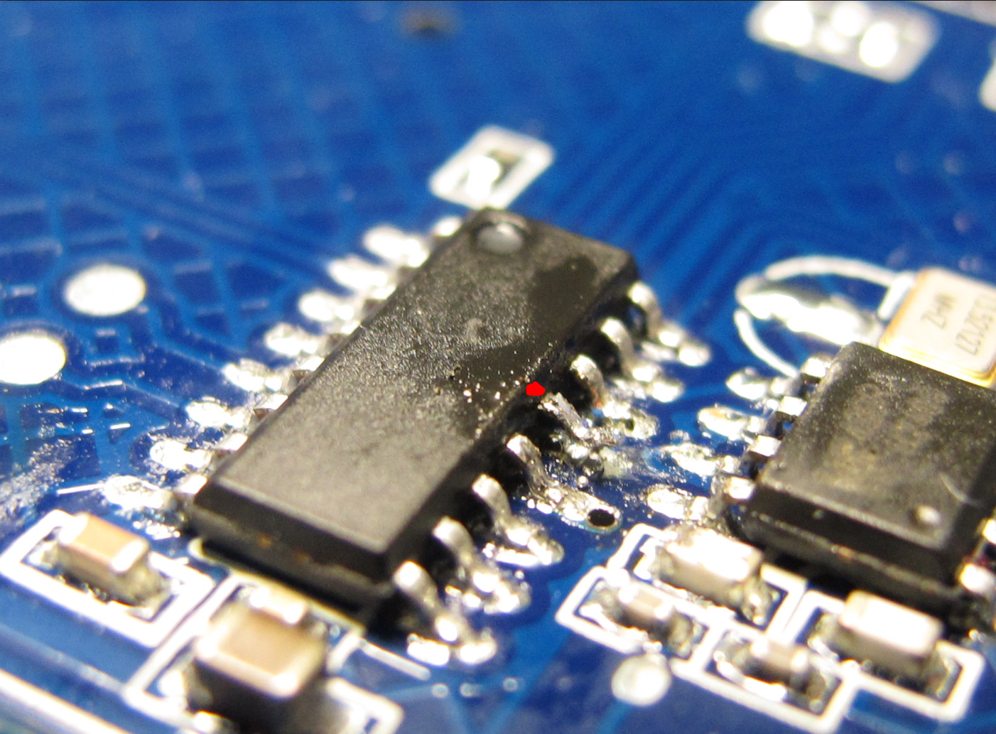

    I forgot to mention that I also lifted this pin on the MCU.
    Close-up of an integrated circuit mounted on a blue circuit board.
    it either traces to P1 or P11, not entirely sure. I'll drop it again then see if I can still dump firmware, now I have needles the right thickness.
    Close-up of a PCB with several integrated circuits and a pinout diagram.

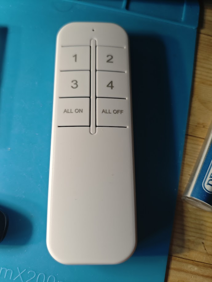

    Do you have RF Remote? This device should still have RF working I guess. RF is connected to the SOIC chip.
    I have 1 RF remote. Not sure of frequency or pulse or whatever. will try it
    Added after 50 [minutes]:
    sadly none of the remote buttons have an effect. it's one those 4CH Qiachip types
    Remote control with four numeric buttons and two function buttons.
    Bought it to try on this https://www.elektroda.com/rtvforum/topic4042000.html

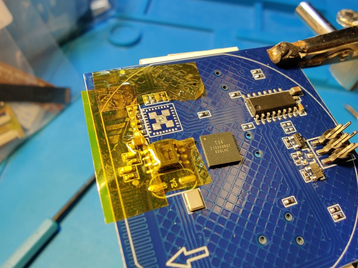

  • Hot-air desoldering T34 without displacing nearby parts
    #72 21127058
    Pete0815
    Posts: 34
    Hi
    just received 4pcs. of 1 Gang Switches and I expected CB2S to be inside but now there is T34 :(
    Interior of an electrical switch with visible electronic components.
    I have 858 hot air gun and used it for replacing damaged USB-C ports and figured out not easy to take care of swiming SMD components.
    So far no special tape here to use.
    Can you advise if it´s worth givin it a try just using the Air gun for <60 sec. with some flux to desolder T34 but not damaging or displacing other components?
    T34 is looking very circled by other components in my case/ for this type of switch.
    Thx!

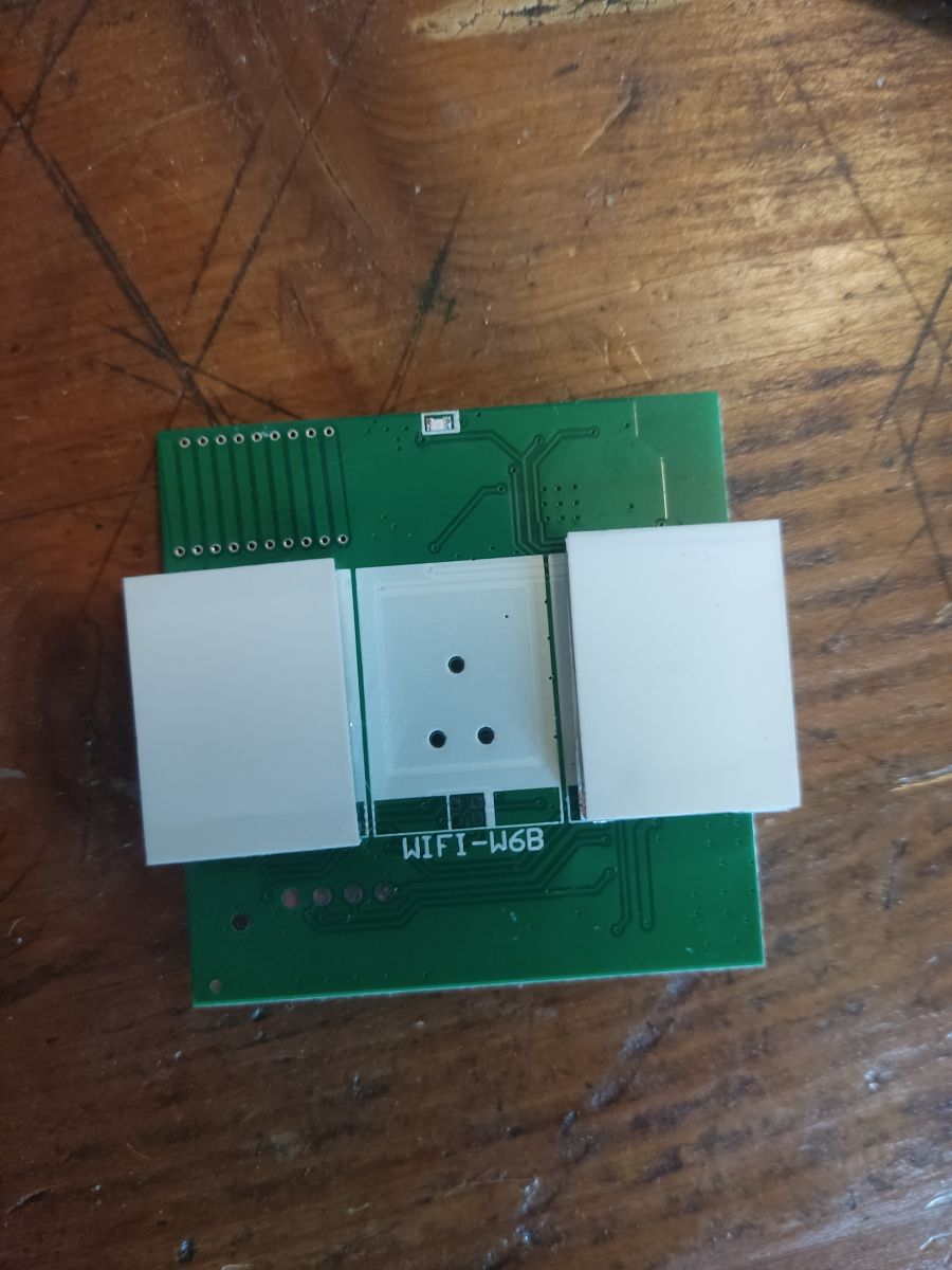

    I bought a similar one from ali to replace an esp8285 variant and it came with a t34 but i was pretty lucky and the pcb got easy flashing points
    Green PCB module with white plastic buttons labeled WIFI-W6B on a wooden surface. PCB board with marked TX and RX points.
    flashed it and it works flawlessly , here is the template :

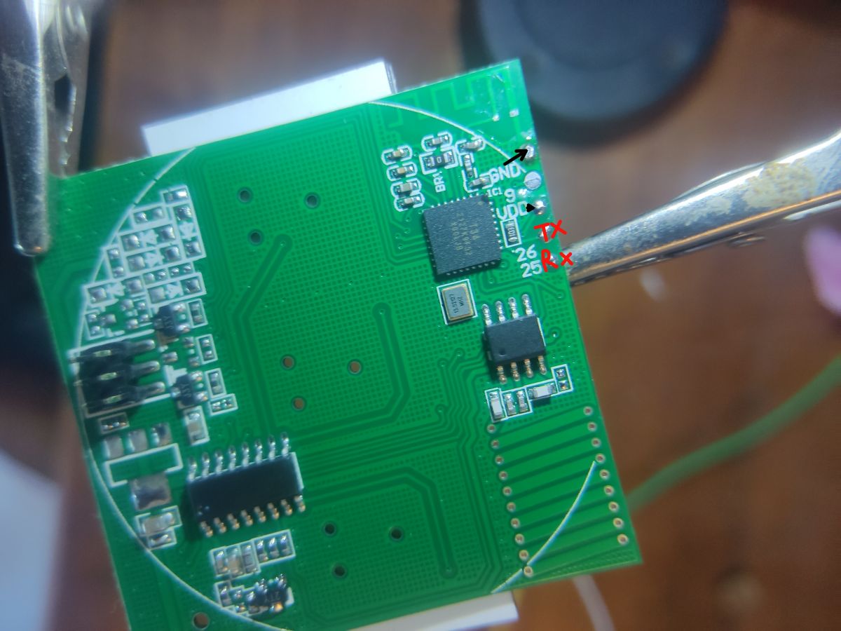

  • JTAG pads may allow T34 programming via MCU pins
    #85 21326143
    dgel27
    Posts: 19
    >>21117908 Hi, i have board most similar lake yours, but different component placement.
    In my board the Rx from T34 connected to resistor, so 1 needle is less :) The 4 pads also have different positions. the 2 of them - VCC and GND, the 2 others come to "unmarked" MCU, that i think served RF encodings touch buttons, and maybe T34 programming.
    I think it have be way to program T34 via these pads, at least for production. The chineese guys have to change at least their config for 1,2 or 3 gangs in the switch. I don't belive they program T34 for different configurations before assembly.
    Edit:
    My board seems exactlly as @dhanushkadx , the pads plased on the buttons side.
    I found, that in both modules, my, @dhanushkadx , @CameronDev and @divadiow have pins, that in regular works connected to buttons via some MCU,
    the 2 "special" pads, connected to same MCU's legs (in my case the pins 5 and 6 of MCU).
    But in some "special" modes, the buttons used P22,P23 that is JTAG TDO and TDI of T34.
    @p.kaczmarek2 maybe you know some way to program chip via JTAG? At least, it will be easier to connect to MCU's pins, instead with needles to T34.
    And if found way to program via 4 PCB points (i think it JTAG via MCU) it will be exellent.
    Other ways it seems Tuya go to produce more smaller and smaller modules with harder to connect to it..

  • #86 21351950
    dwygaming
    >>21135586 Hello :)

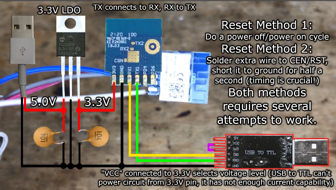

    How did you shorten with CEN ? I got the module connected, 3.3 and GND ok, But I can t pass the "reboot device" step, when I disconnect 3.3 from uart the COM3 disappear/ flasher sends an error.
    Any help appreciated :)
  • #87 21351976
    Posts: 14755
    Rate: 12881
    What do you mean by "3.3V from UART"? 3.3V pin from UART can't provide enough current, check out our flashing tutorials here:
    for example, that one:
    Here is a screen capture from this vid:
    Connection schematic with USB to TTL converter and 3.3V LDO with reset instructions.

    Posts: 9

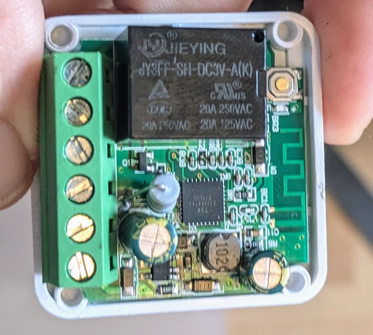

    Thanks for the thread, it has been very helpful.
    A few days ago I install tasmota on several wifi smart sockets bought in Aliexpress with ID T34 2132K9RQT X00LHC directly welding according to the information of this thread.
    Smart plug and box with Works with Amazon Alexa and Google Assistant information.
    Here the photo of how I did:
    Close-up of a circuit board with labeled 3.3V, GND, RX, and TX ports and connected wires.
    It is a very simple device, these are the details to be able to use the relay and the external button:
    pins
    24: Rel;1
    26: Btn;1
    28: WifiLED;0
    command: startDriver NTP
    Thank you very much for the information and for sharing it with everyone. <3
    PD: I hope my post is not at the wrong place
  • #89 21486299
    Posts: 14755
    Rate: 12881
    Thank you and good job on flashing that!
    I've also received this plug and decided to create a separate guide: https://www.elektroda.com/rtvforum/forum51.html
  • #90 21486326
    kalikum
    Posts: 9
    Thank you!!!!
    I had not seen it before, everything is very well documented, awesome.
    Mine has no consumption chip.

  • One 3-gang T34 switch shipped with Tuya firmware 1.3.10, blocked Cloudcutter, and had four board pads where only 3.3 V and GND were identified as useful for power, not direct flashing. [#20968165]
